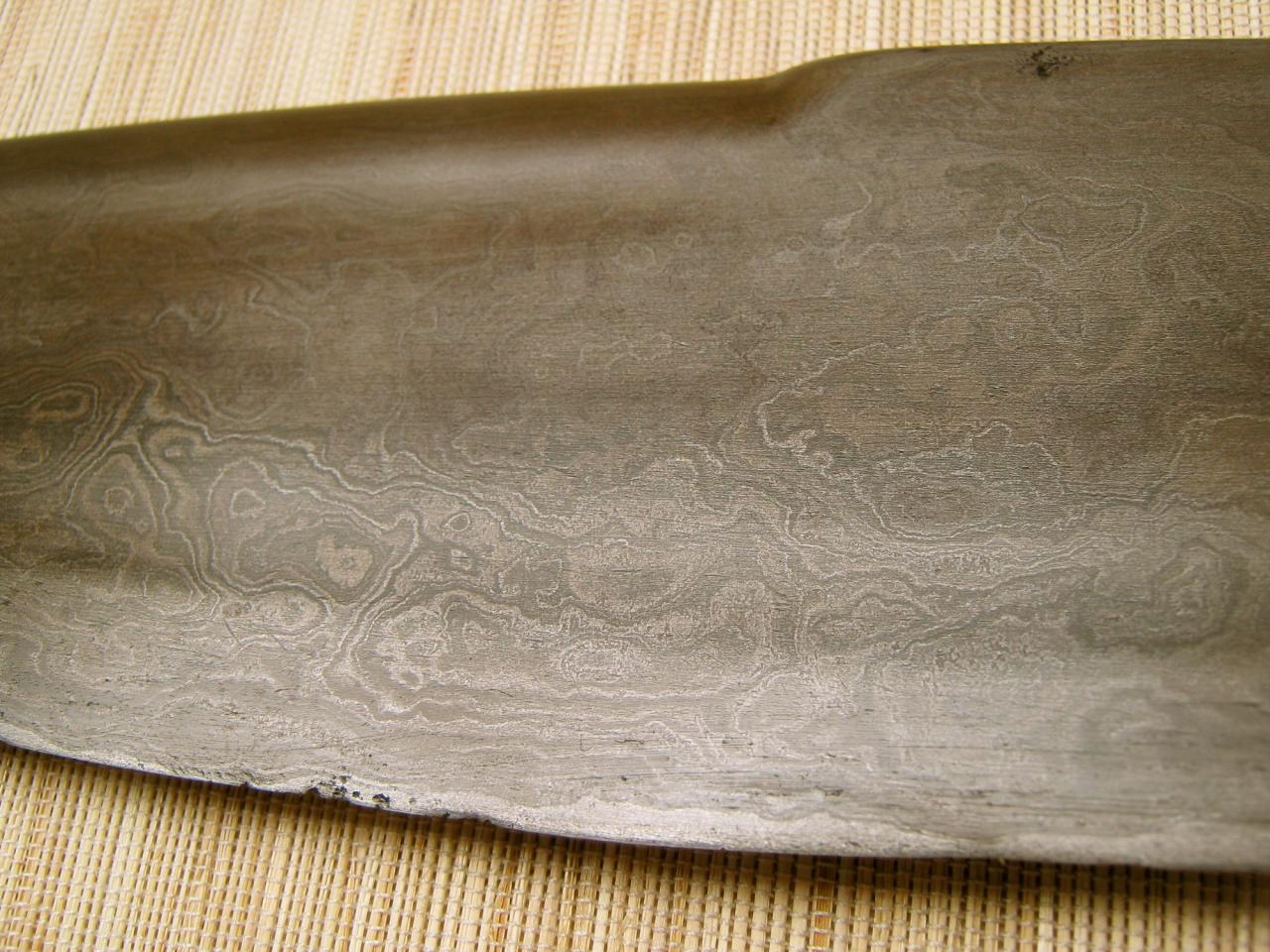

Hello all,
Sharing with you my straight kris and kampilan.
Kris pattern welding
Hilt = 4 7/8in
Blade = 20 in
Kampilan with pattern welding as well
Entire length - 37 in
Hilt - 9in
Guard - 6in
Blade - 27 1/2in
Thickness 1/4
I'd like to know their provenance, I was told the Kampilan is from Maguindanao.
Thanks!

Nice blades. But my question would be is this "pattern welding" or are these "laminated" blades? I realize the techniques are related, but my understanding is that pattern welding is a technique which grew out of the process of "laminated" or "piled steel" forging. This aspect of blade collection is not my expertise, so please feel free to correct me if i have this wrong. It could be just me falling for the naming of the things and expecting to see a more defined pattern in pattern welding.
This is what i would more expect to see in a pattern welded Moro blade as seen in this barung.
It could be that you are right? I wasn't aware that there's a difference...I'm pretty new in collecting Moro blades so my knowledge is very novice.

Just a query: would it be correct to assume that the kris blade is laminated thru and thru and the dark edges are the result of differential tempering?

all pattern welded blades are laminated blades, but not all laminated blades are pattern welded.
Well, there are also pattern welded wootz blades (which are technically not laminated...) - however, more often than not, the terminology often gets pretty loosely applied, anyway.
In Indonesia, there also is the concept of planned and unplanned pamor: Complex, controlled pattern welding would usually be referred to as planned while more basic, "random" laminations are usually considered as unplanned. IMHO this is also somewhat off since for tight "unplanned" laminations you also need to have a clear intention, know how to achieve that and what you're doing, as well as having extensive control during your working processes. Moreover, there also seems to be a tendency to refer to some pamor motifs as unplanned since their "spontaneous" appearance is believed to enhance their mystic power. In many cases, I'm more inclined to believe that the blade smith did lend more than a mere helping hand...
Old 10th July 2021, 12:29 AM   #9
Post
Hello Ariel,
No, most kris blades are of sandwich construction with a central layer of hardened steel (dark after staining) and laminated mild steel as outer layers (lighter areas).

Pattern welded : use of two different steel with different characteristics to produce a contrast (like keris)
Laminated/forge folded : use of bloomed steel, forge folded several times to purify it. The position of the bloom, in the furnace, will not be homogeneous in terms of carbon content. Which will produce different coloration during etching. Also, several layer can be seen (like Japanese sword). Not that if you use two different forge folded steel ingot with different amount of carbon and different composition, you can make a pattern welded blade.
Wootz steel : crucible steel, made in a graphite crucible. It’s the composition + heating/cooling process which will give it the characteristics.

Ariel - usually the edges that are dark are due to tempering.

Seems the two responses are good. The kris shows a harder steel use for the edge (darker because of the better carbon content than the rest) plus the quench line. You can see that variation of the quench line go above the harder edge, especially on the tip

that’s exactly what I had in mind and was saying about the kris presented here: dark edges due to tempering.
Well, these blades are most certainly not tempered. The central steel layer is certainly higher carbon steel with at least the edges hardened; it's tough to establish whether these got differentially hardened/quenched though. Indonesian/Malay Keris are usually water quenched by dipping the distal third to 2 thirds into water - I have yet to see a Moro kris with the same tell-tale v-shape discolouration. However, this is also not commonly seen on keris and the larger size of the Moro kris may dissipate heat resulting in more gradual transition between hardened and non-hardened areas.
D'accord.
Pattern welding is probably more defined by the intention of the blade smith rather than actual contrast achieved though: In many cultures a more subdued contrast was appreciated compared to the bold pamor often seen with keris Jawa/Bali. Also the method to visualize the contrast varies widely (high polish in Japan vs topographic etch, warangan stain vs patina from use, etc.).
Quite often the contrast is also due to phosphate, nickel, or other differences between alloys. (While bloomery steel is historically most relevant, also other sources/alloys can be welded to produce laminated steel.)

The blade most likely would benefit from a gentle polish and etch. Certainly laminated with hardened edge; many exhibit nice laminations/patterns, too.
