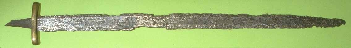

O.1 Early pattern-welded blade with later Viking Age bronze guard

This sword reputedly had been "making the rounds" in the Dutch antiques trade before finding its way into its present collection; as such, the details of where it was found have been lost, along with its pommel. Of interest is that the blade is of a type characteristic of either the Migration Period or early Viking Age and generally regarded as having been mostly out of use by about 800, while the cast bronze lower guard is of a type characteristic of 900 to 950, strongly suggesting either that this is an.early blade re-hilted or that our chronology is defective (more details in zooms of hilt and guard). Of special interest regarding the blade is that the degree of erosion exposes the structure of this pattern-welded blade and a stress fracture paradoxically suggests failure of the pattern-welded bands before the steel edge sections.
