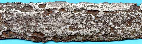

The four bands of pattern-welding may best be discerned just to the left of the center of the picture where curving patterns emerge from a plane of section into the rods of either less or more than halfway through a composite rod's thickness. The non-patterned steel of the edges appears most intact along the edge at the top. (For further discussion of pattern evolution, see the on-line document on pattern-welding).
