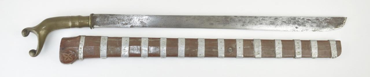

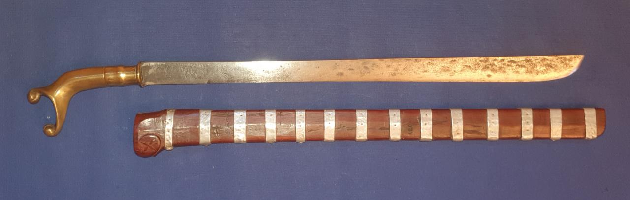

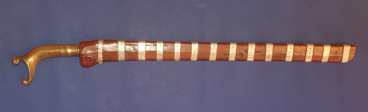

Today I have received the shown sword from a German auction house and which was wrong described as "Moro klewang"!
It's a Nias sword with a seldom seen brass handle. When I returned from work we didn't have daylight anymore so here is the picture from the auction house. In hand it looks much better, the wood from the scabbard shows a glossy patina, the bands could be from aluminium but could be from mamas also, I am unsure for the moment. 57,5 cm inside scabbard, 55,5 cm without, blade alone 44 cm and 5 mm thick at the spine behind the handle. Blade is laminated and still very sharp.
Better pics will follow soon as I can take them.

Very nice and congratulations. Bands do look aluminum to me too. I may have seen only one other years ago. I think they are rare.
I agree - not Moro at all.

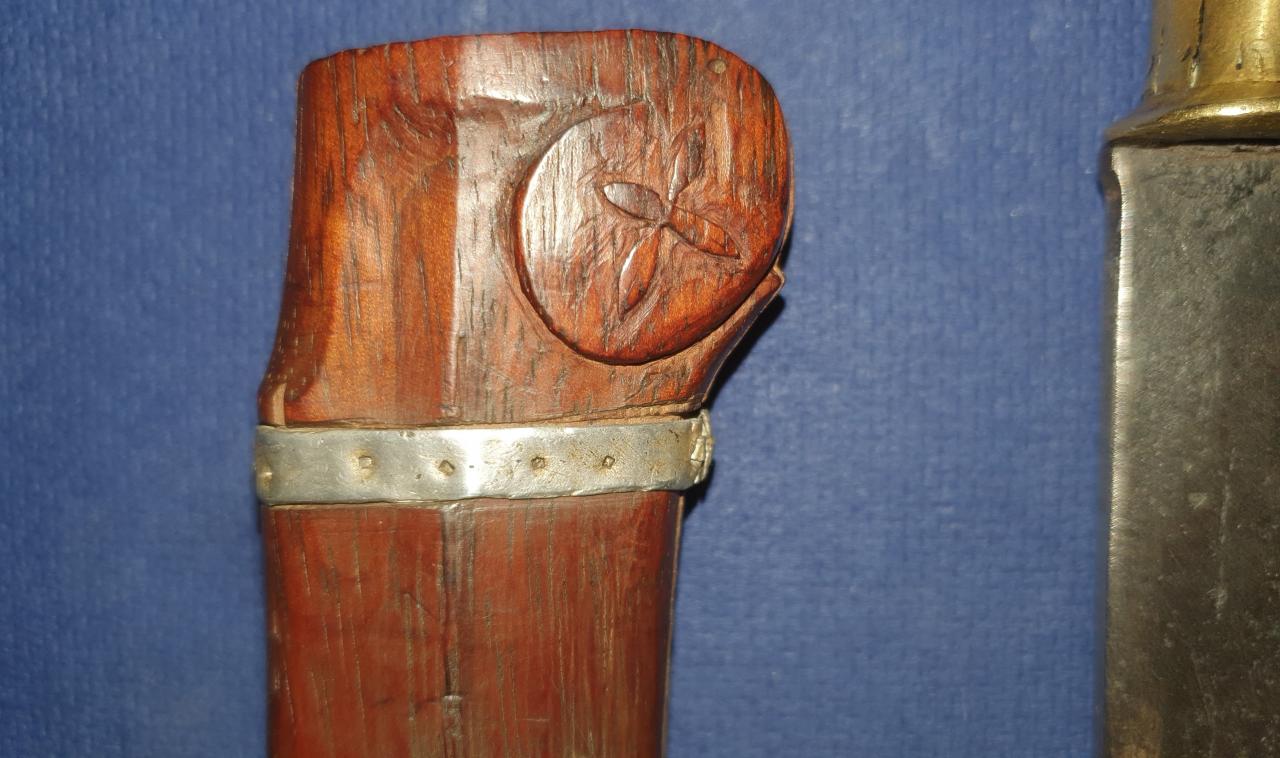

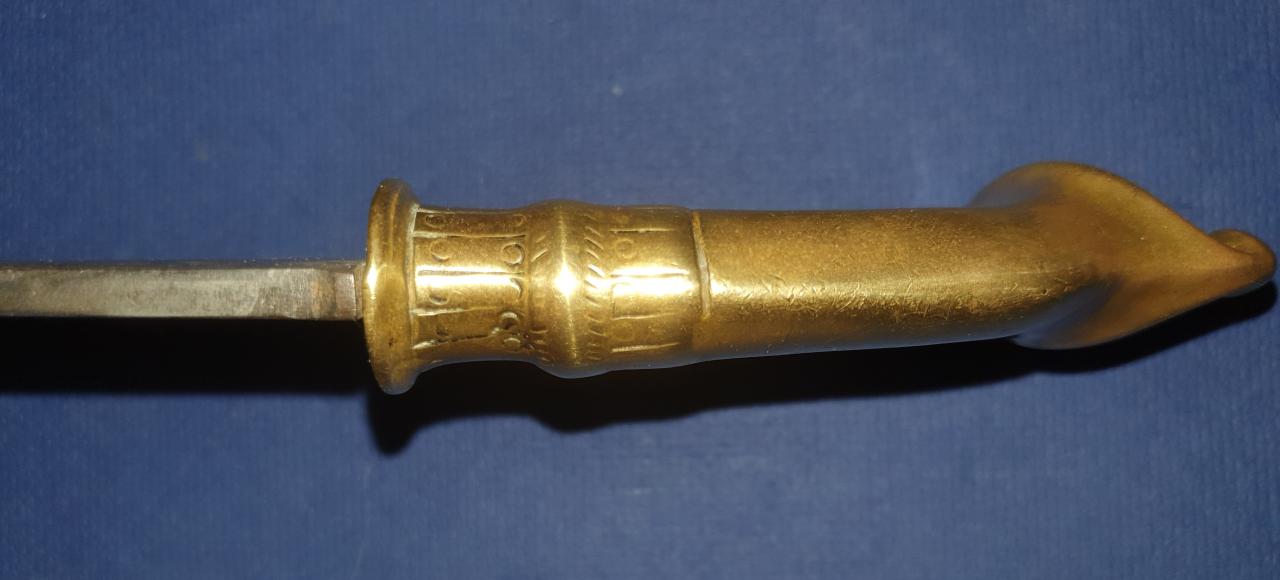

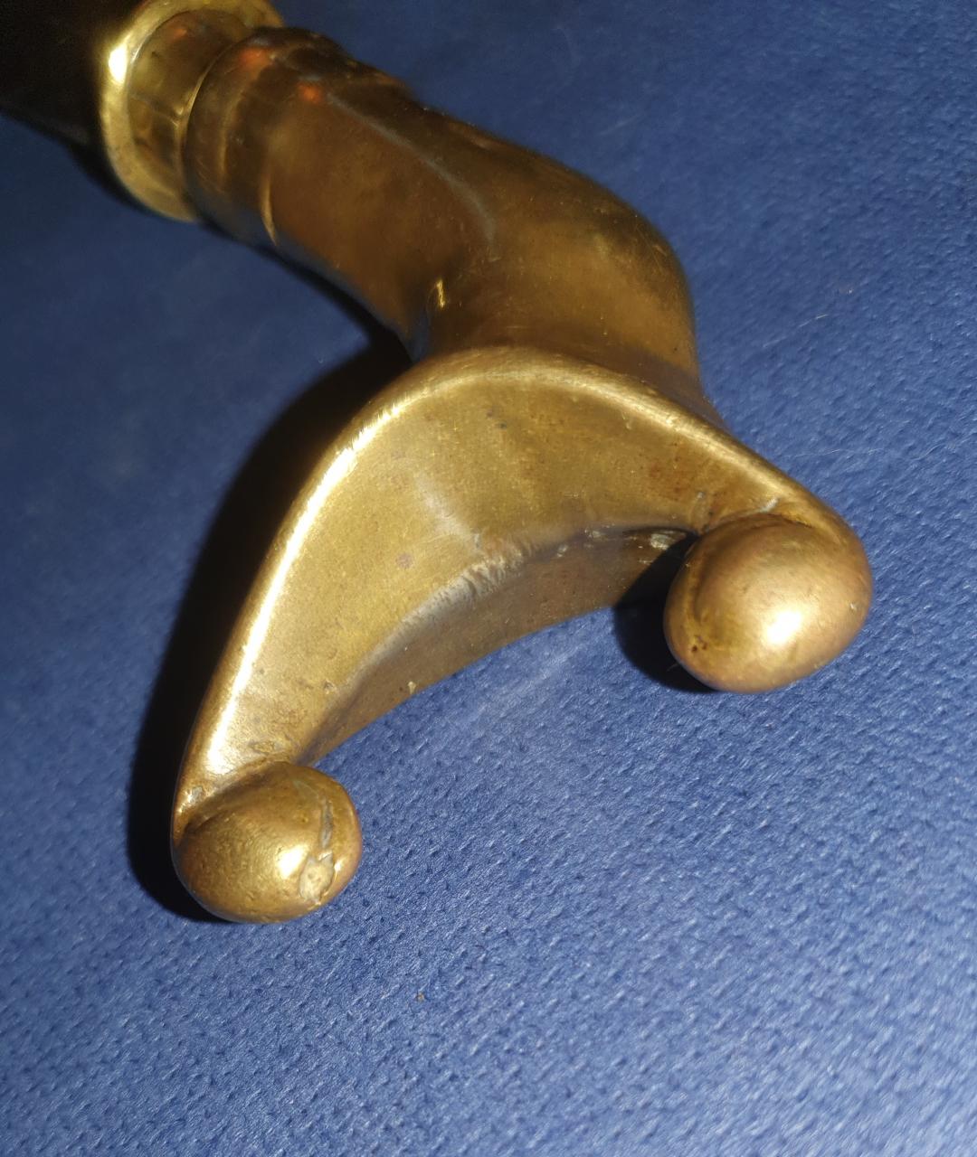

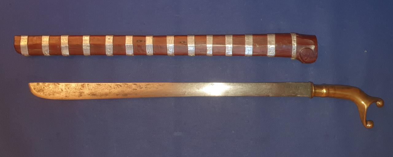

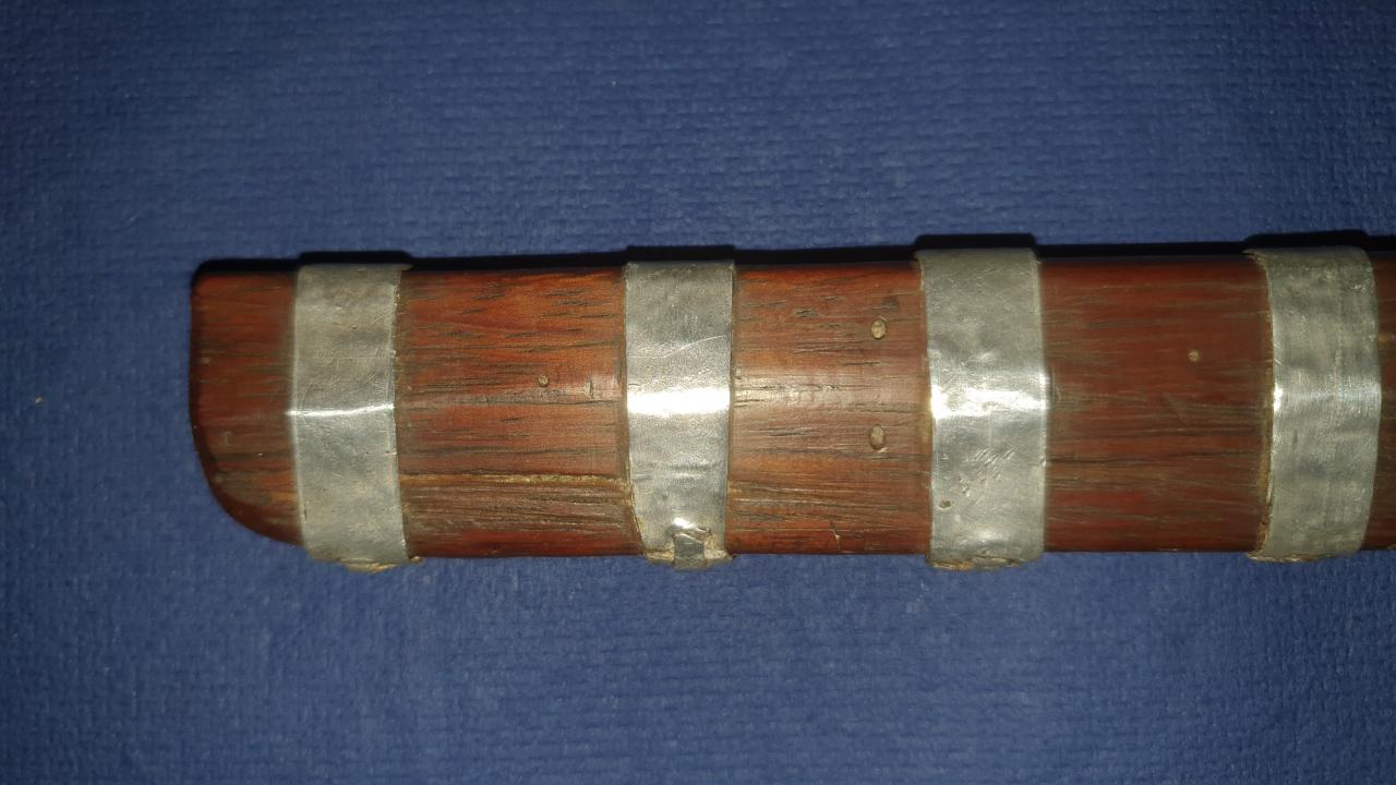

I am very pleased with my new toy! An overall beautiful patina. I am still not sure that the scabbard bands are from aluminium, they polish up very fast, very unusual for aluminium, who have done it before will know what I mean. And when polished very shiny, again unusual for aluminium. And I know that mamas, when tarnished, look like aluminium.

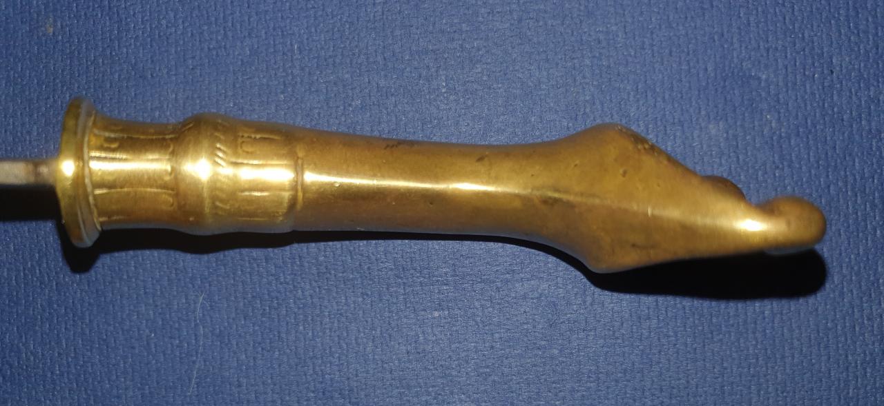

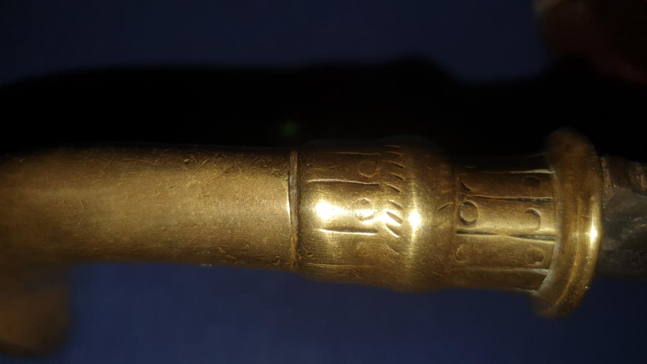

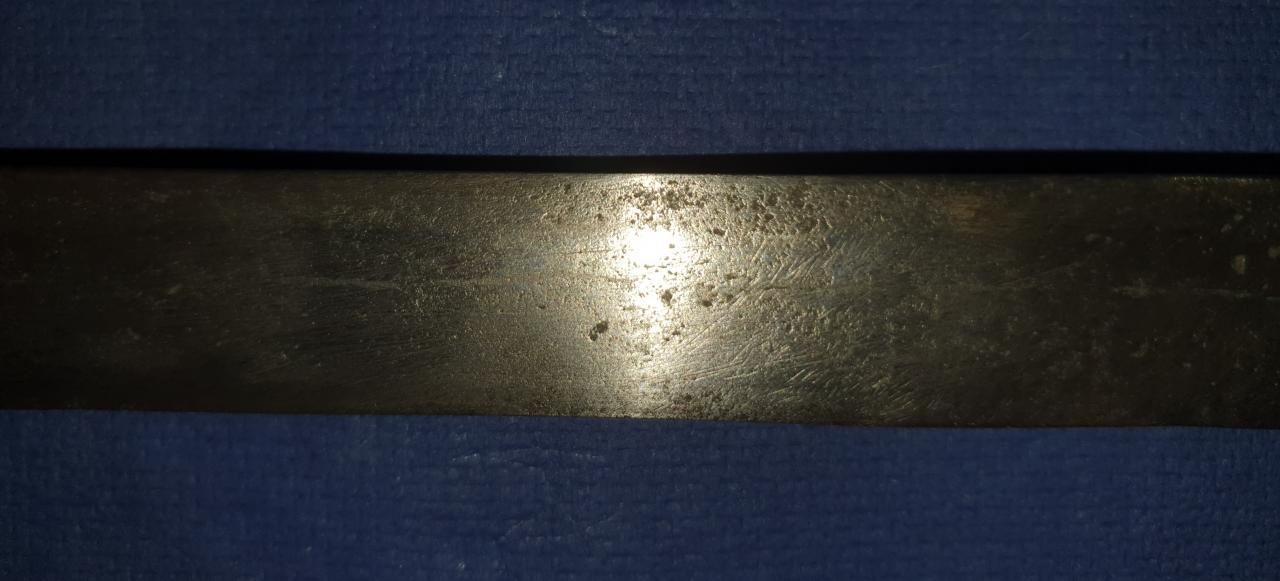

Here some new pictures from the balato.

kino
kino's Avatar
Posts: 1,038
Great catch Sajen. A handsome sword.
Old 7th November 2023, 07:40 PM   #6
Thank you Jose! Like said, I am not 100% sure that the bands are from aluminium, I will polish one band to get sure.
The other one you will have seen will be this one: http://www.vikingsword.com/vb/showth...highlight=nias
The definition "Moro klewang" was used from the auction house, they have offered two other swords, a Batak kalasan and an Aceh sikin panjang, also these both are offered as "Moro klewangs"!

I'll add my voice to those who congratulated you on a very fine sword. There is a lot of "rustic" character in the sword itself. I particularly like the brass hilt, which seems to have some age judging from how the designs have worn from handling over the years. The blade similarly looks old and you noted a nice patina. Just from these pictures, the sword looks to be at least 19th C. in manufacture, although the scabbard might well be later. Very nice.

Congrats, Detlef, a very nice sword!
The hilt does look legit: While age is often easier to fake with metal pieces, this looks good to me; I'd estimate it and the blade as being antique, indeed. Scabbard is a later replacement (post WWII) as shown by carving quality and materials.
These more slender swords were either worn as EDC single blade/tool or as a secondary sword behind the main/heavier sword (akin to samurai usage). For all Nias blades, their stylistic details including names and local attribution need much more research as already indicated.
BTW, most extant Nias swords with balls originate from the post-headhunting days. Dutch and German missionaries were very active on Nias in eradicating old traditions during the 19th century (first in the North, later in the South); most Nias blades on the market are from the second half of the 20th century; older examples usually originate from the late colonial period (roughly turn of the century up to WWII). As with all Indonesian blades, most older pieces do originate from Dutch or British colonial sources and hardly anything can be inferred from the current owners place of living.

Brass hilts are much more common with the smaller Nias blades, especially the Si Euli. Detlef's piece has a fairly slender hilt.
Larger hilts get really heavy and result in non-functional swords. I'd guess that the one in the linked thread is too heavy and messes up the sword's balance.
