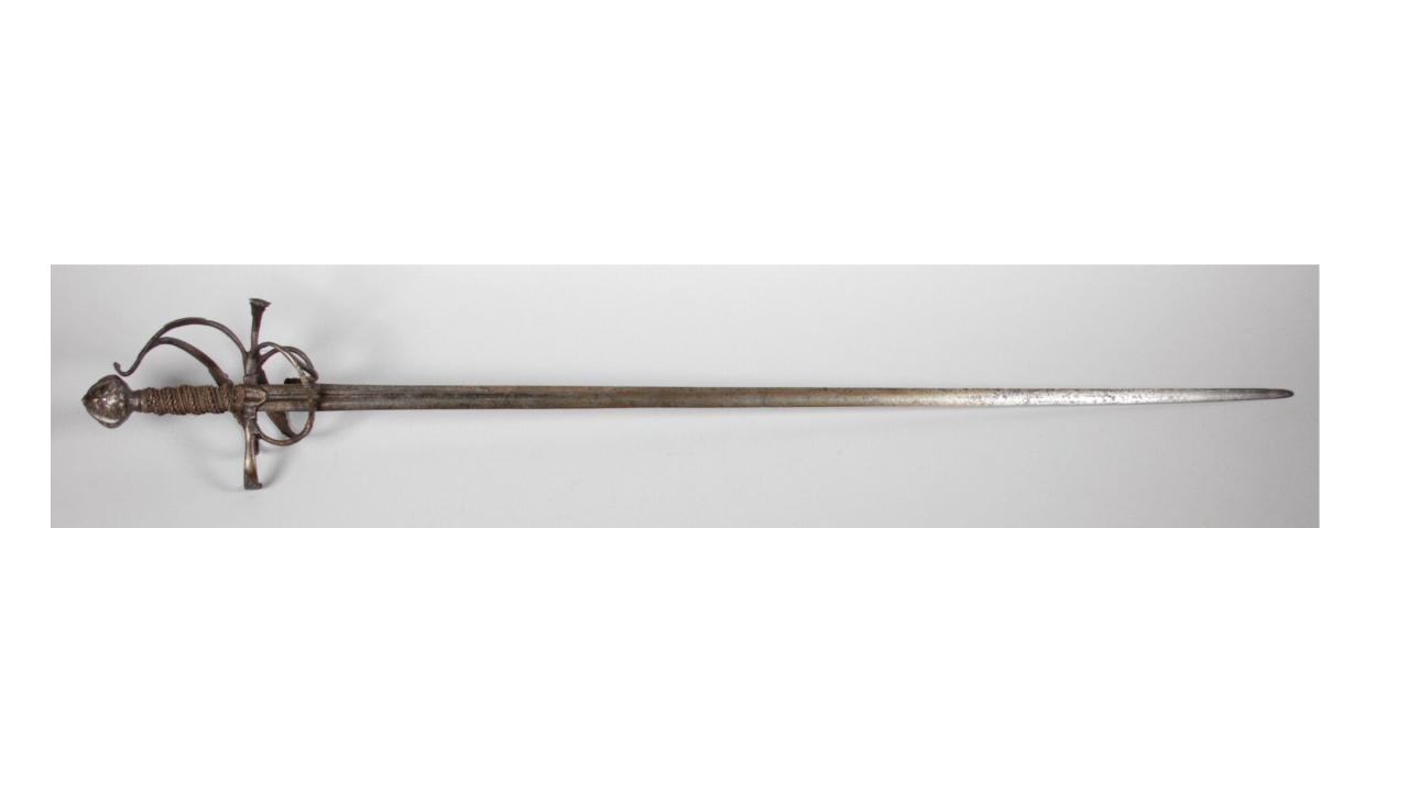

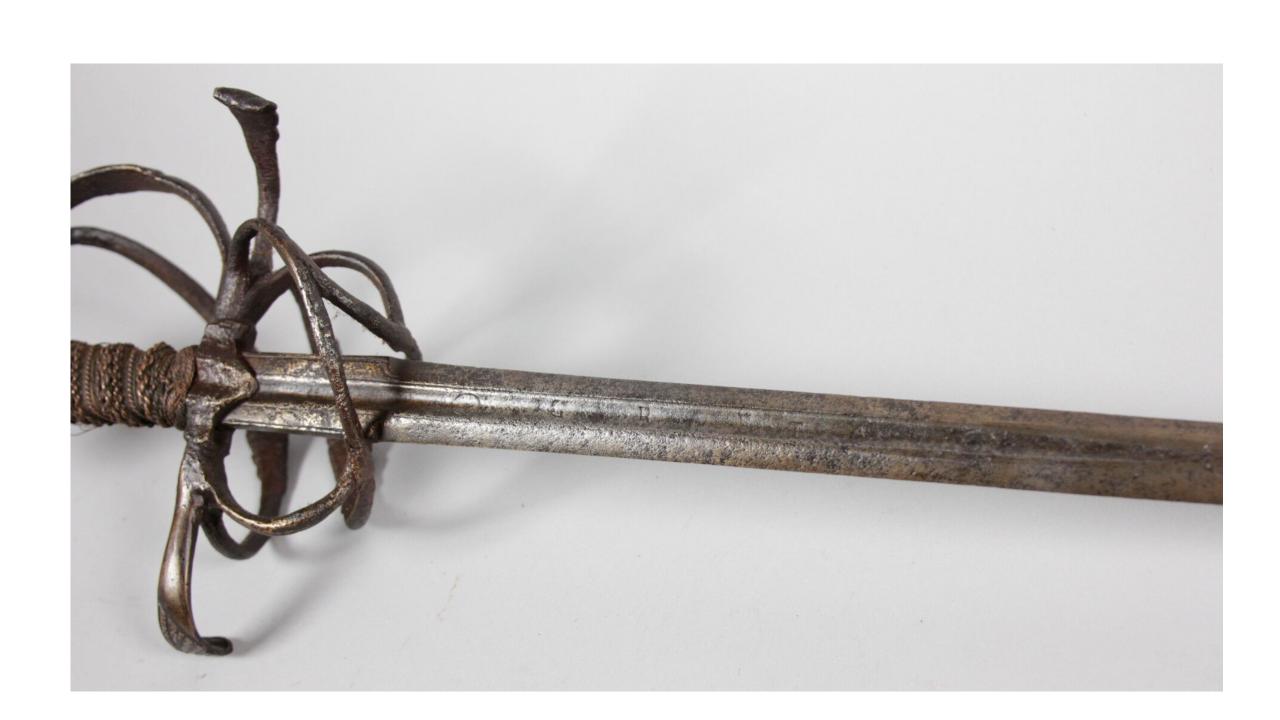

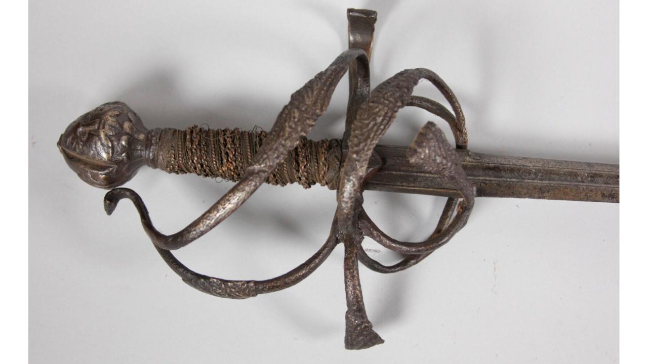

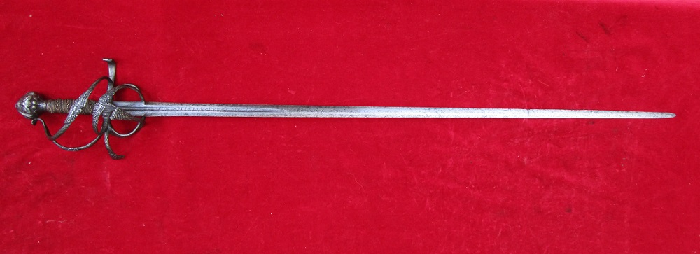

I bid on this rapier today. Alas, I did not win it (probably better for my wallet as I'm still "recovering" from the last sword I bought), but I am nevertheless curious about your comments as I am trying to learn more about rapiers in general.
It was sold as German, circa 1730 but that seems wrong to me (I would have guessed 16th century). The length of the grip gave me some pause as it seems relatively long for a rapier (although I find the proportions aesthetically very pleasing). The markings seem to say "Pedro Dei" or "Pedro Del" on the one side but I'm having a hard time deciphering the other side. Another thing I thought was interesting is the pommel decorations. It looks like a green man face? I've seen a lot of those on mortuary hilt sword guards but not many on rapiers.

To me this is a nice authentic rapier circa 1630-1650. Iron cutting was popularly done in Italy (Milan). I saw it too, but it's in poor condition.

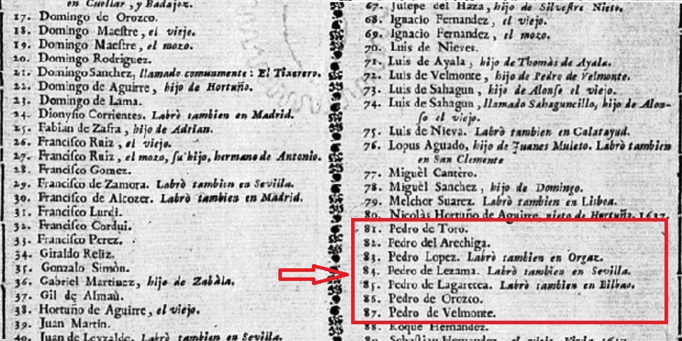

Why not Spanish; by one of those Toledo smiths ... like PEDRO DEL MONTE .
True, but the condition isn't terrible, and "a bit rusty" is probably the only kind I can afford for this kind of sword. And apparently not even that (I was not all that close)! }|:oP
Why not Spanish; by one of those Toledo smiths ... like PEDRO DEL MONTE :o.

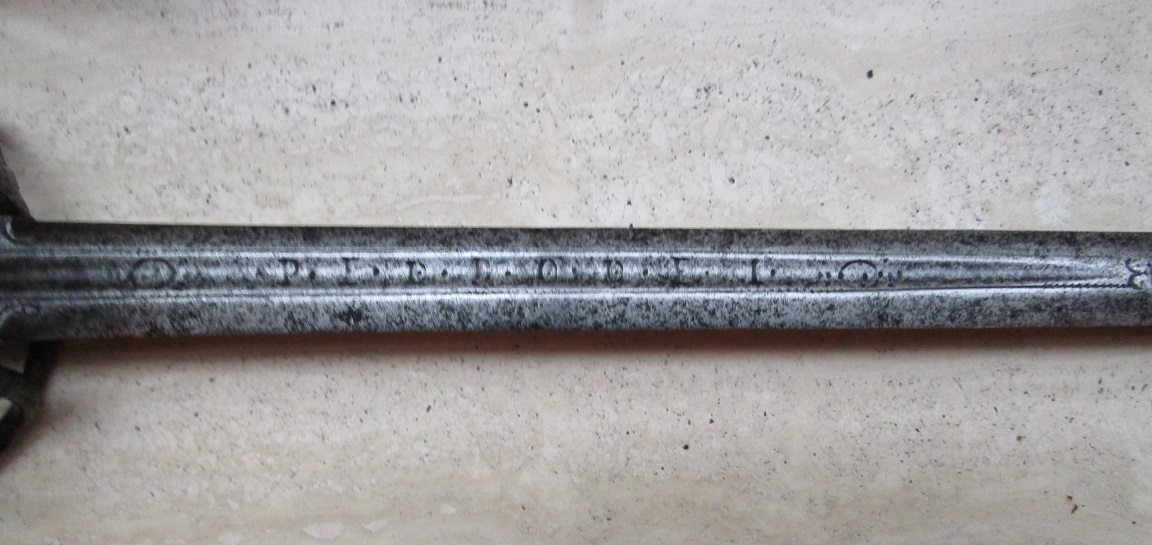

I thought it might be a reference to Pedro del Monte or even Pedro Hernandez, but there is no last name it seems, or at least I can't make it out. I can't make heads or tails of the other side. Those oval (eye?) shapes do look a little more familiar although I can't remember where I've seen them before - the closest ones were Italian marks I found on a thread on this forum (which I can't seem to find any more now), but they have another line of "lashes" surrounding the "eye".
Old 23rd April 2022, 07:58 PM   #5
Originally Posted by werecow View Post
... I thought it might be a reference to Pedro del Monte or even Pedro Hernandez, but there is no last name it seems,
There should be some written stuff in both sides ... as usual. Something like PEDRO DEL in one side and MONTE EN TOLEDO in the other.
But i am only guessing on the name, of course.

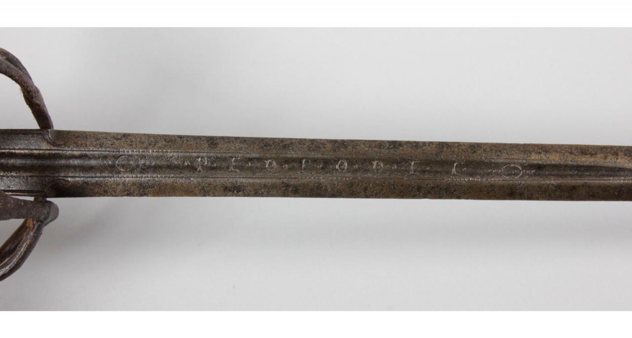

There is writing there (3rd picture) but all I've been able to make out is G R ET (or I suppose with a bit of imagination it could be a degraded "FECIT") and I'm not really sure about any of it.
True, but the condition isn't terrible, and "a bit rusty" is probably the only kind I can afford for this kind of sword. And apparently not even that (I was not all that close)! }|P
I agree, the condition isn't all that bad, it would have benefited from a reasonable amount of cleaning and ended up looking a lot better than when it left the auction house. The trick is to stop the active corrosion and remove accumulated dirt, while retaining as much of the existing patina as you can. A slow and conservative approach is far better than fast and aggressive, a lot of collectors use inappropriate methods and ruin pieces with overcleaning.

Default PEDRO DE GARAETA ... XVI century.
So ... looking better at the 3rd picture, it should read GARAETA, a Basque smith name mispelled by Palomares as Lagaretea.
"Este hecho se produce especialmente en el caso de los de raiz vasca, como Pedro Lagaretea por Pedro de Garaeta"
He is reported to have worked both in Bilbao and Toledo.

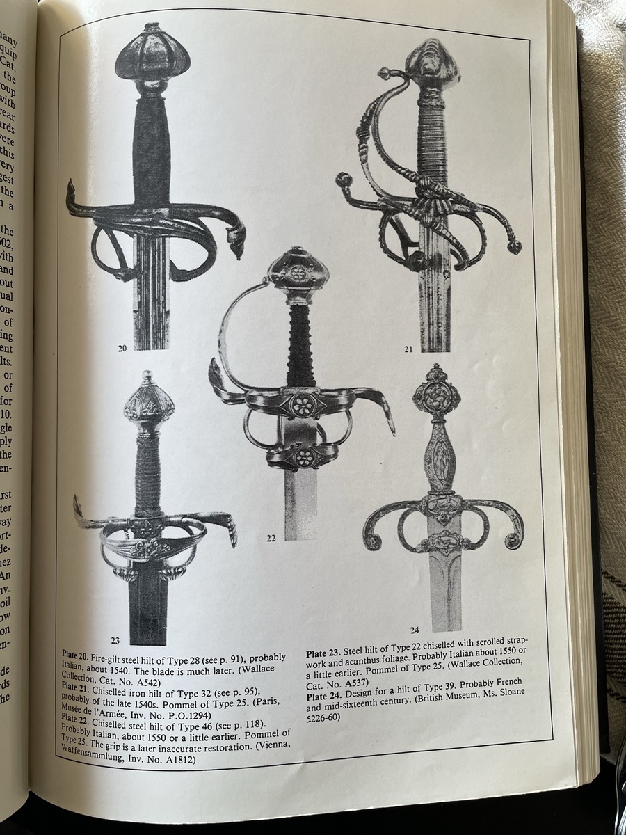

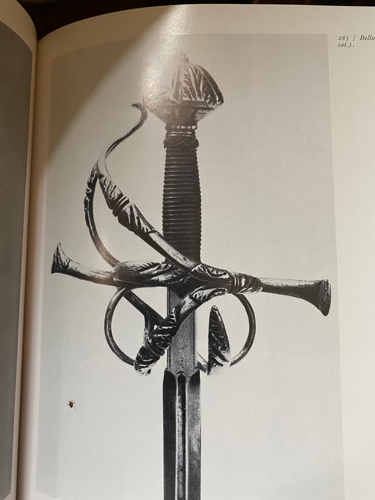

What a coincidence, Iam from Leiden and I was bidding on this rapier yesterday afternoon, bought a hunting sword so we can combine shipping :-)
I stopped at a certain point because I was not sure if there was a crack at the quilon near the ricasso block, It may be ok, it was not clear on the photos
nevertheless concrats the rapier is beautiful, early and rare.
The Rapier is Italian 1540-1560, Norman Type 32, if you have the book have a look at plate 21. there are similar examples in the Met , the wallace collection and stibbert museum.
@ Fernando yes I came also to PEDRO DEL.........AGARETA
Ah, so there's a third Pedro! The plot thickens. I had heard of the other two before but not this one.
Ha! I knew you were Dutch from lurking on the forums for a while, but I had no idea you were from Leiden. Small world/country!
Thanks for the reference, that's a pretty close one, as is the one in the Norman book. Which book is the one you posted the screenshot from?

Il museo Stibbert -Boccia book 3 **
@ merenti
the rapier and small-sword 1460-1820-Norman and Barne

It is indeed mid 16th c and very rare as it is, its even more rare to find it in a condition like this uncleaned and unmolested . For rapiers or swords this rare the condition matters less than items you can find in better condition.
I mean if one would decide to wait untill a better one come's along that is also for sale and all original like this one , it could be you would need to wait longer than the swords age itself.

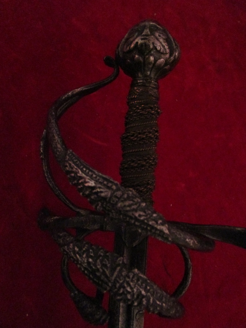

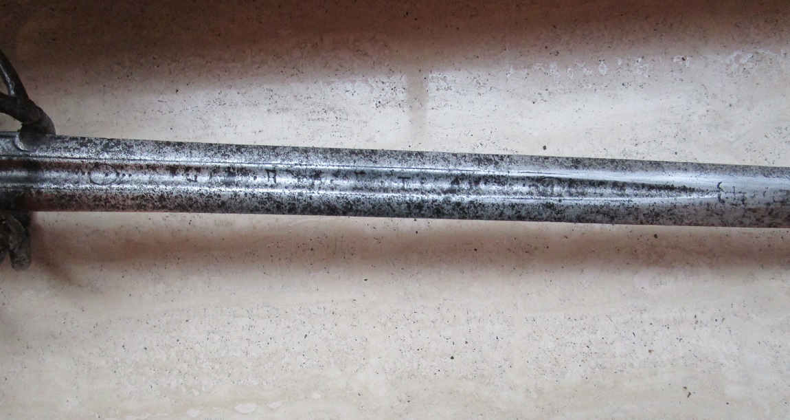

After some carefull cleaning I can confirm it is indeed PEDRO DEL GARAETA.
The condition is good enough for me condsidering its age.
More important its complete not missing anything and the blade is still at full lenght, including original gripwire. There are not that many of these around either.
kind regards
Ulfberth

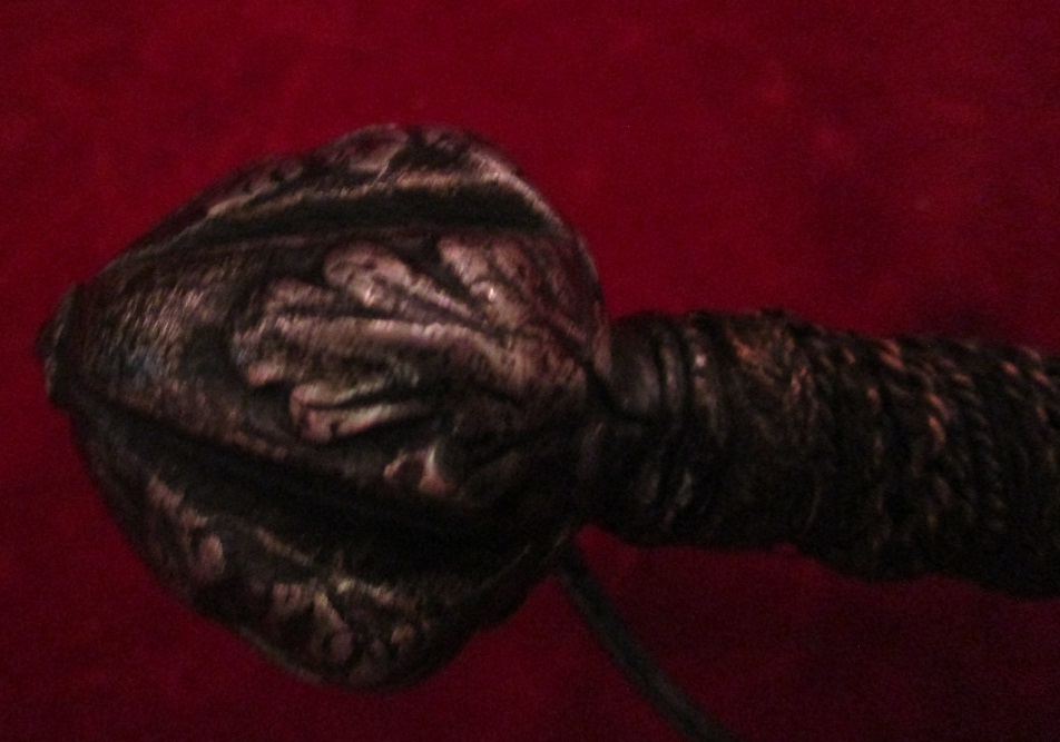

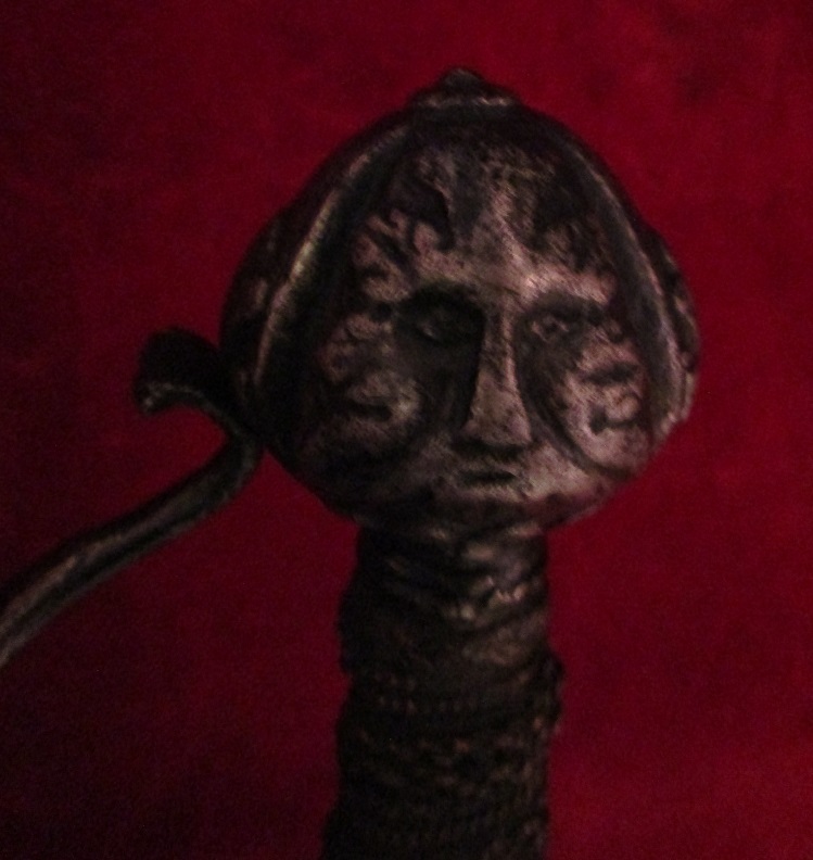

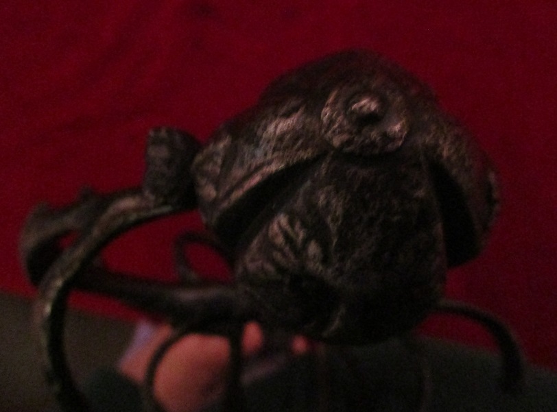

Very nice piece ulfberth. Congrats! I should've known someone from this message board got it. Very jealous.
Is that indeed a green man on the pommel?
Old 24th May 2022, 02:57 PM   #20
ulfberth
Join Date: Jul 2014
Posts: 447
Thank you for you'r kind words Werecow !
Yes I believe it is " the green man" although a bit with a brownish black tan.
Now that you mention it, I have not seen this type of pommel with the green man on it before. Although it's not an uncommon type of decoration, it appears hilts to and suits of armour from the same period.
I did no know there was a collector who collects rapier this period in Leiden either. Here is a better picture taken in daylight, im not a good photographer certainly not with an 80 dollar cam.
Kind regards
Ulfbert

The Green Man is a human face, or sometimes a full figure with leaves for hair and often wrapped in vines and foliage. It's very common in church carvings from the middle ages and a Victorian era author used it as the basis for a theory of hidden pagan cults hiding within the medieval church. The truth is we have no idea what it symbolized to people of that time.

All my plants eventually do that, so it's fitting.
Yeah, I've mainly seen it on mortuary hilt guards.
