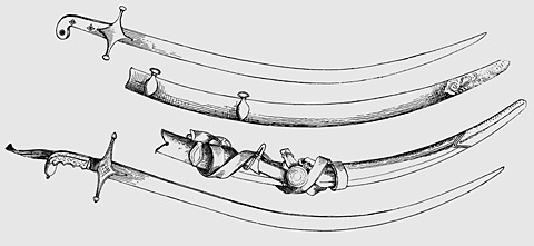

Details from plate XV of Lord Egerton's Indian and Oriental Armour (1896). Above is #757, described as a "shamsher" having a Damascus blade, buffalo horn hilt and gold mounts and its scabbard, described as blue velvet with gold damascened mounts. Below (and reversed in this representation) is #659, attributed to Peshawur, and described as a "shamsher" and noted as having a Khorassan blade and hilt of ivory and gold damascened steel and a scabbard of embossed leather.

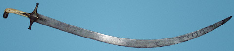

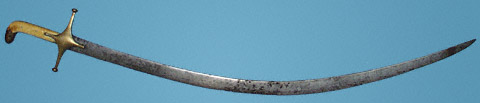

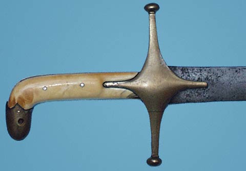

Example 1. A very well worn and frequently rehoned shamshir of Persian form, likely 18th or 19th century. The blade is made of wootz or "true Damascus" steel, with a fine pattern only very focally visible on a blade which shows evidence of having been bent and restraightened. The guard assembly and pommel cap are made of bronze, over which, very focally, remains of gilding can be discerned. The grip consists of two blocks of yellowed ivory which have a rounded square cross section in the area by the guard which includes the reflection of the langets and increased thickness beyond this towards the pommel cap. Gilded bronze strips, not visible in the photographs, cover the interval between the ivory hemi-grips where the tang lies. The sword was reputedly brought from Saudi Arabia by an oil field worker. Overall length: 95 cm. (37.2 inches); blade length: 81 cm. (31.8 inches).

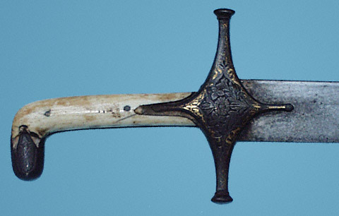

Example 2. A shamshir of Persian form, likely 18th or 19th century. No evidence of a pattern may be discerned on this blade. The quillon block or guard assembly is made of iron, over which remains of gilding can be discerned. The grip consists of two cheeks of bone, which are likely later replacements, and is thicker than it is wide. Well patinated strips, not visible in the photographs, cover the interval between the bone hemi-grips where the tang lies. Overall length: 94.5 cm. (37 inches); blade length: 81 cm. (31.8 inches).

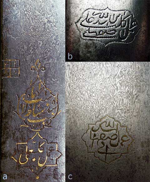

Shamshir inscriptions against a background of true "Damascus" or wootz steel.
a.
is from a dagger blade which has been formed from a cut down shamshir blade. The cartouche forming the lower part of the gold inlaid inscription may be read as amal Kalb Ali and translated to "the work of Kalb 'Ali" while the upper portion of the inscription appears to read 'Abbas bandeh shah i velayat and refers to Shah "'Abbas, servant of the Lord of the World". The inscription is dated 181 or 1181 AH which corresponds to 1767 - 1768 AD, nearly two centuries after the reign of Shah 'Abbas of the Safavid dynasty (1588 - 1629 AD) and the lifetime of Kalb Ali or his father Assadullah of Isfahan. In the upper left is a square, or Bedouh (or: Bedu), with 4 sections, each with a character, which is a characteristic talismanic device.
b. is from example 3 below; is executed in a very different manner as a series of very small punches and may be translated as "the work of Kalb 'Ali, son of Assadullah of Isfahan".
c. is from example 4 below and is gold inlaid and may be translated as "the work of Assadullah of Isfahan".
The assistance of Philip Tom and Rand Milam in translating and interpreting these inscriptions is gratefully acknowledged.

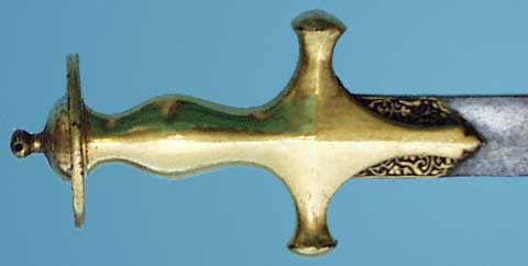

Example 3. A shamshir with a typical Indo-Muslim hilt of Delhishahi form, likely 18th century. Many authorities would classify this as a talwar based upon this hilt, which is of iron covered by a thick layer of yellow gold. A false ricasso in the form of two plates with an embossed and gilded intertwined floral pattern may be seen behind the langets covering the root of the blade. The blade is of wootz steel and bears a gold inlaid Arabic inscription on its spine, likely a religious invocation or prayer. A cartouche with inscription made as a series of small punched marks is present and is illustrated and further described above as b. Overall length: 92.5 cm. (36.2 inches); blade length: 80 cm. (31.2 inches).
Hilts, while exhibiting a multitude of local variations of form and greatly variable styles of decoration, do retain a core of common features. The quillions (crossguard tips) may exhibit a number of styles: moderate length with rounded button like terminals in the classical Persian style (see #1 and #2 above), stubby and bulbous in Indo-Muslim varieties (as with #3 above) and longer and more drawn out in Arab and Turkish examples (see #4 below). The quillions arise from a centrally thickened and convex crossguard assembly from which integral langets also almost universally arise and extend towards the blade's tip. The langets vary in bulk, often being more delicate on Persian influenced examples and more robust on Indian types. Aside from their obvious assistance in seating the sword in its scabbard, some authors posit a role for the langets as sword catchers or breakers in combat, but such a role seems unlikely for those more delicate hilts crafted of softer metals. A metallic grip is integral to the crossguard assembly in the typical Indo-Muslim hilt, however in the more Persian influenced varieties a symmetric reflection of the langet extends into an inletted area on the grip, which may be formed of two cheeks or blocks of material such as ivory, bone or horn which are riveted into place. Indo-Muslim hilts may rely entirely upon adhesives for attachment to the tang, while in Persian examples the crossguard assembly will be secured by adhesives and the attachment of the grips supplemented by rivets. While tangs may extend the length of the hilt, they are also often shorter. The wire wrapping over the portion of the grip adjacent to the crossguard, seen most frequently on Arab variants, but not entirely lacking in Indian contexts, most likely originated as a reinforcement of an area of the hilt most likely to experience early failure. In swords of classical Persian form, beyond the width of a single hand, the grip turns at roughly a right angle to the axis of the hilt in the direction of the edge. This short extension is covered with a pommel cap, usually decorated in or complementary to the style of the crossguard assembly. The angle and length of this pommel may vary such as with the longer pommel cap arising at a more acute angle on the likely Syrian Arab example (#4 below) or in the form of a bulbous expansion on Turkish examples. In some Indian examples, a knuckle bow will arise from the quillion on the edge side and extend back towards the pommel; a similar function may be served by a chain with Arab styles. The hilt may terminate as a beast's head on more luxurious examples, and such luxurious examples may adopt unique forms beyond the scope of this discussion of the basic characteristics of working grade weapons.

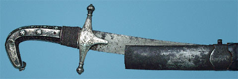

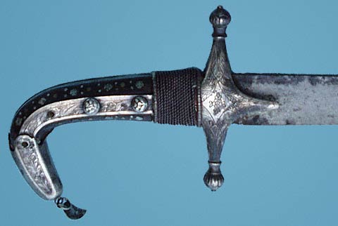

Example 4. A shamshir or Arab saif of Syrian style, the mountings likely 19th century; the blade possibly earlier. The blade is made of wootz or "true Damascus" steel, with a bold moderately complex pattern and has a gold inlaid inscription illustrated above as c. The quillon block and pommel cap are made of hallmarked silver engraved with foliage. The grip is of horn, thicker overall than the width shown in the picture. Four silver strips opposite from and at right angles to one another cover much of the grip and the areas of exposed dark brown horn show small silver and brass inlays. The end of the grip turns at an acute angle toward the edge to form the pommel. A tear shaped silver dangle is attached to the tip of the pommel cap by a loop. The scabbard of this example is of the Turkish fashion in that the scabbard is slit from the mouth along the spine side for about 12.5 cm. (5 inches) to allow the sharply curved blade to be withdrawn. Overall length: 91 cm. (35.7 inches); blade length: 76.5 cm. (30 inches).
