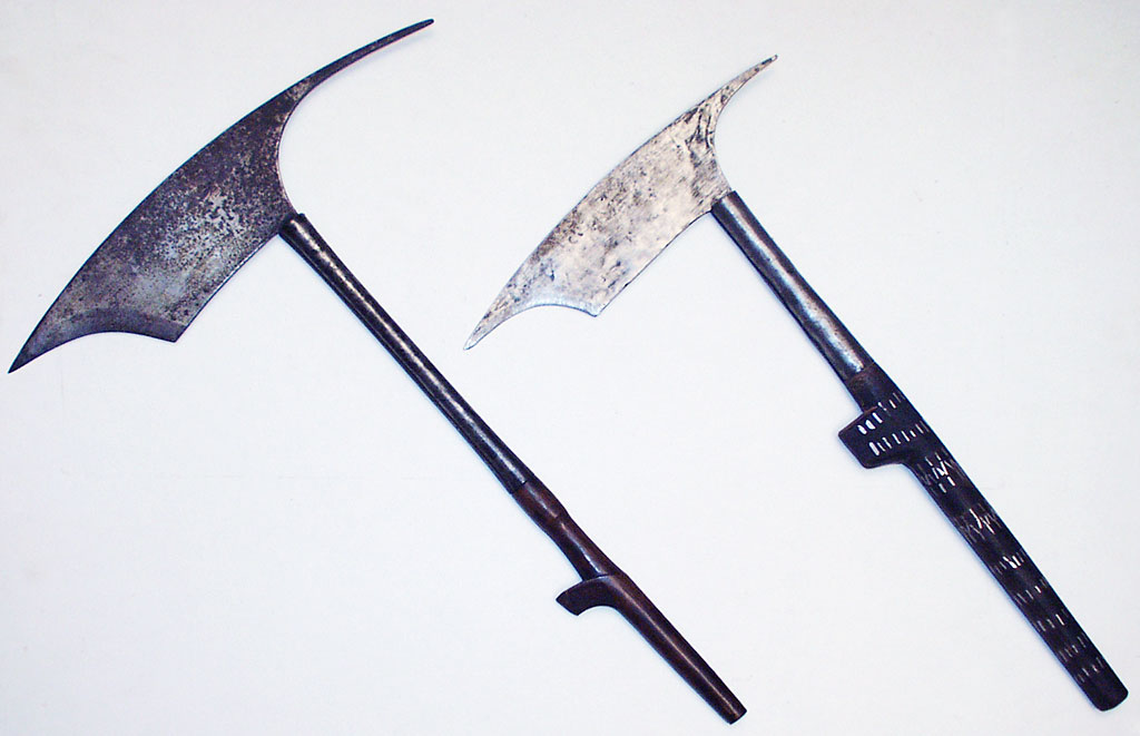

Left: An authentic Igorot "head-axe" from the Luzon highlands. The overall weight is 590 grams and the blade varies in thickness with multiple tapers, up to a maximum to 4.6 mm. Well forged and finished with a hardwood haft displaying varying cross-sectional areas and carving with crisp definition.
Right: A tourist-grade axe sold along the roadside near Banaue in 1974. The overall weight is 390 grams and the sheet metal-like blade is a uniform 2.2 mm in thickness. The soft wood shaft is simple in section, crudely carved and decorated with aluminum inlays.

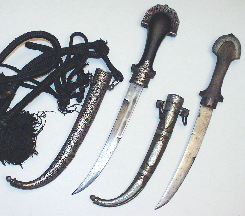

On the left, an antique koummya mounted in well-worn hallmarked silver of good quality and with a silver trimmed well smoothed hardwood grip. The well defined blade ranges up to 4.5 mm in greatest thickness.
To the right, a tourist-grade koummya (Moroccan dagger) in mountings of brass, nickel silver with a roughly finished soft wood grip. Although superficially of typical form, the finish of the blade is crude and 2.7 mm in greatest thickness.
