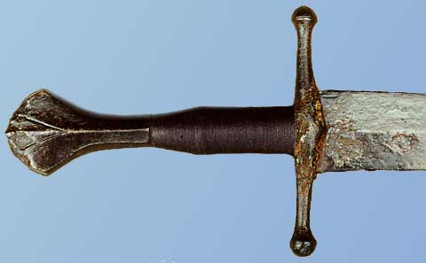

XVa: A Cut and Thrust Sword from the Castillon Find
Find place  Dordogne River upstream from Castillon-la Battaille
Collection Private
 Date 1410 to 1453 AD
 Condition Excavated, overall with mild to very focally moderate pitting; the blade solid and straight.
Literature Oakeshott (1984, 1993)
This sword is typical of Oakeshott's type XVa, which is the longer hand-and-a-half variant of type XV, adapted for thrusting coincident with the development of plate armour. Types XV and XVa may be found throughout Europe in contexts from as early as the late 13th century through to the middle of the 16th century. Characteristic of this type are blade edges tapering symmetrically as relatively straight lines from the crossguard to the tip and a flattened diamond cross-section with a well-defined central ridge running down the center of each face. In this example, the four blade facets (two to each side) are quite flat; others of type XVa may be mildly concave (or hollow ground).
The long iron pommel is of fish-tail form fanning out towards its end and narrowing towards the blade to merge with the grip. Such pommels, we learn from Oakeshott (1993, p. 12) are commonly observed in Italian and Flemish paintings from the 1420's through to the end of the 15th Century and in English effigies of the 1440's as well. The twine wrapped grip in the photograph above is a modern reconstruction; the naked tang may be viewed in an illustration in Oakeshott (1984, p. 9). The iron crossguard widens over and towards the tip of the blade and terminates in bulbous tips.

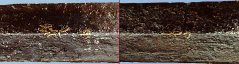

Latten (brass) inlays are present on each face of the blade several inches from the hilt; the illustrations above are oriented with the hilt toward's the viewer's right. Upon one face is a "running wolf" of Passau or Solingen (for a chart of the evolution of these marks see Wagner, 1967, pl. 81, p. 109) as well as a smaller adjacent mark of three lines more towards the hilt. On the opposite face is an inlay interpreted as representing a bishop's crosier.
