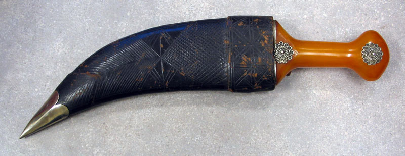

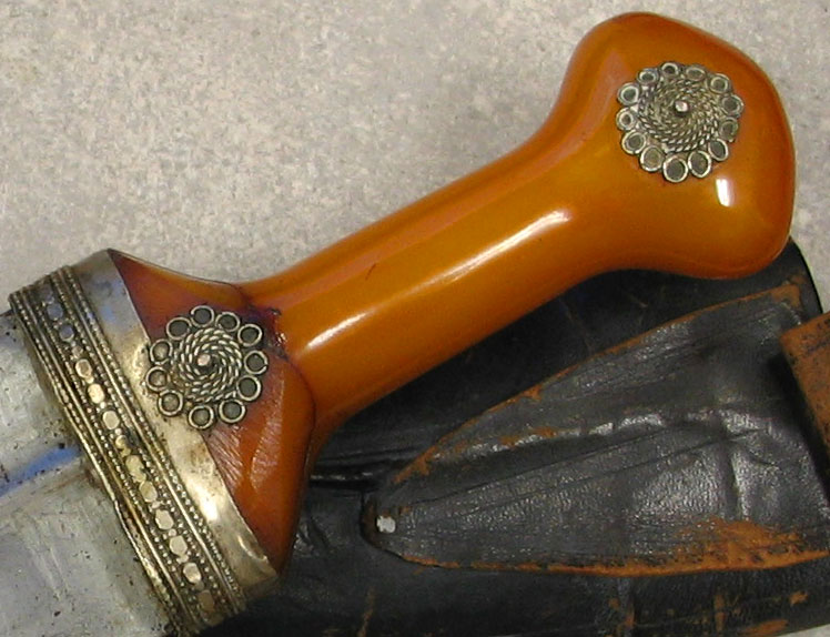

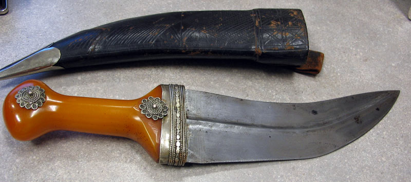

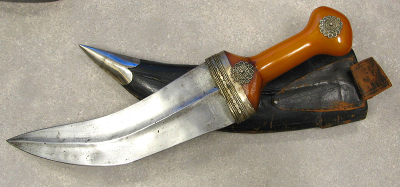

I got this jambiya recently and saw several things about that bugged me. First, it looks like an amber hilt, but I'm open to comments on this. It doesn't melt at a hot needle, when it breaks it behaves a bit like glass, but it can be filed and smoothed. It has been broken and repaired.
Anyway, as you can see the "nicer" fittings on the grip are facing the back side when it's in the sheath. the dagger looked arabian peninsula to me, but the scabbard looks very Indian. In fact, it's much like a kukri sheath in construction, design, decoration, etc. So, my first thought was that the scabbard was matched to it after the fact. But it fits like an absolute glove, so I'm just not sure.
Then I started to think that maybe when the repair was done the person reversed the silver floral-looking studs without realizing it. The thin, lower-quality coin-like studs were added when the repair was done, I believe.

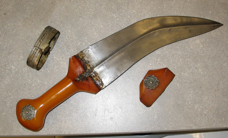

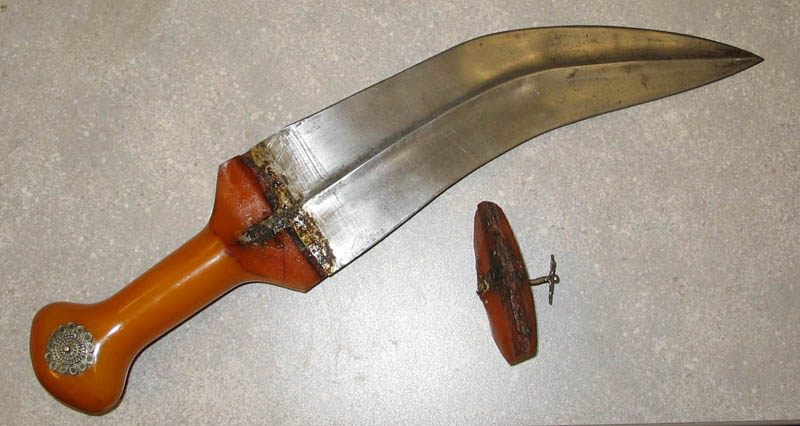

I decided to tackle it as a project. I worked all the silver loose and pulled the broken amber off, removed the blade, and wiped out all the gunk.
Then mixed up some orange acrylic paint into some epoxy (thanks Tom for that idea on a previous project). I put the blade back in, slide the silver stud and pin back through the right way (there is a hole in the blade tang for it to pass through), added some epoxy, place the broken piece back over and into place as perfect as possible, and let it set. then I replaced the rest of the fittings and polished up a few rough spots. It looks better and the repair is definitely stronger now. I still can't decide the origins of this one though.
Any thoughts?

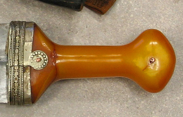

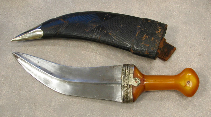

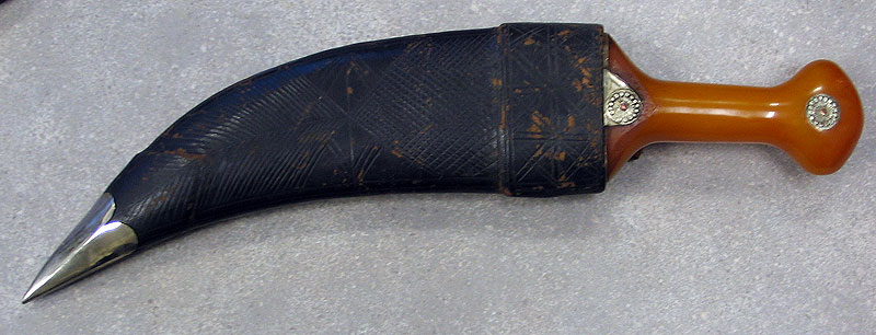

These are the "after" pics:
derek is offline   Reply With Quote

Hi Derek,
Nice jambiya, and nice work you have don't, but why don't you think it can't be from SW coast of Indian?
Jens

Hi Rick,
Good one pointing that out. I feel fairly certain about the jambiya itself being arabian, esp. with Artzi's comparable example.
However, the scabbard is quite different. The pattern in the leather, the toe (which may have been added later), the leather flap on the back with the single nail tacking it in place are classic features of many Indian kukri scabbards.
Maybe it was dumb luck that the owner found a scabbard that exactly matched?

Man, I'm not sure it's amber. The usual smell test is impossible. The whole thing smells like it spent the last 75 years sitting in my great grandmother's attic.
The needle did not melt it, so it isn't standard plastic. but it didn't crack or chip either. When you scrape it, it powders, which is consistent with amber. I'm going to burn one of the shards later and take a big whiff. Is it illegal to huff amber?

If you mean that it smells like moth balls, then that could be the camphor smell associated with celluloid, a synthetic resin used a lot 100+ years ago. In any case, amber would not smell like moth balls.
Ian.

I think it's celluloid. I've smelled real amber, and though this looks a lot like it, I just don't think it is. It has been in a smoker's home as well, but even with all the smells mixing together you're right about the moth ball odor.
Thanks for the help.

I decided to drop those shards into salty water as described in the amber test page. One is about 1/2 inch by 1/4 inch. Big enough to sink. The other is slightly smaller. I even pushed them to the bottom of the cup. They sat there - until the salt dissolved completely. Then they both popped back to the top! So now I really don't know.
