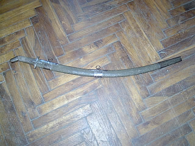

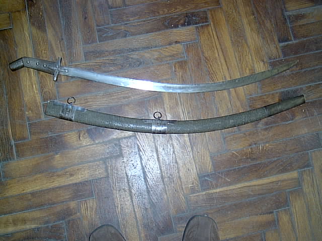

Default Tatar saber for discussion

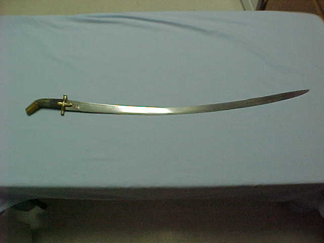

It is not often one has a chance to discuss Tatar wepons. Here is an example of a 17th c. Tatar (or Polish-Tatar as some texts would call it) saber I was recently fortunate to find.
Perhaps Wolviex will be so kind and help to narrow the age range.

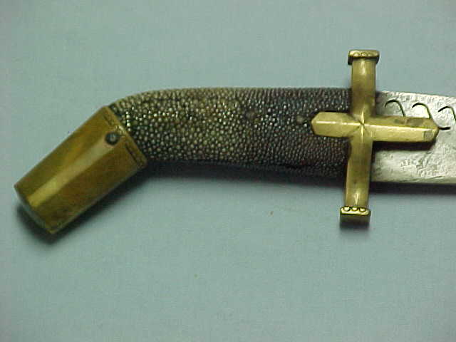

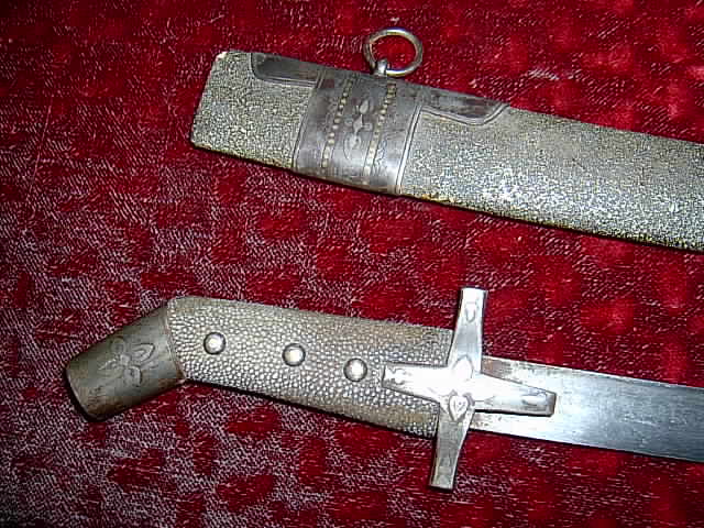

Is that sharkskin on the hilt?
Jacob is offline   Reply With Quote
Old 18th June 2005, 09:15 PM   #3
Perkun
Perkun's Avatar
Join Date: Mar 2005
Posts: 45
Yes. Held up very well too!

Old 19th June 2005, 12:11 AM   #4
Posts: 10,857
This does appear to be an example of a Tatar type sabre of the latter 17th century. While this form originated with the Tatars, it was commonly duplicated in examples made in Lvov by Armenian craftsmen, thus the term commonly misapplied 'ormianka' or the Armenian sabre. King John III Sobieski of Poland favored Eastern fashion thus he is portraited wearing one and a number of them were likely worn by others in his favor, during latter 17th century. In Poland these sabres were termed 'ordynka' (=horde) for thier likely steppes origins, or often 'czeczuga' (=small sturgeon) for the distinctive ray or fishskin grips.
These sabres are beyond incredibly rare! and very little is published on them aside from the data above which is from "Polish Sabres: Their Origins and Evolution" by Jan Ostrowski & Wojciech Bochnak, in Art, Arms & Armour, Vol. I, 1979-80, pp.232-33. Examples are also illustrated in Zygulski (p.242-43) and in "Iranian Swords of 17th c. with Russian Inscriptions in the Collection of State Hermitage Museum" by Yuri Miller (p.138, #150). In the Miller illustrations the hilt form is of this type but mounted with shamshir blade dated 1698. The mounts and hilt on yours seem consistant with the example illustrated in the Ostroski article, and it appears by the photos yours has held up quite well. Is there anything you can divulge on the provenance of this fascinating piece?
Thank you so much for posting it!!!!

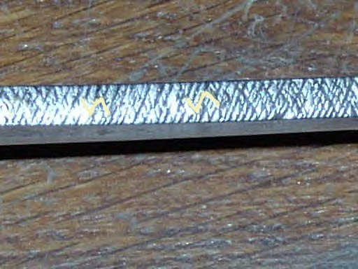

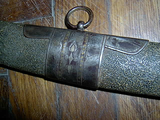

There are some markings on the spine of the blade (in gold, visible although not well on one of the attached photos). I have not yet examined the saber in person so I don't know if they are owner's Tatar tamgas or maker's marks.

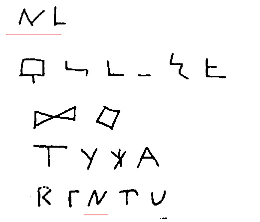

I attach images of Tamgas of Golden Horde and Lithuanian Tatars

I attach additional pics.
I don't know if the gold inlay dots on the blade could be tamgas but they are there on both sides of the blade. In one of the plates of tamgas I attached above, there is a tamga in shape of a circle.
I also enhanced the pic. of the spine by tracing over the not so well visible gold inlay there. Please check your references if you could make any sense if it.

Perkun, regarding the hilt material, it is actually rayskin (with round noduals) not sharkskin (with triangular noduals).
Nice and complete piece. Thank you for sharing it. Rsword has one, would like to see what he makes of this.

The geometric pictograms which are seen in double on the back of the blade somehow do not seem to be tamgas. Unless I am mistaken, doubling or parallel representation seems to occur more on European makers marks or native interpretations of them. However, in Caucasian regions the application in multiples of key markings or symbols does of course occur on blades.
It is known that tamgas were later often incorporated into certain Russian and European heraldic devices with varying degree of accuracy in interpretation. The geometric floral device on the guard and pommel seems to suggest certain heraldic device possibility. Many of the Polish heraldic elements of course seem to derive from possible tamga origins.
Returning to the double 'lazy n' pictogram (well, thats what we'd call it here in Texas!!, we need more research, but at this point to me it does not seem to represent tamga. Possibly researching tamgas further might reveal such 'double tamgas'.

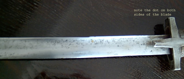

The gold or brass inlay dot in the blade. It seems that such dots or varying symbolic marks were often placed at strategic locations on blades in India, in the case of this sabre referring to the location at the base of the apparant step in the blade back. It is yet unclear what such symbolism may imply, but the placing does seem strategic, thus some inherent meaning is distinctly possible. Again, it does not seem to be any type of makers mark, but some sort of key symbolic application.
I hope this is considered relevant, but, I recently read this in "Islamic Swords and Sworgsmlths" by Dr Unsal Yucel on Page 57 while describing Umayyad and Abbasaid Swords
'The majority of these swords have somewhere between one to seven gold-filled holes, generally located on either side of the inscription and sometimes at the tip. These golded filled holes were made by riveting a piece of gold into a hole in the blade. They are usually level with the surface of the blade and approximately 5mm in diameter. It is thought that the purpose of these gold rivets was to bring good luck to the swordman'

This type of mark seems to be common, almost worldwide; it is common on medieval European knives (not so much swords), often in silver, copper, etc. I believe in Europe it was usually soldered in place, with peining being optional. Also seen on medieval European knives were grooves filled with contasting metal wire. I have no established meaning, but it's common; seen in China, SE Asia, India, Europe, and in a thread on a spear we just saw, N Africa (?) Some variability from culture to culture as to size, number, placement, affixing method, and even shape, but a widespread interesting phenomenon.
What is the relation between that "step" in the back and the crosshatched part of the spine? Is it hatched out to that? Then what happens?

As a matter of fact it was exactly in this fashion ("a gold filled hole") that this mark was described to me by my friend who personally examined the saber.

As to the spine markings if we rule out tamgas then a possibility of them being an Armenian maker's marks should be examined, perhaps it represents the letter "h".

I agree with Jim that neither mark on your sword is a Tamga sign. The "S" shape on the spine is very similar to marks on my sword blade. Mine are found at the top of the blade on both sides just below the spine. My example has 21 of these marks down each side of the blade. If one looks closely, in example 68 in Gutowski's book, that blade has a similar "S" shape marking along the top of the blade near the spine. I believe all the crosshatching on the spine of your blade contained many of these "S" shape marks but it looks as though many have worn away over the years. I do not know what these marks could represent as the example in the book looks to be a Persian imported blade, yours is undetermined as of yet, and my example seems to be of Lvov manufacture.

Fugh, I'm not an expert on turkology, so it can all be bs, but:
AFAIK tamga is usually just a signature. Turkish writing evolved from hieroglaphic to alphabet based, and so did the tamgas. There are 3 types of tamgas - consisting of one symbol (Type I). Usually these are the old ones, correspond to pictogramms or hieroglyphs. Very often have a totemic (or animistic) symbolism.Type II - tamgas consisting of two symbols that are symmetric or anti-symmetric to each other. These tamgas usually have to be understood as a combination of individual characters forming a word (with some of the vowels, especially initial vowels omitted). Why turks specifically liked symmetric writings (like swastika - two letters "a") I don't think anyone knows. The third type is tamgas composed of completely different letters, again these are already writing using an alphabet.
Concerning the first sword - these symbols can be tamga, or they can be not, I don't know. However in turkish alphabet this lazy n is usually "t" (however sometimes m or if looked from a different agnle -o and dz can be written quite similarly). Example - attached is an example from Karachai (turkish tribe from northern Caucasus).
Conerning the second sword - that's a classical tamga, probably modified Type II (symmetric with respect to one axis, anti-symmetric with respect to another). The letters involved seem to be "a or ae" and "n".
I'm not an expert in tatar to know which word exactly they coded like this...
Concerning family names - nothing comes up immediately, unfortunately because the letters are very popular ones, there are dozens of tamgas that use at least one of these letters + something else - for example a circassian tamga on the second picture, but did not yet find something exactly like this.

Another lazy n (this time it's "m" ?). From the writings of ancient bulgars.
And one more thing - eastern turks (I guess our tatars ?) write from right to left. Western (bulgars etc.) from left to right.

Hey, thats an interesting note Jeff, I too noticed this thing with the gold rivets. Could there or is there a relation between those 8th century swords, and this saber (in relation with the gold spot)?

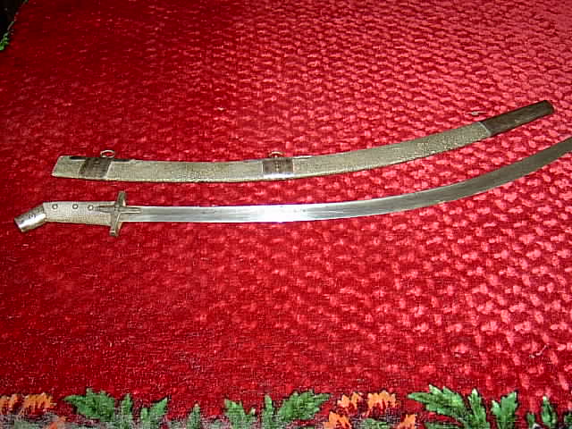

I didn't want to say anything until I was sure I could find this one in storage. Tatar saber with Persian blade.
Enjoy.

What a surprise! Could you tell me more about it, age, region? What is the scabbard covered with?

Hi Perkun,
It has a similar story as yours. Most likely made in Lvov 18th century. The blade is clearly Persian with a very nice wootz pattern. The scabbard is wood with a later leather recover. the mountings are brass.
