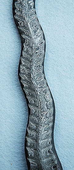

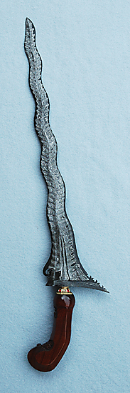

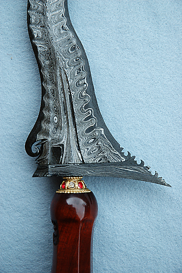

Hi all, I'm currently making my dream keris Balinese 19.75" long, dapur Pasopati, wos wutah/ngulit semangka pamor, 12 meteorites, 30 irons (Roman to 1900) 4" wide at the gongo (third attempt gongo! ) 5/8" thick.
Kiai-many thanks for the vote of confidence, but I wouldn't call myself an mpu (or a master), just a crazy Englishman who likes making keris.
Sneak preview below.... It no longer has this gongo, made a right mess of it!!

Lemmy,
I think you need to start taking orders soon!
J

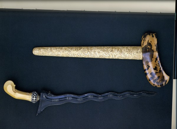

I am lucky ! my dream keris exist :
A kris Nagakresna,XIX century, Surakarta.
Page 161 of court art of Indonesia
A beauty !
Michel

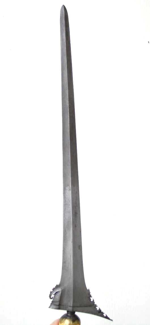

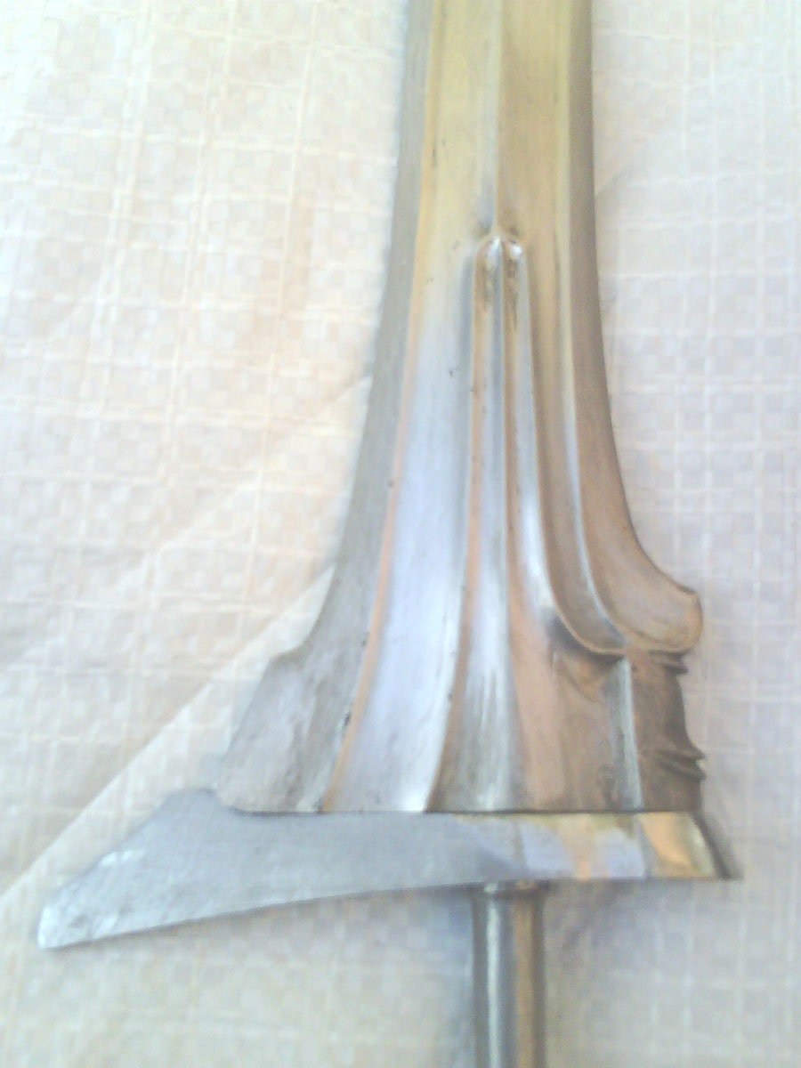

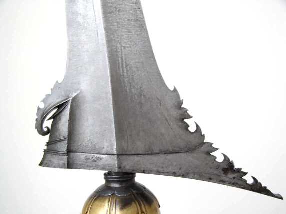

That it precisely what I meant. - No existing kerises are allowed. On a perfect world I´d like to acquire something like a fusion of sorts between these pictured on Mr. Maiseys website.
I have no idea what such beast would be like but these kerises, especially the two on the middle, rock my boat hard so to speak
Thanks,

Bram, I took all these pics, and all but one of those keris are still in my possession.
Yes, the pamor is pretty close to what you see in the photos. Much of the result of what you see is in the technique I use to take the photos; I use natural south light, I am particular with the quality of the light and if a pic is important I wait until that quality is right. I use a tripod and remote release, very slow shutter and a small aperture. Sometimes I forget the small aperture and use the mid range aperture that the lens performs best at. Everything I use is simple stuff that anybody can do.
The blades have been correctly stained. Pak Parman did his own, Pak Pauzan's and Mas Budi's were done by a commercial stainer in Solo, I did the blade that I made. The stain job that I did took me several attempts and several days before I was happy with it.The material in all the blades is iron and pure nickel.
So what you see is a due to a combination of care and correctness.
As for the appropriate pamor for a dhuwung Australie, it could be no other than pamor ron kulahbah (once a jolly swagman sat by a billabong,under the shade of a kulahbah tree)

In dreams "miracle occures"!
Should I think of modifying the beautiful kris I have shown ? I think that before I could make a valid description of what should be done to this kris, I would have to study all the elements of the keris (blade, grip, sheath, etc) and be fully embedded in the kris culture and this would take the better part of 25 years of study. Some of you guys are, may be, at that level of knowledge and understanding of the kris culture ( Alan ?) but I am very far from it.
But there I have a piece I can look at, its virtual in a sense, but it does not require that I draw it, forge it, file it, etc. I can just look at it and admire the workmanship of the artist(s) who made it. I do not think one can cumulate the most beautifull parts of several krisses to make one perfect assembled kriss. It would not be balanced.
So please let me dream of my beautiful keris !
Michel

Because there is no way I could play by the rules, of figuring out a keris that would be my dream keris. I am not an artist who can create from nothing an object, which will be an art piece. I need example, something I can base my ideas on and develop from there with sets of rules. If I do not know the rules, I will be in trouble developing anything.
Mastering the rules of the keris, is something that Alan and may be you, have done but not me. Alan having learned and worked many years under the guidance of Empu Suparman Supowijaya is probably capable of describing a keris that would suite him. He has done it in his December 13 description but with all respect for Alan description, I cannot see his keris, I cannot visualise his description. Ferrylaki did the same, I cannot see his dream keris.
Kiai Carita did the same, quite precisely, but still I cannot see what he dreams of.
Do I care about the origin of the nickel, if it is meteorite or from a bicycle ? Absolutely not !
The pamor, yes I do love the example I have shown, neat, precise, discreet, not flashy but elegant.
Doest it mean, that this example is “THE Kris” for me ? No, it is the one that I have seen, that pleases me most.
Does it mean it is the one that would best fit my Personality? I do not care, this aspect of the keris culture goes far beyond my understanding and ability to admit a reciprocal influence between the keris and the personality.
