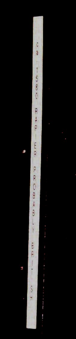

Let's raise the stakes. I'm throwing you guys this tasty morsel.
Best
Manuel

Victorian re-hilted German 16th c. blade?
Ed is offline   Reply With Quote

....possibly a 1580 Rapier....British

No, seriously, you guys think it truly can be late 16th C.? It's gorgeous, I salivate everytime I hold it....

To continue with my rampant guesswork and speculation, I guess the blade could be the real deal, but that hilt looks fishy. Maybe not the oddest I've seen, but nothing I'd dare stamp as authentic on my own.
And while manufacturing dates aren't contagious, the fact that it seems to be in the same batch as the Executioner's Sword and the Bastard isn't exactly a good sign.

Frankly, and I mean this in a constructive way, the hilt looks like it belonged to a bouncer in a bordello. An old bordello perhaps, but a bordello nonetheless.

Or as Mr Sherlock Holmes has said..."“There is nothing more deceptive than an obvious fact..." Who's to say the label on the sword is correct though....

The blade *could* be genuine 16th - 17th c., but better pictures (short of direct inspection) would be needed. For the hilt, my bets go to "modern" (19th-early 20th c.) on stylistic, decorative and construction grounds (I agree with Ed in that there's a certain degree of... "pimp-ness"... in it )

The blade looks ok to me but, my dear, that hilt.
You know, if it were cheap enough, I'd think about buying it, loosing the hilt and displaying the blade.
