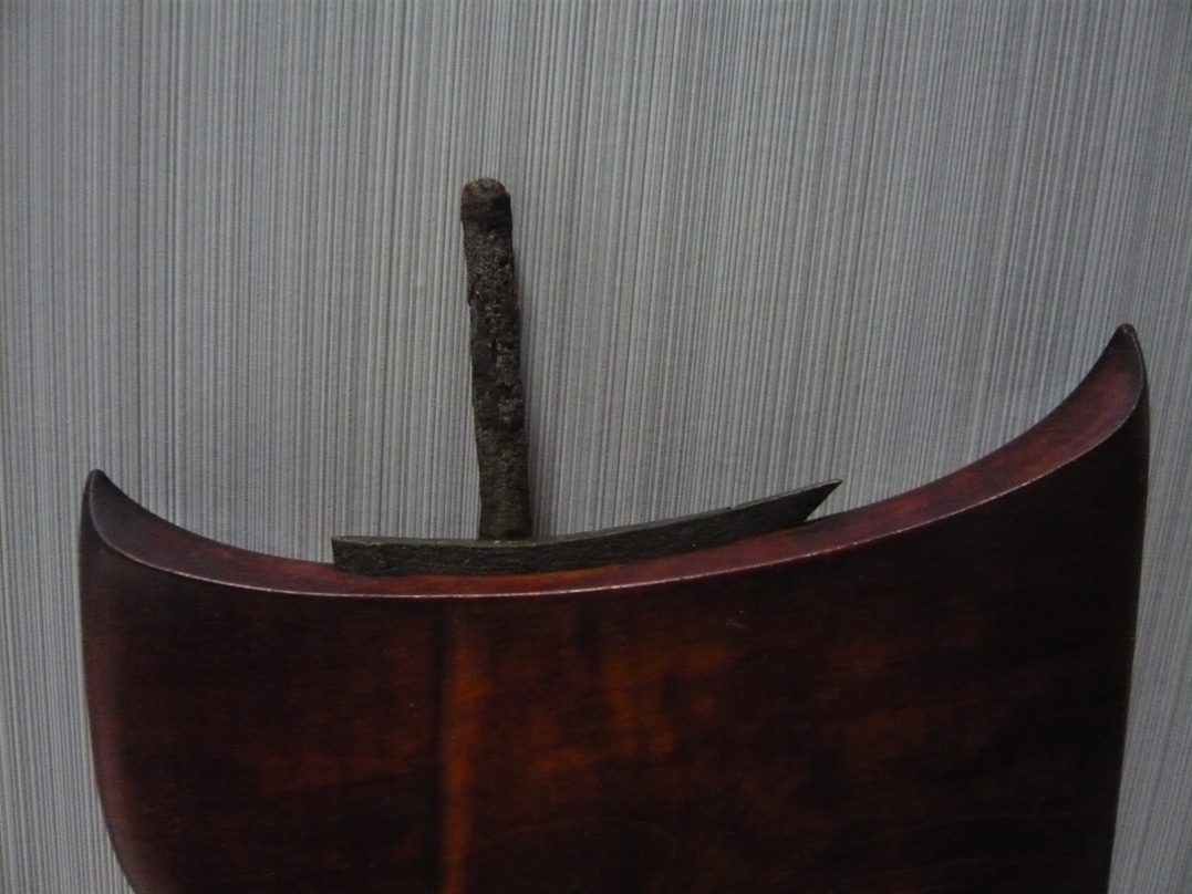

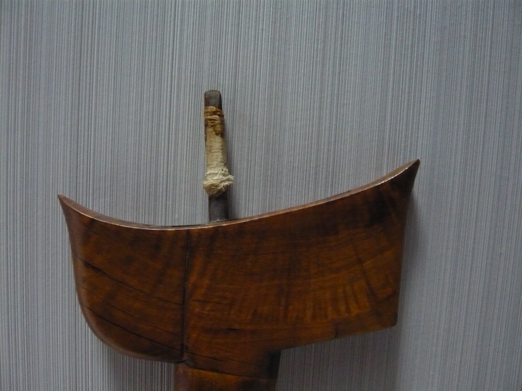

I recently bought what I think is a Bugis keris. Unfortunately without sheath, but it's still a nice piece.
The position of the handle looked a bit 'akward' to me. I had quite some trouble getting it off the blade. The peksi was bent.
I was able to straighten it without causing damage, but now I'm wondering what would be the best position of the handle for this type of keris.
I'm sure some of our keris-loving forum members could 'enlighten' me.
Here are some pics : first the piece as I got it, secondly a pic of the 'bent' peksi.

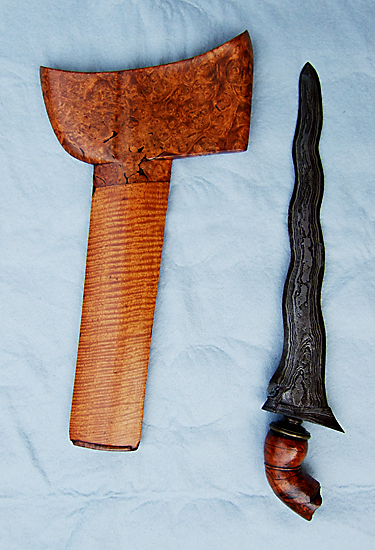

Hi Fredy,
I do also think it's a bugis from sulawesi, but im no expert. But stil i can see the garuda on the sorsoran(V shape). I have one like it, but without luk.
Her a pic, how it's mounted.
You have to twist the hilt till it is in comfort in your hand. I hope it is clear for you, iff not tel us and one of us wil try to help. One knows a bit..all know a lot.
Regards and congrats...nice blade and willah. Maybe someone can help you with a sheath(sarong)...try out and you wil know.

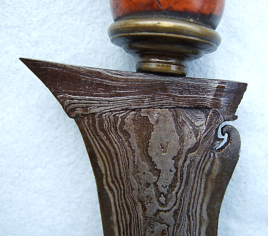

I have two of these keris, David.
One has the end of the grip broken off , making it considerably shorter in the grip. (pictured)
One of these keris belonged to my mother's father, that is, my grandfather, and he brought it to Australia around 1920.
The other one I bought at an arms fair.
I have taken both these keris apart, and both had the grips fixed in the reverse position with damar, I needed to heat the blades to remove the hilts.
I have also seen an old photograph of a keris being worn in this way.I saw it in a book, but I cannot remember which book.
Yes, I agree, this way of mounting a hilt is an exception to the rule, but if a tang has been purposely bent to allow such mounting, I believe it is very likely that the hilt was fixed in that way in its place of origin.
It probably comes down to just how the hilt was fixed, and how it sat on the blade when moved to a normal position before the tang was straightened.
One other thing:- both of my keris that had hilts mounted in this way have blades that appear to share relevant characteristics with Freddy's blade, they are broad, have very stiff gonjos, and the kembang kacang is very internal. To me, they seem to be variations of the same type of blade. If we were talking tangguh---which I don't think we can with these types of blades---I'd be inclined to think they were candidates to be classified into the same tangguh.
Yes, I accept that in the case of Freddy's keris, we do not know its history, and no mention of the way in which it was secured is made. Maybe I was a little too positive in my previous remarks, however, although I could be wrong, I don't think I am.

Thanks for all your input, guys.
I don't believe the position of the grip on this keris was the original one. When I got it, it was too much bent towards the ganja to be held comfortably in one's hand.
It wasn't easy to get this grip loose from the peksi. But once I was able to take the keris apart, I can assure you that there was nothing with which the handle was secured to the peksi. No 'damar', cloth, paper or similar things.
Only the bent peksi 'secured' the grip. It seemed unnatural to me. Therefore I guess the peksi was bend some time ago. Perhaps it got stuck somewhere.
Now, I'm trying out the best position (for me) for this grip. I'll show some pics when I figured this out.
