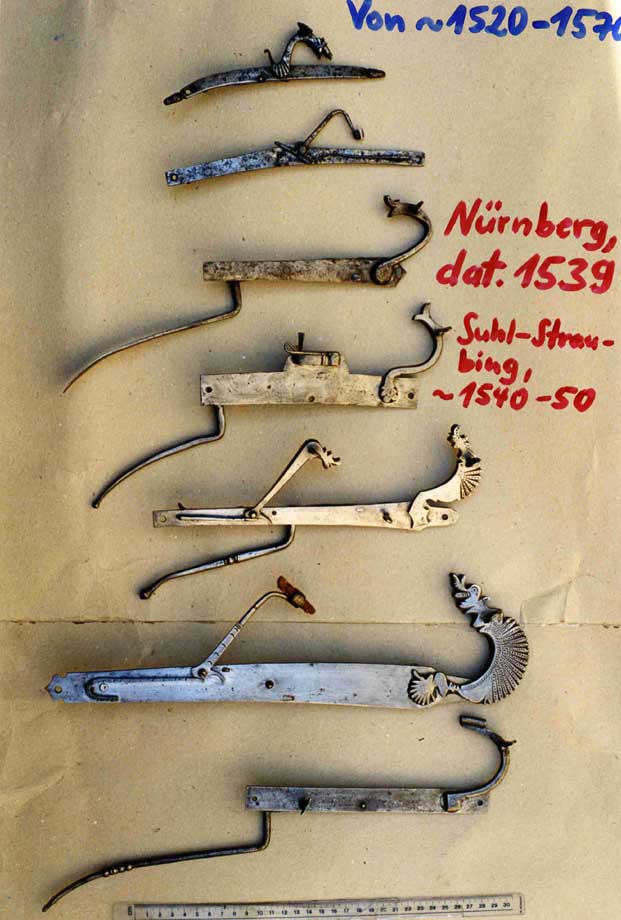

Posts: 4,310
Default A matchlock chronology, ca. 1520 to 1720

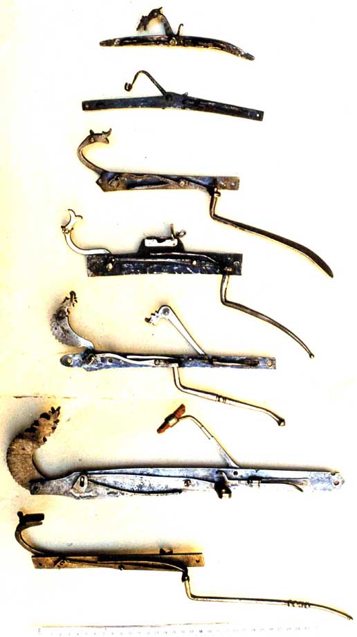

All (and many more) in my collection, many of them belonging to complete guns, some just being detached.

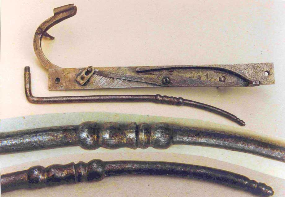

Old 13th November 2008, 01:54 PM   #2
Matchlock
Matchlock's Avatar

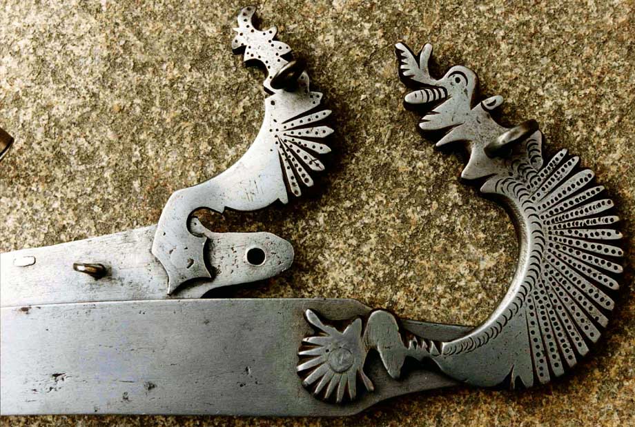

Join Date: Sep 2008

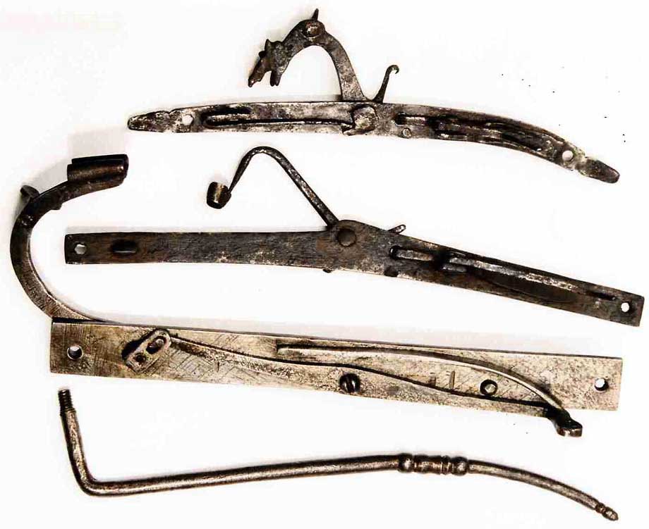

Posts: 4,310

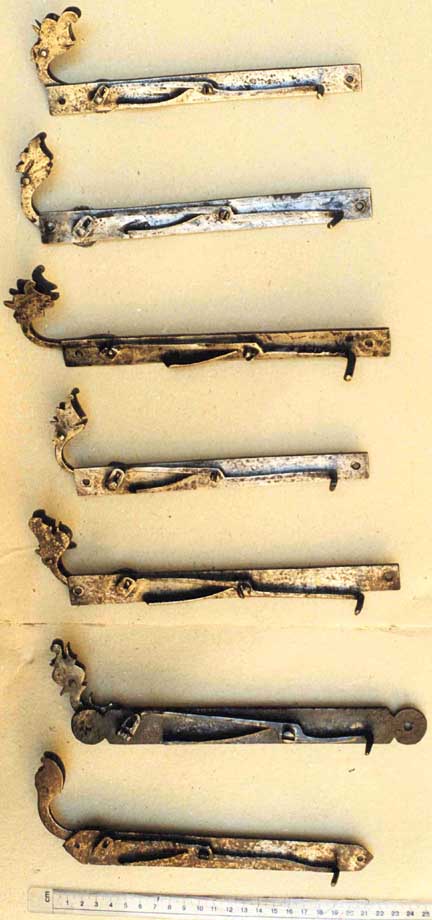

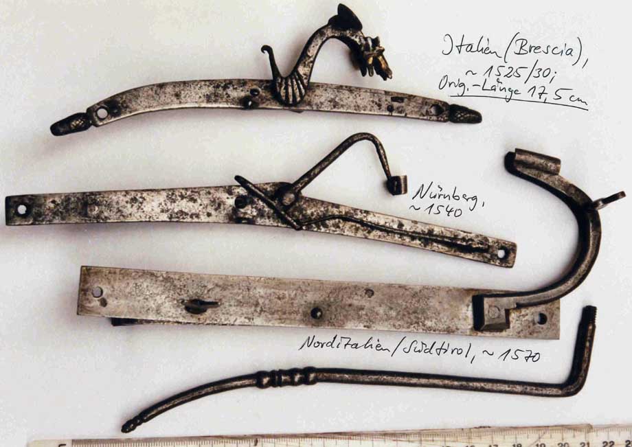

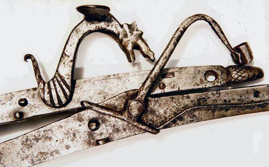

Default First half 16th century

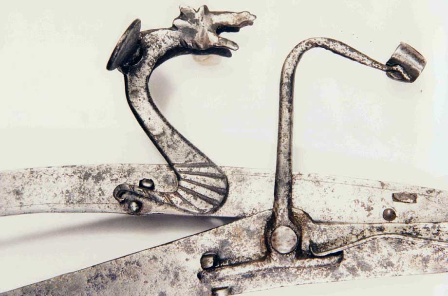

Note the cute sea-horse shaped snap serpentine of the smallest mechanism, which belongs to a small Landsknecht type harquebus in my collection that was most probably made in Brescia, Val Trompia, Northern Italy, in about 1520. I will post that gun later.
The one in the middle is a snap matchlock of Nuremberg make, ca. 1540.
The one at the bottom is North Italian, ca. 1550, retaining its original finely wrought tiller trigger. It also highly unusual in having a safety catch: a wing nut can be turned to block the sear inside the lockplate!
Michael

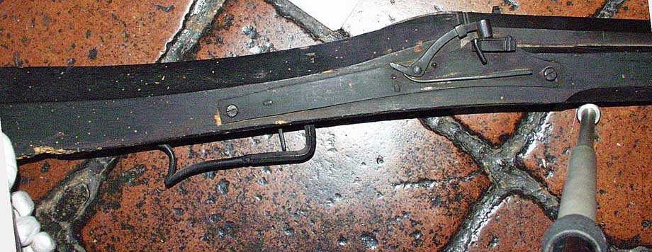

Join Date: Sep 2008
Posts: 4,310

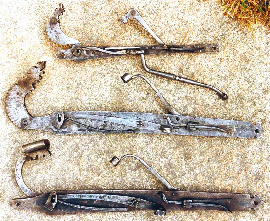

Default Combined snap and sear matchlocks, ca. 1550-60

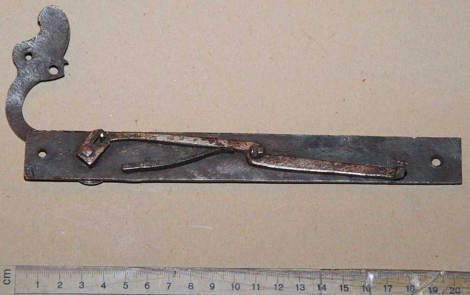

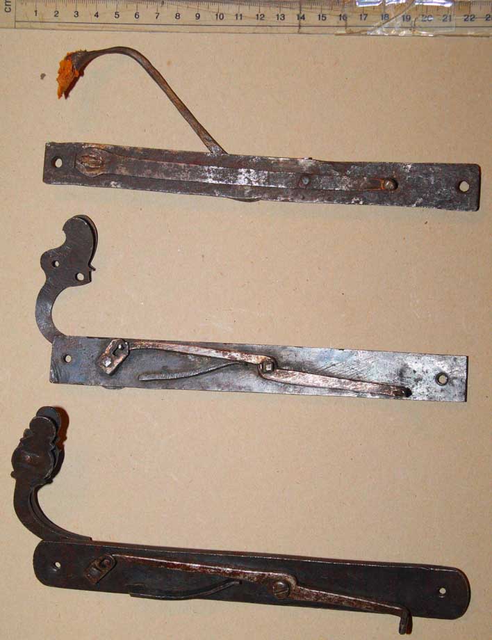

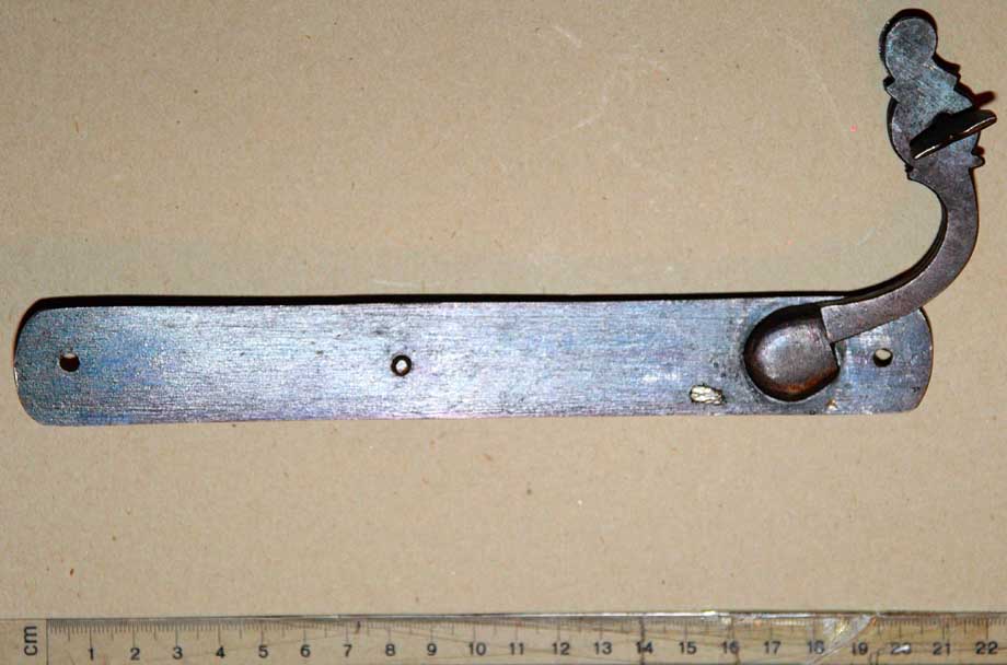

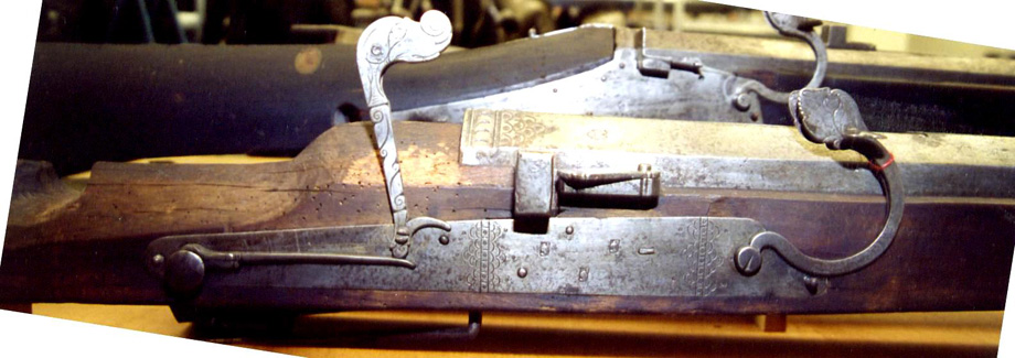

Tho two bigger ones from wall guns. The two photos taken in the Militärmuseum (Army museum) Dresden show the complete guns.
Michael

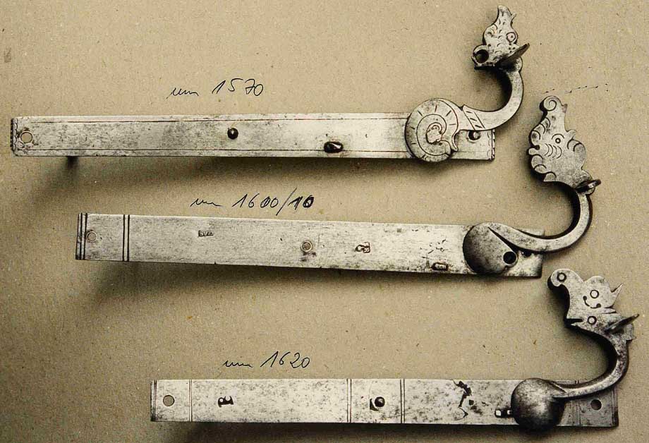

Posts: 4,310

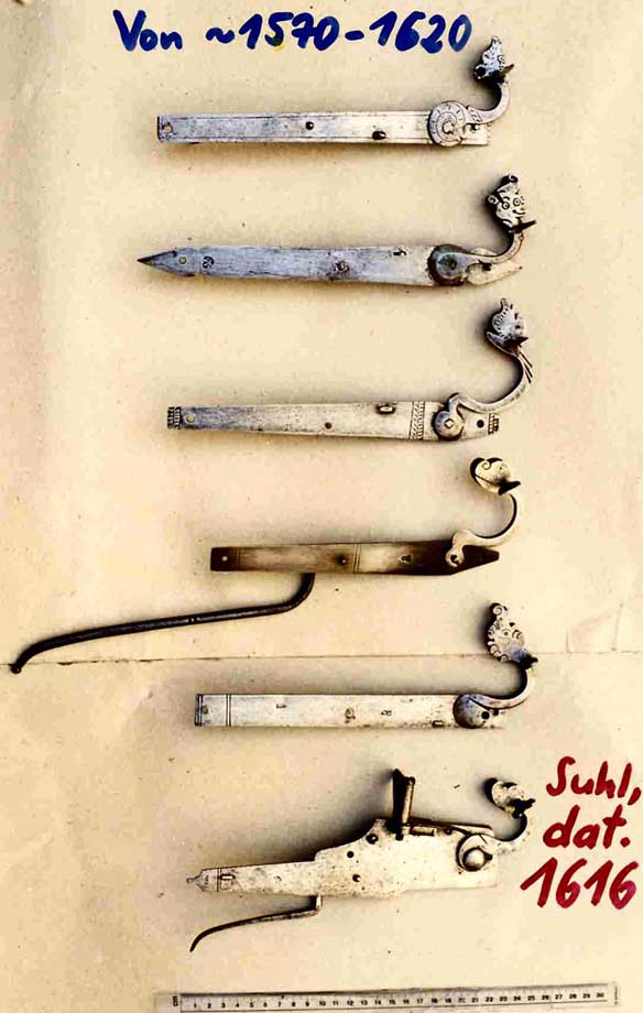

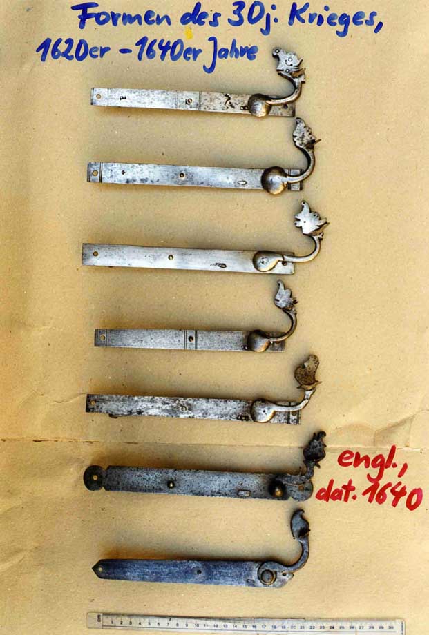

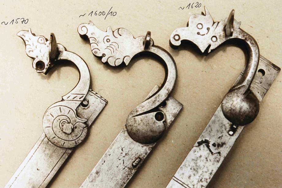

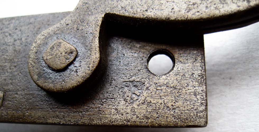

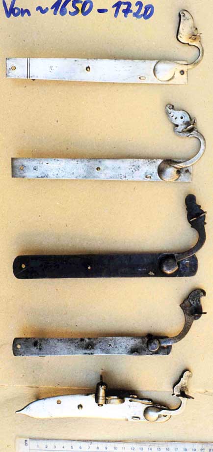

Default Serpentines, Nuremberg, ca. 1580, to Suhl, ca. 1620
It takes a long study to be able and state the differences in both form and the style of engraving.
Michael

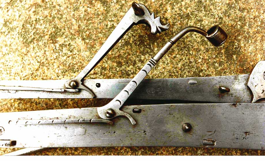

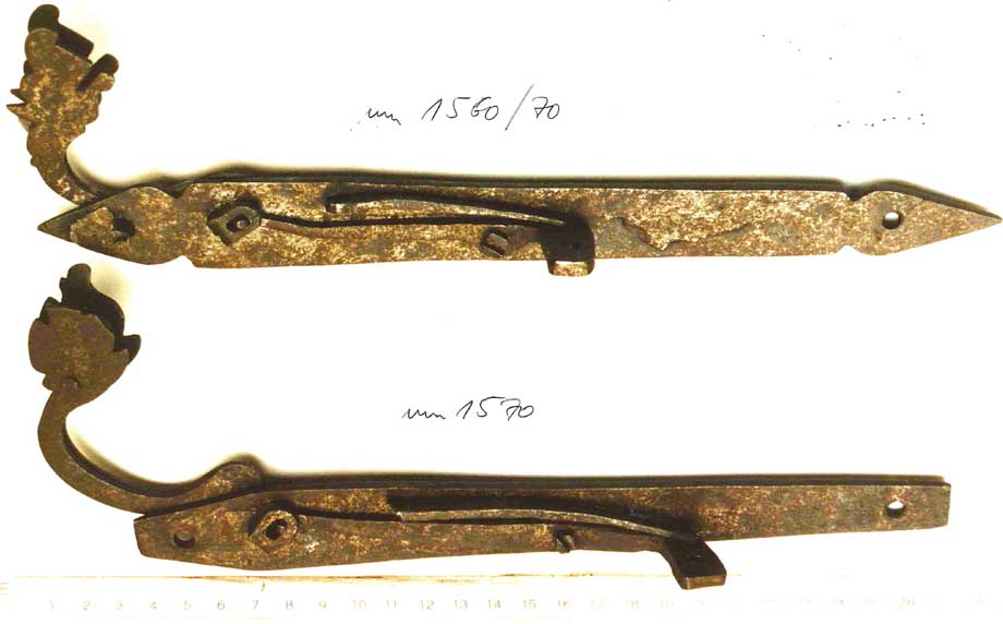

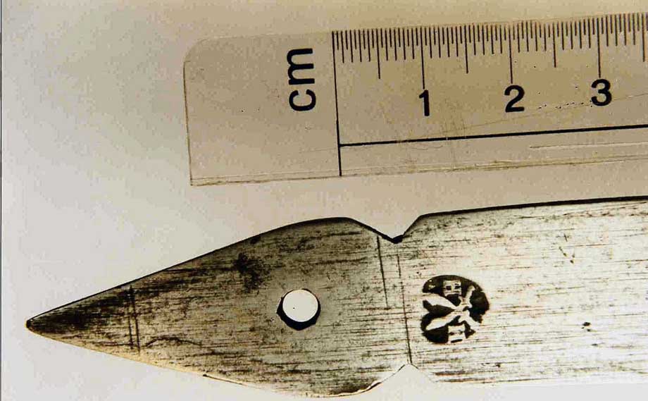

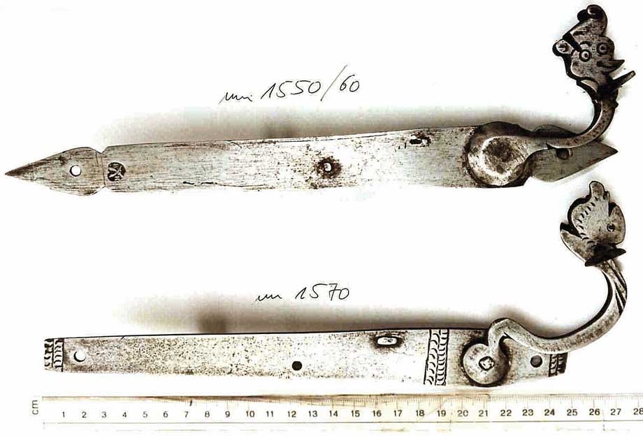

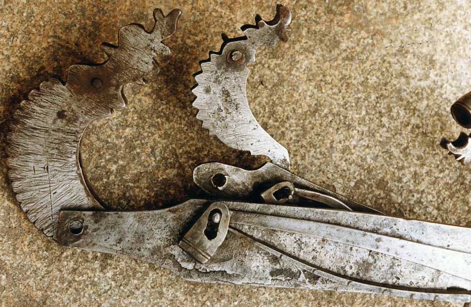

Old 13th November 2008, 06:04 PM   #5
Matchlock
Matchlock's Avatar
Join Date: Sep 2008
Posts: 4,310

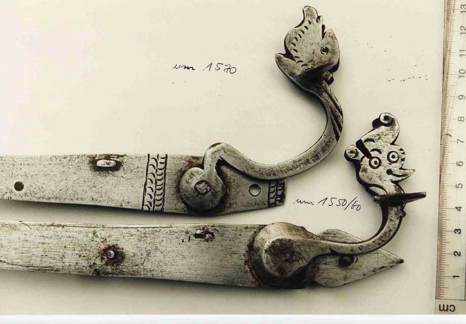

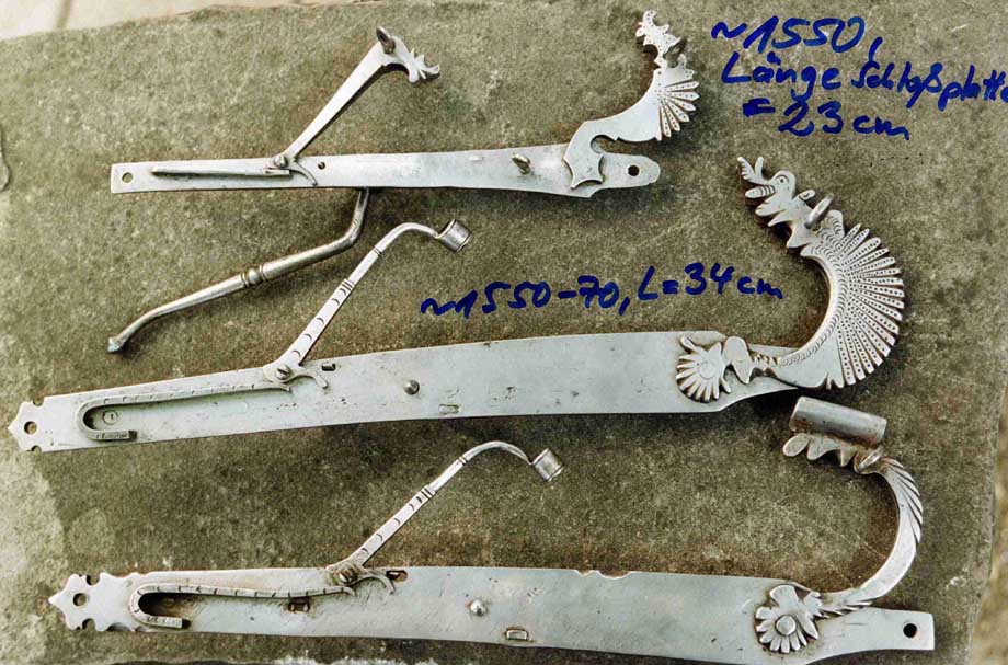

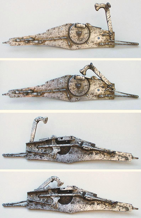

Default Nuremberg matchlock mechanisms, ca. 1550-60
The one with the leaf shaped lockplate ends bearing the crossed sabers marks together with the initials HH of Hans Herold (aka Hörl), Nuremberg, active around 1550-60.
Michael

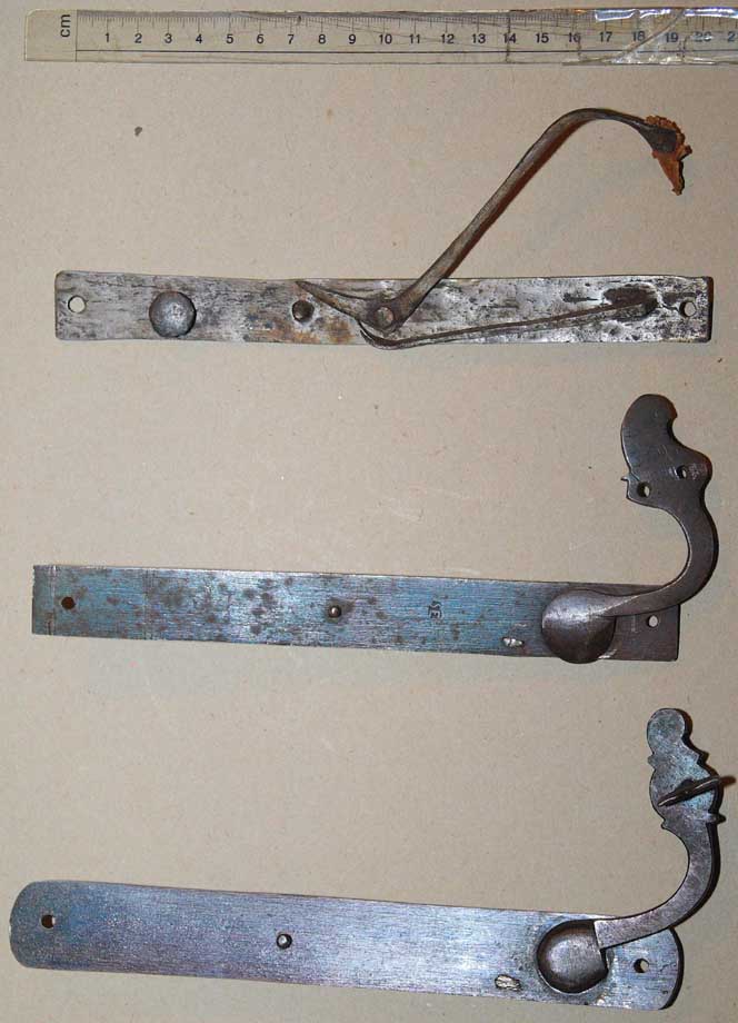

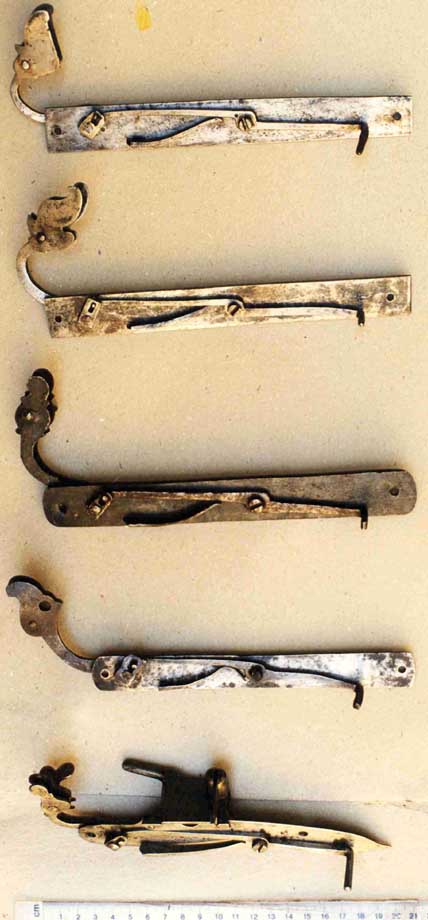

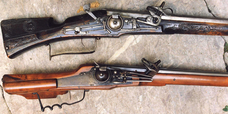

Old 13th November 2008, 06:34 PM   #6
Matchlock
Matchlock's Avatar
Join Date: Sep 2008

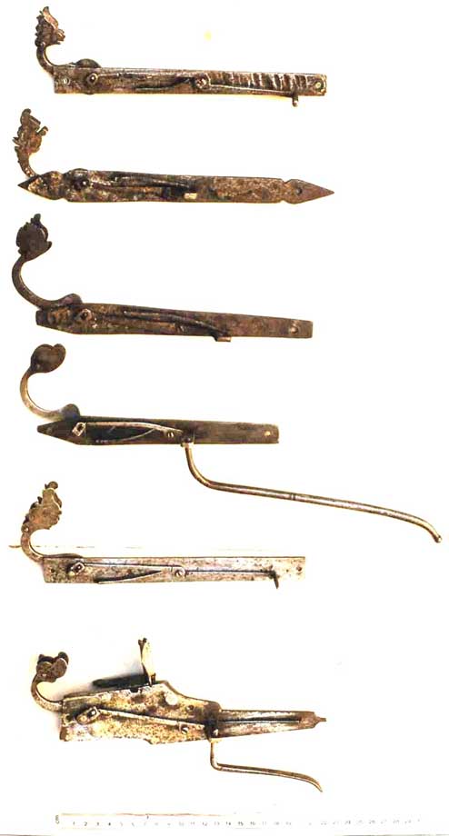

Posts: 4,310

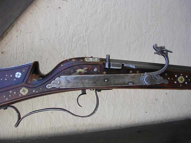

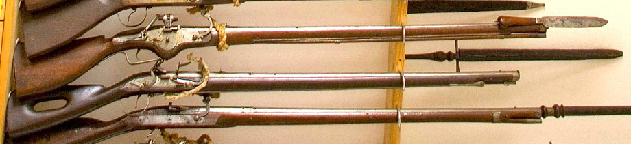

Default Mid 17th century matchlock mechanisms retaining all of their orignal blueing!!!
Extremely rare to find! This is the way they looked like when handed out to the musketeers almost 400 years ago, who - of course, soon scrubbed off the blueing.
The image of three illustrates the comparison between the earliest known complete matchlock mechanism in existence, ca. 1510-15 (defined as all parts being mounted on a common plate - you may remember this from a previous post here), its snap serpentine released by the push button projecting out of the rear end of the plate (on top).
Most people would hardly notice any significant differences between this 500 year old ancestor and the two blued mechanisms below, the first Suhl, ca. 1640, the second Swedish, 1650's. 150 years of developmemt and yet they look almost all the same; even the size of the lockplate did not considerably change. Simple and reliable simultaneously, it was almost perfect from the start. That's why it used to dominate the battle fields for about 300 years, starting from its most primitive beginnings in the early 15th century (please cf. my post on the earliest known handgun in existence) till its most recent examples built in the 1720's.
It's a rarely plowed field ...
Michael

Michael,
Thank you for the wonderful photos!
I see some locks have both snapping and lever mechanisms.
This is the first time I have seen both types on one lock plate.
was the snapping lock used more for target work?
Richard.

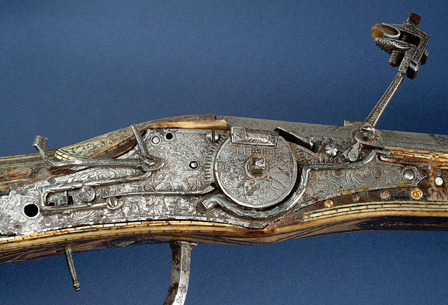

Old 14th November 2008, 11:52 AM   #8
Matchlock
Matchlock's Avatar
Join Date: Sep 2008

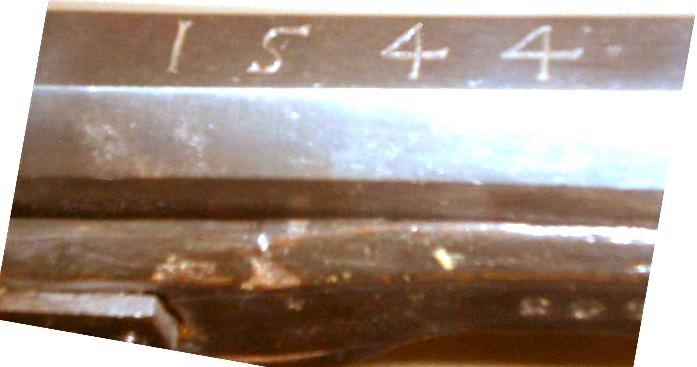

Posts: 4,310

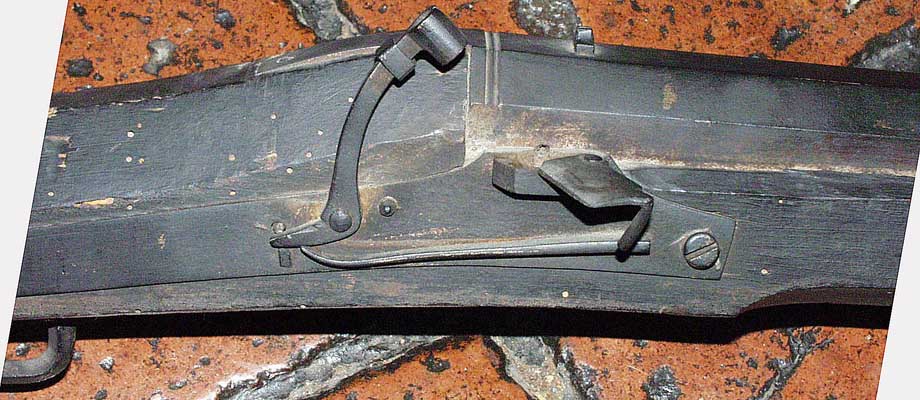

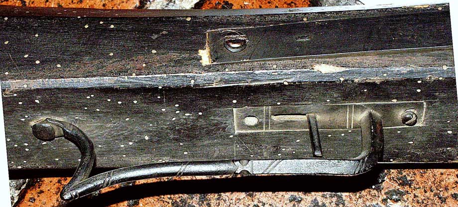

Richard,
All of these mechanisms are from military guns.
Actually, the snap matchlock, or snap tinderlock, was preferred for both hunting and target shooting guns but saw also extensive "service" in fighting.
The first matchlocks in the early 15th century were sear locks activated by pressing a long trigger bar upward which caused the serpentine to move towards the touch hole and return to its original position after the shot had rung out. From early to mid 16th century, the snap matchlock was peferred for military purposes, triggered by a horizontally working push button. In around 1530 we find the first snap tinderlocks activated by means of a "conventional" trigger. Sear locks, however, never came out of military use, and around the 1550's we often see both mechanisms combined, most probably in order to have another igniting system in reserve. E.g., if the match holder failed or the match had gone out, a piece of tinder in the snap cock (which was a real cock because it had to be cocked) could be lit. A complicated and intricate procedure, no doubt.
In fact, in some instances we find double matchlock mechanisms on wall guns up to the end of the 16th century. The tinder snaplock, though, had long since made its way as an additional or reserve mechanism on wheel-locks from the 1530's. This snap or sear matchlock-wheel-lock combinations were highly favorized from ca. 1550 to 1600, then seem to have diappeared from the battlefields for the period of the Thirty Years War, only to face a renaissance in the 1660's/70's. By then, the flintlock had begun taking over from the wheel-lock - and again we find wheel-lock-flintlock (extremely rare) and sear matchlock-flintlock combinations on the same lockplate for a couple of years.
It seems that the "new" ignition system respectively was not quite trusted to work reliably on its own in its early years.

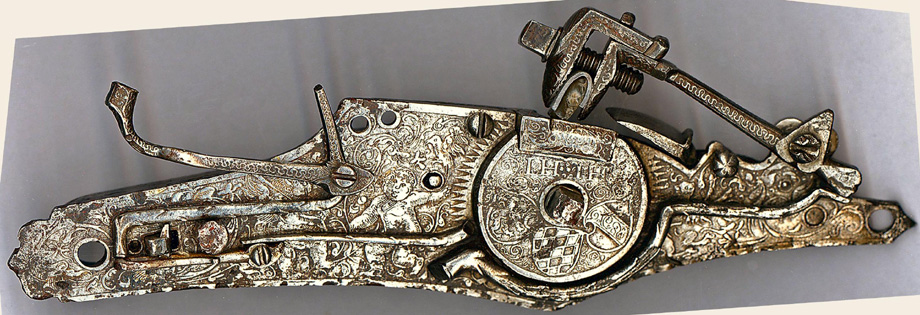

The attachments show:
a snap tinderlock/sear matchlock combination, Nuremberg, ca. 1550
some snap tinderlock/wheel-lock combinations:
- Munich, dated 1532, the lock and barrel etched profusely
- dated 1544
- ca. 1580, from a wall piece
- a fine Suhl military musket in my collection, dated 1602, in my collection
- a Suhl wall piece, ca. 1610
- a Suhl military musket, 1660's, and
- a sear matchlock/flintlock combination, Suhl, ca. 1666 (the famous Montecuccoli system), both in my collection

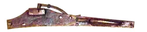

plus:

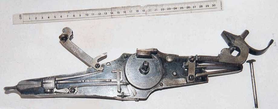

a highly unusual dummy wheel-lock mechanism, ca. 1565, which really is a snap matchlock in that it never had a wheel and chain! (in my collection). At first sight, it has the appearance of a high tech wheel-lock but is really a simple snap matchlock.
Michael
Old 14th November 2008, 11:54 AM   #9
Matchlock
Matchlock's Avatar
Join Date: Sep 2008
Posts: 4,310
More views of the dummy wheel-lock.

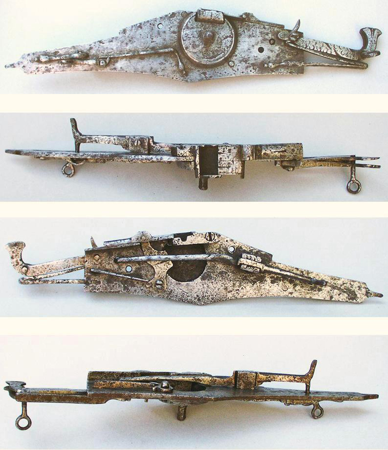

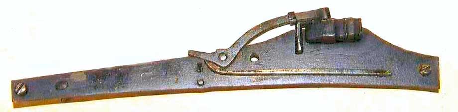

Old 7th December 2008, 05:05 PM   #19
Matchlock
Matchlock's Avatar
Join Date: Sep 2008

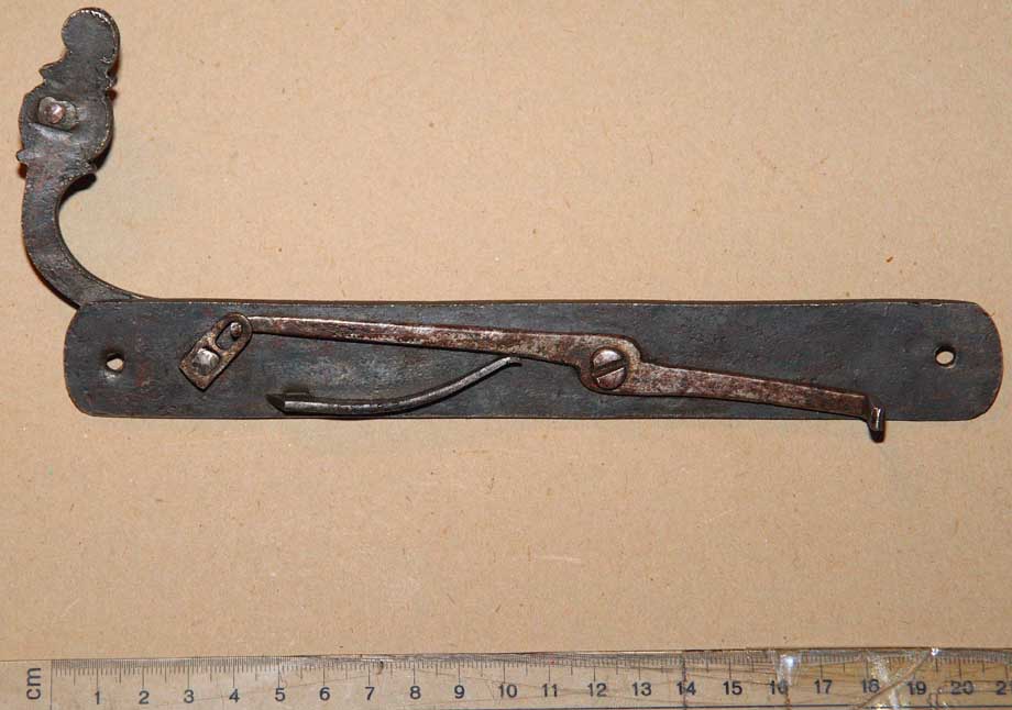

Posts: 4,310

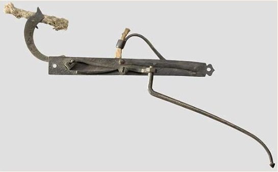

Default A Styrian snap matchlock with pan, 1550's, retaining its original blued surface
Extremely rare.
Michael
Old 9th December 2008, 01:49 PM   #20
Pukka Bundook
Join Date: Jan 2007
Posts: 803
Good morning, Michael.
A very nice lock and in just about 'as new' condition!
was it ever fitted to a gun?
The notch in the pan for the touch-hole looks very narrow, and made me wonder if it had ever been fitted or not.
It is a lock roughly similar to this, that I thought may have been originally fitted to the two harquebus' from the Tower.
Looking again at the dummy wheellock above in this thread, I must say an awful lot of work went into it. It is a very nice lock!
I see the pan withdraws when fired via a link inside.
All best wishes,
Richard.
I have just been looking at the dummy wheel-lock again.
Do I see stains inside the lock-plate where a longer spring was once fitted? also, I see a cut-out for the wheel.
I was just wondering, with the quality of work here, Do you think this was originally a true wheellock, and when it broke down, converted more cheaply to a matchlock?
An interesting lock!
R.

Good morning, Richard,
The blued matchlock mechanism in as new condition belongs to a gun which is not in my collection. I just took it off for the pictures. You will see the complete guns with this kind of lock later on.
The dummy wheel-lock in fact never had a wheel mounted, and there never was a U shaped mainspring. The pan is not cut out for a wheel and there are no other screw holes than those with the screws present.
It was built just to be a dummy. Nothing more to it.

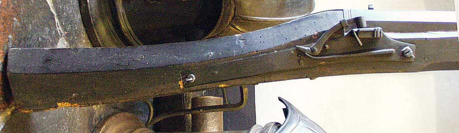

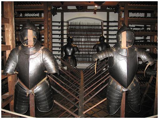

Join Date: Sep 2008
Posts: 4,310

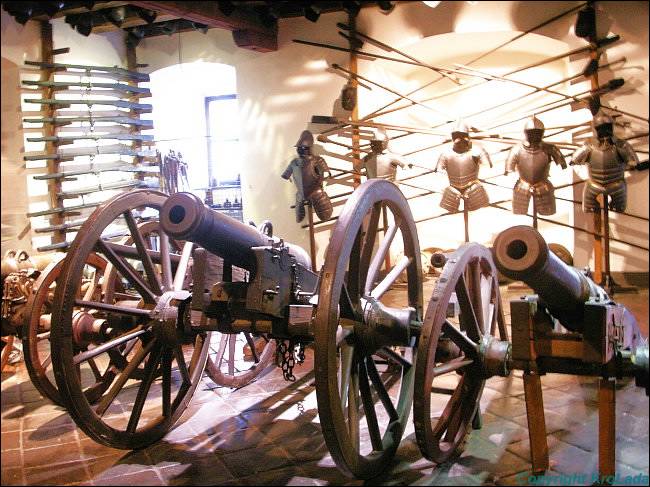

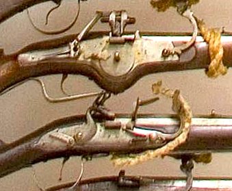

Default Snap matchlocks ca. 1555 in the Graz armory

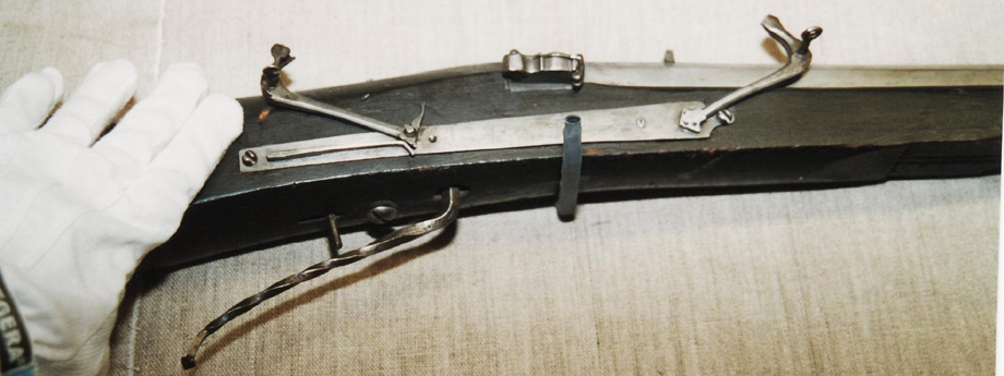

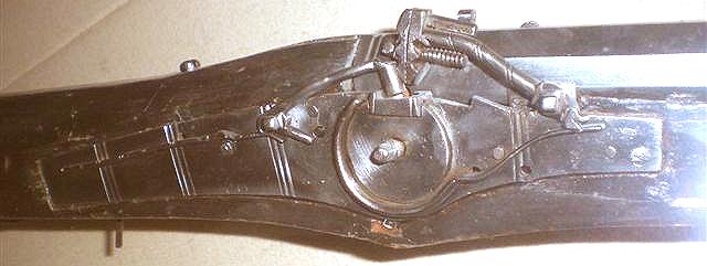

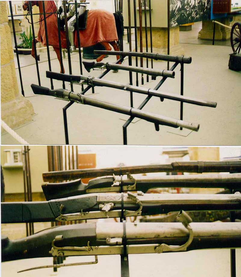

Hi, Richard,

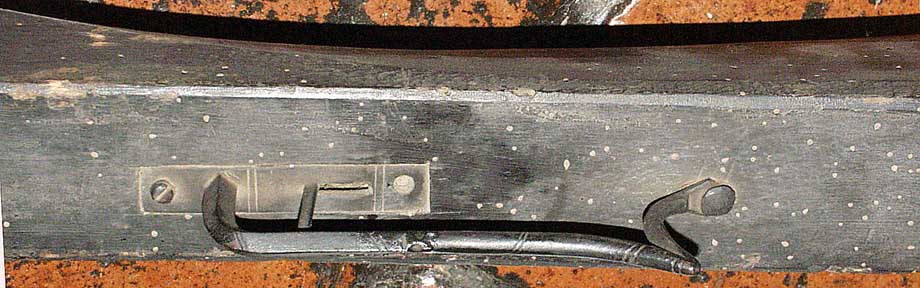

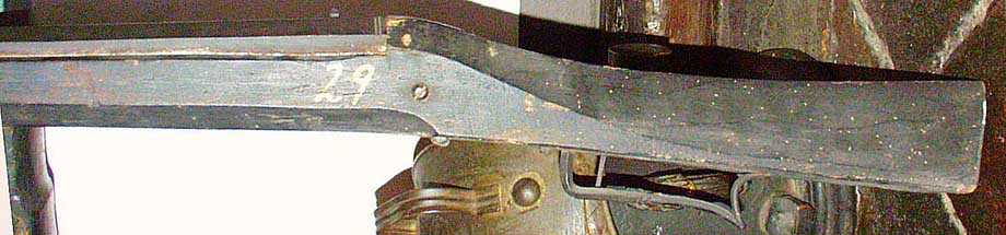

Here are digital pics a friend of mine took that show details of a ca. 1555 Styrian wall gun; some of the barrels of this group are dated 1554, 1556 and 1557 respectively.
I took the measuremts of one of those big pieces:
overall length 215 cm, cal. 24.8 mm smoothbore, weight 26.5 kg.
Some of the butt-stocks resemble that of my Straubing harquebus but there are other variations as well.
Michael

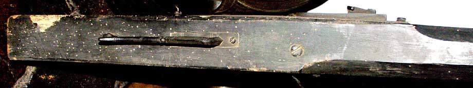

Old 14th December 2008, 12:57 PM   #23
Matchlock
Matchlock's Avatar
Join Date: Sep 2008
Posts: 4,310

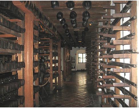

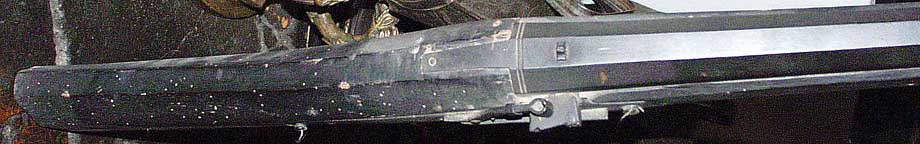

That's how these matchlock wall pieces are stored on their original shelves at Graz.
Michael
Old 14th December 2008, 02:51 PM   #24
Pukka Bundook
Join Date: Jan 2007
Posts: 803
Thank you for the reply.
I am surprised the dummy wheellock was made that way. I have never seen one before with such nice internals, inc. engraved spring!
It shows that at this time, the old matchlock was not looked down on, as something inferior.

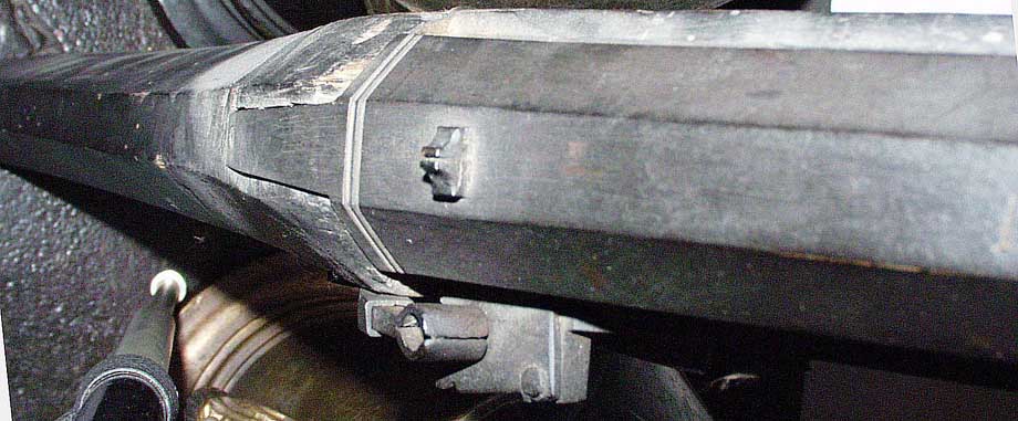

Re. the Styrian wall guns, a few things surprise me;
The barrels look to be of high quality, Very well finished!.....something not always seen at this early date.
More surprising to me, is the use of a conventional trigger and guard!
(When we think that sear locks were being made for about 100 years after this time, and many snap locks were still using the button on the lock-plate, or an early unguarded trigger.)
It is interesting to see the trigger and guard off-set, so as to make the reach shorter on the heavy, thick stock.
Also. this is the first time I have seen this simple method of tightening the jaws of the cock on the tinder. .....Very simple! I would like to try making an arrangement like this!
Looking at these pictures, I started to itch to give these guns a 'drink' of oil!....they look a bit dry and thisty.
Graz looks like a place to not miss if I ever get to that part of the world!
I could be los in there for hours...days!
Thank you for posting these pictures!!
Richard.

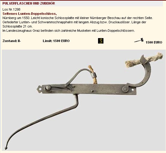

Posts: 4,310

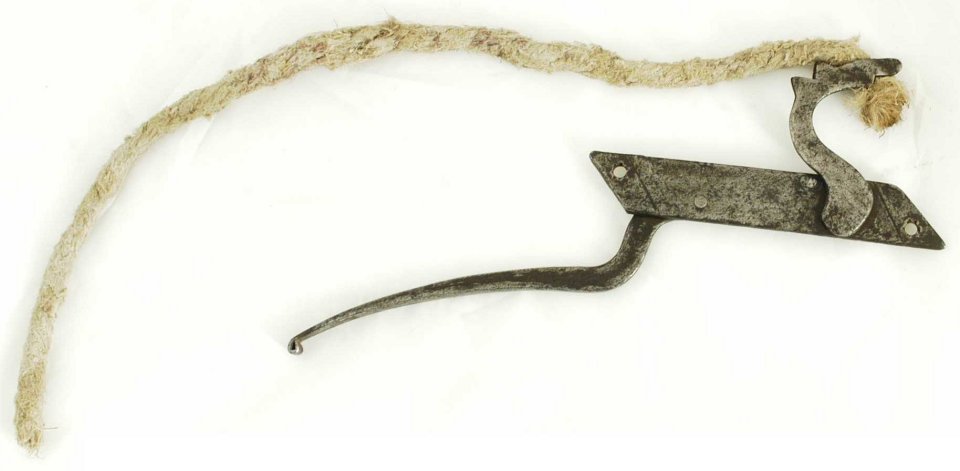

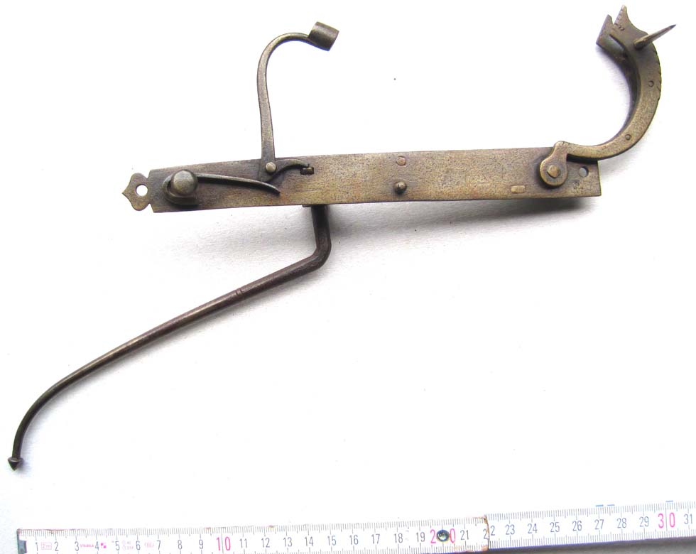

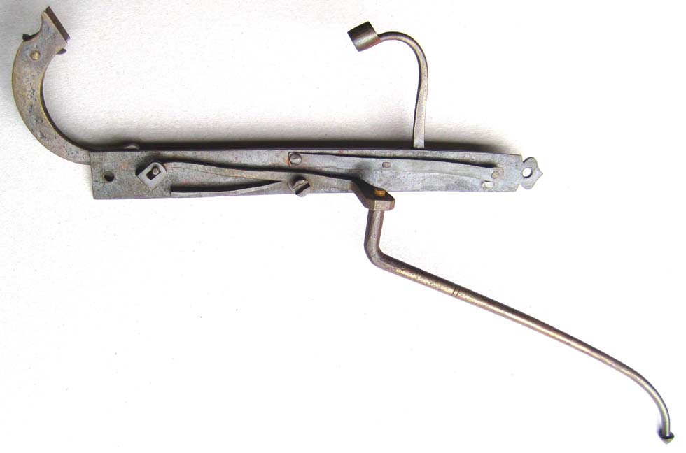

Default A Very Rare ca. 1550 Nuremberg Combined Snap Tinder and Matchlock Mechanism
A detached mechanism for an arquebus, retaining its long tiller trigger acting on the forward match serpentine while the rear snap tinder cock is released by a lateral push button.
Length of lock plate 21 cm.
On the fore end of the lock plate, right underneath the foot of the serpentine, a small Nuremberg city proof mark is struck - please see detail image.
Both the cock and dog (serpentine) retaining a piece of tinder and match cord respectively and of corse both served the same pan alternatively.
Sold October 5, 2009, Hermann Historica, Munich, at a hammer price of 1,500 euro.
Cf. similar combination locks in my collection posted in this thread.
Michael
