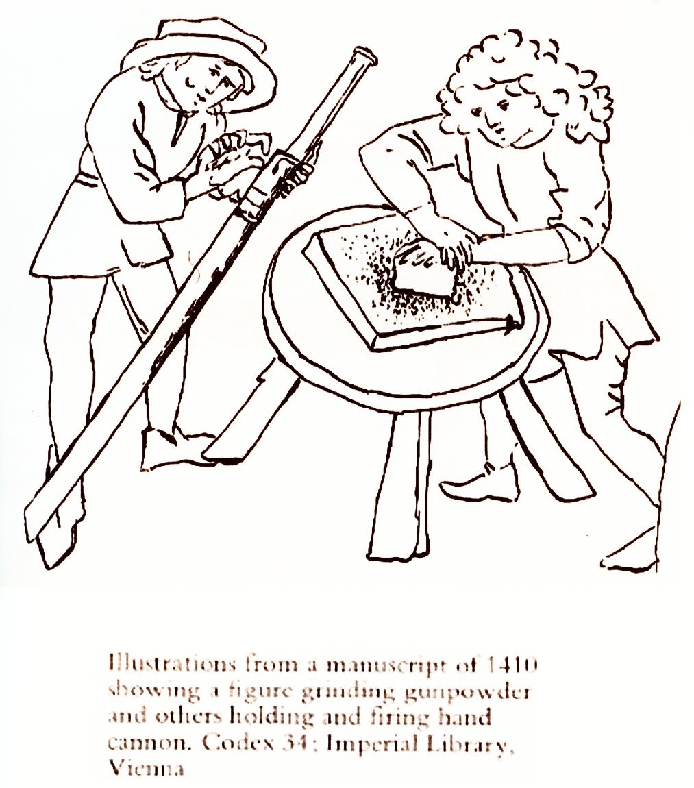

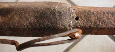

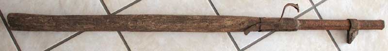

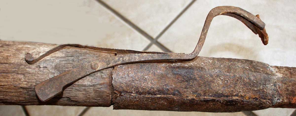

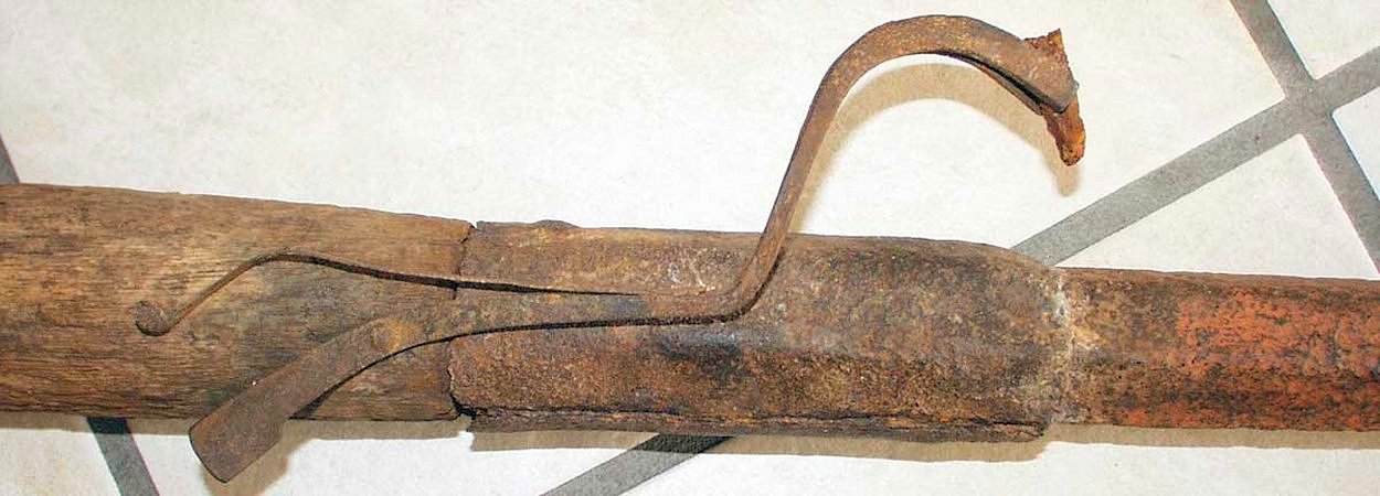

I should mention that the hook, like the firing mechanism, seems to be a working amendment as it is not wrought to the barrel but split in half, drawn over the muzzle and riveted on the underside.
The comparison with the attached illustrations of 1405, 1410 and 1411, with no support hooks present, indicates that the hook which actually defines a haquebut (German: Hakenbüchse) was an invention of the first half of the 15th century.
For having patience with me you are credited with additional images.

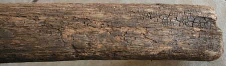

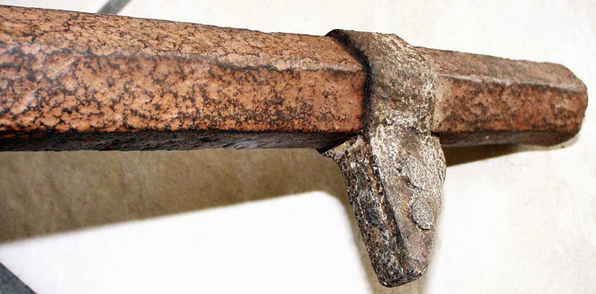

A few more details of this 600 year-old handgun.

Very interesting to see the spring-loaded serpentine,
This must be an extremely rare hand gun!

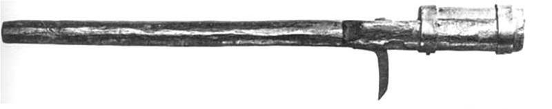

Now here is the Pilsen handgonne that you mean, Fernando.
I was in the Pilsen Armory in 2000, being kindly allowed by Dr. Hus to handle and photograph all the items I liked to.
The stock of this piece with the staged wall support may be original and may have worked against the recoil with this small and short barrel as the "hooked" stage is both very long and thick! It would never work with a long barrel and slender stock as in Daehnhardt's gun, though.

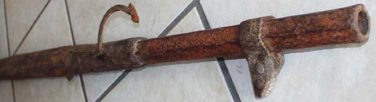

I enclose another early 15th century Pilsen handgonne with an iron hook drawn over the barrel (!) and put through the stock - the last stage before welding the hook directly to the barrel for optimum stability.
I have tried to do my best and sure hope to have made things as clear as possible. I spent 30 years of my life studying to be able and tell wrong from right.
Michael

... The stock of this piece with the staged wall support may be original and may have worked against the recoil with this small and short barrel as the "hooked" stage is both very long and thick! It would never work with a long barrel and slender stock as in Daehnhardt's gun, though. ... I spent 30 years of my life studying to be able and tell wrong from right. ...
I don't have the slightest doubt that you know more about this subject while you are asleep than most people awake, and i thank you a lot for your patience and teachings. Only there are positions to consider; for example Bernahrd Rietsche states without hesitation that the Pilsen specimen was a clear example of a wooden hook being a primary solution to recoil. I assume you have read his article ... have i made a wrong reading ? So i was misguided by such source. And as Daehnhardt has aproached the same problematic of the wooden hook fragility, i assumed it made sense.
The Daehnhardt's gun is an Indian item... not necessarily an example of European haquebus expertize. Allright, it has an atypical design and you say such stock could never work; noted.
But ironically, every wooden hook experiments, after time, ended up failing.
But i bother you no more. Now it's my turn to say: enough said
With respect.
Fernando

Fernando, have you seen the pictures of the Pilsen gun mentioned by Bernhard Rietsche that I posted? It was the short rectangular iron lug protruding from the underside that would soften the recoil, not the lug of wood; the last was only for support to rest the gun comfortably.
It looks as if the short iron lug was originally a hook and broken off or shortened later.
In any case it had the function of a wall hook.
I am afraid that Herr Riestche had overlooked that detail.
With my respect and best wishes,
Michael
Michael
Duly noted Michael,
I must say that the part of this topic that has mainly raised my curiosity was whether indeed the first generation of harquebus recoil hooks was made of wood ... even soon to be assumed they were doomed to failure.
Fernando
