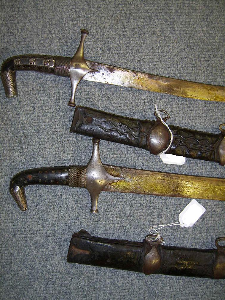

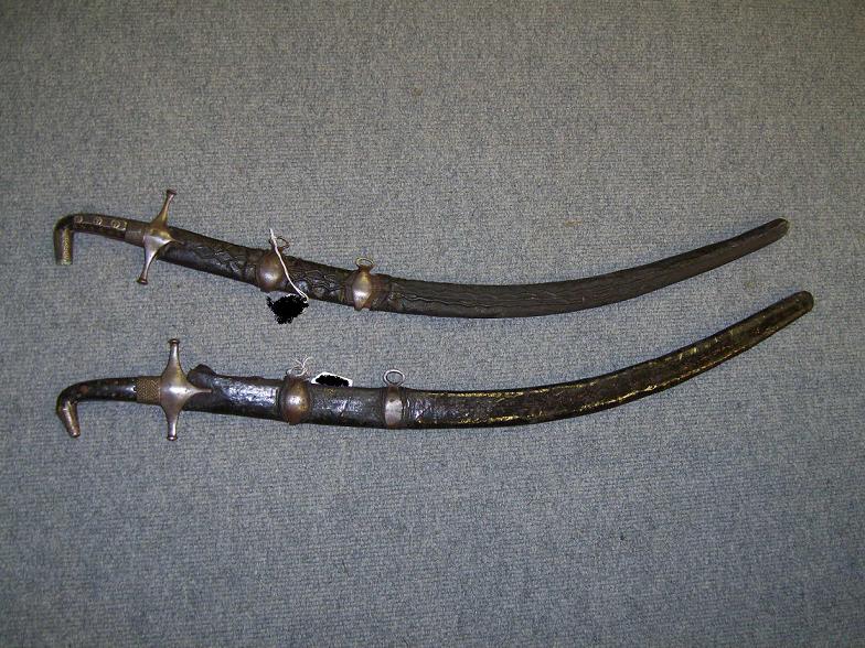

I recently purchased these two Shamshirs and a few other swords that I'll post in the weeks to come.
I have my ideas of origins from reading previous posts, some things make sense, others do not when reading through them. I would like to know more from those whose main interest lays with these swords.

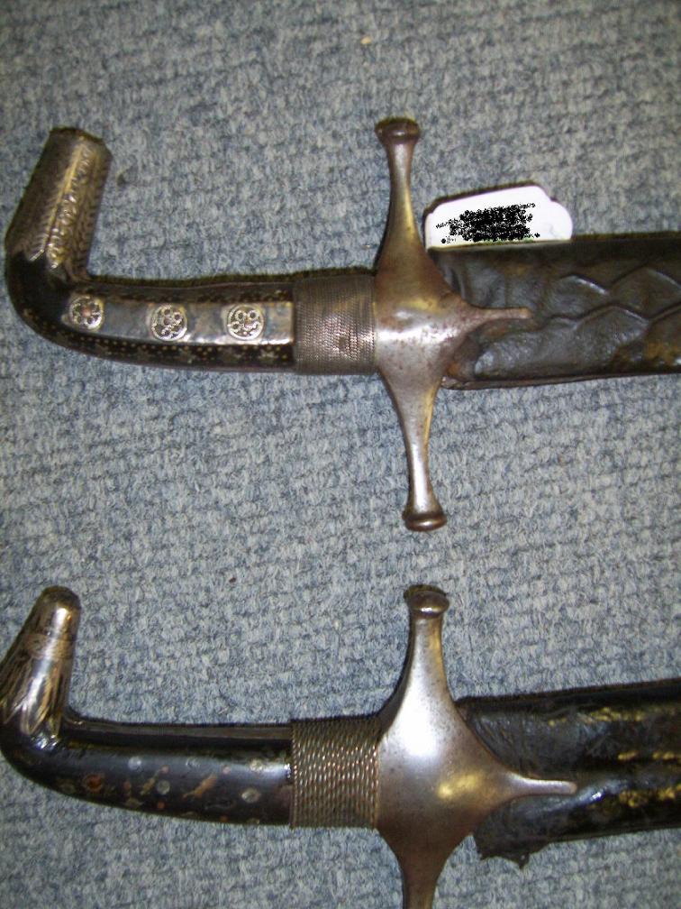

The bottom sword with the larger blade is of particular interest to me as is the workmanship in the inlay of the handles of both swords.
I'll post more pics of the steel in the blades in good time once I have received them in the post and clean the grease from them.
thanks
Gav

These are Syrian shamshirs Gav, and these look like late 19th century, possibly into early 20th. I really like these (see my avatar and they were typically acquired by Bedouins in Arabia. It would be interesting to get a look at the blades.
Intertribal warfare and raiding prevailed well into 1930's and 40's in Arabia, probably much longer, in fact I'm sure well into the Nejd it still goes on, but more on that from our guys in Arabia.
These are handsome sabres and good examples of 20th century swords where these weapons were still used.

Thanks Jim, Any ideas on the bottom sword as to why it differs somewhat in dimensions so far as the blade is much broader than the usual Shamishirs I have seen and the hilt tapers more than I have seen on most too? I am guessing it is just a varient of styles prefered by owners???
Thanks for coming in.
Gav
Gav
The makers had certain styles and the owners had to choose among them. I suppose that some of them wanted heavy blades.
I suggest to clean them and etch them. It could be damascus blade there

Blades often saw long service lifes, were family heirlooms, were extensively traded, etc so it is not uncommon to see older blades mounted up in late 19th or early 20th century mounts. While it is not an exact measuring tool, a wider, heavier blade with less curvature can be a fairly old blade especially if it is damascus. Anthony North in his book "Islamic Arms in the V&A" mentions that while it is difficult to date unprovenanced or undated swords the earlier ones tend to be wider and heavier and this was due to usage. It would have been used against armour. In the later times, 18th and 19th century, heavy armour slowly went away and the shamshir design slimmed down, took more curvature, etc.
Lovely swords!

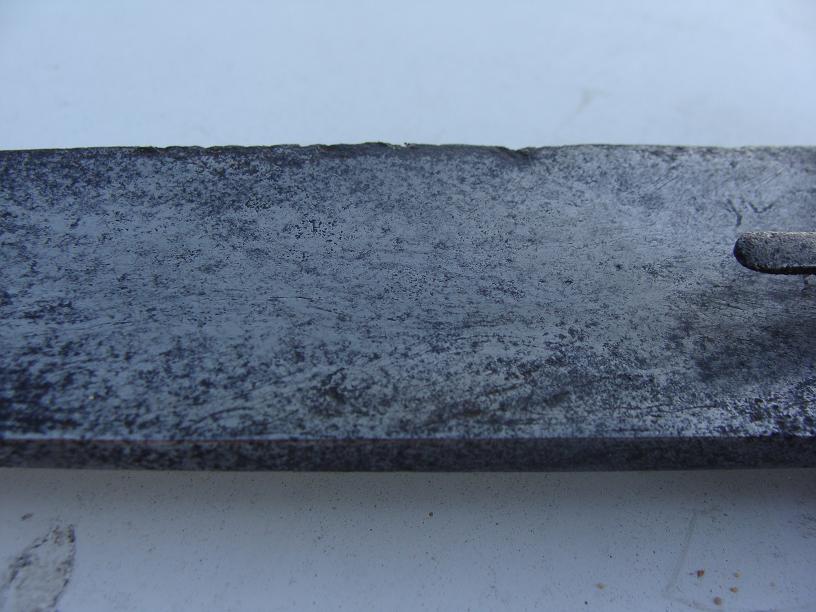

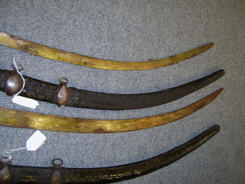

Default A couple of images of the steel
They certainly need a good clean but I do beleive the older broader blade is Damascus as are the scabbard fittings. There are 3, what I consider very bad rust spots on the blade but then I guess it is a very old blade and the ravages of time have had their effect. I will if I ever find the time, give these 2 blades a very good clean to see what else can be revealed.
More to follow...
Gav

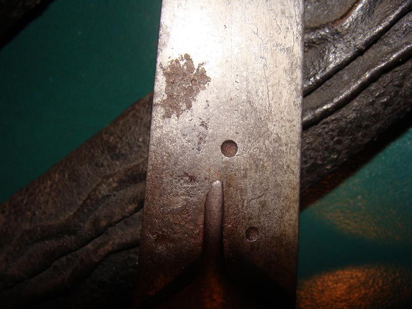

Default What do these mean?
After further cleaning, I am curious to know what these 3 indents/dots in the blade mean? They are found on the narrow Shamshir near the guard.
Thanks
Gav
Old 19th August 2008, 04:51 PM   #12
Posts: 10,792
Hi Gav,
Looks like things are coming along nicely. The dots, in triple, are something that has come up in discussion occasionally over the years, and appear in variation it seems on some Indian swords. I dont think we have really established if in fact there is distinctly a certain symbolic application as yet, but it would seem with the numeric there may well be.
Perhaps there is a practical explanation, but that is equally elusive.

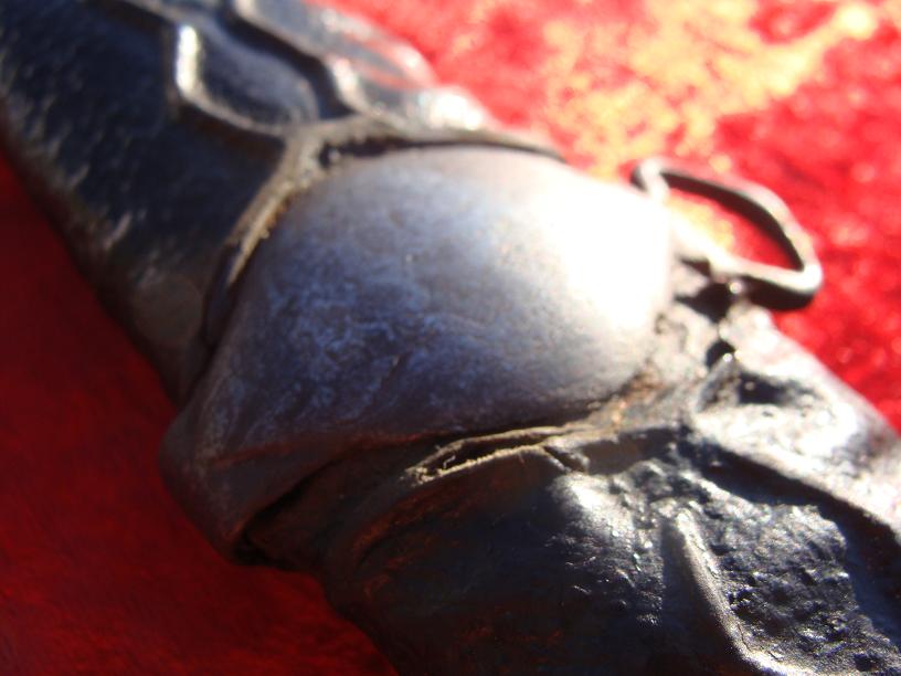

Just one note on the wiggling lines on the scabbard, these are apparantly typical on scabbards of Bedouin swords from regions into the Sinai.
All best regards,

Hi Gav,
All best regards,
Thanks Jim, I do wish I had more time though. I would be interested in knowing what is the best cleaning/etching method to bring anything out more these particular blades. Stick with the Ferric or try another line? Also in the image you can see a rather nasty rust glitch, there are several like this on the broad blade on the cutting edge. What would be the best method to conserve these areas.
Interesting statement about the Sinai Jim, it certainly helps with the goegraphy research.
Thanks
Gav
