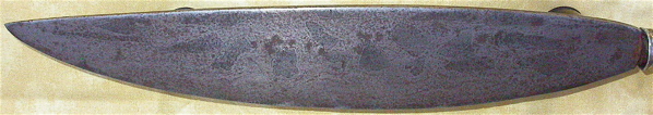

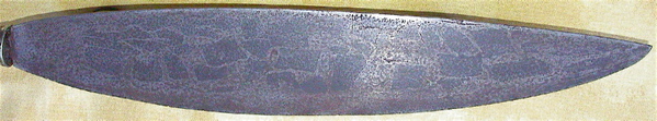

Here is an antique Barung which exhibits a very distinctive pattern welding: Looks almost like bits of high-carbon steel were thrown into melted iron and slices of this material subsequently utilized for sandwiching the high-carbon steel core. Well, I expect this pattern to have been forged but I really have a hard time to understand how this was actually done by the bladesmith!
I have seen this pattern before but only with Barung and not any of the other Moro blades! It seems to be pretty rare, too. A more knowledgeable member commented that this pattern may suggest an Indonesian origin. My guess would be leaning towards one of the coastal Moro settlements of North Borneo, maybe Tausug or Samal?
total length 54.5 cm / 21.5 in
weight 760 g / 1 lbs 10 oz
blade length (without hilt) 39.3 cm / 15.5 in
max. blade width 66.9 mm / 2 2/3 in
max. blade thickness 7.5 mm

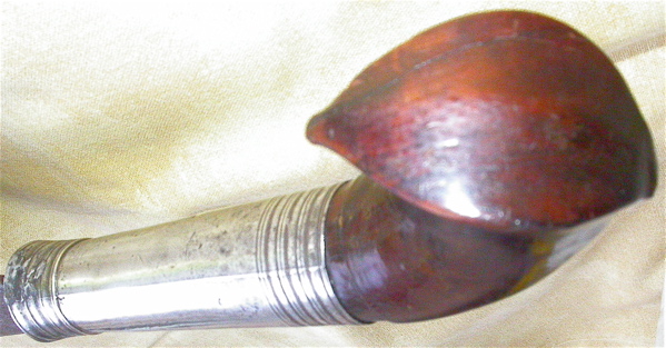

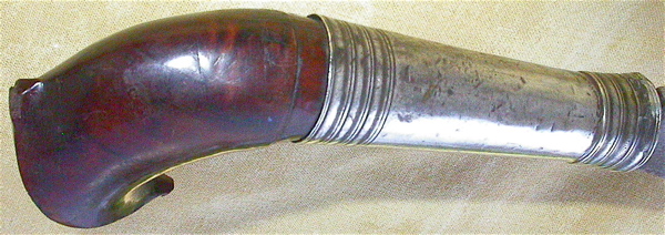

More pics: warrior blade pommel with small piece of the crest missing. There also used to be a braided band between the silver sleeve and the pommel (either silver wire or lacquered jute twine).
Old 30th July 2008, 03:33 AM   #3

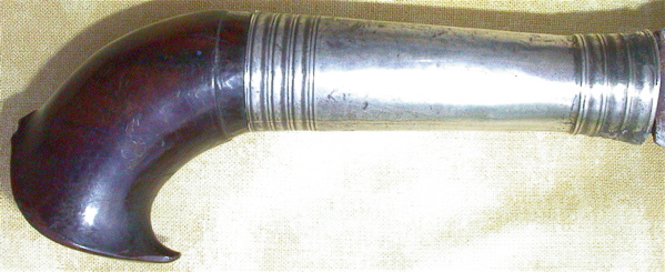

Bunti pommel - sorry for the blurry pic!

I have a Barung with a similar pattern though I haven't been able to highlight it as you have .
Nice work .

I don't understand why "A more knowledgeable member commented that this pattern may suggest an Indonesian origin" on a non-Indonesian weapon?
And I don't understand why everything odd from this region "probably is" Borneo?
I have also seen this pattern before on other barongs.
But so far I haven't read anything about specifically these barongs being either collected, or manufactured, in Borneo/Sabah.

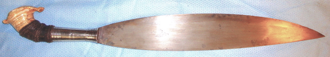

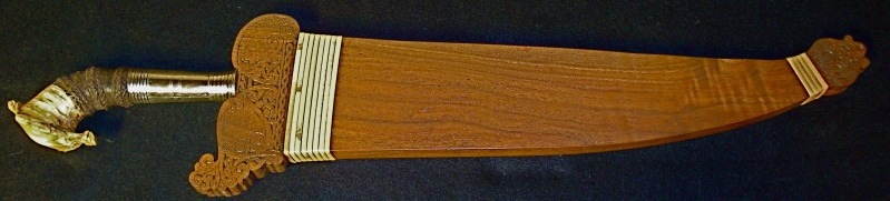

Here is my Samal fossil ivory barong. I made the scabbard years ago in Samal fashion.

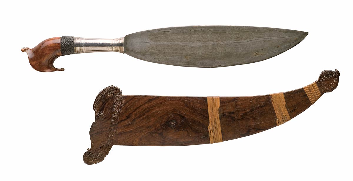

Here's one of mine for comparison.

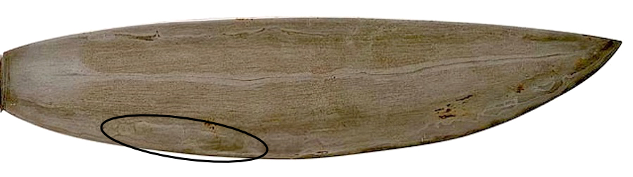

Lovely barung Rick. It has a really interesting blade. I'm not at all an expert in how these are forged, but it seems that the initial billet was divided in two down the long axis of the blade where the long forging line appears, then forged out from there. It seems there was a central core of (? softer) steel or iron, surrounded by a (? hardened) steel layer. I've circled what I think are the area of "blotches," but are these really inclusions like on Kai's example? Am I looking at the right area? The edge has a lot of lamination activity, and its hard to know if the circled areas are just lamination or are inclusions.

Posts: 6,436
No Kai, it was this one; the patchy areas were the closest I could come to anything like the OP.
I know it's not quite what you were looking for, but there was also a request for photos of Barungs so I thought I'd throw it in there.
I'll be glad to remove it if you think it's off topic...
Ian, this one came from ebay back in the good old days when it was actually possible to score bargain prices on these 'unknown' knives/swords like this one and a certain twist core kris I bought for literally peanuts.
The forging pattern is interesting and indeed it may have been divided in the process; to me it resembles the inside of a flattened banana peel.
I wonder if it is also Samal like yours and Jose's example.
