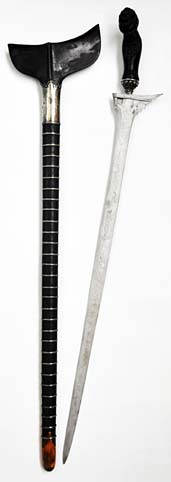

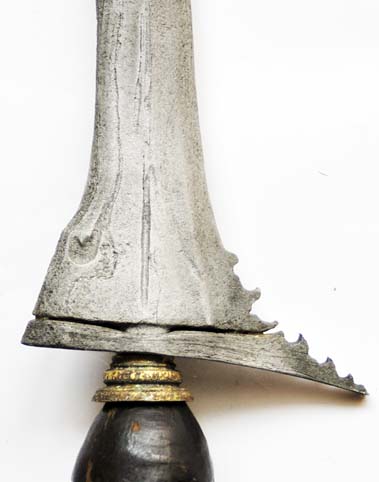

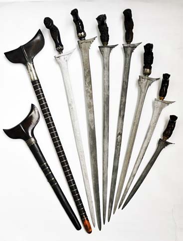

We – in Java – call kerises such these, as Bangkinang (the longer), and Bahari kerises (the shorter one). But of course some of you know better than me what they really are. The shorter keris with specific "greneng" measured 42 cm (not including the pesi) and the longer is 54 cm long. More information on these kinds of keris, please?

Hullo everybody,
From the viewpoint of an Oerang Soenda:
- based only on length; yes, the short one (LHS) can be called 'bahari' and the longer one (RHS) a 'Bangkinang'
- the Bangkinang was developed in answer to the Portuguese rapier, mainly for use on horse-back (read 'pony-back'). So it was straight (no eloeks/waves) and concentrated more on steel content than pamor/damascene patterns). Also, the Bangkinang did not have a tonggong/back-bone). Last of all, the bedor/tang had a flat section to prevent rotation.
Best.

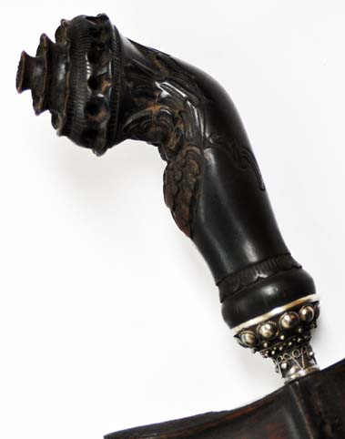

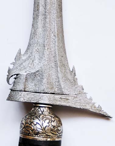

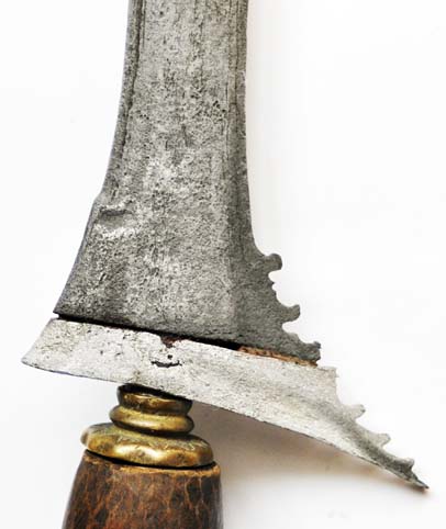

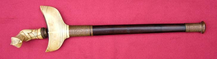

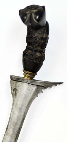

Sumuhun (thanks -- in Soenda dialect), kang Amuk... Once again I post pics of the blades but without hilt. The pesi (or 'bedor' in your term) of the longer keris is not flat as you mentioned. But round -- though bigger than the normal kerises, even a bit bigger than Balinese blade (but not longer).

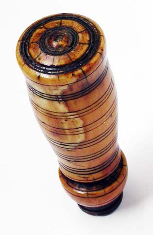

Originally Posted by PenangsangII
The Malays of Sumatra & Peninsula call these dapors as keris Penyalang. Some would simply call them keris Panjang.
BTW, are the hilts original to the blade, or are they much later additions? I never saw this type of hilt in a keris Penyalang / Panjang before.

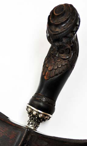

Dear Penangsang, the hilt belongs to the longer one. It is not ivory, but perhaps old 'duyung' teeth. I got the 'keris panjang' with such hilt (keris Bangkinang in Javanese term -- Bangkinang is a name of a small place in the southwest of Pekanbaru Riau, Sumatera to the direction of Padang, Sumatera Barat. This place, believed to be the 'origin' of such keris model or at least popularized from this place before 19th century). The style of sheath is Palembang, but the wooden "gandar" (blade section sheath) is no more original. Maybe broken, and changed with trembalo wood gandar..

Originally Posted by Amuk Murugul

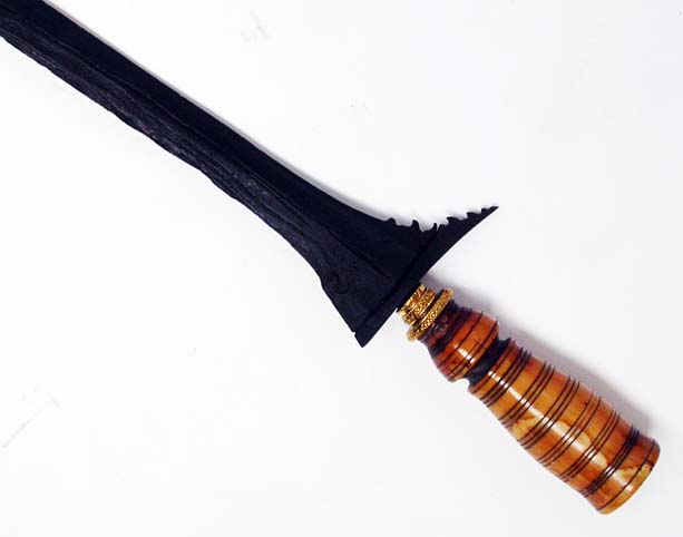

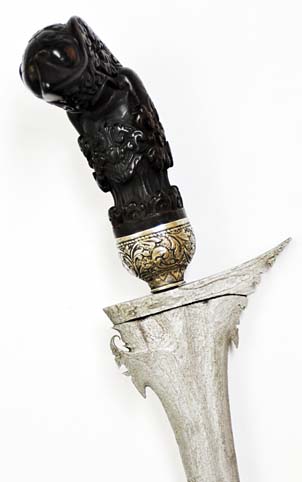

...Cannot see from pictures, but if the gandi (front part of base of blade) of the longer one has a tikel halis/eyebrow shaped like an inverted comma, then it has the 'Bangkinang' form.
Yes, it has a kind of "tikel alis" shaped like an inverted comma near the gandhik. I will post the clearer pics later tommorrow. The blade is too heavily etched with warangan...

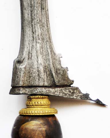

Old 24th June 2008, 04:26 PM   #11
VVV

Posts: 991

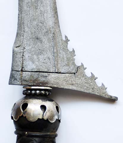

Picture from the gandik part of the blade. Like an inverted comma...
Hullo again,
Is that a ridge/backbone I see running along the middle of the blade?
If it is, then I wouldn't call it a traditional Bangkinang but I would settle for a panjang/penyalang.
Best.

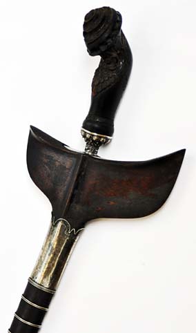

In the state of Perak this type of keris are also known as Baur. If i'm not mistaken, it's an Acheh word according to our forumite Raja Muda. He heard it during his trip there.
http://www.perak.gov.my/sultan/english/baur.htm

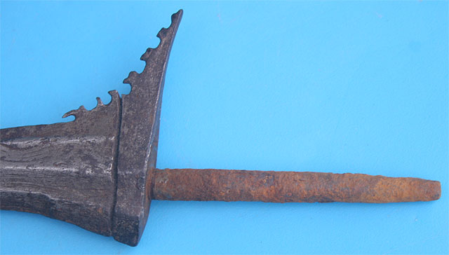

Hello Amuk,
Thanks for your contributions!
The tang would be about 10 cm.
Are you sure?

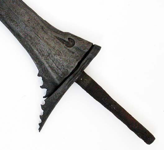

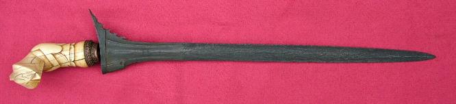

Here's a pic of a pesi which seems to be unaltered and is only about half the length you give. (I'm going to post the exact measurements later.)
I may have seen a dozen other pesi of this keris type but all had unspectacular sizes. Any pic of those (partially) flattened pesi would be great, too!

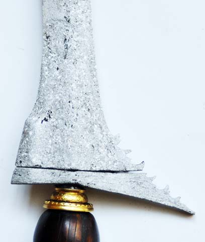

(Additional info for Kai and Amuk) the supposed to be a "bangkinang" I've shown before, has a pesi/tang's size of 6,5 cm long, round but bigger than normal. But the supposed to be "bahari" keris, is quite much longer -- 7,8 cm but smaller than the "bangkinang". Here are the pics...

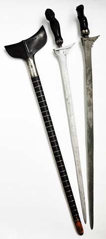

Is there any significant difference, between Malay sundangs and Filipino sundangs?

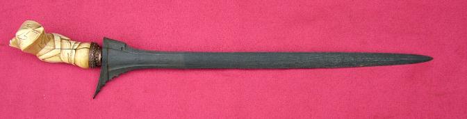

The scabbards are definitely Malay. Malayan keris sundang often have blades which seem to originate from Moro smiths; those of local Malay manufacture often have distinct features.

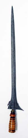

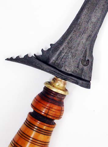

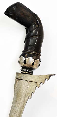

Yeah, that looks like what I'm used to.
BTW, my piece has a pesi length of 6.0 cm (2.36") and a blade (without pesi) of 51.4 cm (20.24").

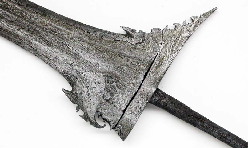

Thanks for the pics. I have to admit that this one looks odd to me: It's certainly not a regular keris bahari and I suppose it's not from Sumatra nor Malaya. I know that Alan has quite a few distinct examples - maybe he can comment on Javanese styles?
BTW, are you sure, this is an old blade? For the time being, I even wouldn't want to exclude a recent Madurese origin...

... Thanks for the pics. I have to admit that this one looks odd to me: It's certainly not a regular keris bahari and I suppose it's not from Sumatra nor Malaya.
My opinion is with Kai on the piece with the longer pesi. The base area (sor-soran) seems suspicious.

Hi Ganjawulung,
Sorry for the late reply. I have quite limited internet access at the moment. IMHO the main difference is the "bangun" of the blade. Its hard to explain in words actually..

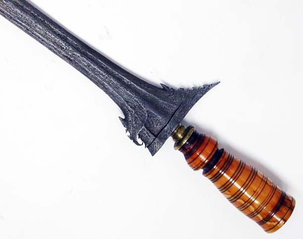

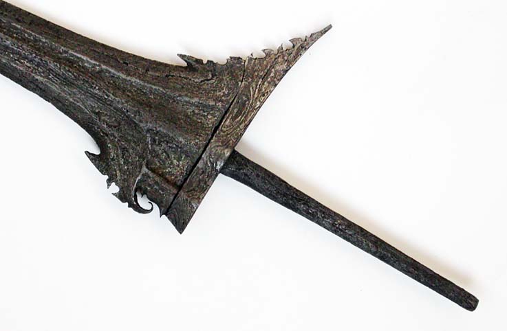

Yes, Kai, quite sure it is not a recent one (from grasping the metal blade). Nor madurese origin. (I hope Ki Jayamalelo could comment on this blade. He has seen this blade when we met in Jakarta last Sunday... couldn't he?)
This more close up picture on the base of the blade...

Ganjawulung,
I would categorized both kerises posted above as Keris Panjang. Basically it is the form and length that makes it such. You may have heard about keris panjang, anak alang and bahari. Typically most, infact 90% of this were found throughout Sumatra (Riau, Bangkinang, Palembang, Padang, Jambi, etc) and the Malay Peninsular (Malaysia). How can we differentiate the keris from which part/region is another question.
Keris bahari refers to the same form (dapur?) but normally less than 12 inches long. Length of 12-16 inches would be anak alang, and longer than 16 inches can be called a keris panjang. This is just my roughly guide.
Newsteel is offline   Reply With Quote

I thought that your keris panjang with kembang kacang is rather 'unusual'. I have seen many but obviously not all. Typically an old 18th - 19th century straight panjang (panjang lurus) would have no kembang kacang. Only keris panjang with luks (very very rare) would have kembang kacang.
The other panjang (with that 'inverted comma at the gandik) is more common. This inverted comma like is typical found in Minang and Palembang keris - bahari and panjang.
