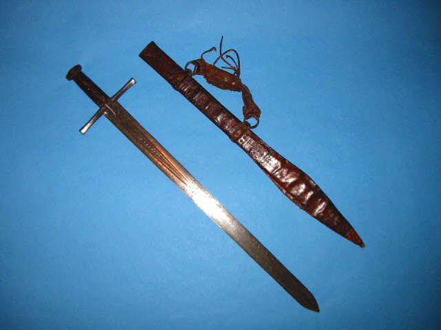

Recent interest in Andrea Ferrara blades recalls our previous thread on early makers trade marks, and noting that while this name (or marking) appears most on Scottish baskethilt blades, some have been found mounted elsewhere. Some have appeared on Moroccan 'nimchas' as well as on Indian tulwars.

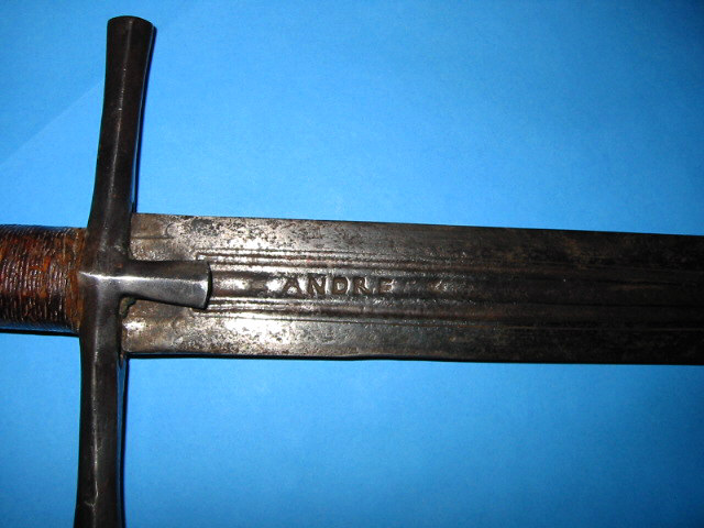

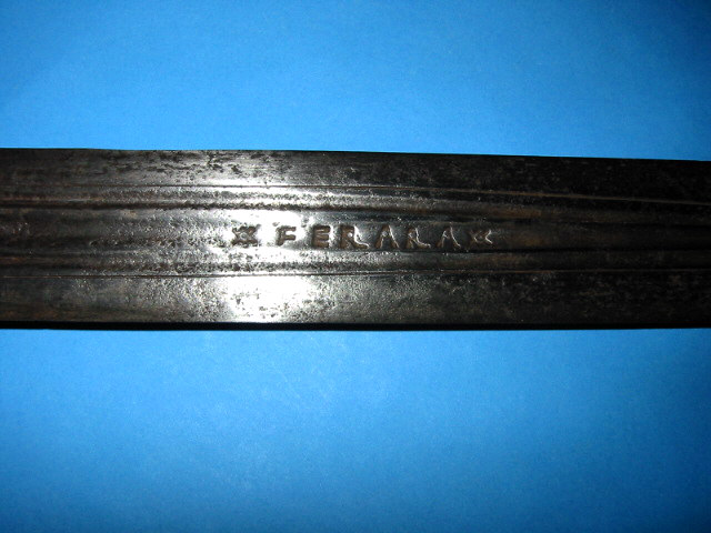

It is generally agreed that the 'ANDREA FERRARA' mark was consistant and apparantly quite significant on the blades of Scottish swords, but these are of 17th to 18th century blades, which are certainly from German workshops. Therefore, it seems clear that these blades carry this name more likely in the sense of quality or talismanic significance, since the named person whether Italian or Spanish, lived over a century before most of these blades were made.
