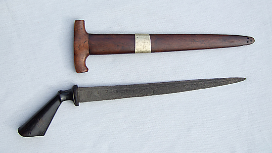

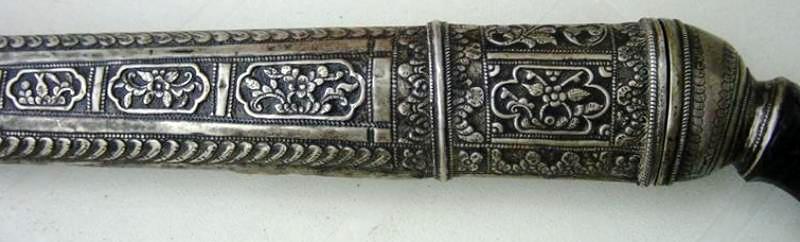

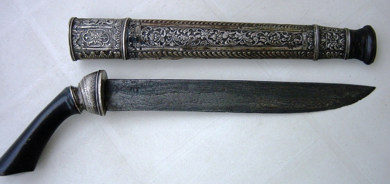

Badek ... badik ... badiik. I see all three versions out there; which one would be correct ?
The blade is 10" (25 cms.) long.
The seller dated it 18-19th century ... would 18th make some sense ?
Some signs of restoring can be seen on the wooden parts.
I wonder whether this is a current piece or a bit of a "presumptious" example, with its silver mountings ... i mean in its due period.
Would anyone care to coment on it ?
I would be most gratefull.
Fernando

Lovely example with a nice pamor blade, and nice silver bolster,
I think I am most impressed by the silver scabbard fittings that appear to be legitimate old ones, which are getting harder and harder to find.
Nice catch!!

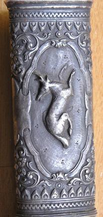

Old 20th April 2008, 12:16 AM   #3
Thank you Charles.

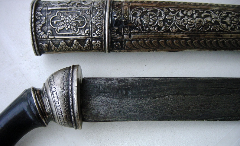

Silver fittings undoubtfully originals, as checked at sight.
Any opinnion on its age, judging by its pattern ?

A BEAUTIFUL EXAMPLE ,TOP QUALITY WORKMANSHIP WITH SOME AGE TO IT.
I COULD BE OFF ON THIS OBSERVATION BUT MOST OF THE BADEK I HAVE SEEN ARE MUCH MORE PLAIN AND DON'T HAVE THE TOP QUALITY SILVER WORK. I HAVE SEEN THIS QUALITY OF WORK MORE OFTEN ON KLEWANGS AND LARGER WEAPONS.

Very nice and rarely we could find badik with finely repoussed silver works with floral motifs. As Vandoo said, it's often found on klewang and pedang. I've seen it on Sumatran sewar as well. Normally we can expect this this kind of elaborate silver works pieces to be dated 19th century. The blade could be much older, maybe late 18th century where new silver fittings were added on later.

Old 20th April 2008, 07:23 PM   #7
Thank you for your kind words, Barry and Newsteel
I thaught i would post today the decoration on the scabbard opposite side. Yesterday i didn't notice that the two sides had a different detail ... i had bought this piece a couple hours before i took the first pictures .
Thank you Kronckew, for the hint on the spelling. Once you mention the different vowels pronunciation amongst the various english speaking natives, i can not ignore that latinic languages have a completely distinct sound for them. Being phonetics the main reason for the different transliterations, i guess that Badik will be the closest sound/spell for me to adopt

I would say the blade is 19th century. The silver work is a tougher call because similar to identical patterns are used today in low grade silver work for both new pieces and restorations.
The central panel of silver work is more common(today) than the work at the scabbard mouth in my opinion, so I think in combination this is very old work, certainly no later then very early 20th Century.....just my opinion.

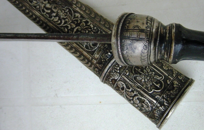

The designs look Burmese to me (see example below). Maybe it is from southern Burma. They are used in both Burma and Thailand, undoubtedly due to the Malaysian influence (not the other way around).

In Jawa this type of dagger is named "badhik"; badik is acceptable.
The type of silver work on the one under discussion appears to be exactly the same type of work that is currently used to make pendok and other silver items in Jogja and surrounds. This is done by first fabricating the form, then filling it with wax and applying the motif by hammering with different types of punches.When the work is finished the wax is removed by boiling the pendok. During the work process the pendok is held firm in a bed of hard wax.
I understand that the Dutch introduced this silver working technique in the 19th century.

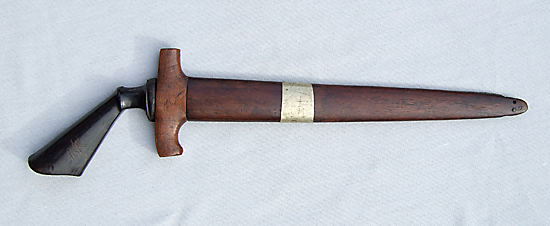

The photos with this post are of two badhik in my possession. According to Javanese people with whom I have spoken and who have some knowledge in this field, these two badhik are of Javanese origin.

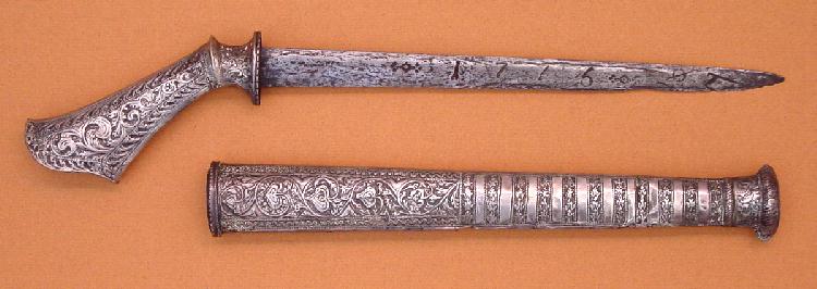

Does it help (or complicates) to show this example ?
... Both for the silver decoration, that looks partly a similar work to my ignorant eyes, as also for the blade, that somehow reminds me the one show by Alan in post #17 ... naturally influenced by the date marking attitude.
Most probably you already knew this specimen, shown here.
http://old.blades.free.fr/daggers/badik/bad03/bad03.htm

Old 26th April 2008, 10:59 PM   #25
Hello Fernando,
The blades of Alan's and Dominque's badik are made from Dutch VOC swords - possibly the blades of broken colonial swords got recycled and given a 2nd life while your nice piece has a Javanese pamor blade.
