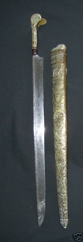

Just ended

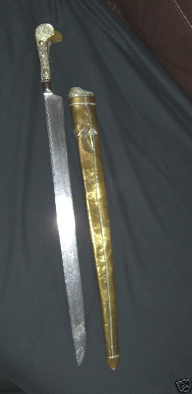

http://cgi.liveauctions.ebay.com/ws/...224029803&rd=1
In moments like that one wonders whether Tirri might have been at least partially correct about the origins of Laz Bicagi....

In Kabyle regions, where the flyssa, whose ancestry seems generally held to have evolved from the yataghan, the young mans greatest rites of passage was the acquisition of his sword. Naturally the flyssa, being locally fashioned, was the traditional aspiration, however it is said that in certain metropolitan regions, the Ottoman yataghan was very much admired and often sought. It would seem that while the traditional blades were the standard, a custom example might have been commissioned.
I am curious about the North African example of the Laz Bicagi, as the horned hilt weapon formerly referred to as Kurdish/Armenian yataghan; Transcaucasian yataghan or colloquially as 'Black Sea yataghan'.
I am wondering if there are more of these in existance than the example in Tirri's book, which is a magnificently produced book and excellent resource overall, despite my unfortunate disagreement with the Egyptian attribution he shows for these ("Islamic Weapons:Maghreb to Moghul", A.Tirri, 2003, p.67, fig. 37B, 'Egyptian/Algerian 'kopesh' yataghan).
While Tirri does not reference his supporting references for the Egyptian 'origin' of these, I recall they included two sales catalogs, and a Russian reference, which was where the kopesh term was used.
My primary question was always, why were all of these swords which were produced in Egypt all exported en masse to regions in the Black Sea and environs, leaving no trace but the forementioned example. I recall in the many years I researched these, finding the identifications of them in 1896, 1941, 1962 shown as Kurdish/Armenian yataghans and so on. I found provenanced examples in Denmark (the article written in 1941 was published by the Danish Arms and Armour Society).
As I have said, the Tirri book is truly outstanding, and it is one that I now have back with me, and I consider it a valuable resource.....with this exception

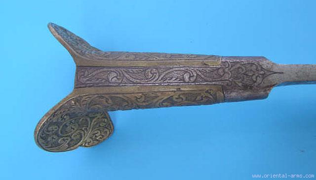

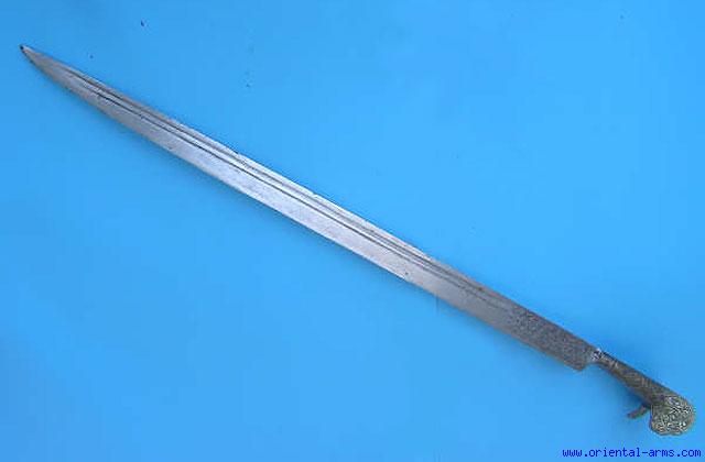

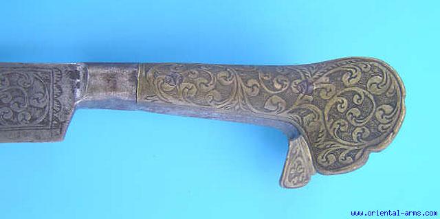

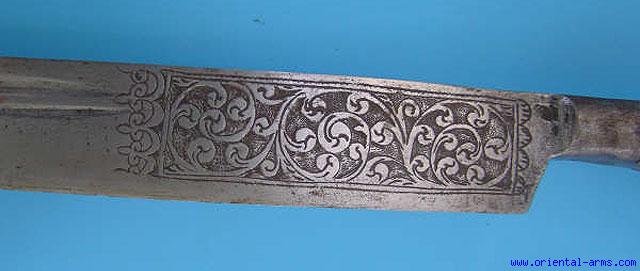

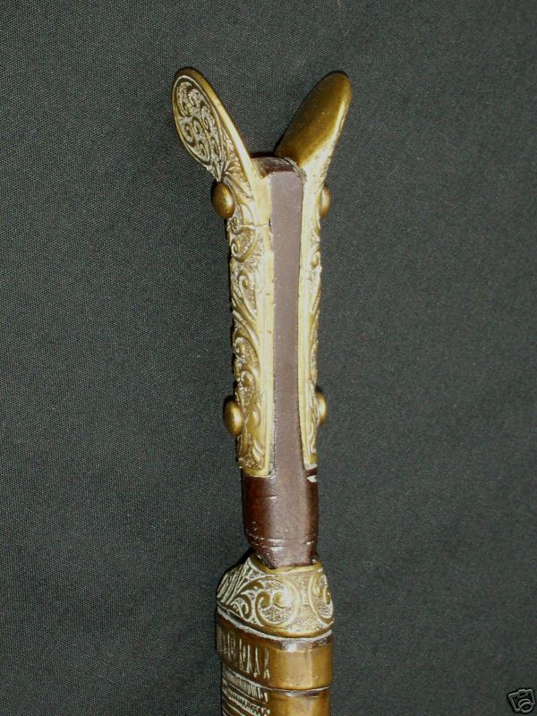

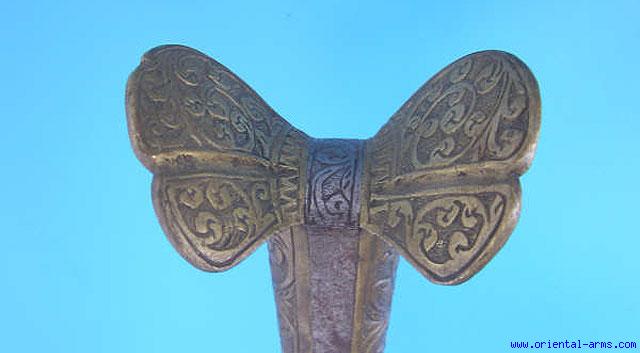

Here is the "yataghan" from Oriental-Arms: http://www.oriental-arms.com/photos.php?id=2703
And the pics...The scroll work is very very similar, and the blade shape is odd.

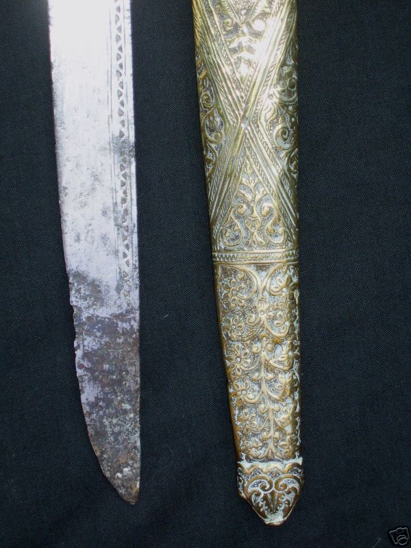

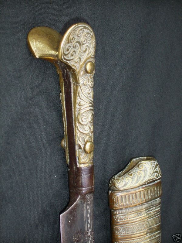

Compared to the yataghan flyssa from the auction:

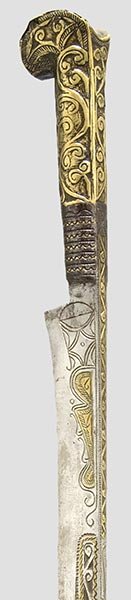

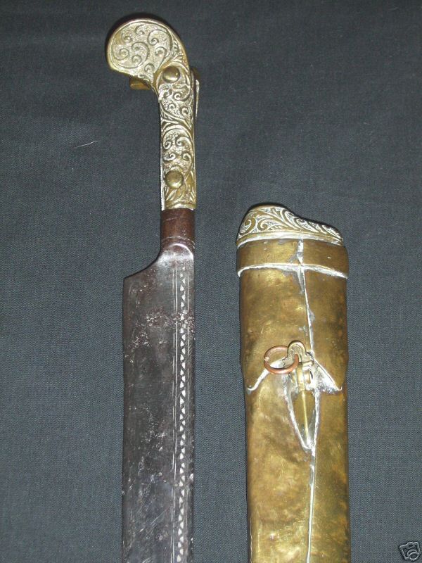

Compared to another yataghan with very different construction, not seen on the majority of yataghan. Again, notice the scroll/foliage brasswork. The blade in this case even had the triangular ornaments close to the spine, often seen on flyssa.
Thoughts? I recall Ham had once asserted that this motif is a common Anatolian one. Could we see these three swords as part of a continuous link?

I'm very curious about that last yataghan. Oriental-Arms listed it as eastern European. The construction is so odd though. The two big nobs are reminiscent of Caucasian/Persian kindjals and qamas. I have not yet seen this scrolls/foliage motif on Balkan crafts, does anyone know if it is indeed common, or how often it occurs?
Same for Anatolian work. Do scrolls in brass occur in other art forms?
Do they occur on Caucasian art?
Specifically Circassian? (Reference to this thread: Flyssa in St-Petersburg Museum where Ariel showed Circassian and Tatar sabres as a possible inspiration for the flyssa)
If not, can we say this is an indigeneous kabyle motif?

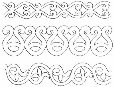

Here is a site on Circassian arts. In their crafts and traditional motifs sections there are some pictures that with a stretch could be quite similar to our flyssa decoration: http://www.adygaunion.com/gallery/index.php?cat=4
Here is some of their foliage work

If only the Hermann's example had a scabbard, it would speak volumes, and, I think, answer many questions...but alas...no scabbard.
As is, I see it as only an Ottoman influence on a traditional flyssa.
