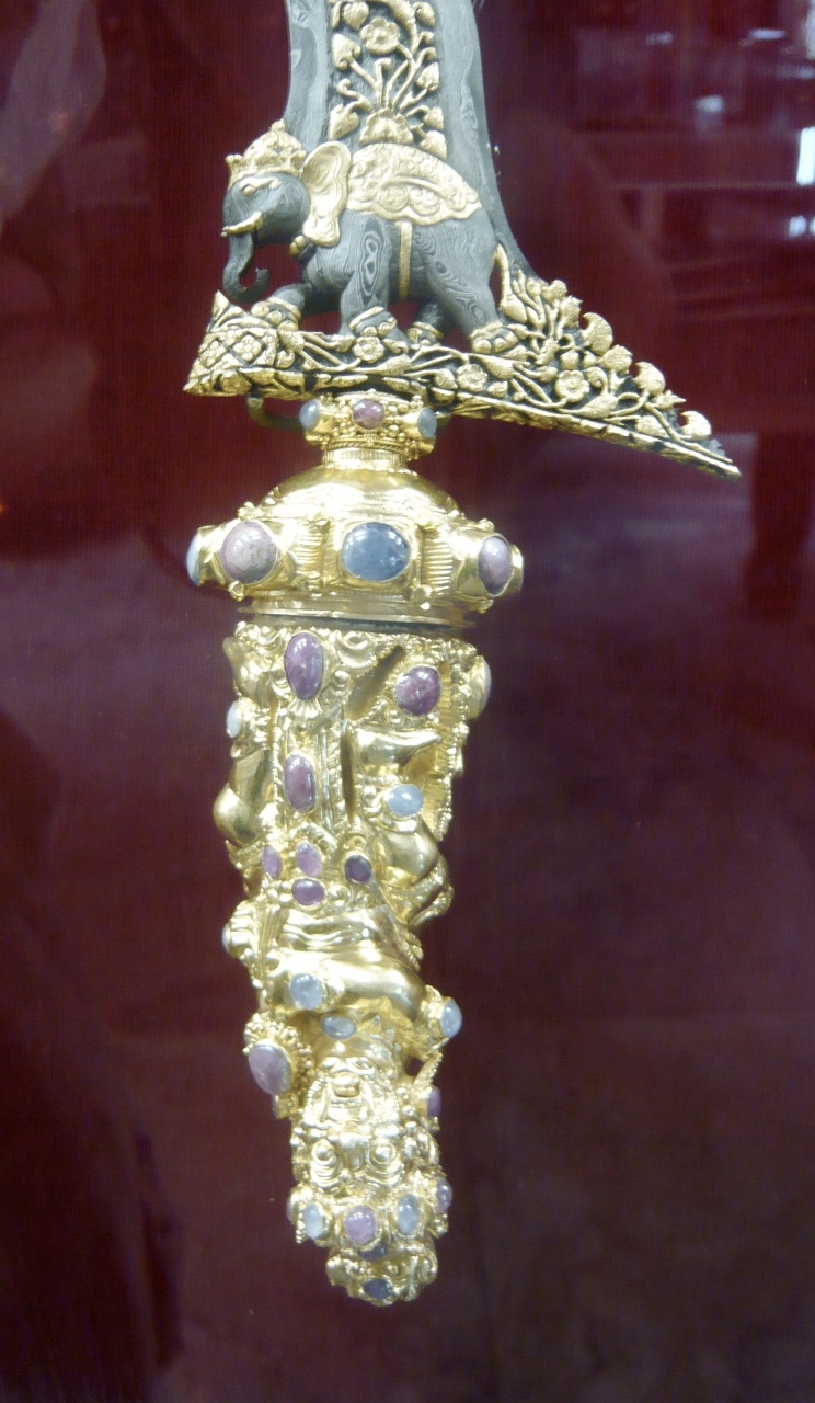

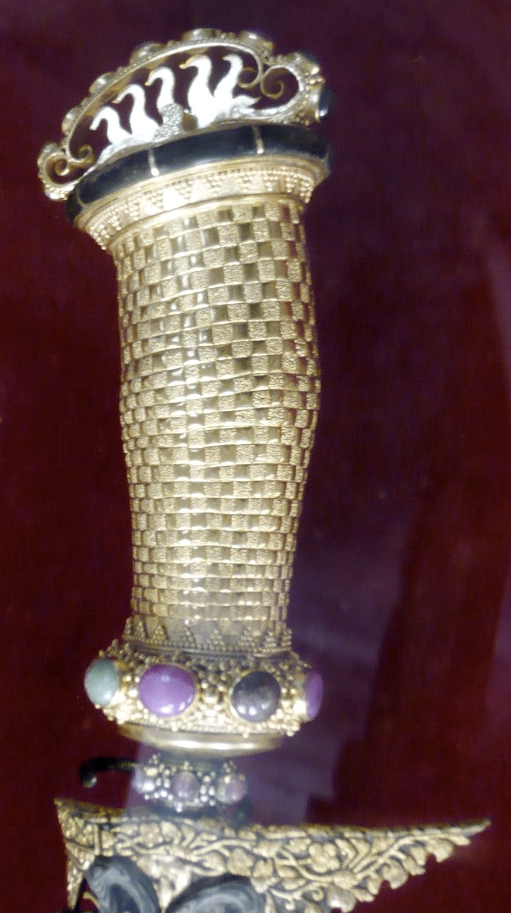

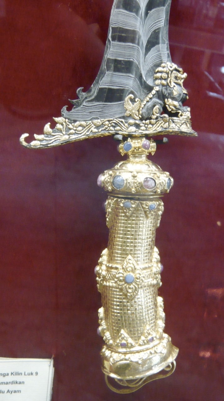

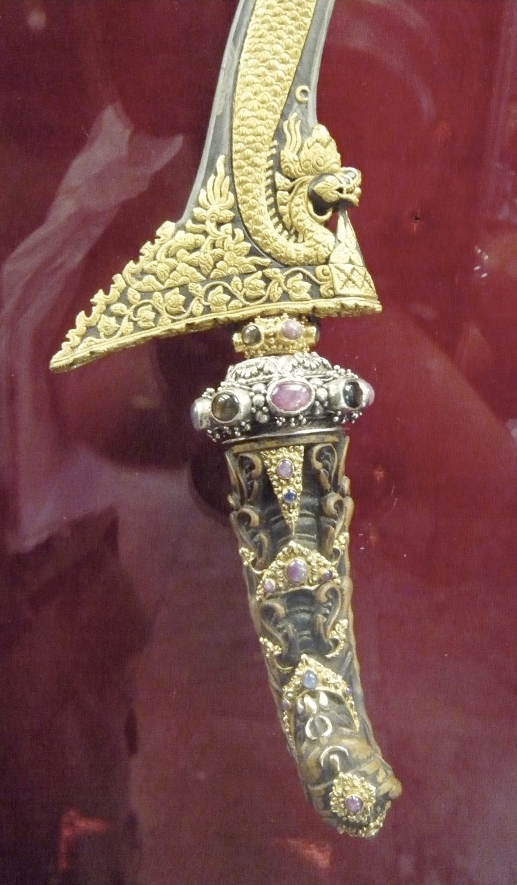

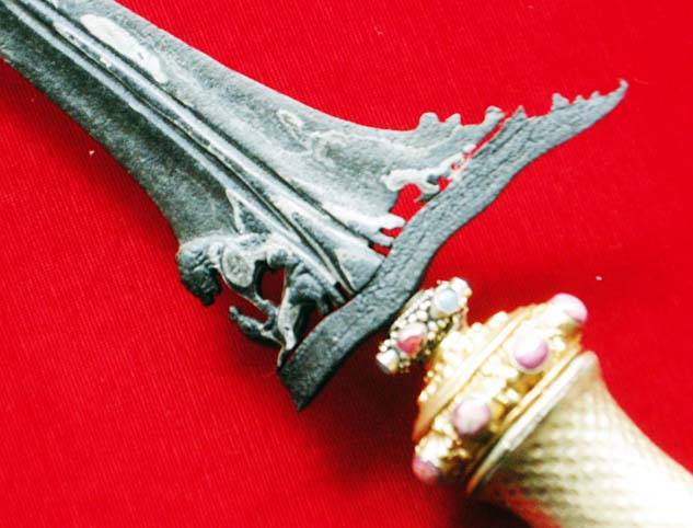

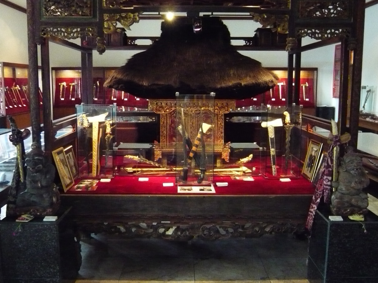

from Neka museum in Ubud (Bali) some photos of permanent marvellous keris exposition
Old 27th March 2008, 04:58 PM   #2
Posts: 7,297
Wow...you must have felt like you had died and gone to heaven!
Can you provide any context to this exhibit? The work is absolutely beautiful, but the close-ups look like fairly recent pieces. What is the source of this lovely collections?

Posts: 3,191
I must agree with David these are recently made keris the blades look like good Maduran made copies to me. I see that there is a secondary bevel on the edges of the blades that is a dead give away

Keris with dapur Kilin and Nogo Sapto are look very nice.
Even both of them it seem new made (tangguh kamardikan).
hhmm.......nice object to painted

Old 27th March 2008, 07:22 PM   #6
Posts: 7,297
From the museum's website comes this discription which i assume is the exhibit in question:
Dozens of antique and new keris from the collection of Suteja Neka, paintings from the Neka Art Museum with keris in them along with photographs by its curator Garrett Kam showing keris in Balinese costumes, ceremonies and dances are highlighted. This will be complemented by an exhibition of traditional Balinese paintings from private collections in Jakarta organized by Larasati Auctioneers and Friends of Larasati. Two books will be launched: The Neka Art Museum in Modern Balinese History: Art and the Passage of Time by Garrett Kam, and Mimpi Jadi Kenyata an compiled by Kardi Suteja and Wahyu Suteja, sons of Suteja Neka and Gusti Made Srimin. NOTE: The opening gala event is by invitation only.
They do mention that at least some of these keris are new and i would suspect that Madura is a likely source for them. They do seem like nice examples of new work so i don't see much problem with it if they are indeed presented as such. I wonder what the balance of new/old pieces is for this show. The one "old" keris photo that they show on the site is too small to tell much, but is described as the 17th century royal keris Ki Baju Rante (Venerable Armored Coat).
Old 28th March 2008, 12:02 AM   #7
Posts: 7,229
Yes, the close-ups are of recent keris, but they appear to be very fine recent keris.
In Indonesia today fine keris by the top current makers are highly regarded as serious art-work, they command very high prices, and are often sold before they are finished.
Lew, when you say:- "---there is a secondary bevel on the edges of the blades that is a dead give away---" I suspect that you are probably talking about the kusen (also "gusen"). The kusen is a correct feature of any high quality blade in good condition, you will find it in well maintained Surakarta blades of the 19th century, and it exists on older blades that left Jawa and Bali when they were still new. It is not found in blades that lack artistic excellence, and it is not found in blades where considerable erosion has occurred, but we do expect to see this feature in any well maintained blade with any pretensions at all to artistic expression.

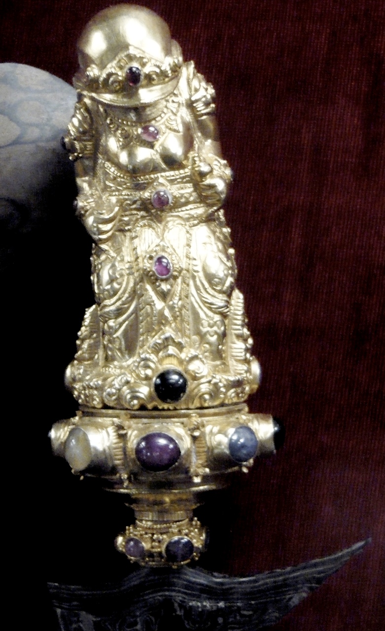

Dear Marco and All,
I'm sorry for joining this discussion so late. I'd like to add some informations on Neka Art Museum in Ubud, especially on its permanent exhibition on keris. I had visited this museum too on February and met with Mr Neka, the owner. (Pls see the photo below, Mr Neka hold the marvelous keris of Tantri Singa-Lembu or Lion Fighting Bull from Tantri Fable, 15th century). I had taken these photos with his permission.
This Neka Keris Museum is also a place where you can see good "documentations" of contemporary kerises which were made by contemporary empus and still living Indonesian keris makers. Altogether, there are total 218 kerises -- including 18 old Balinese keris heritages. It exhibits permanently -- not only kerises which were made by Balinese keris maker like Ketut Mudra, or young Madurese keris maker like Moh Basri -- but also kerises which were made by javanese keris makers like the late Empu Djeno from Jogjakarta. Or Solonese keris maker like Subandi Supaningrat, Sukamdi, Suyanto etc.
The Keris Museum in Ubud is only a small part of the greater Neka Art Museum which were built on a hill-site of about 10.000 m2, not far from the Spanish painter's gallery Antonio Blanco. Hundreds of very fine paintings are exhibited in more than 7 galleries. From various traditional Balinese paintings, to foreign paintings like of Arie Smit (Holland) during his staying in Bali.
Neka himself is a real collector, although he has also keris-maker blood. That is why he bears name "Pande" (Pande Wayan Suteja Neka) in front of his name. He said to me, that now he stop collecting new paintings but beginning collecting kerises. The establishment of permanent keris exhibition is also meant for commemorating the 25th aniversary of his gallery, on July 27, 2007, He said, he was inspired to make keris museum after visiting a keris exhibition in Bentara Budaya Jakarta on 1996.
It takes about an hour by (hiring) car from Kuta. And you will see so many art galleries in this Ubud site -- as you know already. Not only Neka Gallery, or Antonio Blanco Gallery. Ubud, is really an interesting place to visit for anybody who loves paintings and also kerises...
(Pictures below, four photos of keris Tantri Singa-Lembu, and then one photo each of 13th century keris pijetan of old Balinese kingdom of Karangasem, keris with 5 luks Singa Barong of Gianyar kingdom, and keris of Puri Agung Karangasem named Ki Baju Rante 17th century...)
