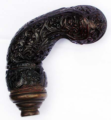

Dear All,
Would you be so kind to help me, please? I have “problem” with restoring this (Sumbawa?) hilt that I bought from an antique-shop in Jakarta recently. Unfortunately, it’s just so heavily coated, with kind of clear-paint spray (we used to call it, “phylox” clear paint).
Is it possible to remove the clear-coating with kind of chemical liquid, without “hurting” the carved-wood of the handle? What kind of liquid, please?

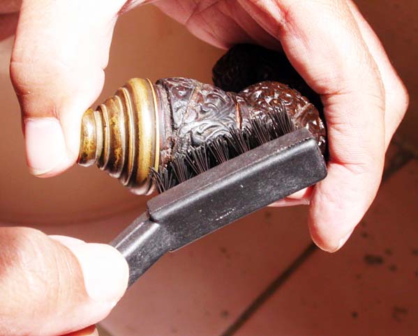

I have used Acetone only one time for a handle and the result was good. It was a classic Solo hit badly and heavy painted of dark brown.
I put the whole hit for a day in a glass fullof acetone (completely dipped in the liquid). After by a toothbrush I removed the paint in the pits.
Then by car-body past i smoothed the wood (a little past remained in the pits) and at last I used light brown shoes past and a little olive oil some time after.
See the picture
