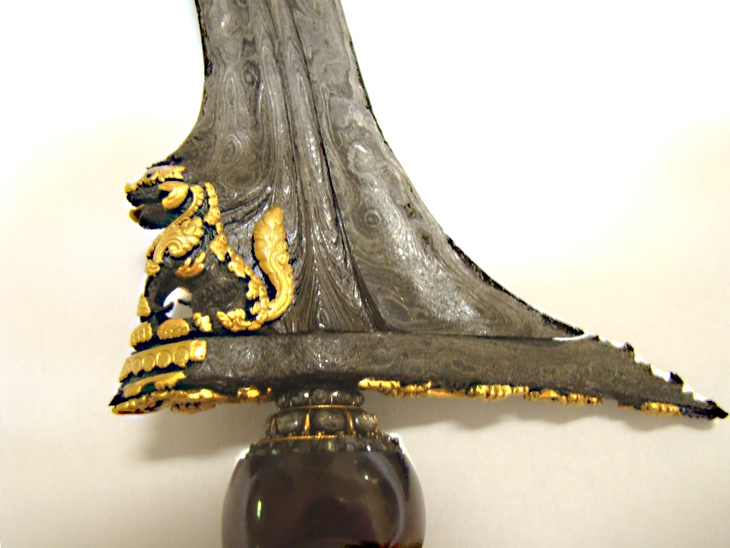

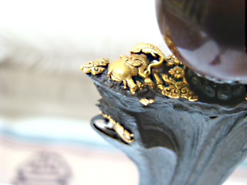

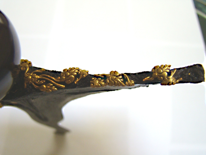

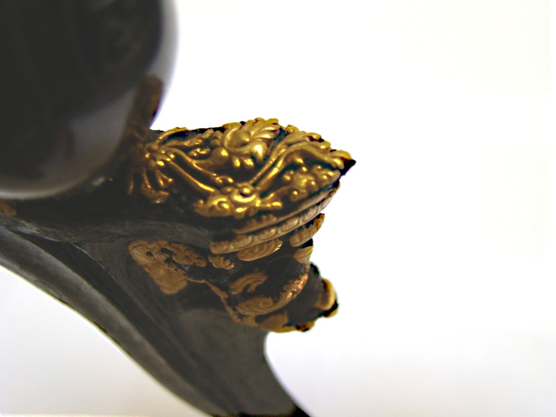

It has been noted that the Javanese gold work is recognized as the best in that the blade is carved and heavily prepared to accept lumps of gold which are hammered on to the prepared surfaces. This gold is then carved to provide the final effect the goldsmith wishes. This work was thought so highly of that people who could afford it sent pieces from the other islands to Java to have this work done and possibly provided for Javanese goldsmiths to reside on their islands while they accomplished this type of work.
The first piece that is used to illustrate this technique follows. Note that the gold has been dislodged and lost in portions of this piece which allows you to see how the iron was prepared. This happens over time no matter how careful the owner is. Of course sometimes an owner strips the gold off of a piece and sells it for its raw material value if he falls upon hard times.
Note the missing gold on the hip of the Singa and some of the missing stems and flowers on the ganja.
