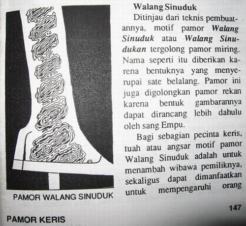

Is it possible to see a CLEAR photo (no a pen/pencil picture) of the "true" pamor Walang Sinudhuk? (I saw in internet a photo of pamor Sinudhukan but it seem a kind of gamelan pamor)
From a long time I ask about this pamor. The answer always is : "Ohh.. i's very difficult to find!"
Is this pamor REAL ? (OR IS A LEGEND?)

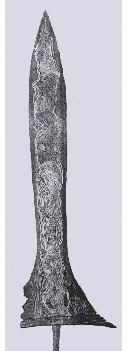

Marco
I may be getting a bit old, but I just leafed through "Keris Jawa" and did not see a sample of the pamor under discussion.
The illustration in Tammens is:
Mick is offline   Reply With Quote

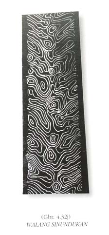

Dear All,
Would you mind if I send the illustration of Pamor Walang Sinudukan according to Mr Haryono Haryoguritno's "Keris Jawa, Antara Mistik dan Nalar"? Hopefully this illustration (page 208) will help you...
Ganjawulung

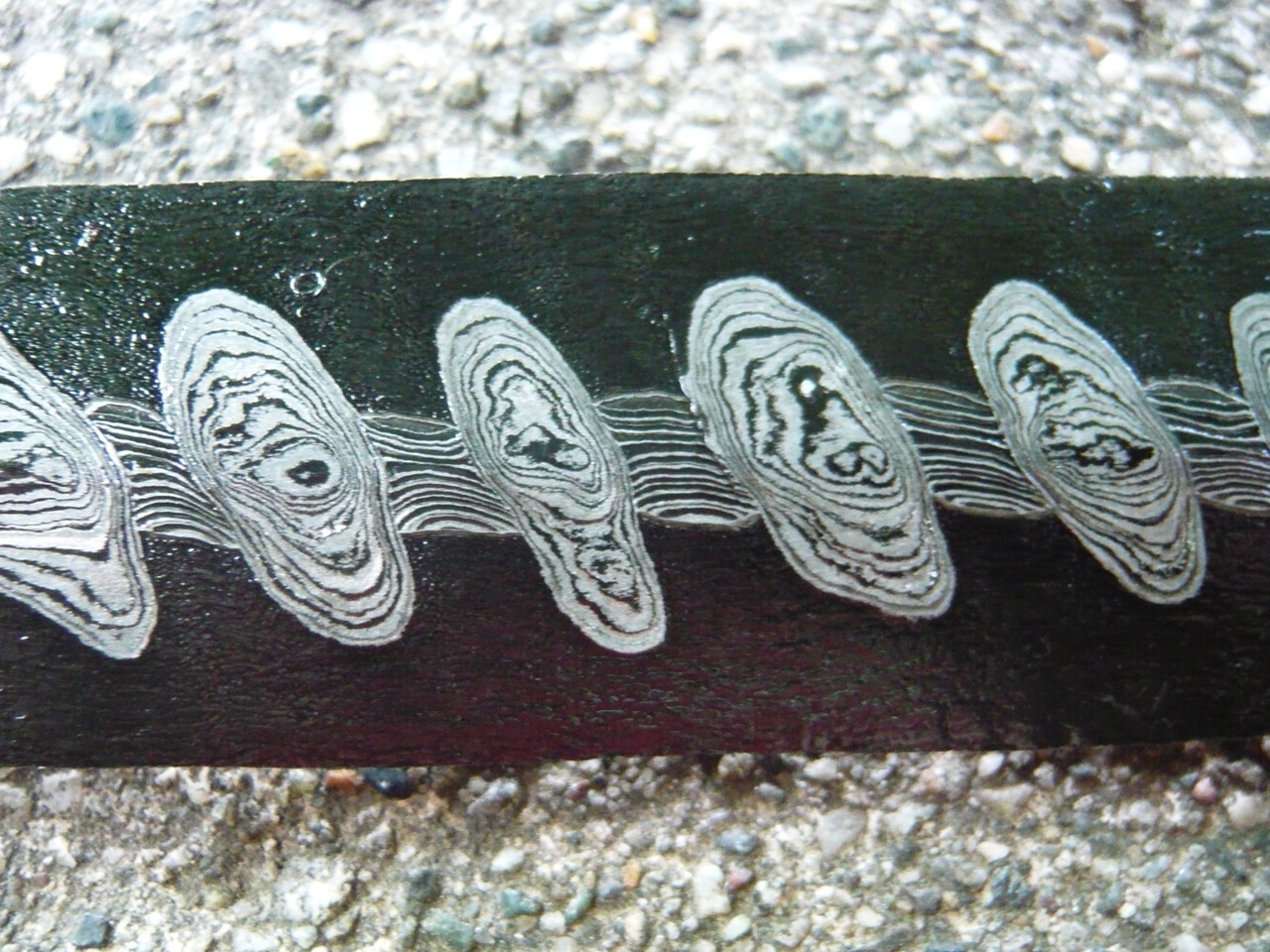

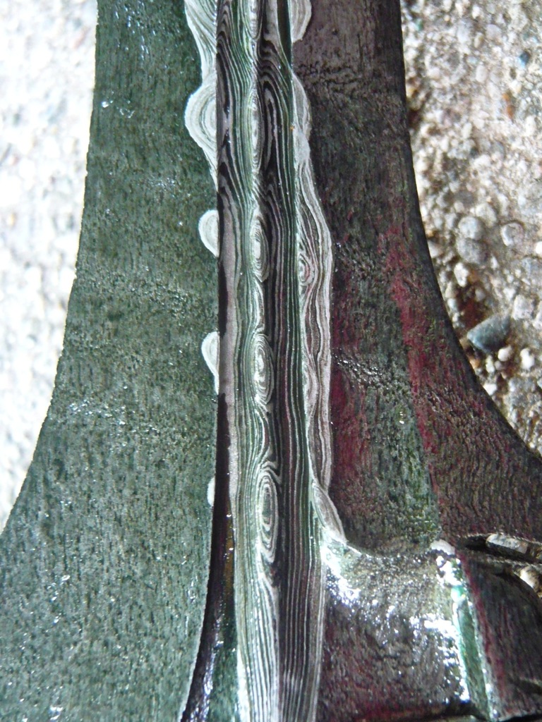

Hello dear all keris lovers,
Sugeng enjang Mas Cahya...

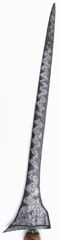

Just want to give my humble opinion regarding pamor Walang Sinuduk although me my self didn't have the keris with pamor Walang Sinuduk yet
Walang, in Jawanese term mean grasshopper or locust. Sinuduk (from source word "Suduk") mean skewer / to stick (hard to translate into English ). So, Walang Sinuduk mean the grasshopper which skewered with a stick.
Walang known as plant disease for farmer (Jawanese people known as agriculture societies). So, Walang Sinuduk has deep meaning that if we need to avoid the plant disease, so we must wipe the Walang at field (wet rice field). And if we can do that, we will get much appreciation or respect from communities of farmers. So that why this pamor believed that it can bring the owner to have more authorities/power --(which gave from communities).
Indeed that many book had illustrated the form of this pamor. but every book gave different illustrations of each other. So, which the illustraton nearest with the from of this pamor as it was
I think the form of this pamor should be similiar with the grasshopper which skewered.
Here I posted another illustrations from book "Pamor Keris" by Bambang Harsrinuksmo.
Also the keris collection of Mr. Budi Warsonugroho :
http://kerisbw.fotopic.net/c589653.html
http://kerisbw.fotopic.net/p16631016.html
nyuwun duko saderengipun Pak Budi, dhuwung panjenengan dalem agem contoh
Well, thats just my humble opinion
Salaam,
Manshur Hidayat

ganjawulung
Glad you put my nose on the right page. I must have had an "old moment" while leafing through the book. I remember the page but did not pick up on the pamor statement. This is possibly the best representation of this type of pamor around.
Marco
The representations of examples in "Keris Jawa" were taken from actual blades that were in Haryono's hands at one time or another. So this is about as near as you are going to get to a blade in hand.

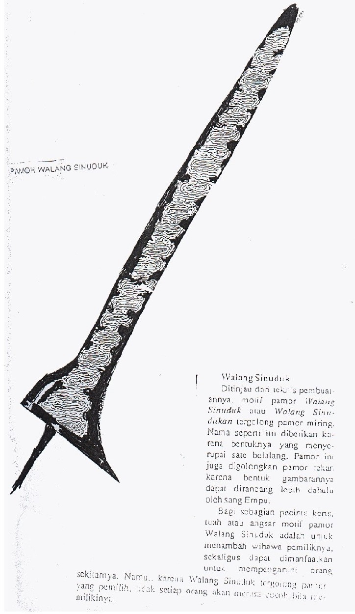

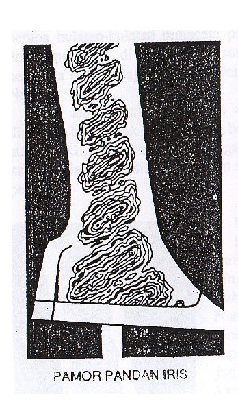

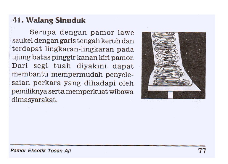

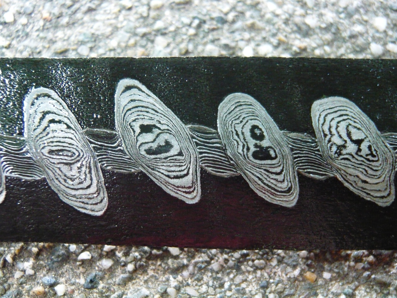

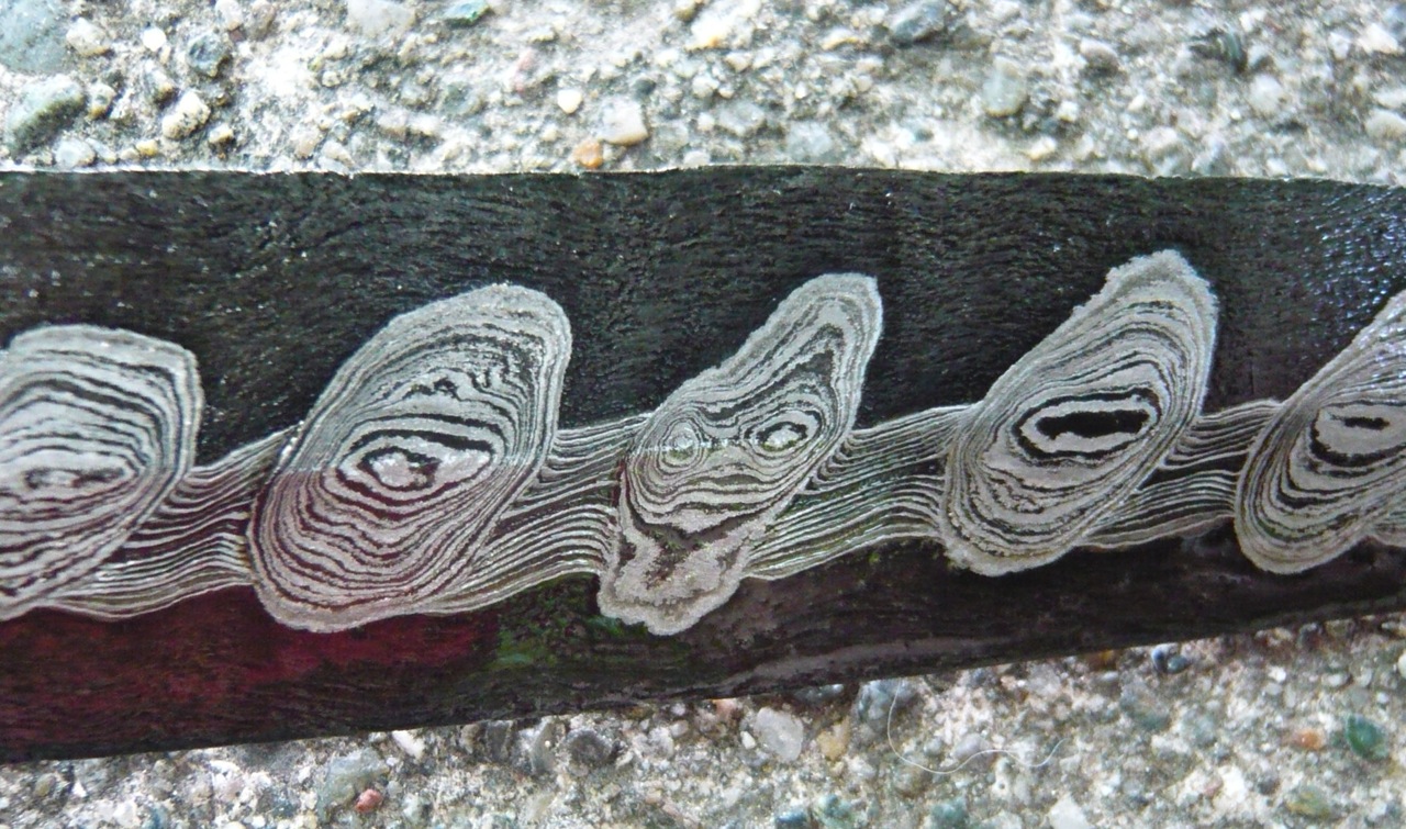

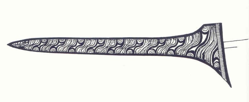

Mans, the pamor in your thread seems from bonang rineteng style. In the book "Pamor Keris" there is another pamor with the same pattern (I put picture below)
Here i put also some "pictures" that well illustrate the confusion in my brain.
one from M. Roeslan book "dunia keris pusaka"
one from a pamor's book by Wibatsu Harianto
another from A. Zazuli book
Old 18th May 2007, 03:12 PM   #18
Alam Shah
Alam Shah's Avatar
Join Date: Jan 2005
Location: Singapore
Posts: 1,248
Marco,
Let's try to straight things out (if possible).
1) Your 1st diagram, I don't think it's pamor pandan iras. Refer to Haryono's Keris Jawa, pg: 208, Fig: 4.32j = Walang Sinundukan, Fig: 4.32lk = Pandan Iras. It's different altogether, although the construction method are similar.
2) Your 2nd picture looks like pamor Gumbala Geni, to me... looks like "smoke rising", in abstract form.
3) and 4) pamor are same with the 1st pic. Same doesn't mean it's correct.
It just means that they copied from the same reference. Even the texts are the same, (Hidayat's eg from Pamor Keris, your 1st and 3rd pictures are the same)... (need to check what pamor is it, btw).
Imho, I guess these authors might have simply 'copy and paste' without much research.

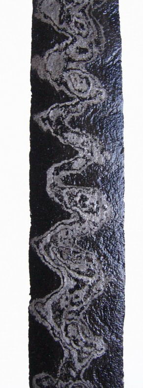

Pak Newsteel ,

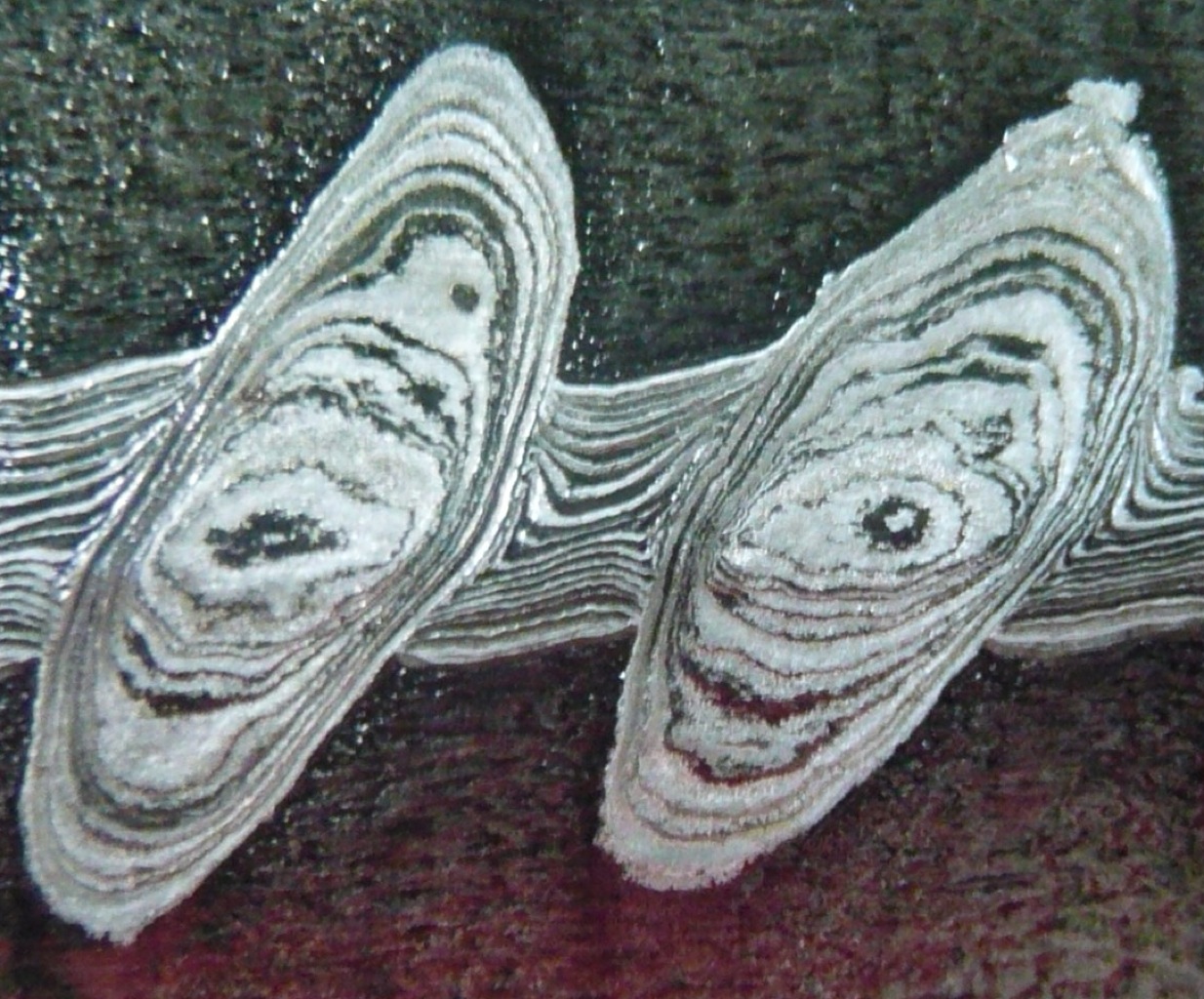

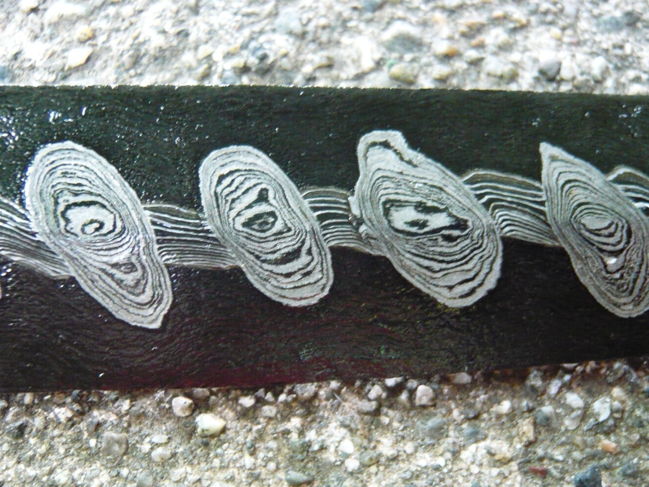

I think pamor keris must be definited, and we must choose the illustrated which nearest same with illustrated on the book (as Pakem). That because pamor of the keris easier to definited that Tangguh which has more complicated aspects to analysis the keris.
Here I posted my keris with has similiar pamor as illustrated on Pamor Keris book by Bambang Harsrinuksmo. But in the other book (Keris jawa ; Antara Mistik dan Nalar by Haryono Haryoguritno p; 121) called as Ilining Warih. So, do my keris can be called has pamor Walang Sinuduk
Marco, I think pamor Bonang Rinenteng or Bonang Sarenteng has different form with Walang Sinuduk (Keris with pamor Bonang Sarenteng : http://keris.fotopic.net/c1045903.html)
Mans is offline   Reply With Quote

Thanks Mans for your photo
I agrre with you
Old 20th May 2007, 11:57 AM   #21
Alam Shah

Thanks Hidayat, now we see an actual Walang Sinudhuk pamor form.
Btw, congrats on the publishing of your article in PAMOR magazine (No.3 March 2007), titled: "Keris Luk 9, Simbol Kesempurnaan Hidup" which literally translated to "Luk 9 Keris, Symbol of an Ideal Life" in the Philosophy section.

I expect that pamor of my keris is Walang Sinuduk..

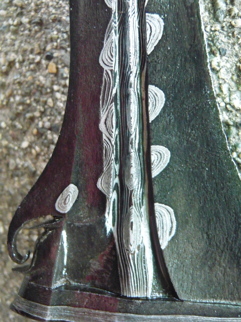

Old 24th May 2009, 02:39 PM   #23
Marcokeris
Marcokeris's Avatar
Location: Italy
Posts: 928

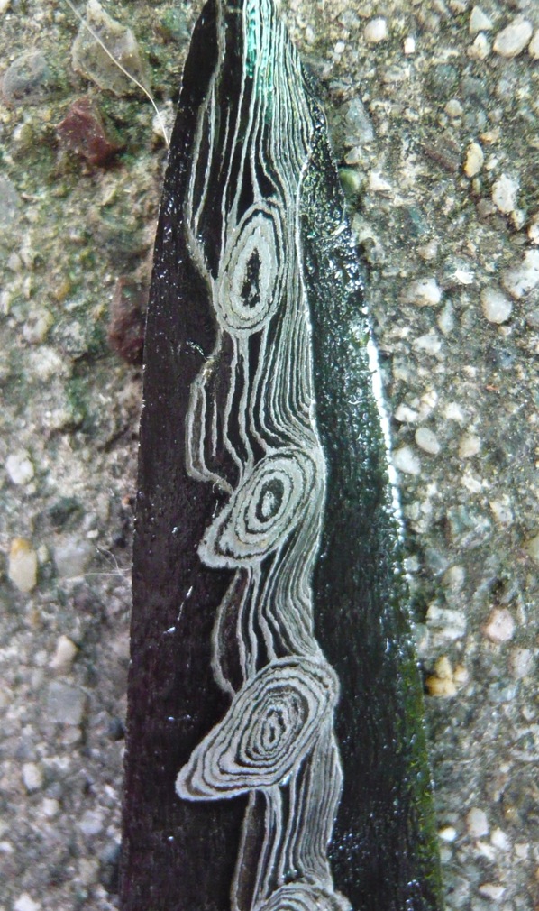

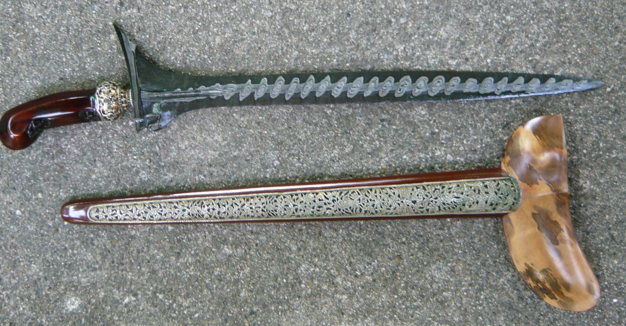

A pamor barbecue full of.....

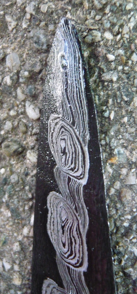

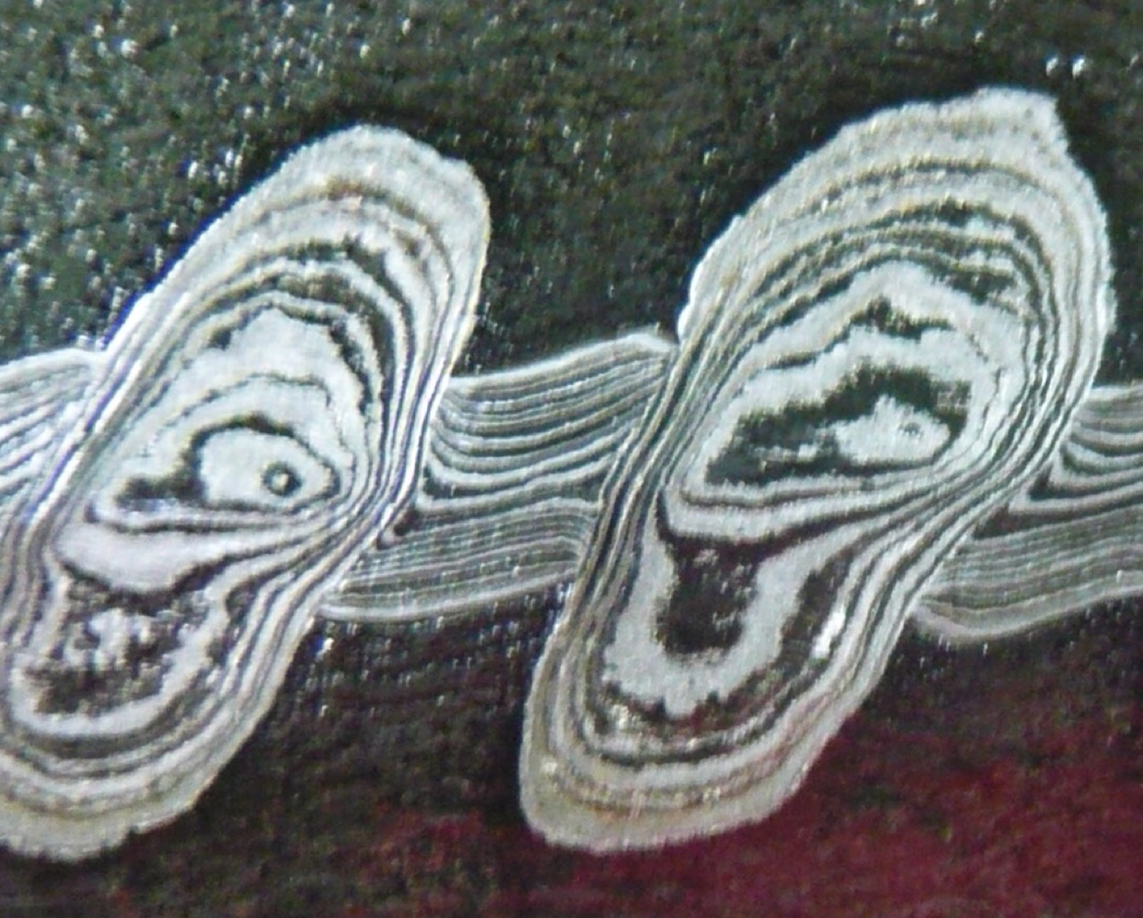

Old 24th May 2009, 02:47 PM   #24
Marcokeris
Marcokeris's Avatar
Location: Italy
Posts: 928
....ghosts!

Mas Marco,
Wouwww... how wonderful it is. Where and when did you find it?
Congratulation.
warm salam,
OeS
Raden Usman Djogja is offline   Reply With Quote
Old 25th May 2009, 08:44 AM   #26
Marcokeris
Marcokeris's Avatar
Location: Italy
Posts: 928
Thanks Raden
I found this keris in Yogya in summer 07.
The blade had another sarong - handle but the seller helped me to change them
Old 25th May 2009, 11:38 PM   #27
