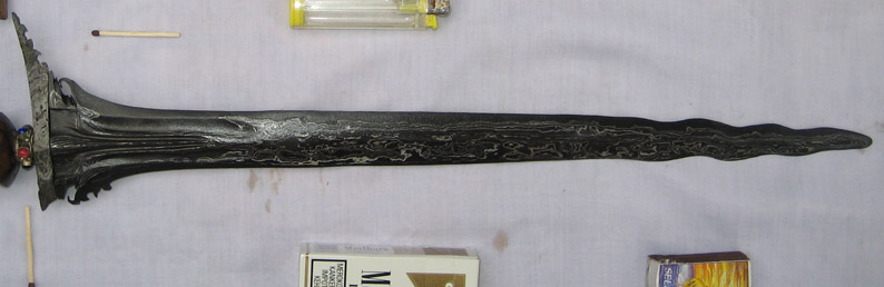

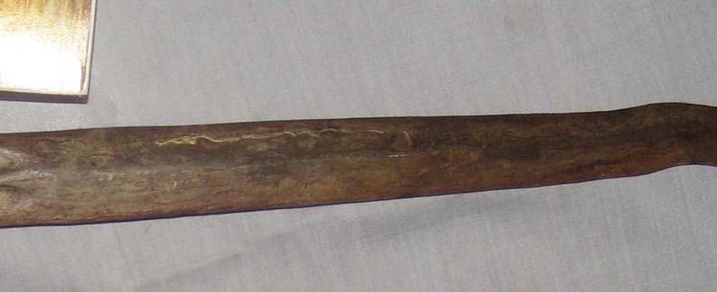

HI GUYS, friend of mine sent me these pictures.
What do you think? Is it old or just piece of junk?
Is there someone have eyes like SUPERMAN?
Oh!! What happened with my friend today?

No no, not junk at all! I think this is a very nice Balinese piece. It could do with a clean and etch. I can't tell the age, and I do not know the dapur, although I've seen it before. Maybe not too old? but looks good to me.

Posts: 6,441
Arrow Dapur / Age
Karna Tinanding ?
1900 - pre WW2 ?

A little cleaning and etching would be better to judge the blade profile. I don't think this piece is a junk at all. This is rather a good and rare dapur (Karna Tinanding) with long straight blade and luks 5 or 7 at near tip. One exceptional detail is that one kembang kacang has jenggot and other is plain smooth curve. Fittings are of Balinese style (maybe Lombok). How old...? I'm not sure but assume this could be dated end 19th century.
Again, would appreaciate if this blade is clean and etch so that we could comment further.

Hi Rick...
As I know Karna Tinanding is straight keris, but this keris at the top (ujung keris) have 6 luk?

Originally Posted by cahaya
Hi Rick...
I believe it's, dapur Pandawa Karna Tinanding. I counted 7 luks. Not junk in my opinion.
The yellowish stain to the blade may be due to improper cleaning.

Nice piece .
Clean it up.
I am not sure or the 2nd kembang katjang (telaleh gadjah) is added later on ?
The 2nd lambeh gadjah looks a little different too.
After cleaning and washing the keris will be sure look better, but also spurs of modifications will occur more.

Also in my opinion no a junk!
The keris could be from Lombok and the blade seems to had been in contact with lemon or lime juice

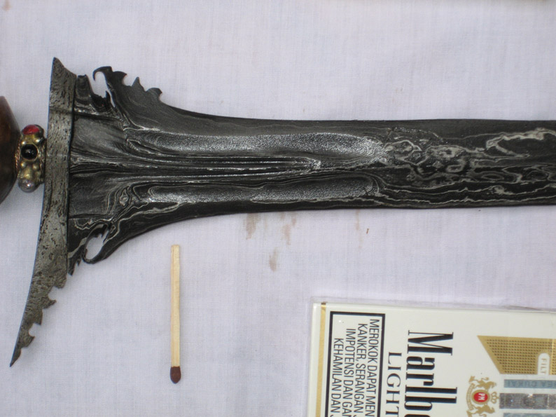

Hi GUYS, that's what I thought too. (KARNO TINANDING).
But 6 luk on top? hhmm
My opinion would say, M A Y B E....the EMPU who made this blade just copy the original KARNO TINANDING style (let say first pakem in era before) and change it little bit with luk. Because I'm agree with Rick about age (my thought was around 70-80 yrs).
Guys sorry, It is just like teory of reality from A KING who copied a castle of A GREAT KING'S castle.
Is it reasonable GUYS? YOUR OPINIONS PLEASE?

Pandawa means = 5 people (Wayang stories) , so if keris Pandawa Karno Tinanding must be 5 luk not 6 or 7 luk....

- Strictly speaking, Pandawa does not mean five. In the Mahabharata epic, Pandawa was the name of the five Bharata brothers (heroes), sons of Pandhu. They are referred to as: Pancha Pandhava (Sanskrit)/Pandawa Lima (Indo)/Pandawa Five.
However, in Indo, some people do take the word Pandawa to be synonymous with five.
Although the Dapur Pandawa (and its variations) is merely a subset of the dapurs for the 5-Eluk keris, many people in Indo generally refer to ANY 5-Eluk keris as a 'Pandawa'.
- I agree that the particular keris shown above is a 7-Eluk.
- I agree that the dapur on the sor-soran in the picture looks like it is acceptable as one of the forms of Karna Tinanding. However, isn't Karna Tinanding generally restricted to straight kerises?
Anyway, just my thoughts, for what they're worth.

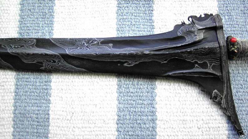

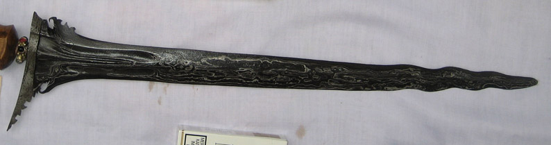

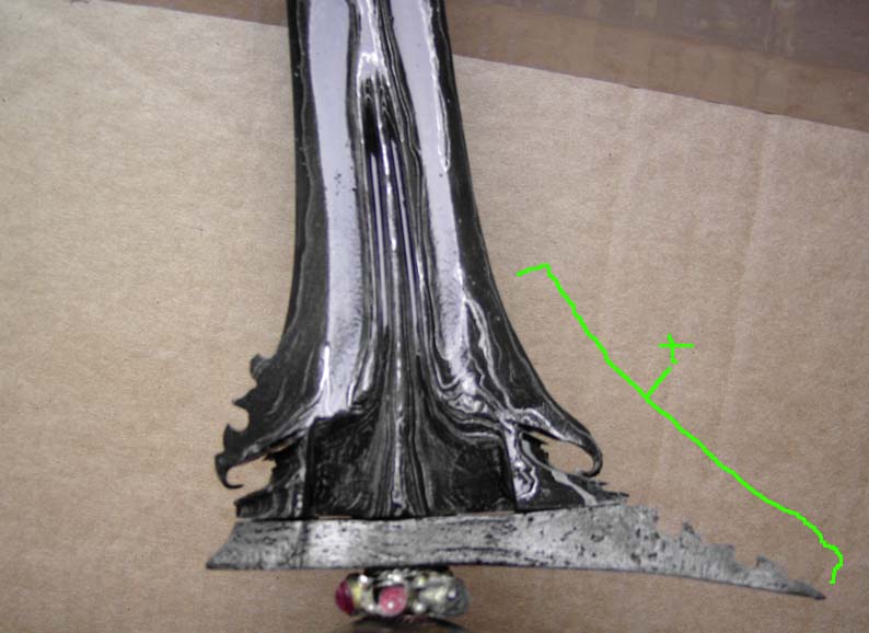

Hi again GUYS, today the blade is cleaned. Now, It's time for me to learn again
Any opinions?

Very nice cleaning and etching job!

I strongly suspect that this keris has had alterations, especially after this cleaning where you can follow the pamor lines. That certainlt doesn't make it junk, but in my eyes it makes it less desirable than it would be in it's original dapur.
Nice cleaning job.

The lower quarter areas does seems modified. The two central grooves (kruwingan) seems to be... the pamor looks 'disturbed'. Probably some other dapur type before it is modified into a Karno Tinanding.

The dapur as it appears now lacks a certain flow and harmony; the execution is not too impressive IMO.

Hi Dave, the Keris Karno Tinanding is already came yesterday.
I looked again and again and again.......

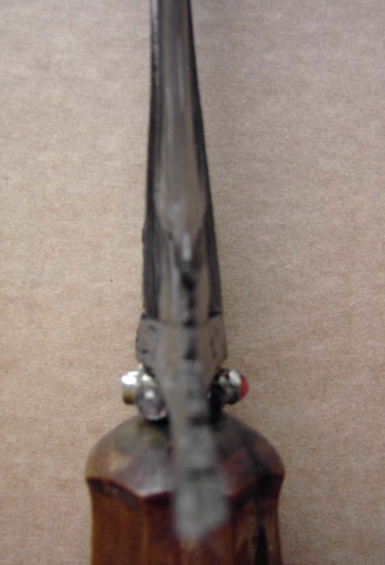

Dave, according of authentic kembang kacang of this keris, then this keris is included "keris bener".
Kembang kacang on back side (wadidhang -x-) is thick/normal.
So, if this keris was already added/modified, then kembang kacang on back side became thin (thiner), and is hard/almost impossible because how to bend/warp (melengkungkan) the kembang kacang by the time iron is hot.
Dave, kembang kacang is resulted (dihasilkan) from process of splitting-up iron/blade and (dipuntir = English?)
Again, So....if kembang kacang is already thin, then is almost impossible/hard because easy get broken.
Dave, sorry....I tried my best to explain it in your languages

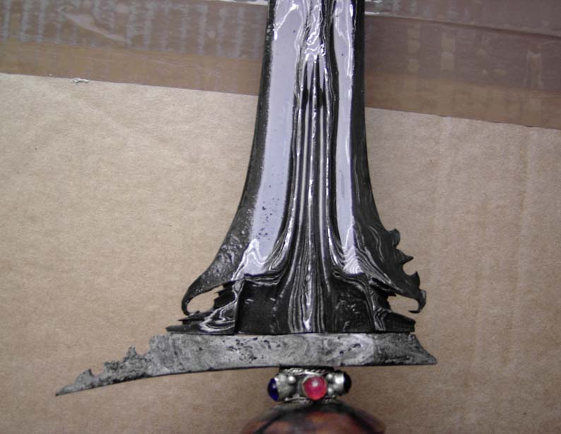

Dave, the blade is ASLIES but the pamor is not my taste

Why did the Ganja not take the stain in the same way the rest of the blade did ?
Possibly it is not made from the same forging ?
Rick is offline

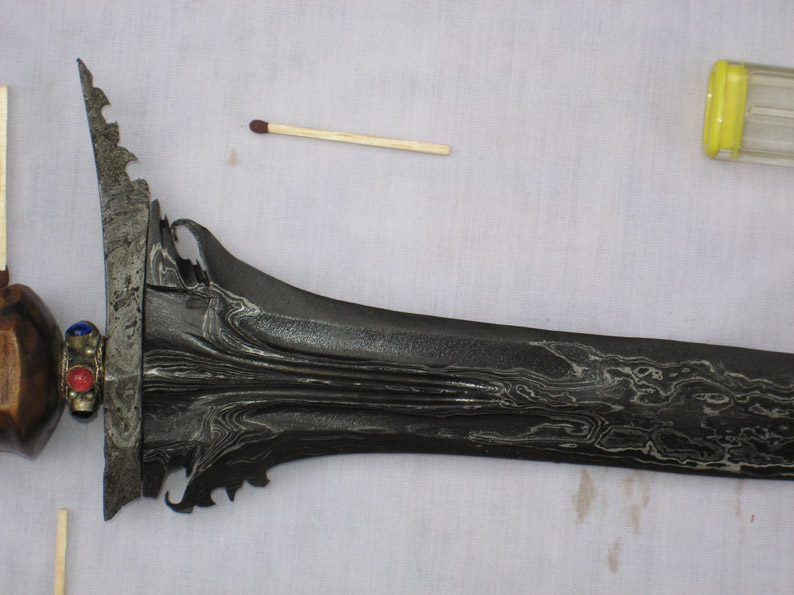

Old 5th May 2007, 06:33 AM   #30
brekele
brekele's Avatar
Join Date: Mar 2007
Posts: 208
Yes yes, you right Rick, It is possible of course and also I though same as your when first time I saw it.
Rick, many time I saw this kind of blades in Lombok THAT the blade and gonjo is not same colour and even not same material of iron and here one of them (Pls see pic carrefully).
And now come up 2 opinions of me.
1. It is possible that the gonjo is being added later on...(But not for keris
trading for now,please). We saw together when blade stil dirty.
2. It could b A TREND for keris at that time in LOMBOK that blade and gonjo is
not in same colour/material just to make a little diffrent than others.
(Rick, just my opinion).
I think, second reason is more I believed now.
hmmm.... I wonder what Alan's opinion, Rick. The man knew the field.
Rick, let me try to call him from his meditation's cave. He might want to come up. Ooops! I hope, I don't disturb him, otherwise bad dream come true.
Hi Alan, How are you today?
