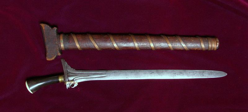

Overall length 22"
Blade Length 17.5"
Horn handle with ivory or tricadna shell cap. Looks more like tricadna
I am very curious about this piece and would welcome comments.

Absolutely stunning. Simply elegant. Can't offer any other insights. Bill, you've got the best toys! The pattern in the blade is superb.
Steve

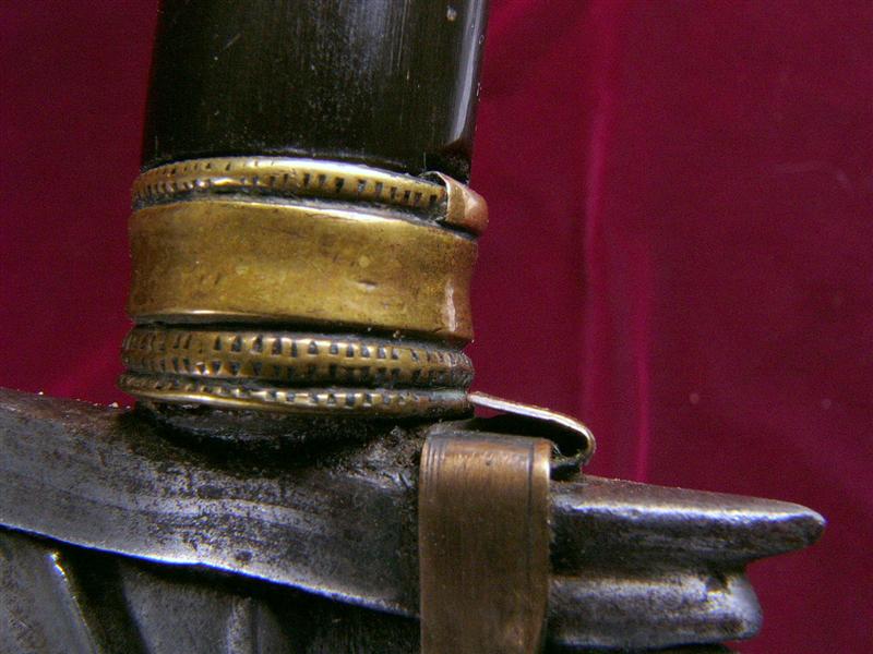

Edit, Oh one thing. The baca baca looks like a replacement made from sheet brass.

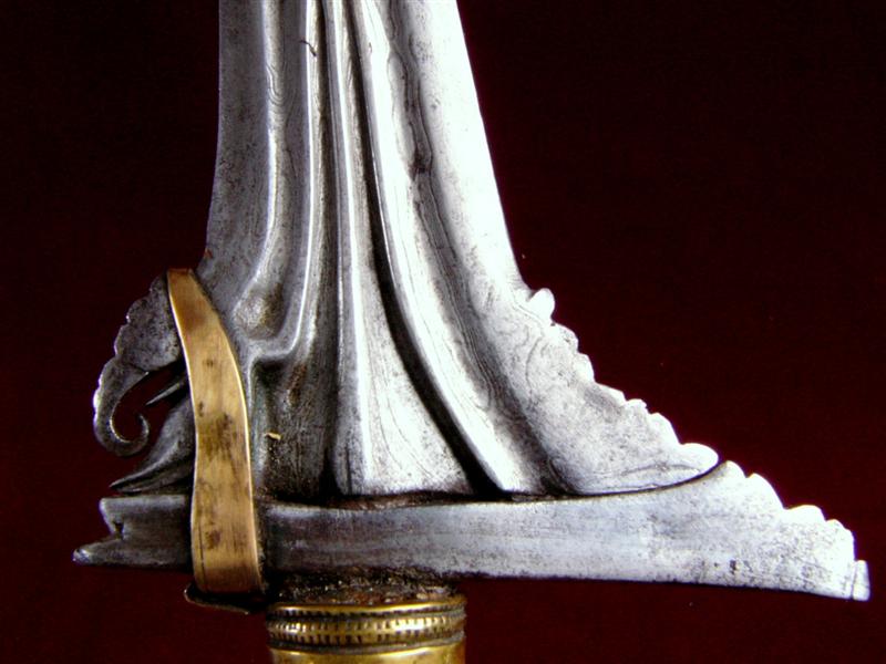

I dare say that looks like a pamored piece ya got there Bill. It would be interesting to see what some warangan would do for it.
It also has rather well formed "sogakan" and a very Indonesian "sekar kacang". Given all these factors i am inclined to suggest that this is not a Moro kris, but an Indo one, or at least made by an Indo smith who may have relocated.
We might have to move this one to the keris forum.

I am quite curious about it. Indo / Moro?

BEAUTIFUL KRIS!! IS FROM BORNEO?
CONGRATULATIONS FOR THIS PIECE

Very interesting kris, I don't recall seeing a straight blade "18thC" before. The blade tip seems to be in-between a stabbing & slashing sword. From what I can recall all the "18thC", I have seen, have a more defined point. Nice example of crossover from keris to kris. As far as "Indo smith who may have relocated", I think this kris preceeds the Philippine kris & a "relocated" smith wouldn't just start making a "kris" just because he is on, what is now, Philippine soil. Simular pattern to a wavy kris RSword & myself have posted before.

Hello Bill,
I'm pretty sure this is an ethnic Malay example - Riau, Straits or even eastern Sumatra.
I wouldn't rule out Borneo/Brunei but most examples collected from Borneo seem to have originated from Sulu (or being crafted in the same style) with some trade blades from Mindanao thrown in the mix. Also, I don't recall any pamor blade from Borneo nor Moro provenance, especially not this pamor (even welded in low contrast).
The gangya configuration is keris-like and doesn't fit into Cato's categories. So, all bets are off on this piece... However, the carving of the blade is really nicely done and I'd guess it has some real age. I'm less convinced of the fittings, especially the clamp might be a quite recent replacement.

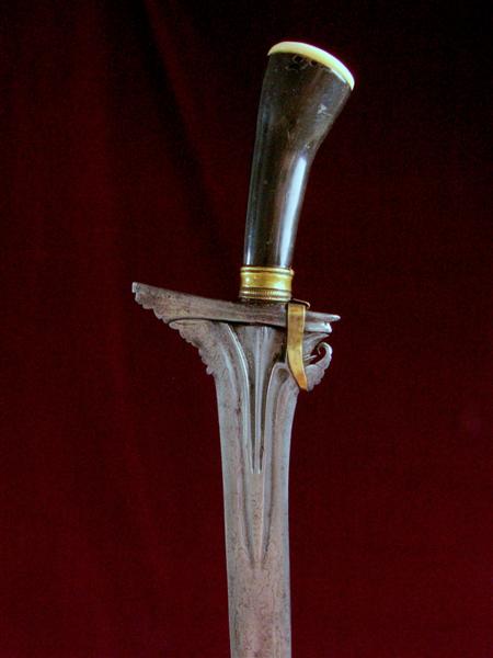

BTW, it's easy to tell ivory from giant clam shell with the help of a reasonable magnifying glass - the latter is quite porous and shows different growth rings.

Yeah Bill (Marsh), this blade seems to exhibit far too many Indo/Malay keris features to be a Moro kris. There is even a very well developed (and extented) tikel alis. The gonjo, as Kai already stated, is much more an Indo than a Moro form. And without a good staining i wouldn't even be so sure that the pamor is a low contrast material (i really think you should stain it Bill ).
Bill (the other one), i am with Kai and i don't believe this keris necessarily pre-dates the Moro kris. No, a relocated Indo/Malay smith wouldn't "just start making a "kris" because he is on Philippine soil". He would be asked to make one because that is his skill. If indeed this blade was made in Moroland and is old enough, it could be that it still exhibits Malay/Indo traits because it is transitional from Indo to Moro need. Still, if i were a betting man i would wager this blade was made in Indonesian (Sumatra or Sulawesi) early on, but still after the introduction of Moroland kris.
Kai, you may still be right about Riau or the Straits, but this type of pamor looks more like what i would associate with Celebes or Sumatra.

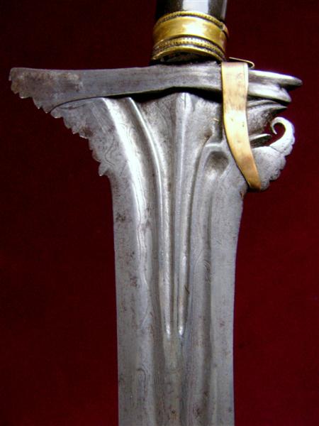

Hello David,
Yeah, that one caught my eye, too.
That's also present on the archaic Moro kris, however, the execution is different...

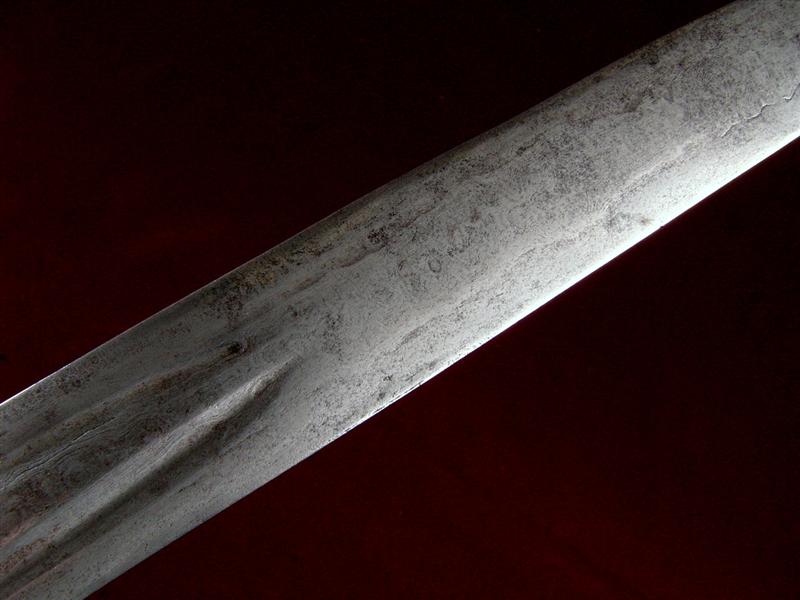

I was referring to Moro kris which are usually done in low contrast. This piece seems to be regular (if Malay/Bugis) pamor though. An etch may be enough to bring out the pattern but some warangan may also be interesting.
Yes, it's pretty common with keris blades from Palembang and places of strong Bugis influence. I'd like to hear from our Singapore/Malay members if the pamor could help in narrowing things down!

While I am not as familiar with the keris construction, this blade has a central core of mechanical twistcore sandwiched with nice lamellar cheeks. I have seen this construction in a few pieces(like the one I use to have that Bill/Chicago now has) and I have also seen a number of Moro pieces with well defined chiseling at the forte as in this example. What I have not seen as much is the sandwich type of construction in keris but as I mentioned I am not as familiar with them. My vote is that it is a Moro blade.
That's another point I was going to bring up. The twist core already present in archaic Moro kris is quite different (from 2 bars, only in the middle of the blade) from this example (which is basically identical with the classic keris blade construction).
We're not talking about the nice chiseling per se but rather the style in which it's executed - different from what I've seen in Moro kris...

I still want to point out that this blade has a central core of mechanical damascus, you can see the lines on each side, with the edges welded on. This seems more Moro in nature. Do you often find keris with a central plate with the edges welded on? Bill, I have had a few Bugis keris over the years and I don't remember a pattern exactly like this one. As I recall, they did tend to have a nice pattern down the central portion of the blade, and as I recall somewhat similar to the blade in question, but the big difference was that it was not a central core with edges welded on. It was a single blade, not of tripartite construction.
I'm pretty sure this kris/keris sundang is of 3-layered construction (San Mai) as are almost all Moro kris and keris...
This pamor pattern is common on keris Bugis - of course, the "random" types are more numerous.
Now, the handle doesn't seem terribly Moro on this piece but the scabbard to my eye looks more Moro than Malay. So, it seems to have characteristics of several cultures so is it a type of missing link?
I'd stipulate that the scabbard isn't typical for Malay keris sundang. The brass coils seem to be off and may possibly have been added more recently. Bill, any provenance for this piece?

If coming out of Indonesia during the last 60 years, this pamor blade would be very well preserved if it's a 19th century piece (which I'd guess - maybe 1850 +/- 100 years).
It would be interesting to know what type of tang it has.
Yes, yes, yes! Bill (M), any chance that you let Jose craft a nice clamp for this beauty and let him have a peek at the tang while he's at it?

I have a few observations. I don't see this being a beheading sword, the blade is light but very well-balanced. I would think it would be a bit of work to quickly cut off a head.
I would also like to see the tang and have a better clamp, but I am concerned about the handle. It already has a crack, and I am concerned the trauma of removing it would break it, though I could be wrong. It is also on very tight, so my usual method of heating the blade would probably crack the handle.
I know the handle is wrong, but do not know what would be better? So replacing this handle might be a problem. If we could arrive at a consensus of what an appropriate handle should look like, maybe I could get a right one made(?)
Could we get some better answers if I clean and stain?
I have one other picture that may provide another clue. The metal that usually goes up into the hilt seems to come out just above the ferrule.
Old 30th March 2007, 09:39 AM   #30
Hello Bill,
Removing the hilt by carefully heating the blade should be possible without damage. Horn hilts like this one almost always come with hairline cracks due to age and, especially, due to storage in low humidity. More often than not, this is not a major issue if one is not living in a very low humidity climate and can avoid humidity and temperature fluctuations. Actually, I'd expect any cracks to become smaller in Bill's controlled environment...
I'm not positive that the hilt really is wrong: Kris fitted by Malays seem to have non-standard hilts fairly often. And this one is certainly not a cheap, hurried replacement for selling this piece to unsuspecting travellers. Many of these kris also don't have clamps (or rather poor ones as in this case) but I think this blade really calls for one, and possibly a better one at that.
I'm afraid that we're mostly limited by missing data/knowledge and possibly won't get more answers. However, if I were you, I'd at least do a vinegar stain as suitable for Moro kris. If other, more experienced folks don't come up with with more info on a likely origin, I'd tempted to try warangan on this one and to let the result decide wether to leave it on...
Too much gunk but it does seem to be a fairly stout tang, isn't it?
