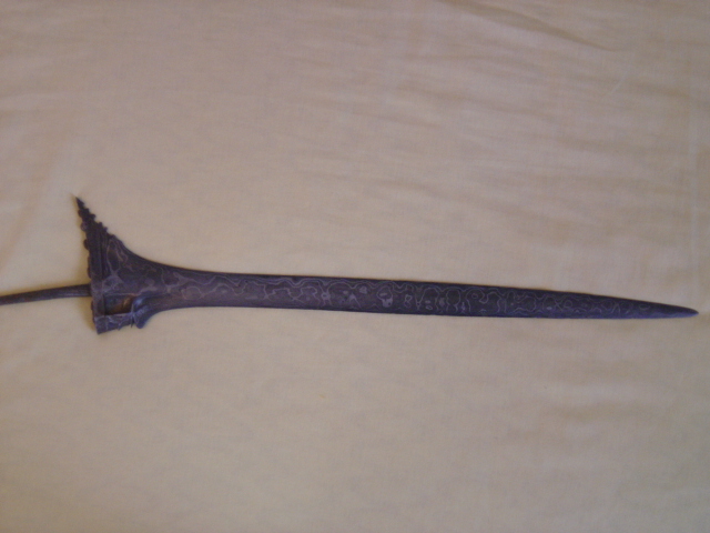

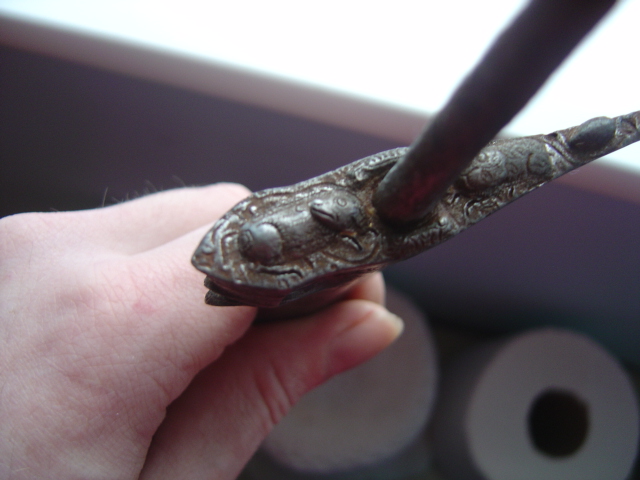

Hi guys i just got this nice Bali blade .Its another nice blade fallen on hard times placed in poor dress and sold cheep[i cant resist a nice blade ] .Im asumeing its a bali blade cause its in bali dress and because of its size[40cm from tip to ganja]and high polish and also there is a one eyed demon/deity? engraved at the bottom.There is alot of engraveing around the bottom of the blade,although unfortunately some has worn away[i get the impression that it was once heavily corroded and then re-polished].Of interest to me is the ganja witch has the strange protrusions and after some scrubbing away the dirt and rust with a toothbrush in water i was delighted to find that the two either side of the peksi are infact very intricately chizeled animals[i cant capture them very well in picture but the detail is almost microscopic with individual hairs engraved to make the fur coat]the animal nearest the pecetan im quite sure is a cow and i cant quite make the other one out yet[it is alot more corroded] but im leaning towards a cat/tiger or monkey [more cleaning should hopefuly make it clearer].Can anyone tell me the significance of these animals?there seems to be a ceremonial feel to it.Any comments and corrections welcome.
Sorry about pic quality my camera is rubbish

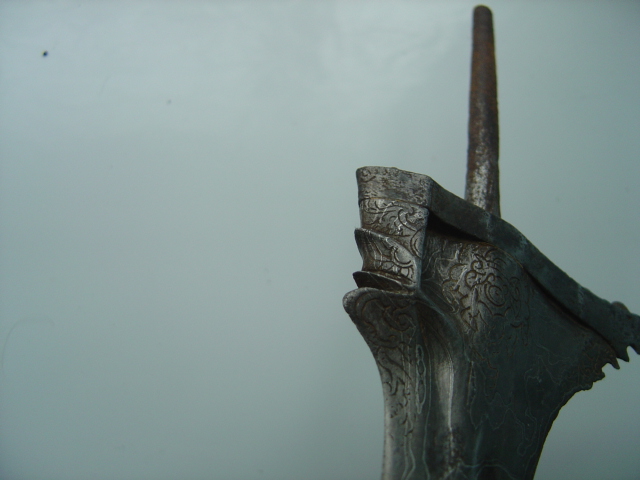

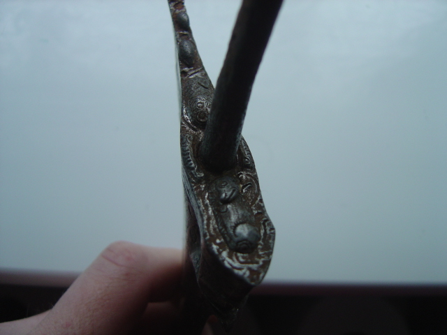

closer inspection reveals that the second animal is almost certainly a tiger and they both apear to be partly submerged in flowing water/river..the nodules near the aring seem to be rocks with water flowing around them.

What a shame that this blade is mounted in such a cheap tourist dress.
It is balinese and once it certainly was dressed in a smashing scabbard with a fine ukiran. Unfortunately the mendak is also missing.
In my opinion this is a very good blade. It should be cleaned properly with lime juice and re-etched with arsenic. The figures on the gandja were certainly gilded and the engravings once were gilded too.
Maybe you should spend some money on this fellow to bring it back in the way it once appeared. Maybe Adni of the Malay Art Gallery can give you some advise. If you have the opportunity to restore it you will have a very fine balinese or lombok keris. I think this one is the effort worth.

Thanks Henk thanks for the reply yeah its a great shame about the dress but for me the blade is the most important part...this is the second good quality bali blade that i have got in almost identical dress and like the last this is one for keeps and restoration. Do you have any ideahs on the significance of the animals ?mabe a makers marks or perhaps something to do with a hindu fable or something they are a lovely detail

the animals on top of the ganja are not original but made recently. The blade itself is not a good one because of the low condition. Remember Balinese Blades are polished not etched like the Javanese. Etching of Balinese blades came up maybe in the 70ties because of the lack of caretaking. To get a Balinese keris in good first class condition is almost impossibleSee: Hamzuri 1982-83 Petunjuk Singkat Tentang Keris p. 8.
Animals on Balinese blades (ganja) are sometimes present even of gold and sometimes like the Javanese Singa Barong (not a tiger), Gajah, winged horse and so on. impossible.
Its said the meaning of this animals is a date and also like a medal of honour for bravery especially under Sultan Agung.

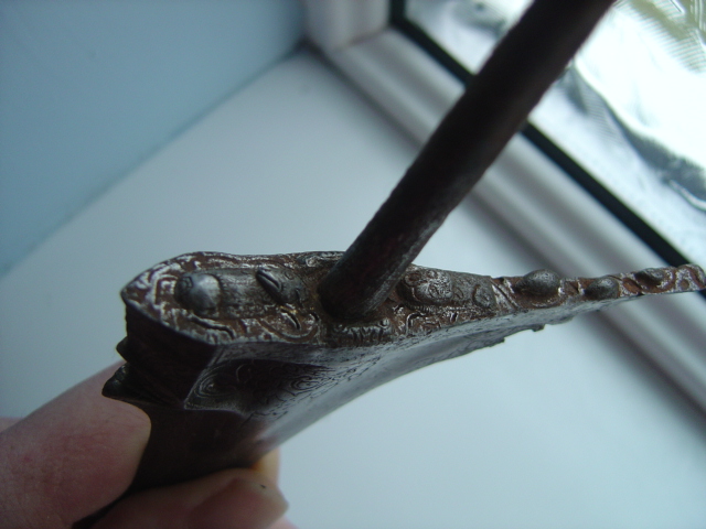

Hi Empu Kumis thanks for your comments this blade is highly polished and you cant feel the pamor if you run your finger over it but does have random pitting and wear from past corrosion im very sure its older than the 1970,s .
Also after more cleaning i have discovred that there is a wafer thin gold shim between the blade and the ganja its only visable in a couple of places and is incredibly thin my camera wont zoom in close enough to catch it properly... strange but interesting

its not only the corrosion but also the incomplete greneng and the blade is to narrow. It could be reshaped. This has been done many times to rise the prices in Bali and even more in Jawa.
The blade itself is older but reshaped. Up to now there has been almost no research about the age of Balinese kerisses. If somebody telling you the age of a Balinese keris its always pure speculation. Even to tell about where it comes from (Southbali or Northbali) is difficult and in Bali almost everythings is forgotten.

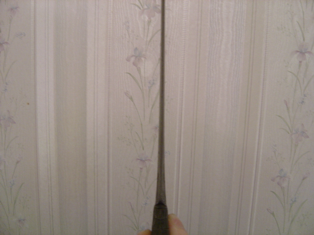

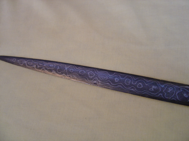

After some TLC and a visit to doctor arsenic....nice pamor in my opinion

Did you that by yourself??? The result is great !!! Next step is restoring the gold part and if possible a good dress for this fellow.

Looks very good Captain, as some of your past posts show questions about etching, tell us about your experiances to date.

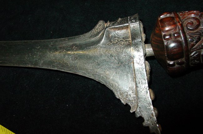

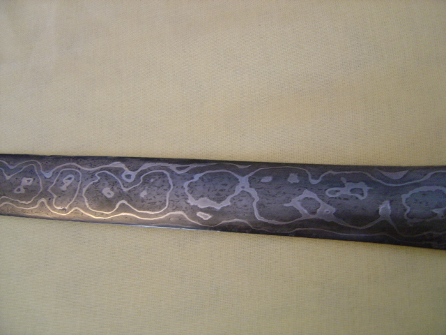

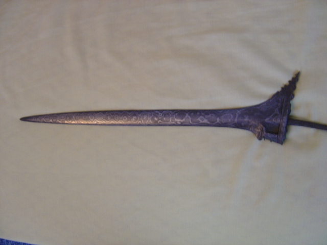

HI guys, Henk yes i did it myself i am currently looking at gold leaf/gilding and have found that gold leaf is quite cheep so i will be doing this very soon .Im also looking into re-doing the fadeing an in some places worn away engraveing on the blade but this is a long term project[i already have the engraveing tools but it will require some further experimentation before hand].
Hi Bill i have been building up to this kind of project for some time and just as i was ready this blade fell into my lap as if it was meant to be .My first task was the staining solution witch as i described in my thread on "warangan".Firstly i had to find a source of Arsenic witch as you know is a banned substance in most countries and after some searching and help from other members i found that warangan[the traditional mineral for staining keris] was probably the ore Realgar[Arsenic sulfide]easily sourced on ebay then powdering it[ a lump of ore about an inch square part crystal part rock]and adding it to about 1 and a half liters of grapefruit juice.I tested this on an inferior trade blade that i got for this task and it worked well although i have found the grapefruit juice is only mildly acidic and only removes dirt and dosent etch the blade [ideal for a bali blade that has a polished surface] so for a more acidic solution i will use limes.I soaked the blade for 1 and a half days in my bathroom with ambient temprature of about 20deg C [slow but easily controllable].
The hardest part was prapareing/restoreing the blade.As you can see from the pics it was in bad shape with lots of corosion, rust ,scratches and pitting along the blade[the pamor not visable in a few plces], fortunately most of the pitting was only very shallow and i spent a day and a half of intermitant sanding with 6 grades of sandpaper [the type used in praparing car bodywork] starting with p100 to remove the surface material on both sides to a point where the pittingwas minimal and i could put a polish on the blade[aproximately quarter of a milimeter off both sides but im guessing there]this was the hardest part becuase i had to draw a line between a good surface and changeing the shape /lines of the blade witch i didnt want to do.After this i then gradualy went down in courseness of sandpaper p180,p320,p400,p800,p1500 till it was in a position to be easily polished.
Some of our more traditional keris lovers may want to look away now I then did a quick pass on a rotary buffing wheel to polish the blade to a nice shine.And finaly gave the blade a few whipes with a rag soaked in sulfuric acid[car battery acid] to re-open the grain of the blade so the pamor could be set free.
In all i probaly removed about 3 quarters of a mill,s worth of material from the blade ,amazeing the difrence it has made and with no detremental afects on the strength of the blade.
Make what you will of it,any coments welcome

Hi Rasdan thanks for your kind words As for" opening the grain"[i must mention that all the sanding was done with strokes running parrallel to the length of the blade only]now after the whole sanding and polishing process if i looked down the blade i could not see the pamor ,the sanding causes the visable surface to blend /smear together so the pamor is barely visible[best way i can think of explaing it] so a quick whipe with battery acid gives it a slight etch just enough to make the pattern visible again.Do you know what i mean by sealed grain?
Also i forgot to mention that i only sanded the blade up to about 3 inches before the ganja[just before it starts to taper outwards] this was so i didnt remove any of the original engraveing.
Any information on technique the profesional restorer would have done on any of these stages would be most welcome
