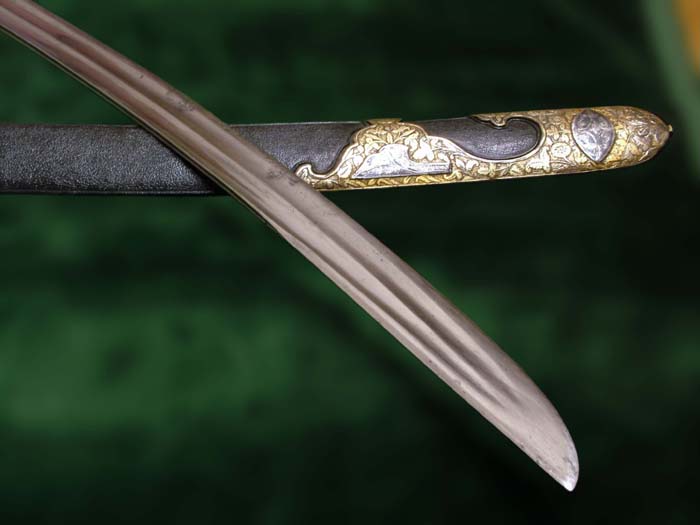

Below hussars sabre blade with inscription IEZVS MARIA IOZEF

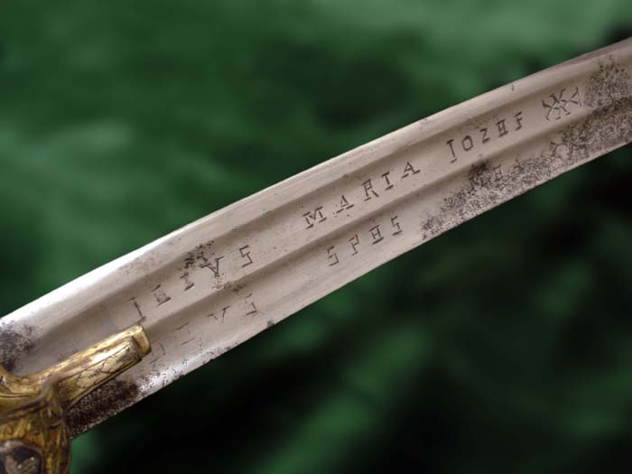

Wolviex, please, what is the translation of the inscription IEZVS MARIA IOZEF?

The full inscription on the blade is IEZVS MARIA IOZEF DEVS SPES MEA where "V" is made as "U" - it is easier to engrave or stamp, and "I" as "J". It means in English "JESUS MARY JOSEPH, GOD IS MY HOPE".

I did put the phrase on a 'translation' web site....and got just 'Mary' .......foolishly I didn't consider the 'V' 's to be 'U' 's etc....thankyou for the explanation.

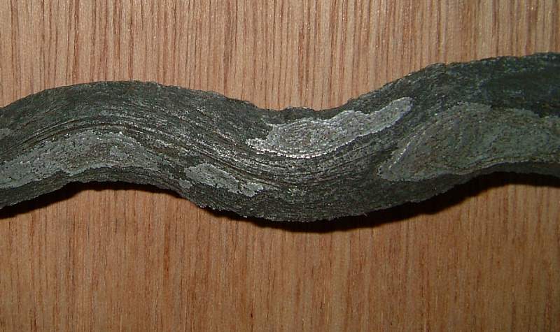

Possibly this picture of a section of an ancient keris blade may illustrate this wrought iron stranding phenomenon.
