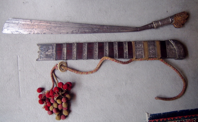

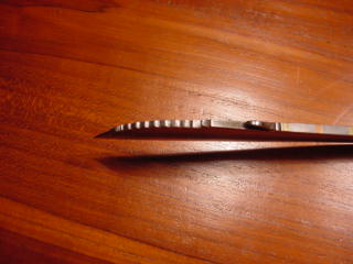

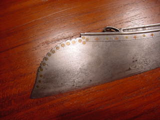

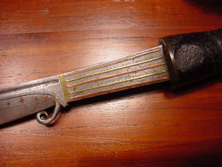

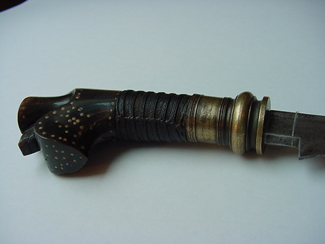

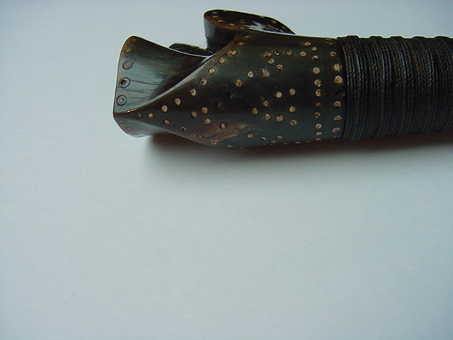

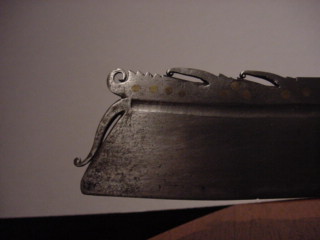

Valjhun hope you can see the difference between yours and these
This is an parang Sangkit look at the blade A murut sword
Ben

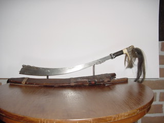

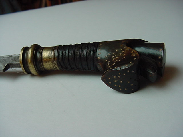

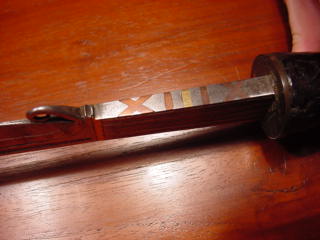

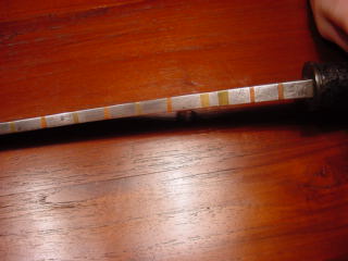

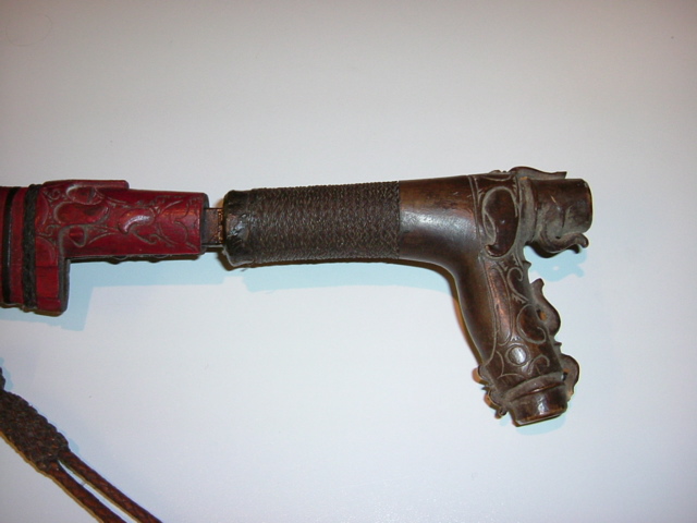

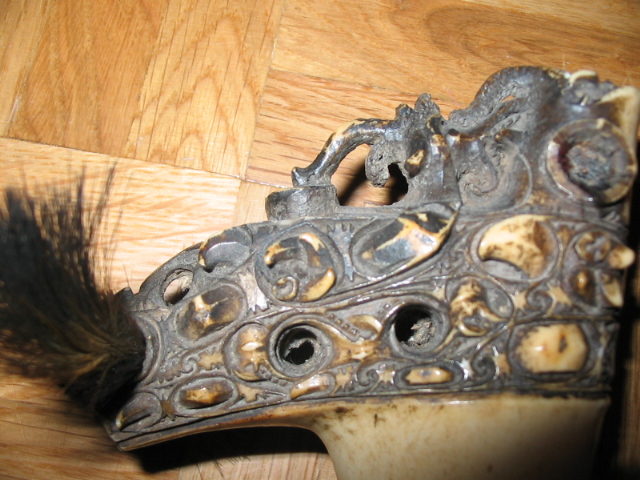

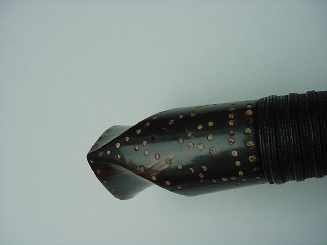

An Jimpul ex collection W. O. Oldman in his cataloque from 1913
Old 12th January 2007, 03:29 PM   #9
Dajak
Dajak's Avatar

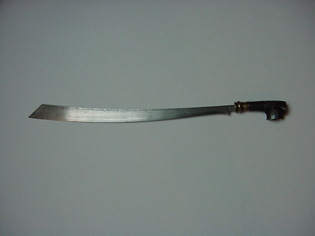

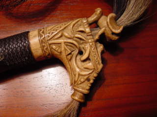

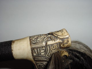

Posts: 952
headmans Jimpul

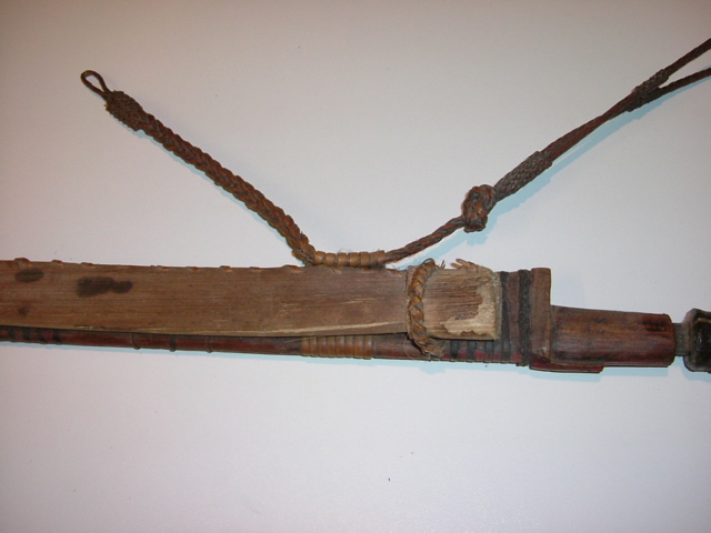

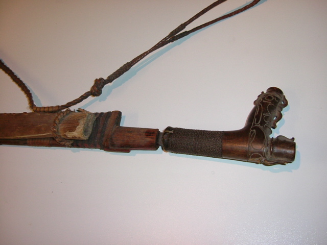

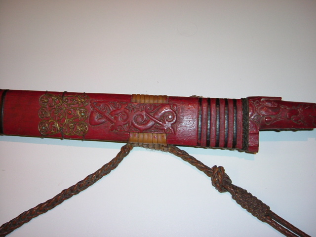

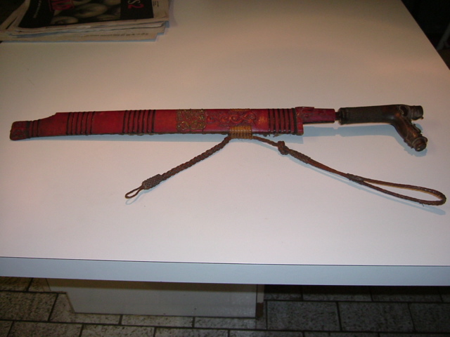

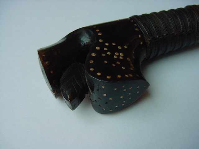

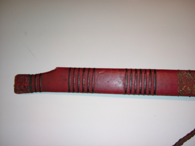

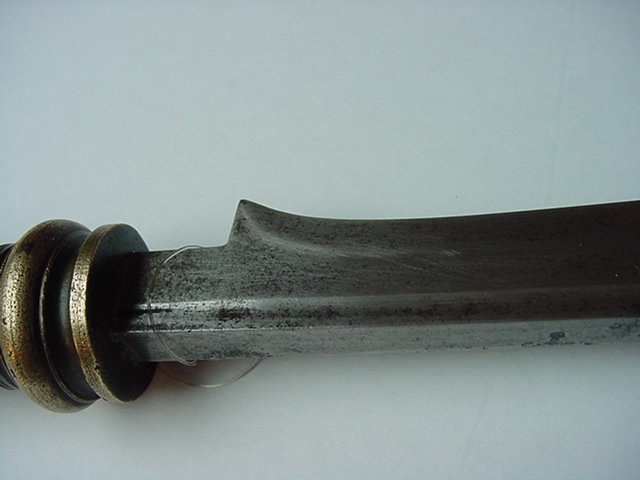

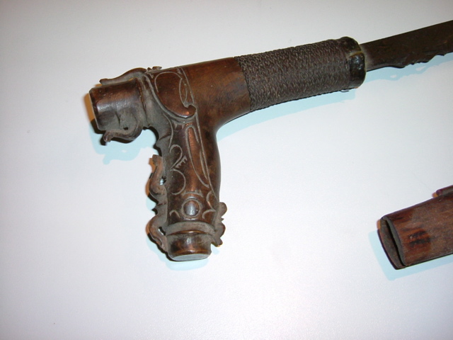

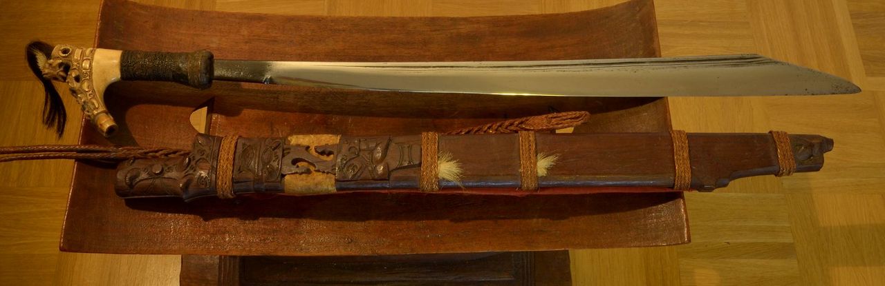

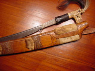

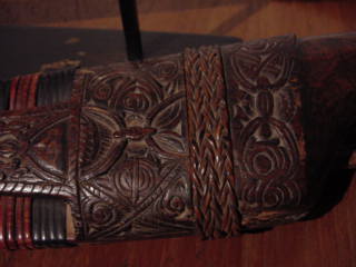

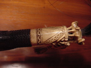

Default Here is my dad's dayak swrod I have been talking about.

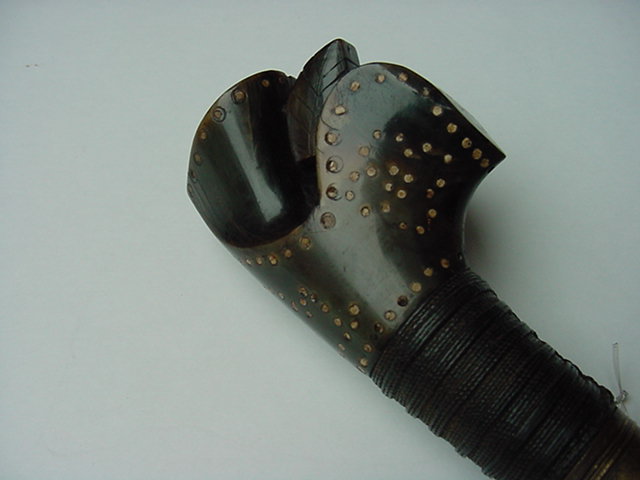

So what do you Dayak enthusiasts think ?
This parang was presented to my dad by the head man of a
longhouse
in the ULU TUTONG area of Brunei in 1968 or 1969 as a thank you for a
helicopter casevac he did. He says that this particular parang which he
thinks is called a parang ilang may well be quite old and is not of the kind
sold to tourists. Indeed he says there were no roads in that area then.
fenlander is offline   Reply With Quote
Old 13th January 2007, 01:22 PM   #13
Dajak
Dajak's Avatar
Posts: 952
Hi This looks like a nice used one not the tourist stuff
It has a nice carrying guard
Ben

Originally Posted by Dajak
headmans Jimpul
Very nice chief sword!

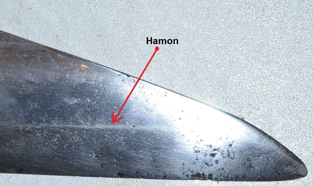

Dayak were famous for the quality of their blades in Indonesia! As far as I know, Dayak blades were very desired in whole Indonesia.
I have one old Mandau, made from flawless forged laminated mono-steel with a differential hardened cutting edge and this blade is of extraordinary high quality.
Roland
