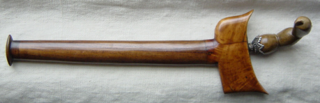

Unhappy It is here, what a sucker!
I do not know about composite but I think it sucks! The sellers use of "used" is just a euphemism for brand spanking new . I paid less for the all metal lance and the Naga dao both wonderful pieces, I said my luck would run out. It seems to rely on wieght rather than any really skilled tempering of the blade. Used is a very meaningless term, something to remember. It was probably made for tourists. pictures of the crap to follow

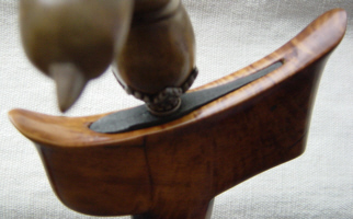

Hi Tim, the small eBay pictures were misleading.
I was expecting to see two properly formed grooves (sogokan depan and sogokan belakang) at the bottom centre of the blade, not two lines of what seems to be formed by a grinder and looked unfinished.
The nice part of this ensemble is, the hilt ring (pendokok). A Malay Straits model. Although it looks new, it's well-formed.

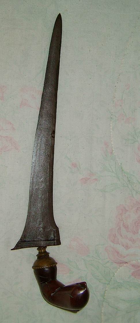

I am not trying to pull this back from the abyss but this side of the blade shows some signs of forging and folding so I am not sure it has been wholly ground to shape. It is still brand new though.

Tim, i don't believe that composite pieces are ALWAYS to be disapproved of. Sometimes a seller has a few various parts lying around that he slaps together for sale.
Sometimes a keris from one region may end up in the dress of anothet for completely legitimate cultural reasons. If one has moved form, say Jawa, to Bali, they might feel the need to dress their keris in accordance with local custom. Some keris make their way to different islands and trade items and are then dressed locally.
i am not so sure that your piece is composite. The blade is certainly not a well made piece, but it is a forged piece, so i would call it a keris. And Alam Shah is correct to point out that it has a nice pendokok and the sheath seems to be a nice wood. All in all i wouldn't go so far as to say you were mugged. You probably didn't pay too much more that the market value.

Tim, I look at keris in a somewhat different way to the way in which the other people who contribute to this Forum look at them.
That "somewhat different way" means that I apply different standards to different keris.
What I can see in the pics you have provided is a village quality blade, a fairly decent old wrongko, a fair average quality handle, and a pendongkok that I believe will test as silver.
I can also see the price you paid.
In my opinion you recieved very good value for what you paid.
It is a fact of life that in this world we pretty much get what we pay for. High quality, old is going to cost good money, no matter where it comes from, including ebay. Yes, we all know of the exceptions to this, but those exceptions , to my knowledge, have been achieved by very, very knowledgeable people who are prepared to gamble on something that looks like it might be good, and then get rid of it if it is not.
Sleep easy Tim. You did OK.

Though I would admit this keris is not a fine keris, I do not think it is made for the tourist. I see signs of san-mai construction, and I think it may not be 'spanking new'. I also think that this is a Sulawesi Bugis keris with every part made for the keris blade, judging from the very good fit and proportions. The sheath, pendoko and hilt styles are all consistent with Sulawesi archetype. Sulawesi kerises may be a rough lot, mostly, but through the roughness, a certain Bugis macho-ness emerges. It takes a slightly different perspective to appreciate it, but you may eventually like it.
"I am Bugis; I am tough. I ain't pretty. You got a problem with that?"
Anyway, if you don't want the keris, get in touch with Adni. I'm sure he can help find a new owner for the keris.

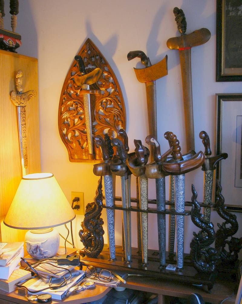

Then the inevitable result; the Addict's hovel...
Old 3rd December 2006, 03:42 PM   #27
Posts: 7,288
hhhmmmm....if i am not mistaken there appears to be room for a couple of more on that back rack...
