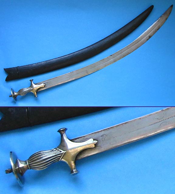

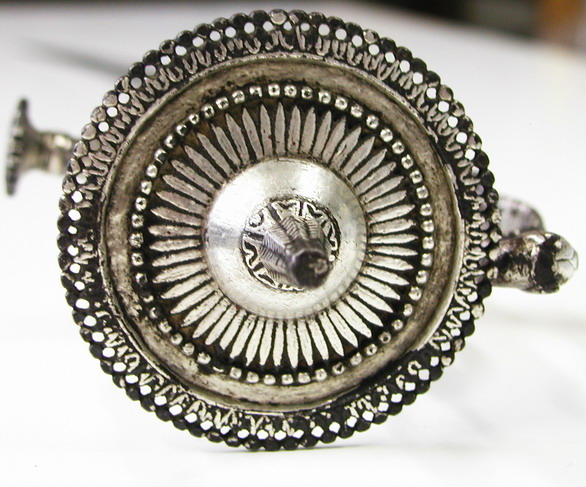

This question is for Jens. I bought these a few years back and would like to see if I can get some more information on them markings,age and region. The top sword has some type of inserted edged blade with a T shaped spine and the bottom sword has traces of wootz patterning in a few spots.

Hi Lew,
I am really not very good at judging weapons from pictures, I prefer to have them in my hand, but let me try.
The hilt on the first one is interesting, fluted grips are seen before, but they are not common – is it silver? Do I guess correctly if I say there is a flower on top of the disc?

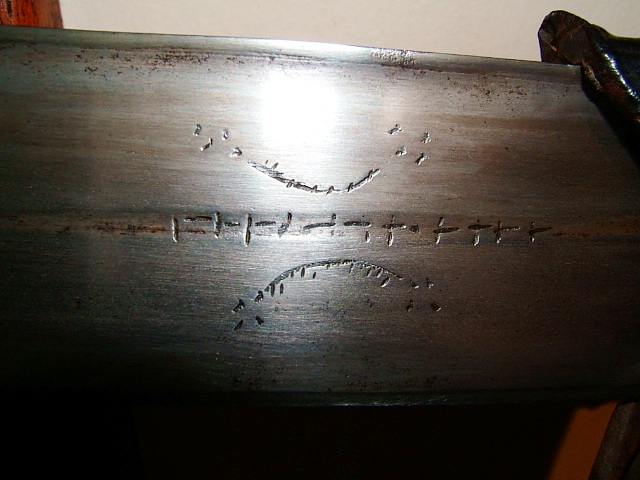

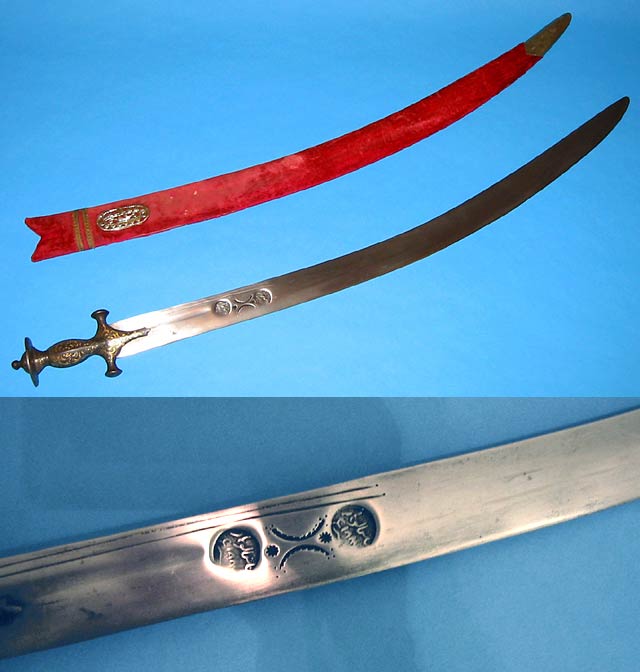

The blade looks nice, and I can see two eyelashes with three dots at each end, however there seem to be something more closer to the hilt, but I can’t see it clearly – what is it?
The blade must be broad, but not necessarily heavy, as the ‘T’ spine will help stiffen the blade. You don’t write anything about wootz, so I suppose it is not watered. I thinbk I see a ricasso, but I am not sure. I think the blade is Indian, and it could be older than the hilt, although I am not sure.
My guess would be Rajasthan, 18th to early 19th century.

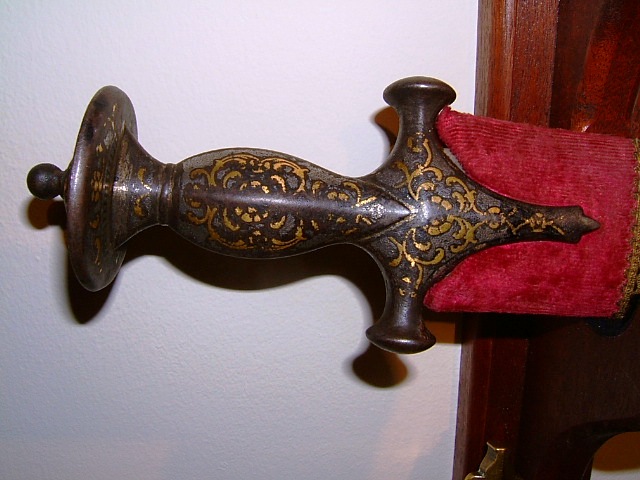

The hilt of the second tulwar is not so easy to see, I think it may have a flower on top of the disc, but I am less certain than with the first one – does it have a flower?
Very nice blade with deep stamps, which must have been made while it was hot, as it would not be possible to make them so deep on a cold blade. Have you had the stamps translated? Does the blade have a ricasso? Also here I think the blade could be older than the hilt.
I am not sure from where it is, early 19th century.
Here is what I think, do you, or anyone else have better guesses?

The silver hilted one has a sun burst or flower type design the other tulwar I can't quite remember right now I will take a few close ups of the hilt. The tulwar with the deep stuck stamps has no riccasso.

The fluted hilt seems to be silver overlay. What is the significance of the blade having or not having a riccasso? The top sword is not wootz but it does seem to have an inserted edge so it must be some type of lamination?

Are you sure the fluted hilt is not made of silver? Have you tried with a magnet? It could be silver plated, but then again, it could be of silver.
Most Indian made blades have a ricasso, often it is said, that blades without a ricasso are European – I doubt that, as I think some of them are Indian made as well, maybe copied from European blades, but still Indian.
Interesting also, as some claim that the reason for the ricasso was, that the Indians used to have their index finger curled around the quillon, to give better room for the other fingers, and to have a better grip. I find it hard to convince myself of this theory, but these blades could have been made in other places, and been exported to India.
They did make blades of softer steel and insert an edge of hard steel, so maybe yours is one of these.

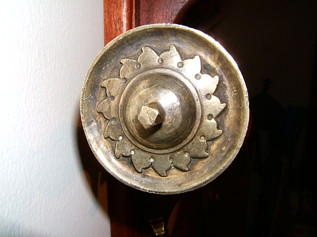

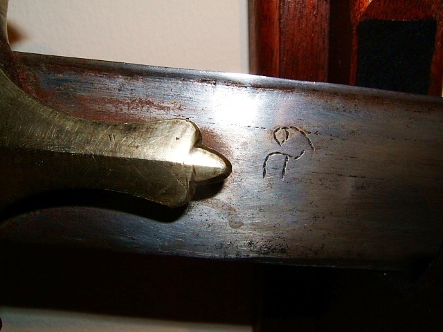

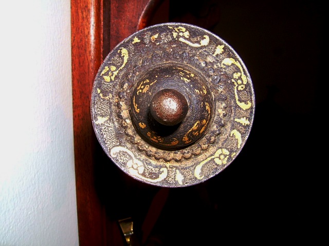

Here are some close ups of the hilts.
Lew

Thank you for the pictures. The one with the gold decoration looks old. The first mark looks like a letter and a number to me, and the second mark, the eyelashes are made in a way, which I have never seen before. It looks very primitive, but there is no doubt what the meaning was. This is interesting, as the eyelashes were said to be a copy of a European sword mark, and maybe it was, but why then mark the blade as it is on yours, as this mark would fool no one. No one would take it for being a European blade mark, so maybe the eyelashes with the dots can have more than one meaning.

I wanted to add some data I have been able to come up with on the first tulwar with the fluted hilt, although Jens has already pretty concisely observed the essentials. As Jens has noted, these are reasonably uncommon and represented by only a few in various references and collections.
The vertically fluted hilt grip is very much like an extremely interesting item I found in "India: Art & Culture 1300-1900" by Stuart Cary Welch. It is item #169 which is a Mughal silver antimony flask of the mid 17th century, stated from either Agra or Delhi. The flask itself is shaped remarkably similar to these hilt grips with the same shape, vertical fluting and stylized acanthus leaves . Actually the flask itself actually looks like a tulwar hilt grip.
It is noted that, as we have discussed before, the style of this flask seems to carry architectural influence, something that occurs in so many instances in the elements of weapon hilts. Reference is made to the upward swelling of Mughal domes (many of which have vertical ribbing) and the "almost baroque columns" of the Sawon Pavilion in Delhi's Red Fort.
Apparantly this flask was used to hold antimony as found in a solution of kohl which was the black application placed around the eyes for protection from the sun.
It would appear that the script markings on the blade are in Gujerati and as Jens noted, are numerals, I believe a 7 and a 5. This suggests of course arsenal markings. Gujerati I also believe, was used as a trade script in nemerous regions including Rajasthan, among others. The crudely scratched imitation of the 'Genoan' sickle marks could not possibly have been applied as 'forgeries', but it my opinion were applied possibly by an owner attempting to ascribe the significance talismanically. I think that these markings receiving so much emphasis on trade blades, of course for quality, may have been misinterpreted by native individuals as carrying talismanic powers.
This of course is simply my own opinion and would require a great deal more research to support in detail.
A tulwar with one of these interesting hilts appears in "On Damascus Steel" by Dr. L.Figiel (1991, p.56, #PS9) and has the distinct vertical fluting and is of the silver or white metal typical of them. There are no acanthus leaves present however, and I'm not sure if these occur on other examples found.
The example is identified as 18th century, and carries a bit more flourish than the very clean geometric nature of your tulwar.
I am inclined to agree that Rajasthan or more northern Delhi, and likely mid 19th century may be the best attribution for this very attractive tulwar.

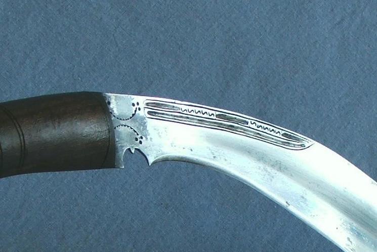

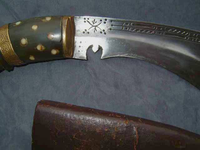

Please find attached the decoration on one of my kukris (2nd part of the 19th cent. is my guess).
Please also note that the lashes ar on the inside.
Best regards
Andreas Volk

What makes me wonder is, the blade seems to be a nice one, and the hilt better than average, so not a cheap tulwar at the time - why then make ‘eye lashes’ like this?
Although the Muslims also used talismanic markings, I agree with you, that I also think it is a Hindu marking.
The markings on your kukri are interesting, and although I don’t know, I would think it is seldom to see on kukris. On thing, which I find especially interesting, is the way the eyelashes are ‘closed’ by the three dots. I have a tulwar where eye lashes and fullers are started and end with three dots. Unfortunately I don’t yet know why that is, but I am working on it.

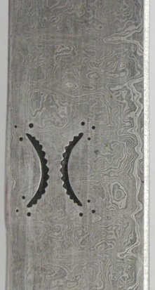

Just to confuse things further allow me to throw this variation into the mix .

Your contribution does not really add to the confusion, as far as I am concerned, as I am after the three dots, not the eye lashes, and they apear in warious places.

Thanks a lot for posting this - these marks are a wonderful hybrid. One of my thoughts was that the eyelids (eyelashes) were somehow related to
the halfmoon (kauri) like maks one finds from time to time (pls. see attached).
To be honest I onl found out recently about the "eyelash" meaning - I took the ones on my kukri for variations of the
kauri mark when I first bought it.
Your markings are amazing as the combine the "temple kauri" with the eyelashes. Outstanding !
