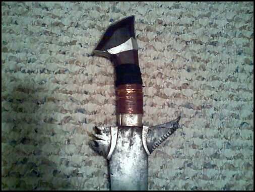

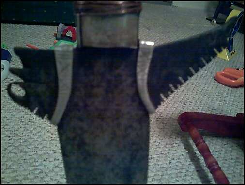

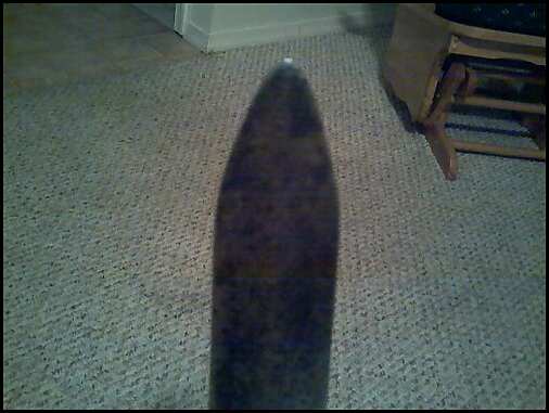

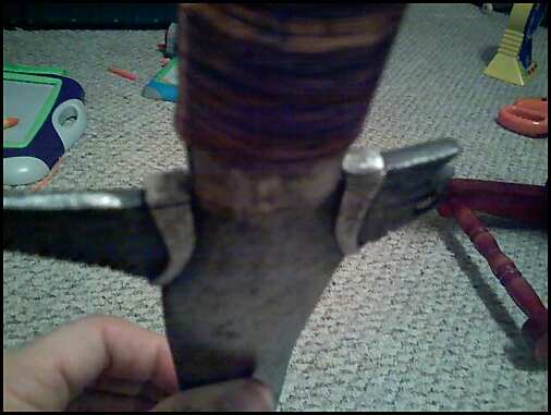

Default Some pictures
Here are a few photos. They are not great either. I only had the camera in my phone to take them with. One day I WILL get a digital camera, really!

Well, that's really thin - any distal taper? It's hard to tell from the pics but workmanship does seem to be lacking a bit. I tend to view this more as a repro rather than a genuine later example but you're the judge. I'd guess all parts are post WW2, possibly not even vintage. Hope others will chime in, too, since I'm definitely no authority...

I am afraid that from these photos i've got a better idea of what your rug in your living room looks like than i do this kris.
Try shooting it outdoors, preferrably not in direct sunlight (overcast days are great. Try to keep the focus on the blade, not the background.
I agree with Kai that this is probably a post WW2 kris, but i don't think that necessarily makes it a "repro". Is the blade edge-sharp?
