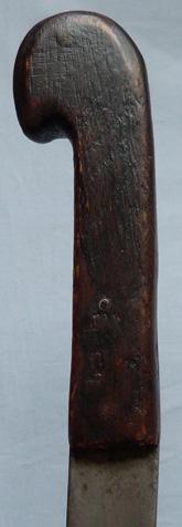

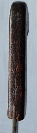

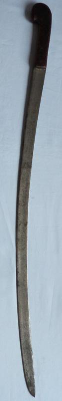

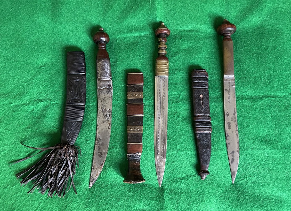

There is a tendency to label every West African dagger as Mande. Not sure is this is always correct, but I do believe the group of daggers shown here is indeed Mande. This is still a very broad definition, similar to labeling something as Slavic or Turkic in a way, so it would be great if at some point we can do a little better.
The British Museum shows three similar daggers, all collected in the first half of the 19th century, one of which was collected in Guinea, one in Sierra Leone and the final one in the Bijagos islands.
https://www.britishmuseum.org/collec...1852-0930-35-a
https://www.britishmuseum.org/collec...ject/E_Af-5319
https://www.britishmuseum.org/collec...f1878-1101-521
Based on this, a distribution from what is today South Senegal to Sierra Leone is possible. It would be interesting to learn more about these knives.

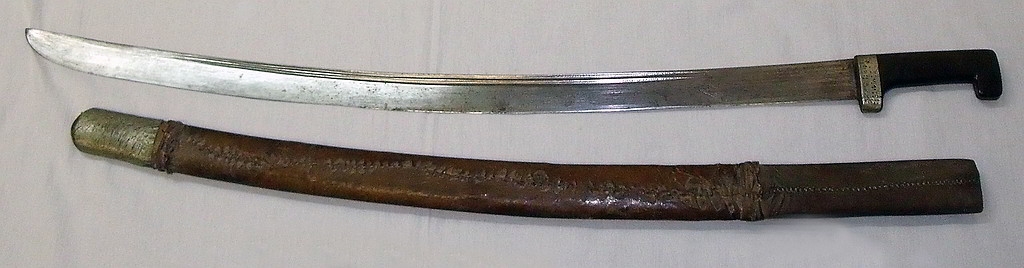

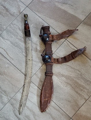

In "Panga Na Visu", the first dagger shown is similar to the group in my opening post. The second is one with a flared tip scabbard. I have one of these as well. A knife in the Quai Branly with a similar scabbard is described as Wolof, from what is nowadays Senegal and Gambia.

Begs the question, what does this 'flared' or 'spatulated' design element on scabbards represent, and which region did it originate? Years ago an archaeologist specializing in the Sudan told me this design had iconographic origins from ancient Meroe.
If that was the case, then how and why does it become significant in the Mande linguistic regions?
Not meaning to deviate from the original topic concerning classification, but these 'regional' characteristics do seem to have bearing.

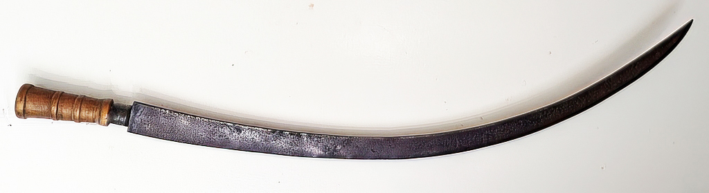

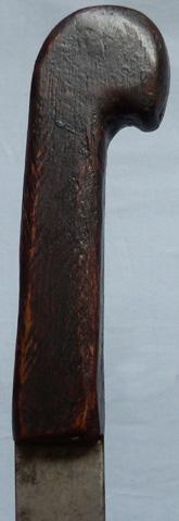

I've already shown this short sword/dagger; the tip of the scabbard has a completely different shape.
I'm more interested in the brass wire inlay on wood. Inlay is also found on Ikul (Cuba) daggers, but the technique is completely different there. The handle shape is also somewhat similar.
The similarities between these hilts and Ikul dagger hilts are interesting, but the pommels seem too different to me - the West African form has a distinct pommel cap. Also, on Ikul daggers the inlay is typically aluminum or some white metal alloy, and like you point out, very different in technique. Nice dagger/short sword by the way.

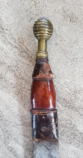

I don't think the bulbous-shaped or cilindrical hilts have any particular symbolism, but they are however a very deep rooted visual design language of weaponry in the region, and probably deeply tied to the Mandinka world. Even the leather sabres share this design language, but it is hidden and visible only when sheathed. It's a subtle allussion, but it is there.
In high status shortswords and knives the pommels tend to be more bulbous and in leather hilted examples they tend towards cilindrical, but it is essentially a continuum of the same shape. The pommels are more uniform in the sense that they have a similar construction, but on the guard you either have a cilindrical round hilt or a more extended area. Some have both, one when sheathed and one unsheated (typical of sabres). There is a lot of variation because of regional and cultural styles expected in an area as large as Senegal to Sierra Leone to Segou, but it points to a common origin, a macrofamily of weapons (like the enormous La Tene family of swords from classical antiquity to the Middle Ages).
