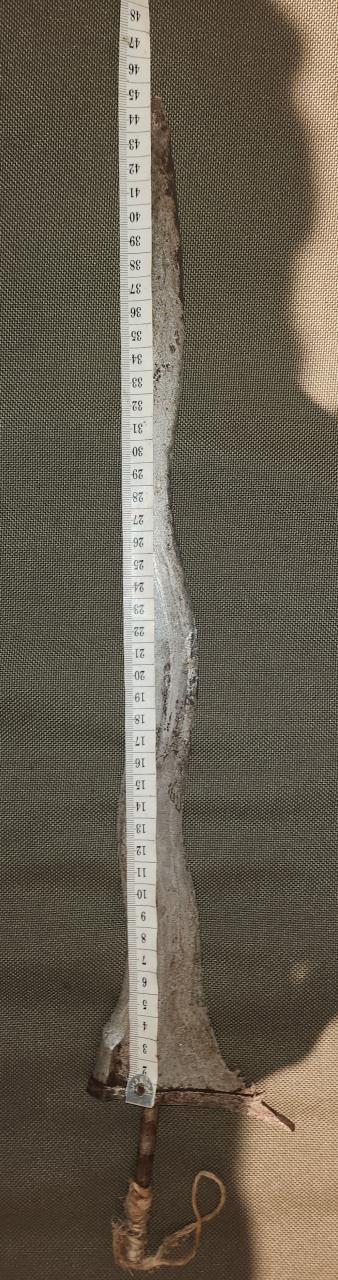

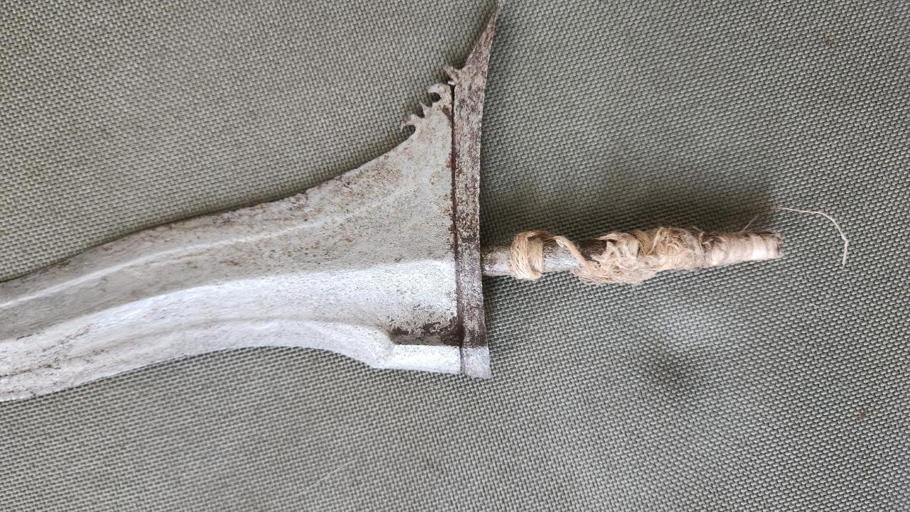

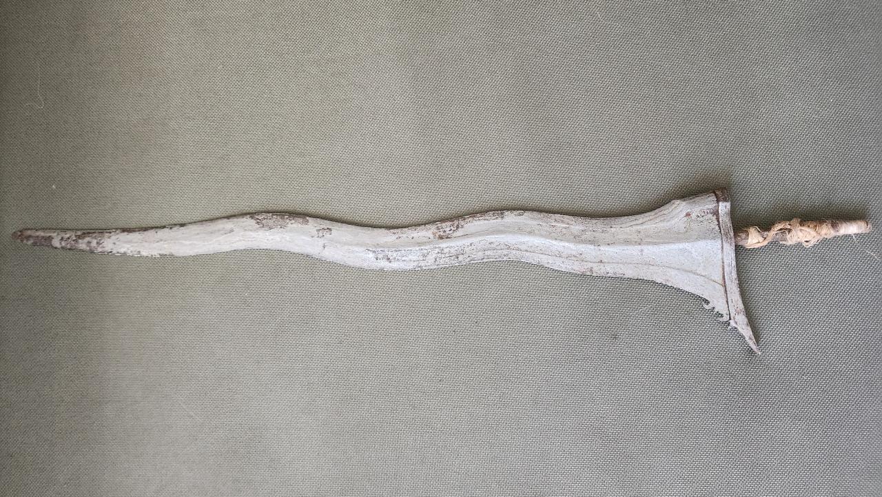

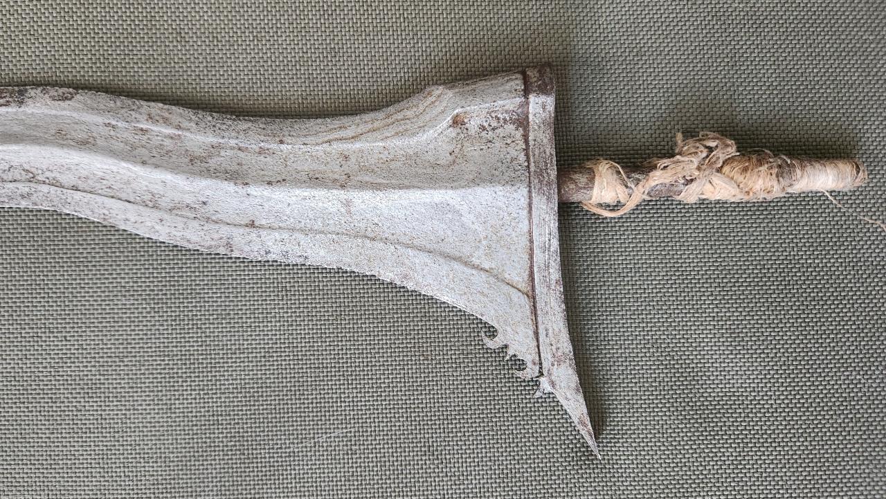

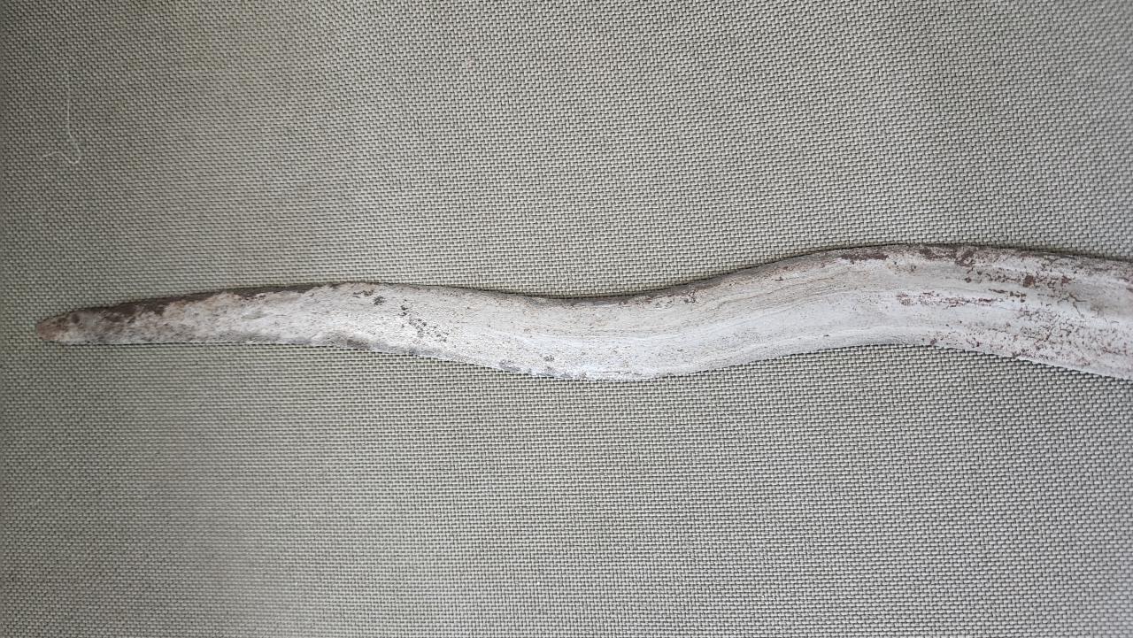

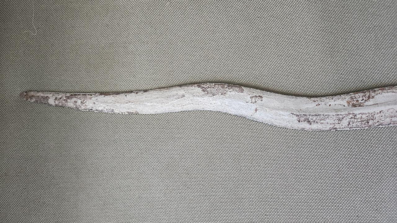

Hello everyone, i need help in identifying this keris i recently received with a large 45cm blade.

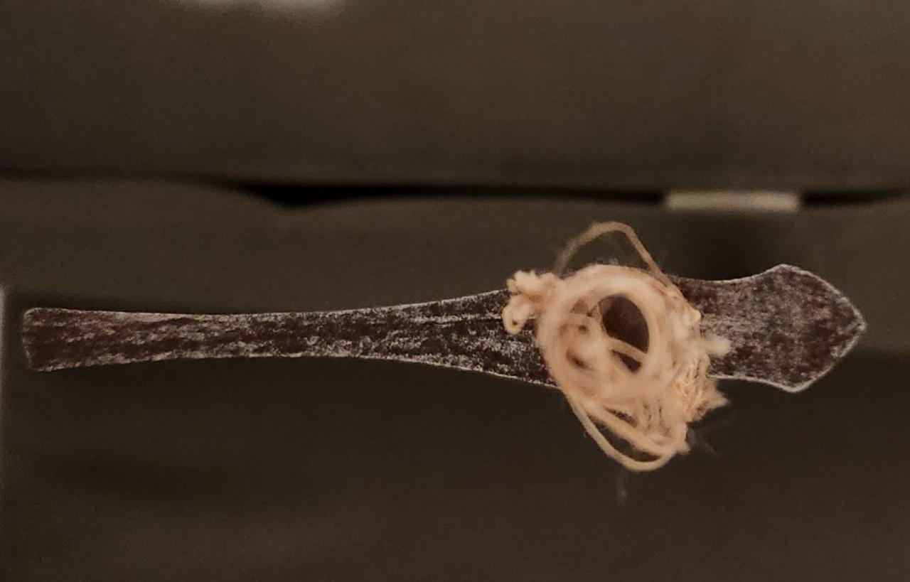

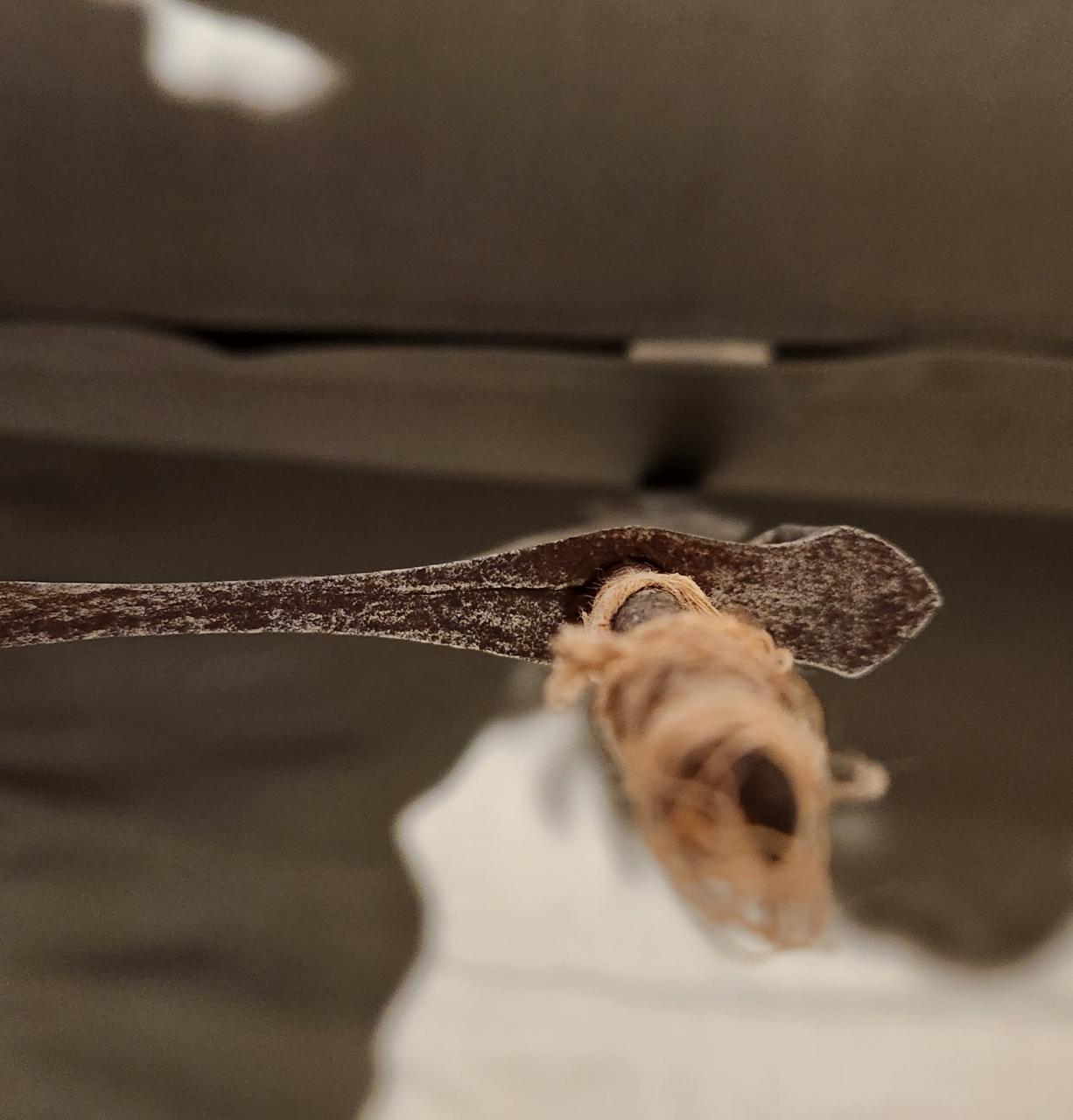

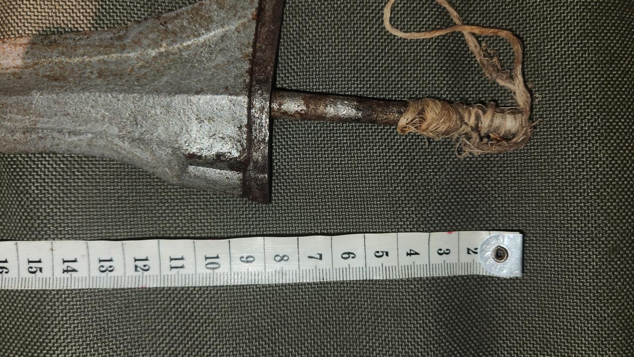

Could you please provide a photo of the top of the gonjo looking directly down onto it, & the length of the blade from the top of the gonjo to the tip of the blade.

Here are the pictures. I also include the length of the pesi

Based upon the Surakarta parameters of Tangguh classification, the gonjo profile suggests Pajajaran, however the rondha form suggests a tendency to Surakarta. Taking these two indicators & noting the blumbangan form, the length of the blade and the overall robust form, my classification of this blade would be Banten.

I’m also sharing some photos of the blade with its warangka for context.
