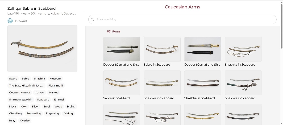

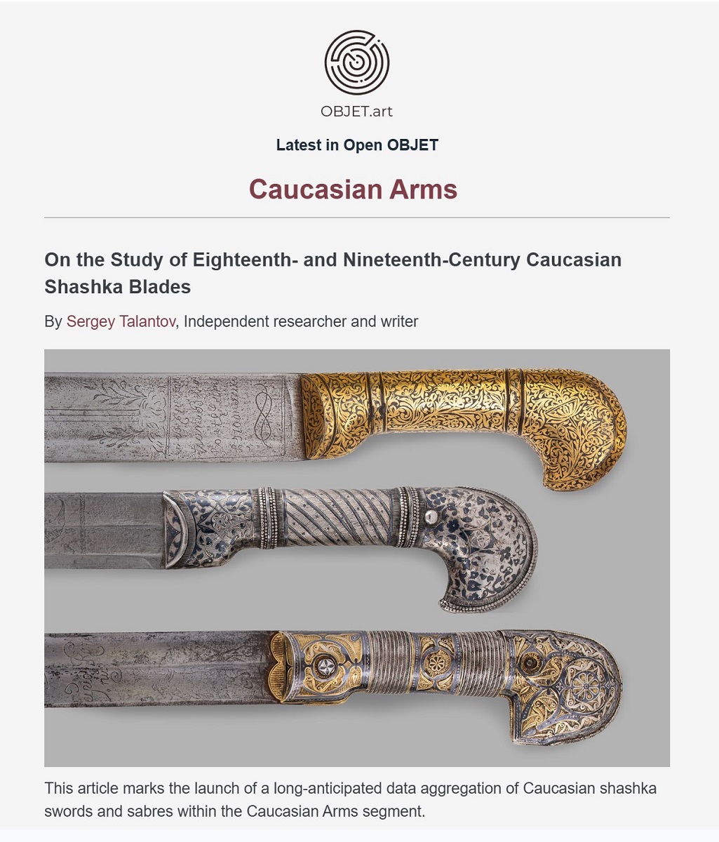

Dear friends,
In case some of you haven't subscribed to the Open OBJET newsletter and missed the excitement — here's a long-anticipated leap forward in building the largest database dedicated to Caucasian arms and armor, now continuing with a major focus on shashkas and sabres.
Some true gems from private collections add depth and distinction to this growing domain.
Check out the article and enjoy the expanding expertise!
Link: https://objet.art/as/articles/687fa78af25e334201ff3691

Thank you for linking this article..brilliant! and well explains some of the mystery behind the shashka blades, which do seem to be largely imported prior to 1860s. However these imported blades did of course remain in circulation and were often remounted whether as heirloom or sometimes trophy examples.
What is interesting here is the modification of European cavalry blades to narrower and lighter versions in accord with the swordsmanship style of the Caucasian horseman.
While it is hard to definitively set classifications as a rule, these guidelines do suggest certain proclivities.
One thing that is interesting is the number of blades noted in many references as from Hungary and Styria. It has been my impression that Styria took much influence from Northern Italy, primarily Genoa. The most notable characteristic marking of course being the dentated arcs commonly known as 'sickle marks'. While these are typically associated with Genoa, they were used in variation throughout northern Italy, with Genoa a port of export. The blades among the commerce into trade networks went to Genoan ports of call, and stations in the Black Sea.
From here these blades filtered into the Caucasian regions, while also into Styrian regions.
In the Caucusus, this ubiquitous marking became termed GURDA, which while meaning in general, 'good blade' (loosely) I am unsure of the actual translation or etymology.
As far as 'Hungarian' blades, Jan Ostrowski ("Origins of the Polish Saber", 1979, p.222) notes, "...Hungarian blade production, if it existed at all, must have been very limited, for 17th century records tell of blade purchases from Styrian and Italian manufacturers and the great majority of surviving Hungarian sabers have Styrian and Genovese blades often marked with crescent moons and inscriptions GENOA, FRINGIA and FRANCIA".
