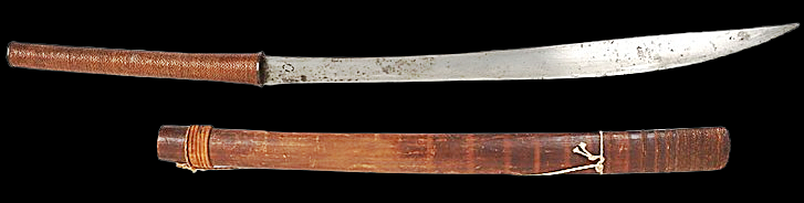

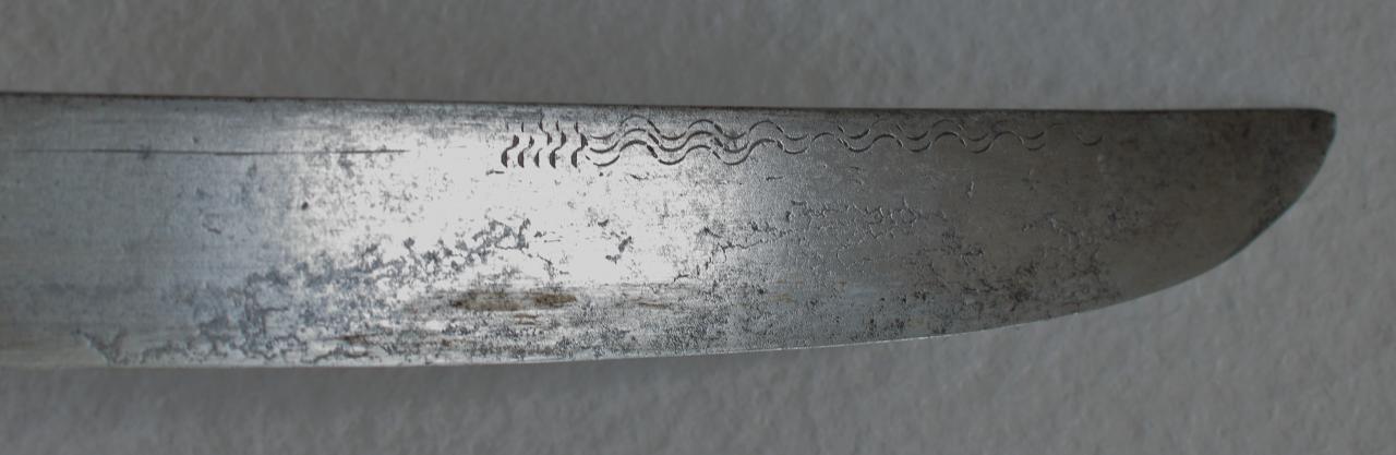

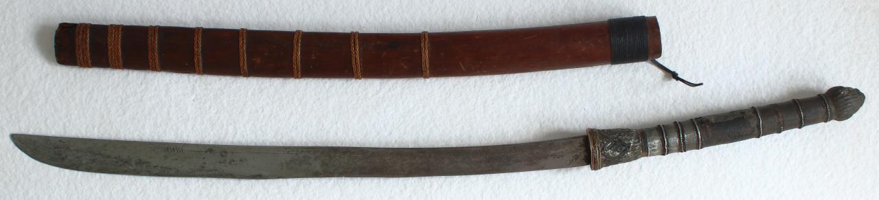

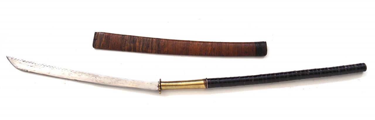

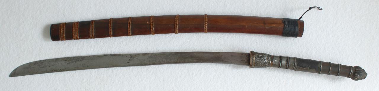

My latest dha/daab, oal 83.5 cm, sword 81.5 cm, handle 26 cm and thickness of blade against handle 9 mm. It could be a sword from Laos. On Iain Norman's excellent homepage on Asian swords, in the article: the sword of the elephant, similar specimens but still some differences.

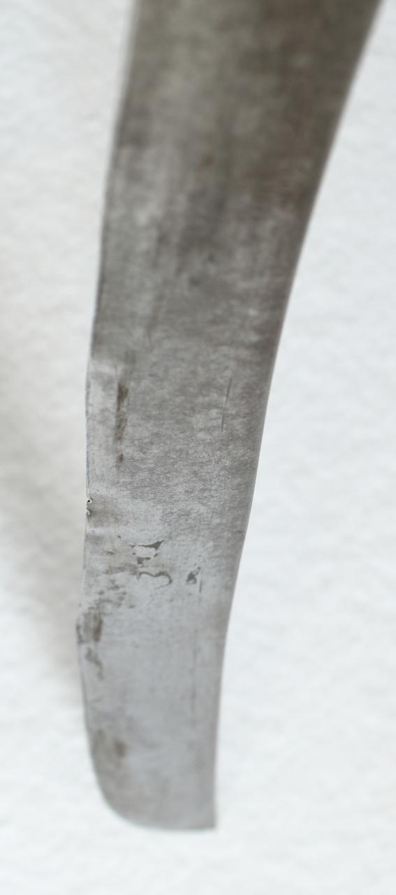

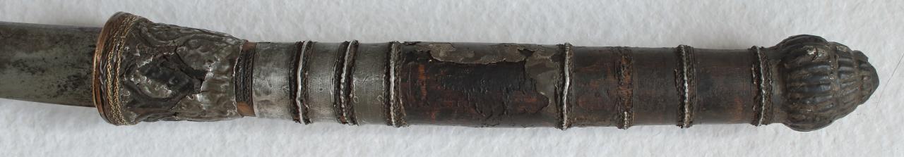

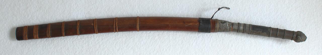

My dha has no handguard, the hilt is damaged but seemed to have been wrapped entirely with a thin white/gray metal rather than cast brass/bronze. The decoration of the handle against the guard is rather rudimentary, the knob at the end then resembles the specimens shown. The blade has had a hard life, with a bent piece in the center with two notches in the edge, must have been a violent impact. On the blade on both sides two light decorations. Sheath is in fair condition, the black rope seems recent (plastic?). Opinions welcome. Regards Marc |

Hi Marc,
That one looks in pretty rough rough shape but it might clean up well. It needs a good clean to assess the hilt more clearly and the blade too. I think I see some areas of delamination of the blade—is that the case? I agree that it is a daab, probably Lao, 19th C. Iain will give you a more definitive answer. |

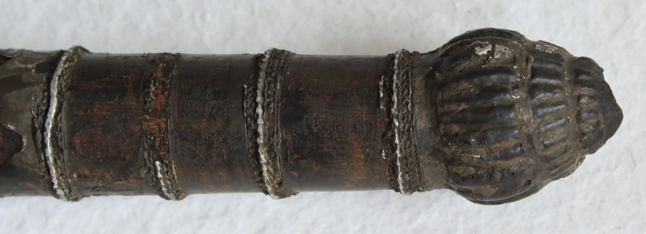

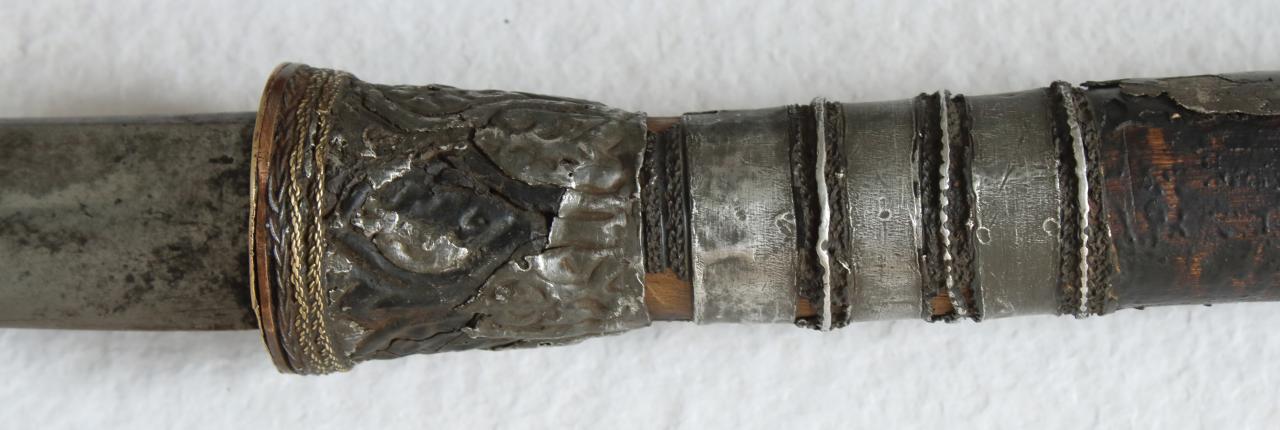

Thanks for your response, the handle is indeed in a rough state. I have tried to polish the metal but with little result.The remaining metal is quite brittle, especially at the pommel.Where the metal is gone there is a hard material, looks like some kind of resin, a bit strange.The blade has some flaws in the steel probably due to impurities during melting, probably native steel. Regards. Marc |

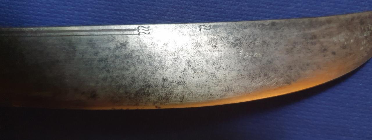

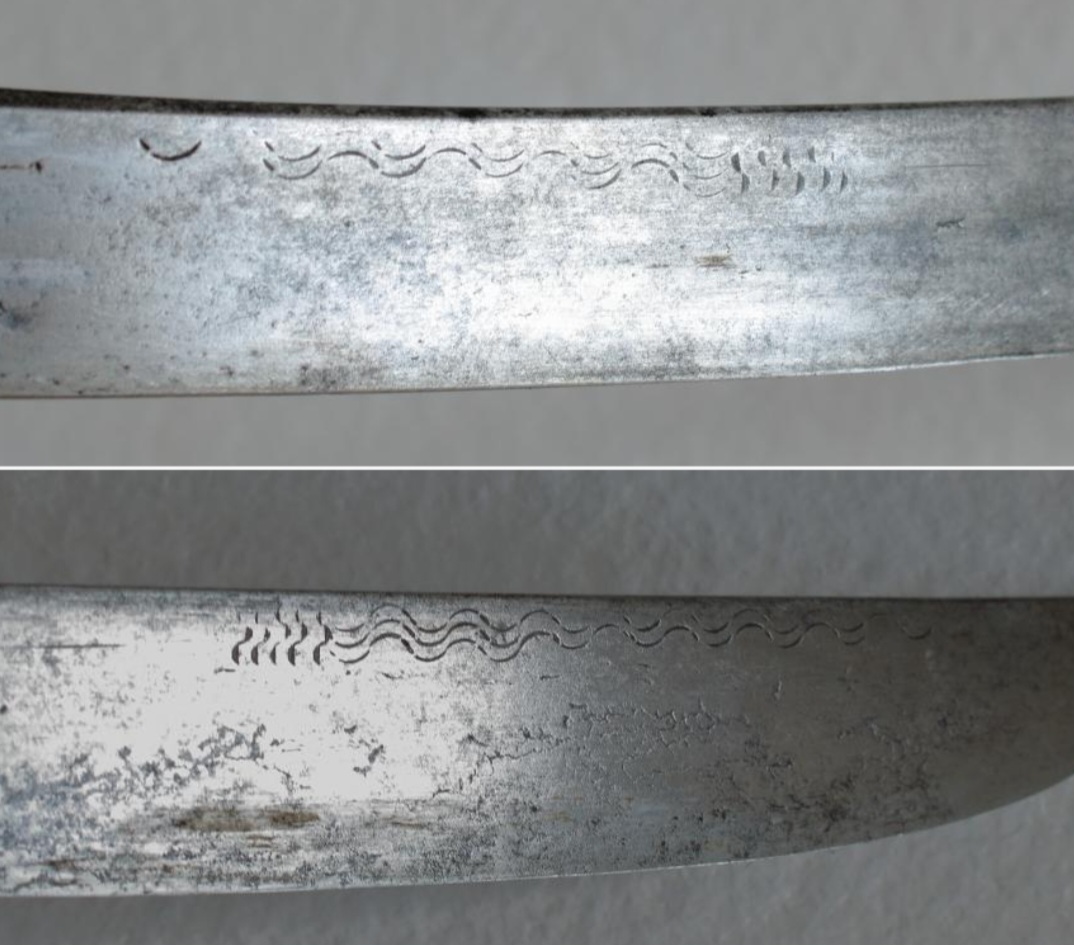

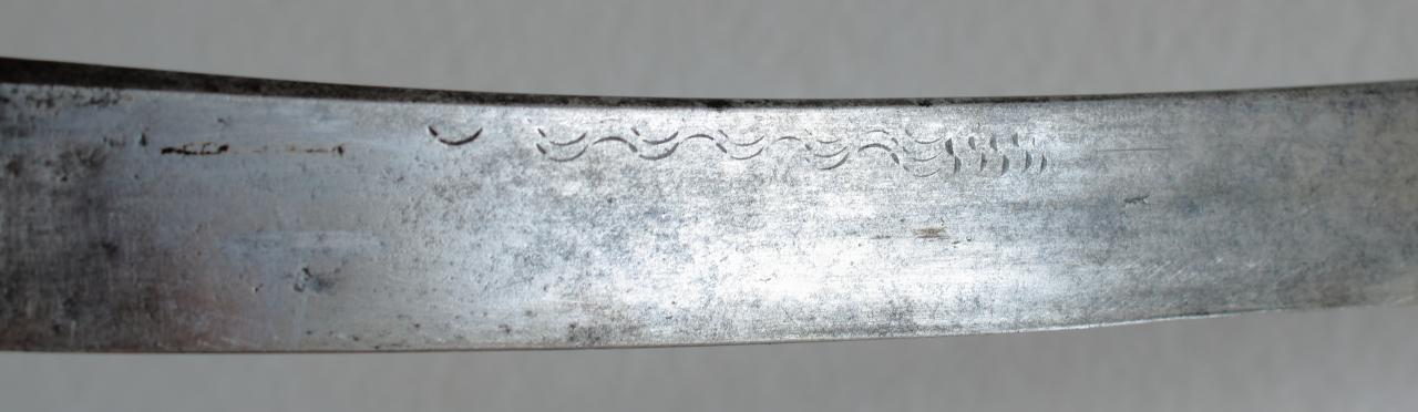

I hope a side question is ok while we wait for comments. Have we discussed these common markings? They are, of course, very present on tourist pieces from Thailand and I usually take it as a bad sign when I see them. However, you do see them on clearly authentic, and old pieces, as the case with this sword. I've also attached a Montagnard daab, featuring these marks, that was collecting in the Central Highlands Vietnam early in the American War there (only picture I had on hand but you can still note the markings despite low resolution.) How far back does this practice go, what geographic footprint would we expect to see them?

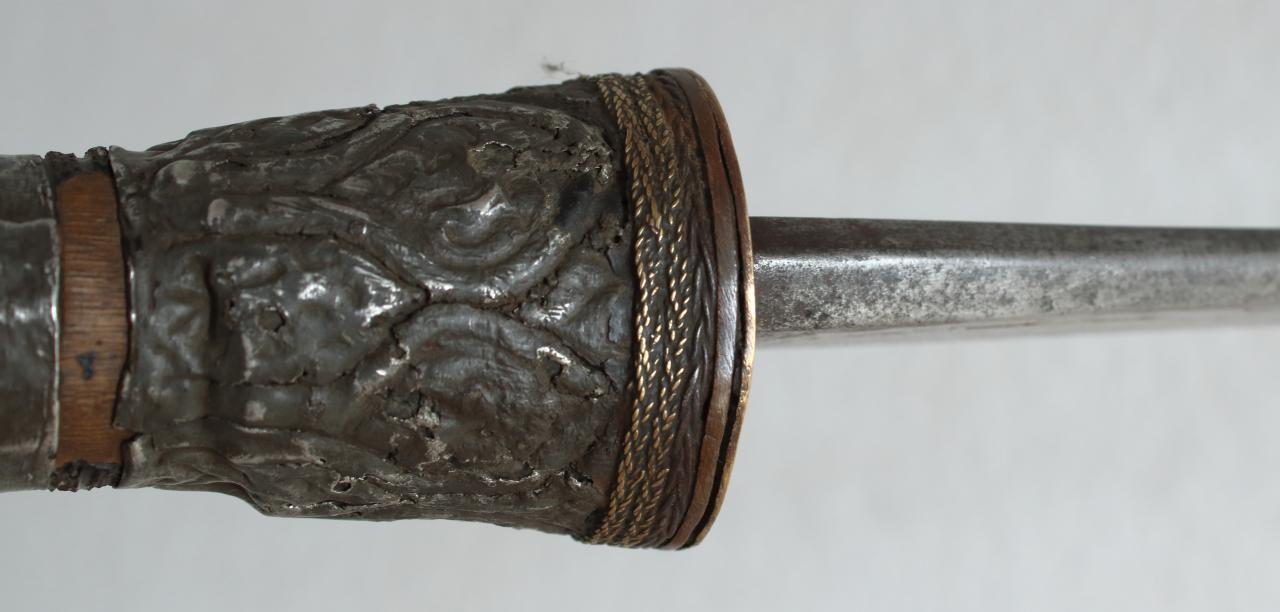

The sword in question was once a very nice sword, sadly it's left as a relic only. The stuff at the handle is indeed a mixture with resin and other components to form the thin silver cover which is mostly gone. It's a similar technique which was used by keris handles.

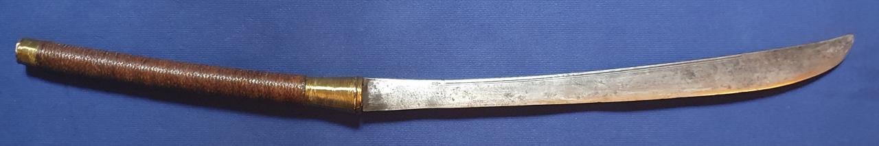

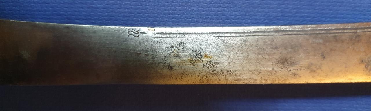

Yes, we had this discussion before. These markings are old and traditionell and not only seen on these tourist dha. Here is a Thai dha from my own collection, clearly old, I guess around the first quarter of the 20th century, with similar engravings on the blade. Regards, Detlef |

The resin you mentioned is the usual tree resin used to fix blades and handles. Very multipurpose for dha/daab and you will find it used to glue down all sorts of materials. The blade decorations are typical in both Lanna and Laos and can be found on blades with great age and of course newer 'touristic' swords. They are not a sign of a good or blade in their own right and need to be assessed with the whole sword. |
#10 | |
Posts: 4,738
I think you are correct to be cautious about some of these marklngs. The flowing sinusoidal waves on the original post in this thread are very traditional decorative traits, mainly associated with northern Thai/Lao blades but occasionally seen more widely (such as on "Montagnard" examples). Swords and knives with these markings have functional blades (I have not seen an example with a clearly poor blade) and I don't think of them as designed to be tourist pieces. On the other hand, low quality tourist blades often have the features shown on Detlef's vintage example (clearly not a low grade blade): namely, the lightly engraved lines running parallel to the spine and elongated S-shapes that resemble integration signs used in calculus. The latter, often punched in groups somewhat randomly along the blade, occur a lot on the poorly tempered blades of tourist swords that were sold to GIs during the Vietnam war (1960s and 1970s), and subsequently. These are the marks that raise suspicions about quality (Detlef's nice older example is the exception). Hence, Iain's caution about looking at the whole sword is very well placed. Regards, Ian. |

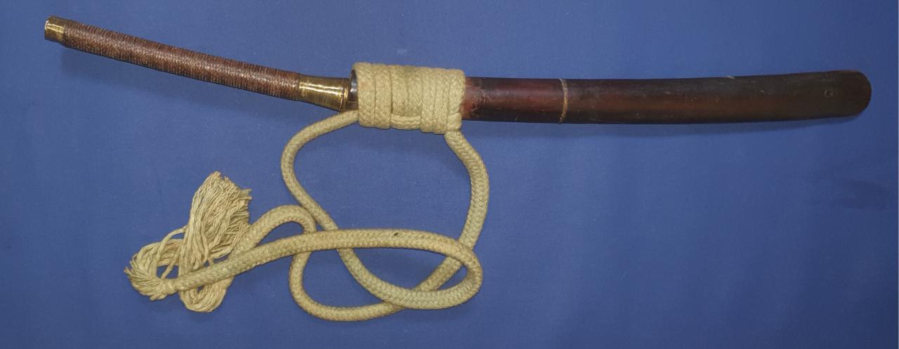

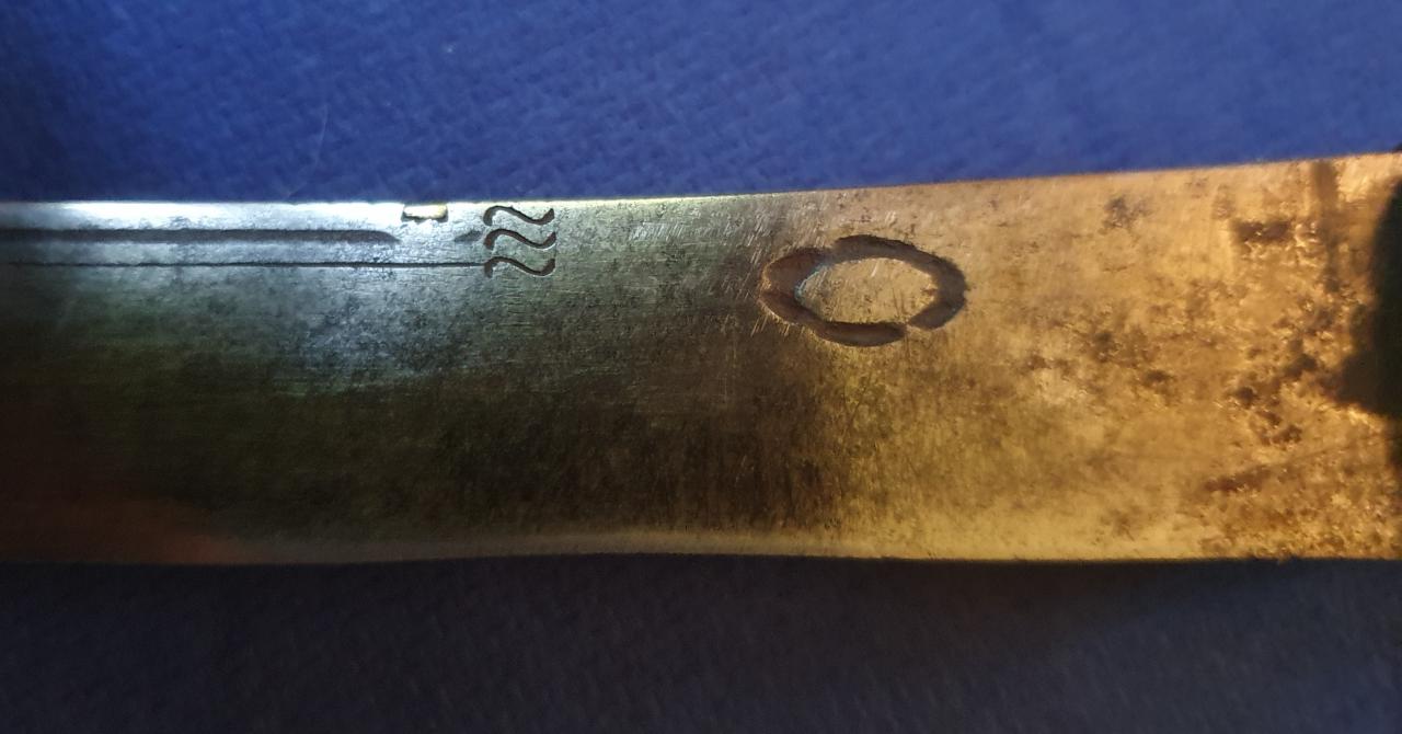

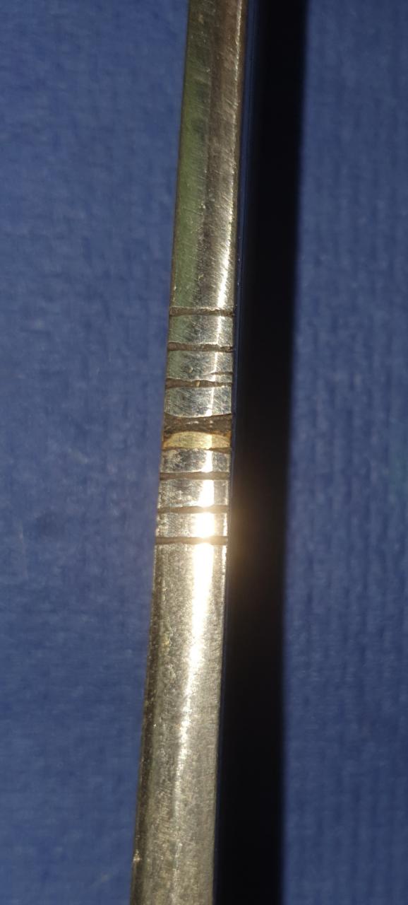

I don't think that my sword is vintage, I think that it's from the early 20th century, maybe older. I guess Northern Thailand, Lampang region. Attached a pic from the spine with brass inlay and the "turtle" mark on the other side. Regards, Detlef |

You could be correct about the age of your sword. Always hard to judge age of these items from pictures. I tend to be conservative about the markings on your sword that I described earlier in this thread, because I have only seen them on swords that I would consider post-WWII in manufacture. Similarly, I've not seen the "turtle" mark or those spine markings on "antique" swords. Always willing to be proven wrong. ![]() Also, please note that I use the term "vintage" for items 50-99 years old, and reserve "antique" for 100+ years old. Thus, "vintage" includes part of the period you describe. Regards, Ian. |

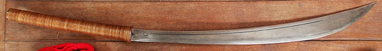

So far I know is this turtle mark (so is this marking called by collectors in South-East-Asia) an old mark from this region, here are a few examples. Regards, Detlef |

The "turtle mark" was discussed in the old UBB Forum on this site, but unfortunately that platform was hacked and the files corrupted. IIRC, the mark was thought to be found on northern Thai/Lao daab starting in the 20th C, around the 1920s or so. It also extended into the 1970s and later on the poor quality tourist swords that U.S. Vietnam vets and other travelers brought home. As I look at the three latest examples you posted, I would say the top one is probably post-WWII, the bottom one maybe WWII-era or thereaboiuts, and the middle one (a nice Lao daab) maybe pre-WWII). However, my earlier caveat about dating these daab from pictures applies--it is very difficult to estimate age without having them in hand, and even then not easy. My approximate ranking of their ages would still put them in my "vintage" category. Iain Norman may have more information about these. Regards, Ian. |

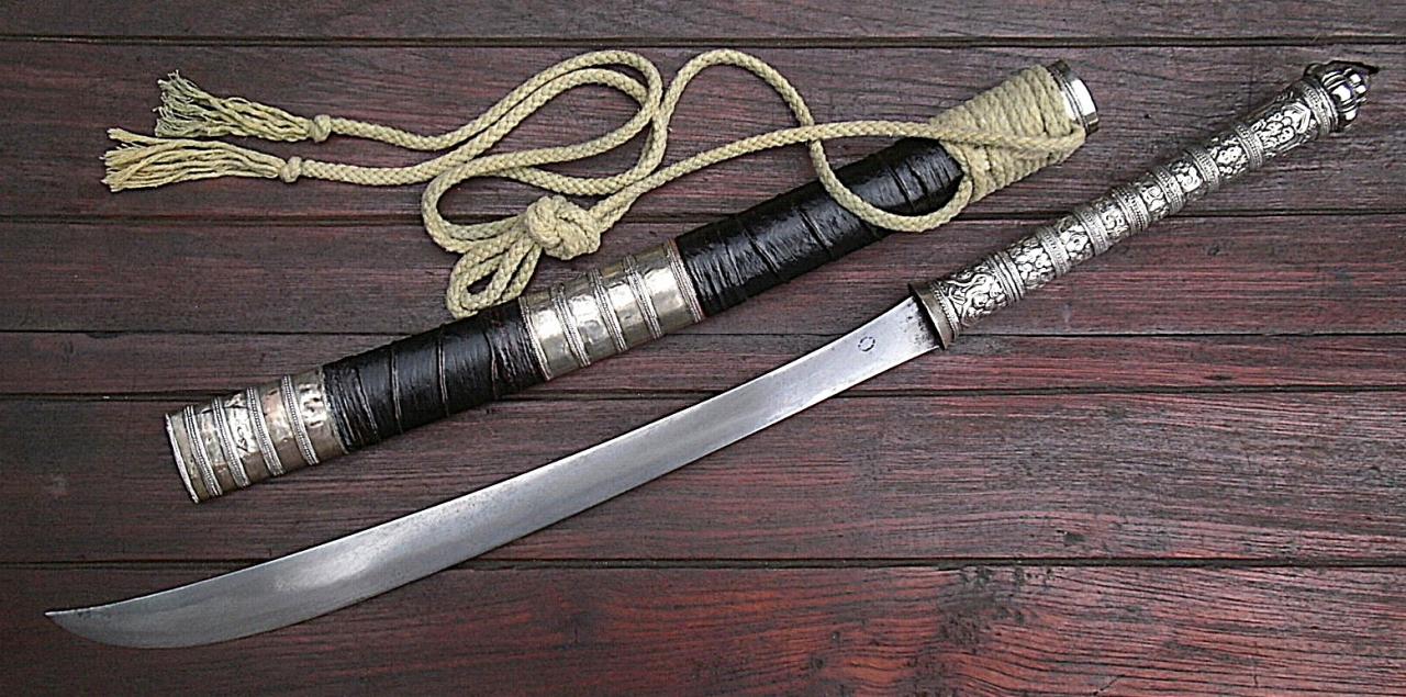

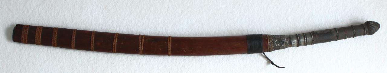

As far as I understand the turtle mark is a well known mark from as far back as the early 19thc possibly a bit before, and the swords shown in the last pics by Detlef are both later 19thc productions, and the silver one is not from Laos its a typical Lanna Thai sword in Lanna Thai silver dress - mounts from north Siam - Thailand.

The so called turtle mark is generally common around Lampang and the surrounding areas and dates back to the 19th century as far as is generally known. You don't see as many of them in western collections but there are plenty of very nicely made blades showing it in Thai collections. As I've mentioned before on this thread, all dha/daab need to be judged based on all their attributes and not on a single blade mark or any other attribute. Does that mean you won't find that mark on much later swords? Of course not, but it is in no way a 'tourist' marking.
From Lampang the mark and/or blades seems to have been traded across the wider region and you see examples in Lao silver dress as Detlef as kindly posted an example of. Keep in mind that handles, pommels and other fittings could and would be changed and refreshed during the working life of a sword. This is still common practice in the region and considered acceptable in local collecting circles to carry out quite extensive restorations. I'd be happy to share some more resources on these swords as there are collectors in Thailand who specialize in these types, but these will of course be Thai language. |
