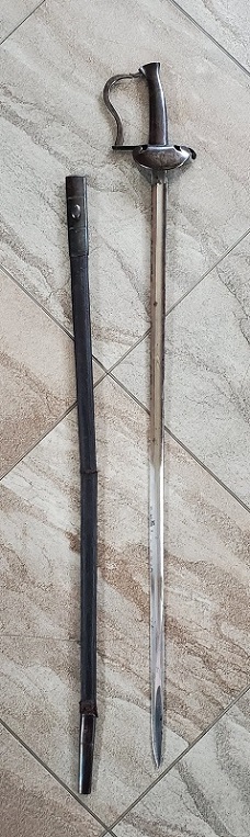

In sword esoterica we are familiar with the small swords known as mourning swords in the 18th century, typically held to be blackened steel with otherwise similar elements to the regularly worn forms.

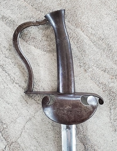

However this particular sword seems to have appeared in several sale venues, and seems to be the same sword identified as 'corpse carrier sword' from Austro-Hungarian context latter 19th c. The reference was apparently a book on arms of the Austro-Hungarian empire but cannot recall title and never acquired the book.
While the unusual scalloped shell element on the guard resembles many types of traditional court swords, this one is most unusual, as is the classification presumably referring to pall bearers in official status.
I'd like to know if anyone has seen such a sword type, or any such term used in classification. While on the topic, it would be interesting to know just how old is the tradition of mourning swords, and the characteristics of these into those of the 18th c.

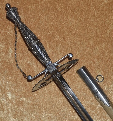

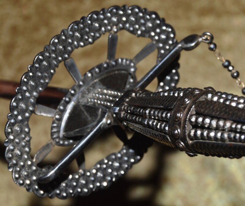

Found some examples :
It seems the fashion for these types of swords by 1790s had evolved into the cut steel neoclassic styles which were produced by Matthew Boulton of Soho and followed by other shops. These were often elaborate and highly embellished with beading and piercings.

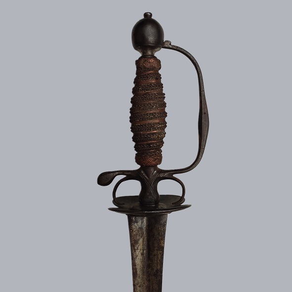

Default Italian smallsword 1690-1720
This Italian smallsword is listed as smallsword with 'blackened hilt' and copper wire grip, noting these types of swords were often 'misleadingly' called mourning swords. It is claimed that this style of decoration was actually in accord with dark toned clothing favored by men in fashion in these times.
I disagree with this assessment as it is well noted that these swords were NOT exclusively used in mourning and funerary occasions but also worn in occasions where somber or unobtrusive weapon would be worn.
Also, the notion that the early versions of these were cheaply made with poor blades (Aylward, 1945) seems to be perhaps an exception, possibly in England. This Italian example of end of 17th century has the triangular blade of 33" which was in following with formidable light rapiers becoming the fashion in civilian swords of the time.

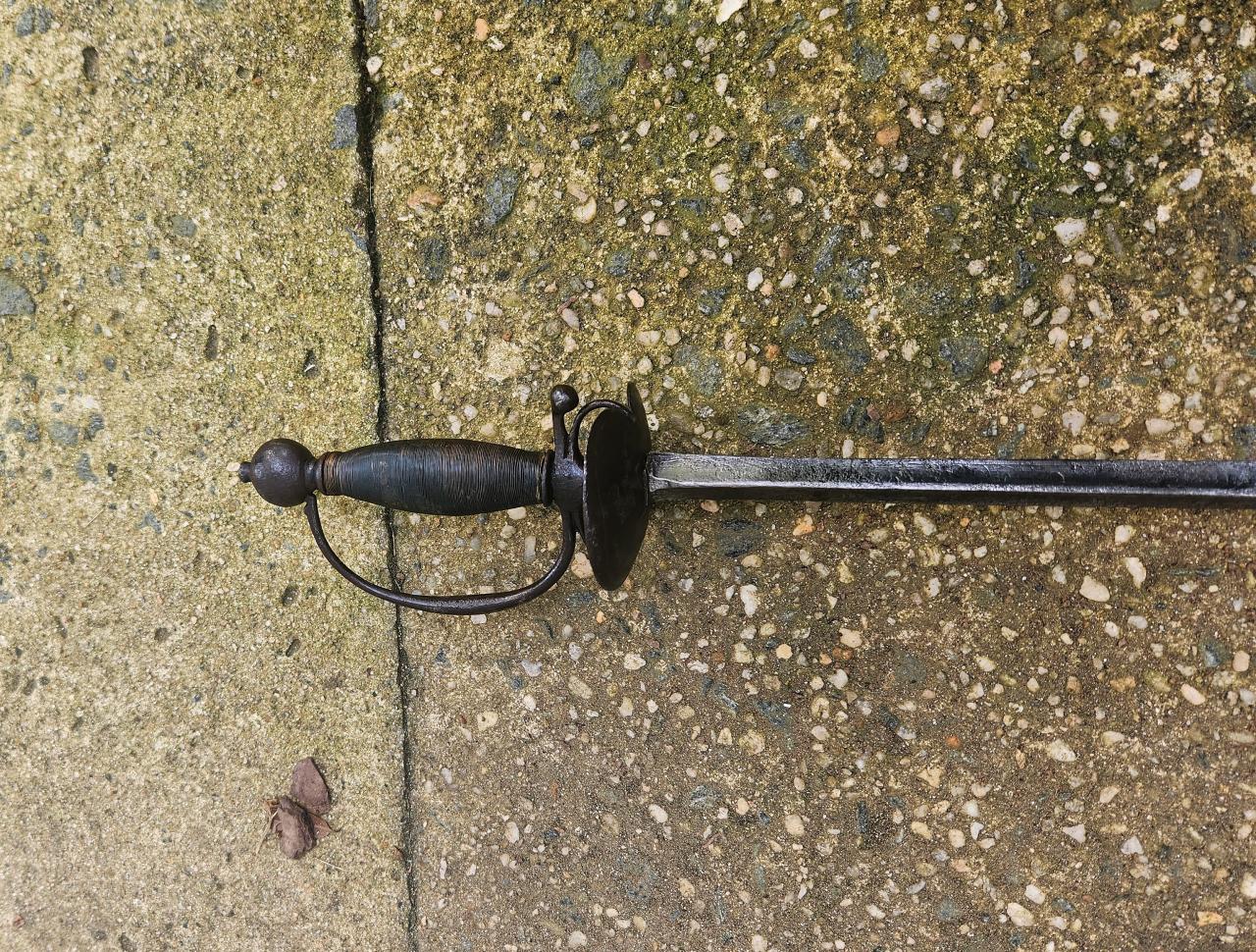

Default Mourning sword?

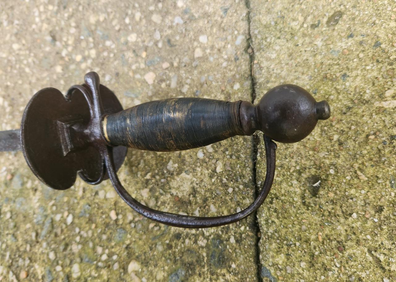

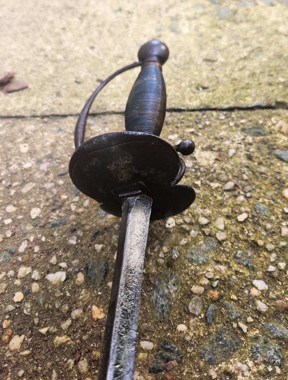

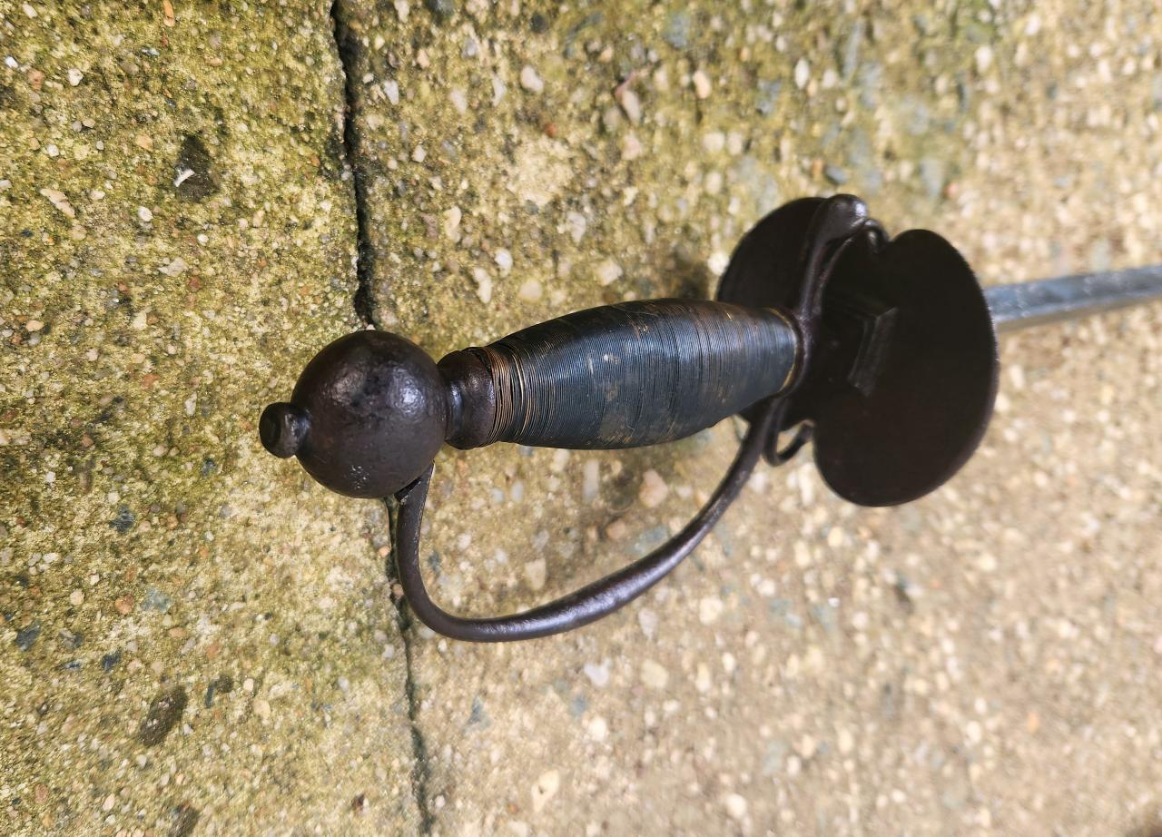

Here's my one and only smallsword from my collection. Although not naval per sae, Annis & May mention Spanish sea captains being partial to smallswords. In any case, althoug 'dainty', mine has the correct design pattern for a 'real' smallsword, including knuckle bow, pas d'ane, bilobate guard, etc. The blade is a trifoil, very sharp with no markings. I used to think this Plain Jane might just be an American knock-off of its fancier Euro cousins, but with the balckened hilt and blade, I'm now suspecting this to be an earlier 18th c. mourning smallsword? The grip wrap is a replacement that someone darkened to match the sword. I think you are right, Jim, that these still were functional pieces for un-dress occasions. Now if I'm wrong, folks, let me know as I am no expert on smallswords-
Old 21st July 2025, 02:50 AM   #10
Posts: 10,862
Hmmm Capn, I think you may be onto something!!! Very nice!
I am so partial to solid, unobtrusive weapons like this, strictly business.
There are FEW experts on small swords, especially around here! As civilian weapons primarily, while following conventional form, there are many affectations and nuanced elements to identify most with any certainty.
It seems that blackened in this manner, your example might be one of the austere sorts that could have served in mourning capacity in the earlier years of the 18th c. Small swords were of course not typically blackened. That coarse black wire grip also seems to respond to Aylwards description, however this blade seems anything but 'cheap', and looks quite capable for use as required in defense.
The idea of this being American is tempting, but hard to say as the colonies, like the colonists were of course British. It seems that small swords were indeed preferred by naval officers, but these were typically with brass hilts. Possibly as often done with weapons facing harsh, damp environment they were 'japanned' (= painted black) but again with small swords they were already brass.
Remember Lt. Maynard in his famed encounter with Blackbeard, held a small sword which was now basically only the hilt, having been broken in the ensuing combat.
Nice, rustic example Capn!!! It serves well in your maritime collection, though it very well COULD be one of these intriguing mourning swords.

"With Drawn Sword: Austro-Hungarian Edged Weapons from 1848-1918", M.Christian Ortner; Erich Artlieb, 2006, p.523,
This exact sword form is shown as a 'mourning sword' but more austere than the faceted smallsword also captioned the same. Both are to the IMPERIAL HOUSEHOLD.
The Royal funerary traditions and protocols of the Habsburg's were detailed, dramatic, almost theatrical and more. The ceremony extended to virtually all the court figures from Princes, Dukes and high ranking nobles.
It seems reasonable that specifically appointed regalia would be in place for these elaborate events, and these swords ...though not mentioned in the pages of description, as typically the case regarding swords. ..are unique.
In my opinion the sword of our discussion is likely indeed for pall bearers in these elaborate Habsburg processions, while the more elegant faceted smallswords more for the dignitaries and ranking court figures.
This sword was likely in use during the Royal Court of Emperor of the Austro-Hungarian Empire Franz Josef I and his wife Elizabeth of Bavaria, Queen of Hungary post 1867.
