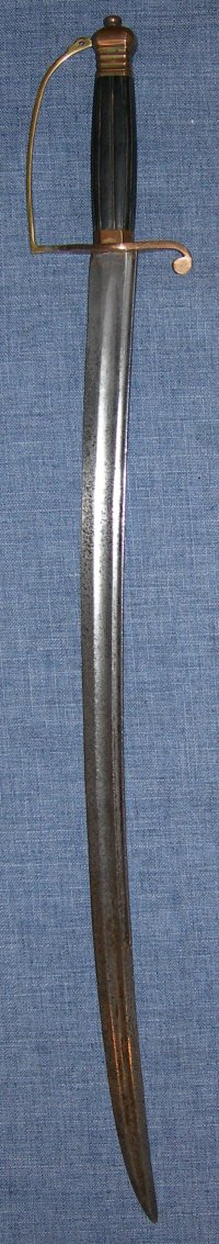

I found an Oley (Shotley Bridge) blade with this hilt and wondered if anybody would tell me about the hilt. It has lost its grip binding in the past, replaced with copper wire - which works but is disappointing. The hilt is identical on both sides.

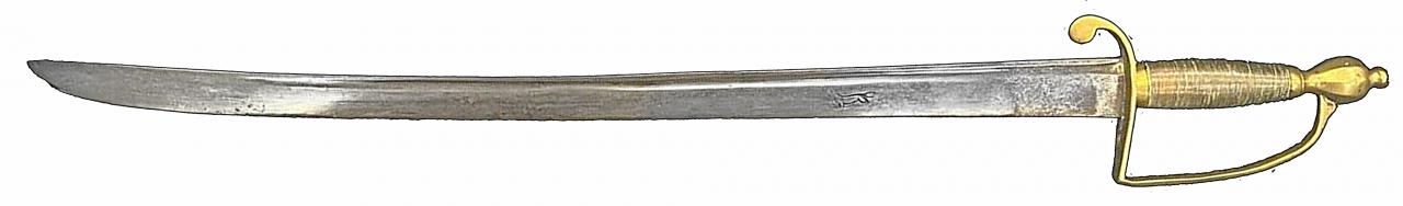

I've been searching in Bezdek but the nearest I can find is this:
Can no-one offer any more?

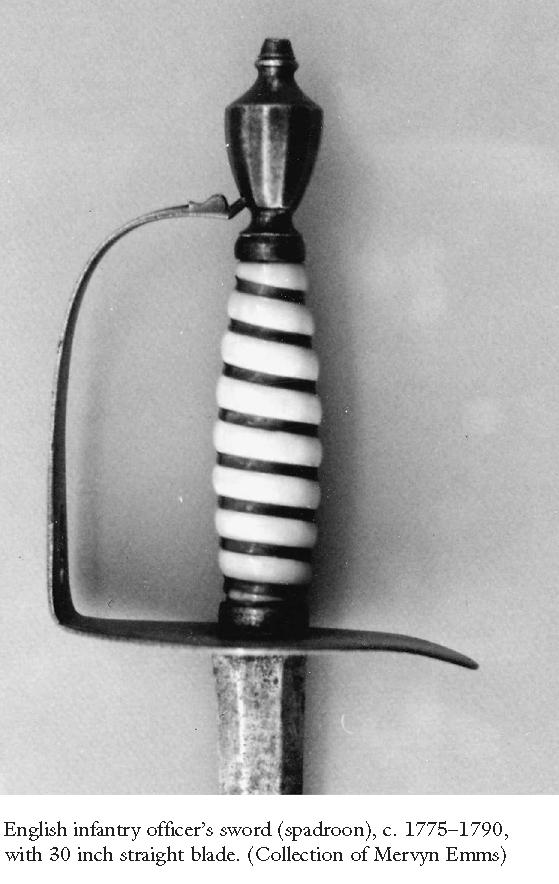

It reminds me of the British spadroons from the American war of Independence era.

Keith this seems like a book illustration, you note other side hilt is same. What is the reference? context?
From the illustration, the example you have found is indeed close most notably for the tall urn type pommel, which as in your illustration is faceted.
These type of urn type pommels were from the neoclassic fashions and styling of Robert (1718-1792) and James Adam (1732-1794) whose mostly architectural designs (known as Adamesque) became in vogue with popular cut steel small sword hilts of Boulton 1780-90s.
These hilts as in the example you show were spadroons, sort of between the small sword (thrust) and heavy broadsword. They were straight blade backswords (single edge) and became regulation infantry officers swords in 1786. ...as noted by werecow previous post (this with brass and 'montmorency' style blade usually used by James Wooley of Birmingham....these I think were naval).

Hi Jim and Werecow. Thanks for responding to this. Let me first explain: I bought this sword at an auction last week simply because it is an Oley blade.

and differs to the one above used when selling to the Birmingham smiths and the Tower cutlers; this made me curious. The blade is shorter than those mid. 1700s cavalry hangars which were c. 27"… this one is 24" and I wondered if it had been shortened at the ricasso but the fox punzone is exactly the same distance down as my 1740s example.
There is very little room under the collar of the grip binding, suggesting to me (also considering its absence) that it was leather, or a wire of narrow gauge like this copper version (which is patently from modern electrical engineering supplies) and not your typical twisted arrangements. I forced a very thin steel needle between the coils of the wire and it is definitely wood underneath. Of course it could be a wood grip stock replacing a bone or twisted horn style that was irreparably damaged.
Certainly it seems obvious that the sword has been re-assembled (without including the grip wire) and this hilt has been added much later than the date of the blade's manufacture.
