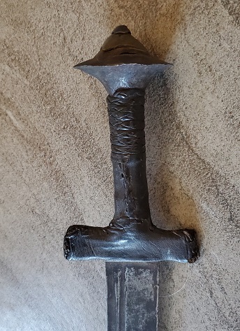

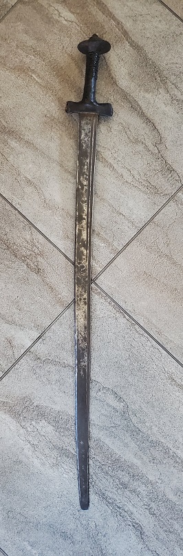

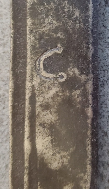

What we have here is a takouba of West Africa, said to have come from Ougadougau, Burkina Faso, which is regarded as 'aljuinar' (slight curved blade). The blade appears distinctly European hanger, and in the center of the blade is a marking, placed much as on many of these blades in mid 18th century.
It appears to be a version of the capital Greek letter OMEGA, which has found use symbolically in many versions from scientific to occult, even Gnostic symbols and other occult systems.
While not an exact rendering of the Omega, it is remarkably close, and it might be a version in accord with any number of forms of the character.
Could thus be a mark used by a European maker? or otherwise symbolically applied?
Or, could this be some tribal symbol added to the blade as sometimes done?
In checking Tifinaugh, and Berber symbols nothing turned up, though this arc with hooked ends had some instance that did not seem close enough.
Just wondering what thoughts anyone out there might have....has anyone seen such a mark on a Saharan blade? European?
