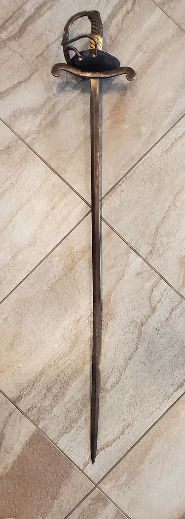

This Mexican sword seems to be of early 19th century, similar hilts are noted in references with the odd combination of multi bar guards combined with cup guard, and resemble the 'round tang' espadas (Adams 1985). The blade is of course clearly not a fighting blade, so this would appear to be a dress or possibly for an official or officer.

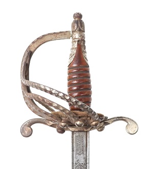

Online I found the example to the right listed as a Mexican generals sword 1883-1918.

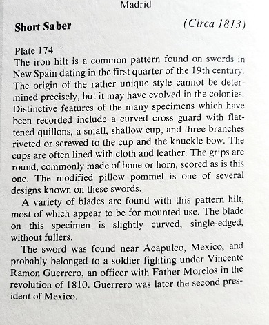

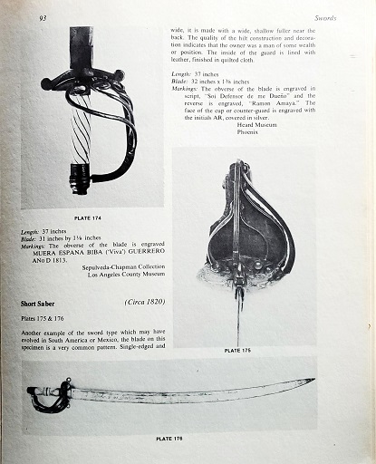

In the reference (pp.92-93)this type hilt is shown as saber mounted, c. 1813 during the Mexican Revolution and this example belonged to an officer with Father Morelos.....Vincente Ramon Guerrero. He later became the second president of Mexico, so the traditional importance of this type hilt can be seen.
The second example is of similar hilt character, and again seems to have been situated by form in southern regions from Acapulco to as far as South America. This one is put in the reference as c. 1820.

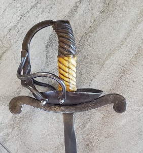

As noted, this 'double' guard was always perplexing to me.....its kinda like a regular cross guard PLUS a cup! Almost as if the Spaniards, so enamored with the beloved cup hilt, just had to keep it there vestigially.
You're right Capn, as we know the 'pirate' eponym was pretty broadly brushed and the Spanish Main was very much a notable haunt for such predators.
Those shell guard swords we discussed years ago and it seems always having old British blades seem to have been around in number, and situated mostly from Gulf regions, Caribbean into the coastal areas of Central and South America.
These curious 'double hilt' forms seem southern Mexico from Oaxaca across. It seems the halved grip (in this case with dark and light halves) was a known Filipino affectation, so perhaps the 'Manila galleons' brought it when docking in Acapulco.

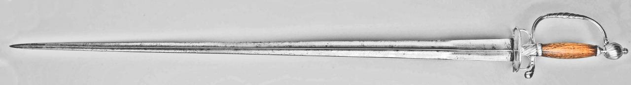

On this court or officers sword, the blade is almost like a fencing foil and not likely for battle use, but dress.

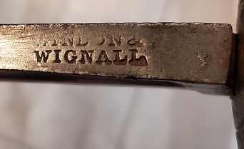

Pictured, the 'Brazilian' shell guard example mentioned, the makers were in England c.1830s
