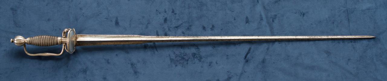

Forgive me if I am mistaken, but is this not the French infantry officer's sword Regulation 25th April 1767:
Name:  French officer's sword Regulation of 25 April 1767.jpg
ps
A superb sword

From what I’ve read the m1767 regulation hilt was silver or silver plated. They can also be identified by the faux turks head knots on the grip. It’s quite common to see them now in their base metal (a copper alloy) with the plating worn away.
My sword came from a dealer in the UK, who in turn acquired it from Matt Easton.

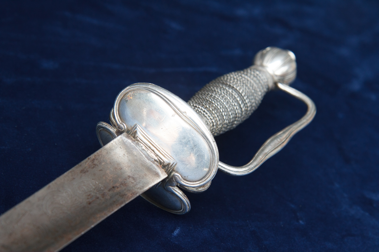

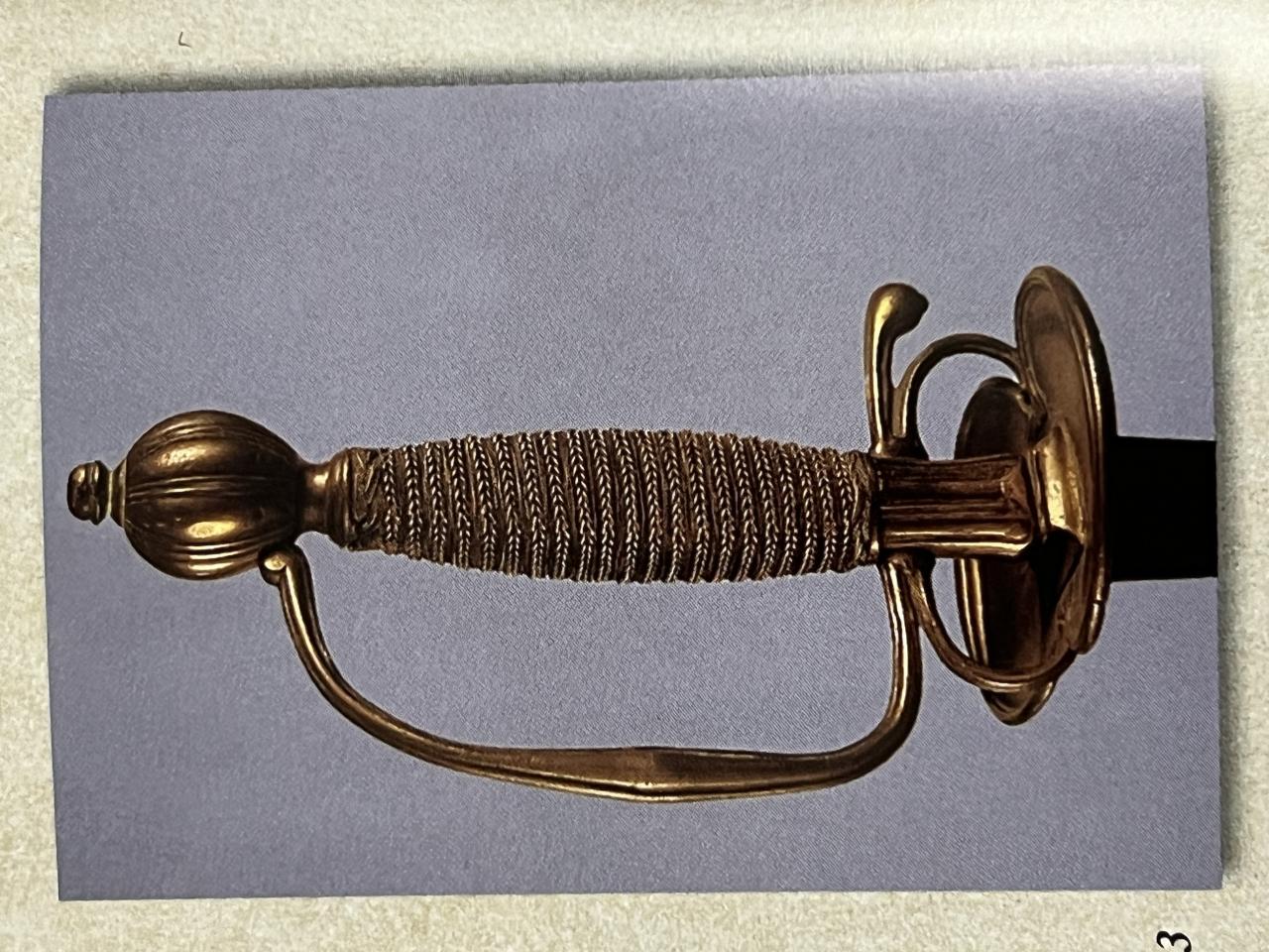

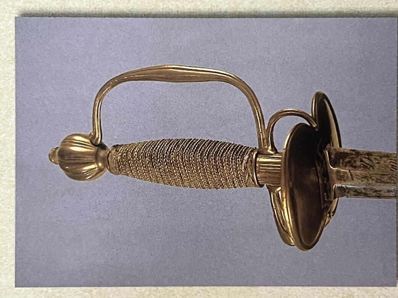

do these photos help?

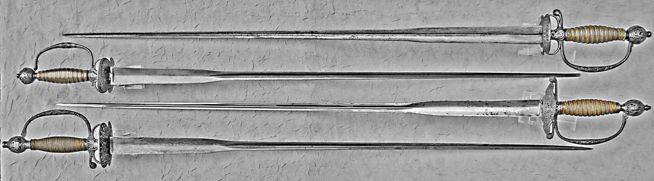

Old 17th May 2025, 08:25 PM   #7

Default Grooves
This is a machine rolled fuller.
Name:  Rolled fuller close up.jpg
Actually, the word fuller was originally the name of the tool used to hammer in the hollow. Anyway, a steel roller under huge pressure bore down on hot stock wedged into a mold cut into the anvil top producing the two upper hollows (same way as they made estocs, then later on Brown Bess triangular bayonets.
Sorry, I am editing here as it is confusing, the upper pair of hollows (with a medial ridge) are on the bottom of the hot stock. They are known as the top of the blade, even though they are below in the en guard position... I think.
It was how they could produce a hollowed smallsword blade in a single pass, as a reducing radius hollow was impossible.
As far as I am aware - hence my question regarding colichemardes - all colichemardes have the groove, a product of the machine which was chased out of Solingen due to the guild's Luddite viewpoint.
The Mohll family owned it and brought it to Shotley Bridge to produce hollow blades at a reasonable price as there were tariffs and heavy taxes on German imports.
The conclusion I recently reached was that the French would not be buying from Shotley Bridge, hence my search for French hilted colichemardes. Even George Washington's colichemardes had to come from England.
All of the dealers and collectors I have consulted agree that there are none but it is not totally impossible.
Does your sword have a groove? Also, why do you think the hilt is French?

Yes, there is a groove on the underside of the blade that terminates about where the blade begins to broaden out.
My sources for why my sword is a m1767 are other collectors and Michel Petard ‘Des Sabres et Des Epees’ Volume 3 pg 67.

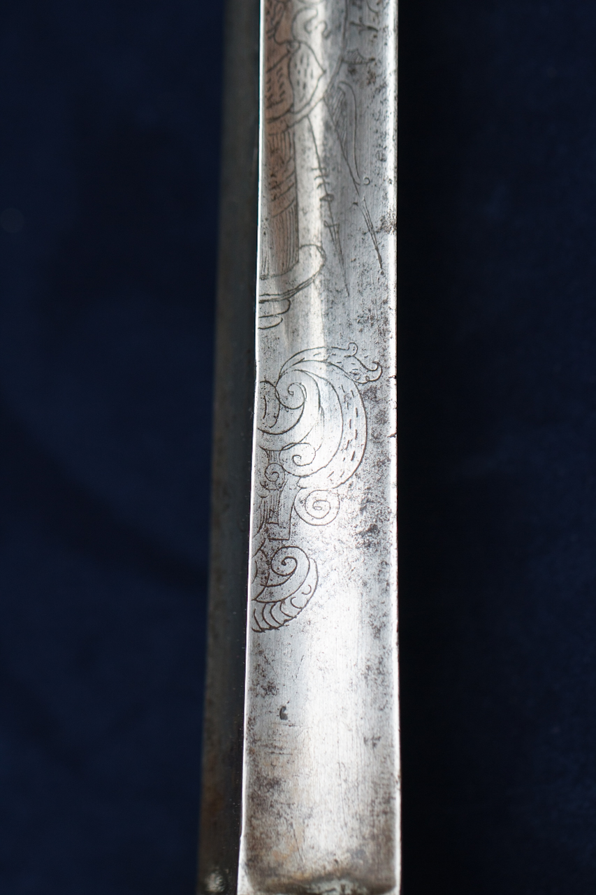

When I run my finger along the inside of the fuller/grove in the back of the blade, it isn't completely uniform. There is a noticable change in depth closer to the tip of the blade. This is different to my English smallsword which also has a grove (but no colichemarde), which is very uniform. Maybe the French blade was hand forged or not a Shotley Bridge supplied blade.
Re Matt Easton, I haven't asked him about my sword, I don't think he attributed any model to it when he had it.

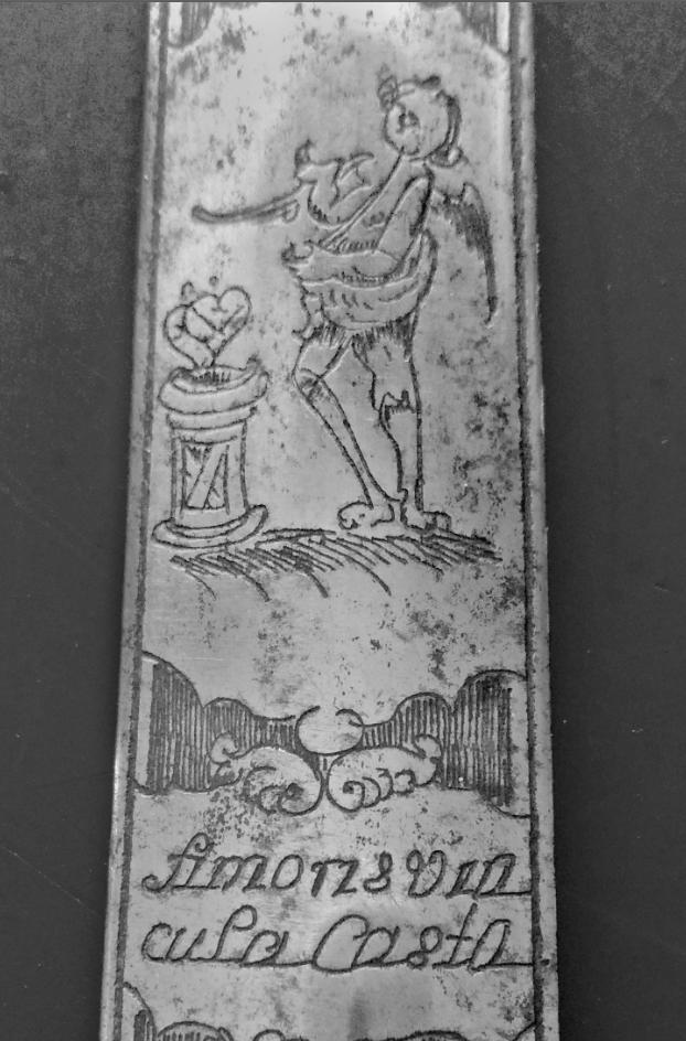

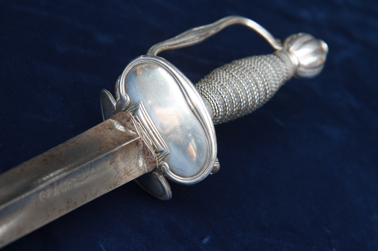

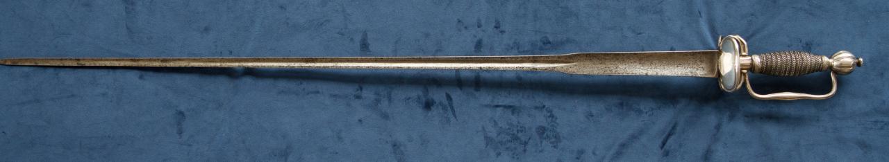

Hello again. I was thinking the same thing. I bought it purely on the basis of "like the look of that" and it was some time later that I saw a sword that looked remarkably similar and was titled 1767 etc. I didn't do any thorough research because it fell outside of my Shotley Bridge quest at the time. It was only when you posted your example that I began to give it my attention.
I've never really considered it a smallsword but it is, isn't it? Albeit, a battlefield weapon rather than a civilian one. The blade is superb, just stiff enough for penetration AND razor sharp. It has a most curious cartouche with an even more puzzling motto that, so far, has defied translation. It is identical on both sides.

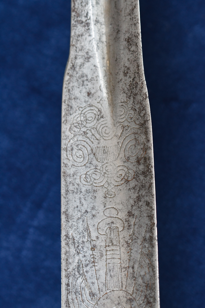

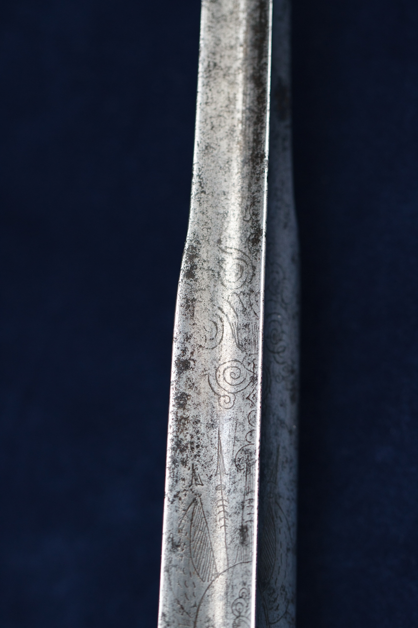

If it is not a pattern 1767 then I can't imagine what it is… maybe it is just a sword, custom made to suit. Regardless, I am very fond of it.
OK, enough of that, now the colichemarde: it is certainly a typical colichemarde blade but then again there are different versions of the groove. Here are four, from my friend Mel again (he has specialised in collecting smallswords ) and in one case you will see the roller traveled right up to the ricasso.
Name:  Mel 4 new edit.jpg

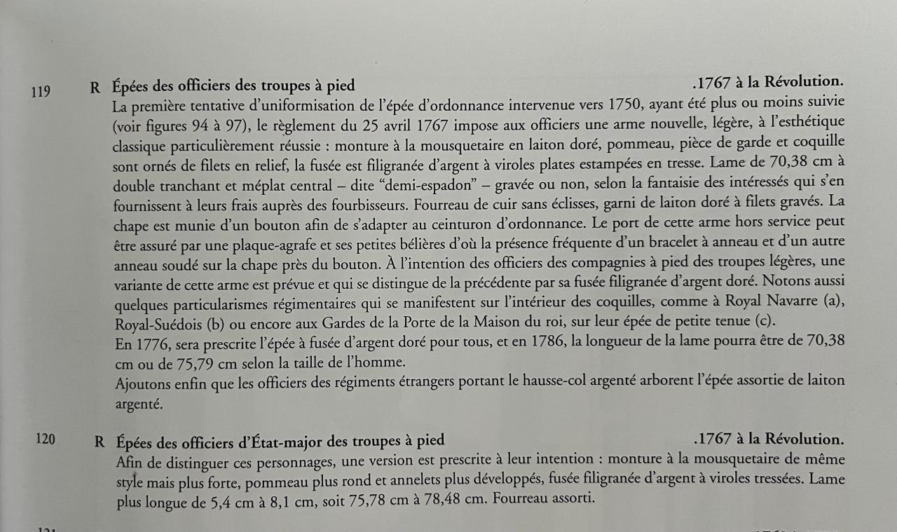

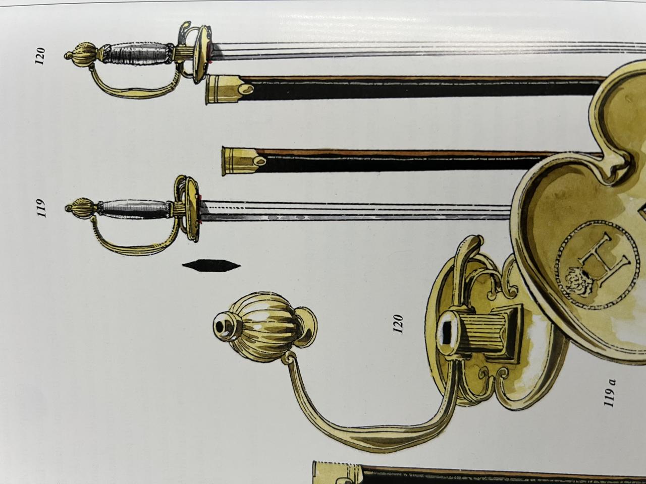

PS Radboud, thank you so much for adding these pages from these rather hard to acquire references!!!

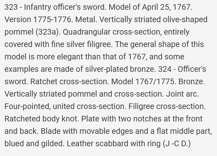

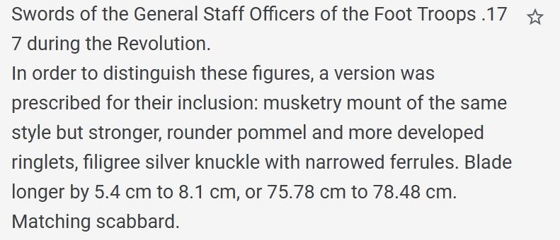

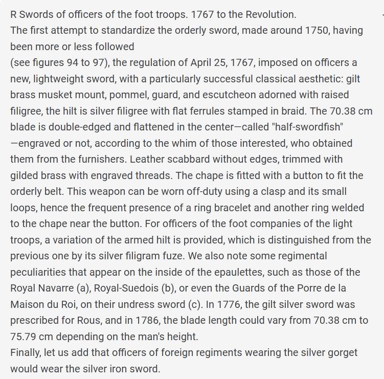

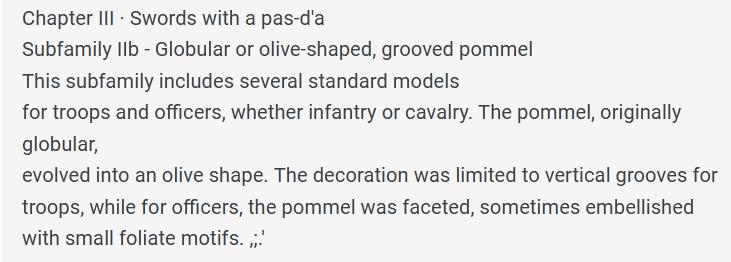

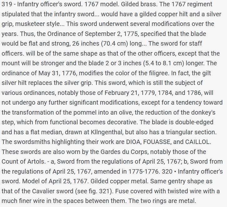

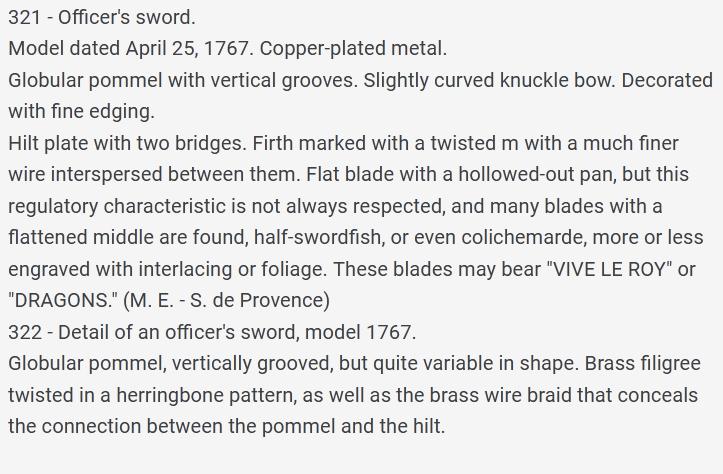

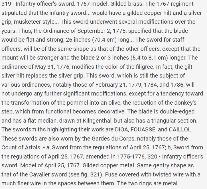

Hi Jim. Here is a Google translation of the text in those pages; unfortunately not in order but easily discerned. I can send you them by email if you wish.

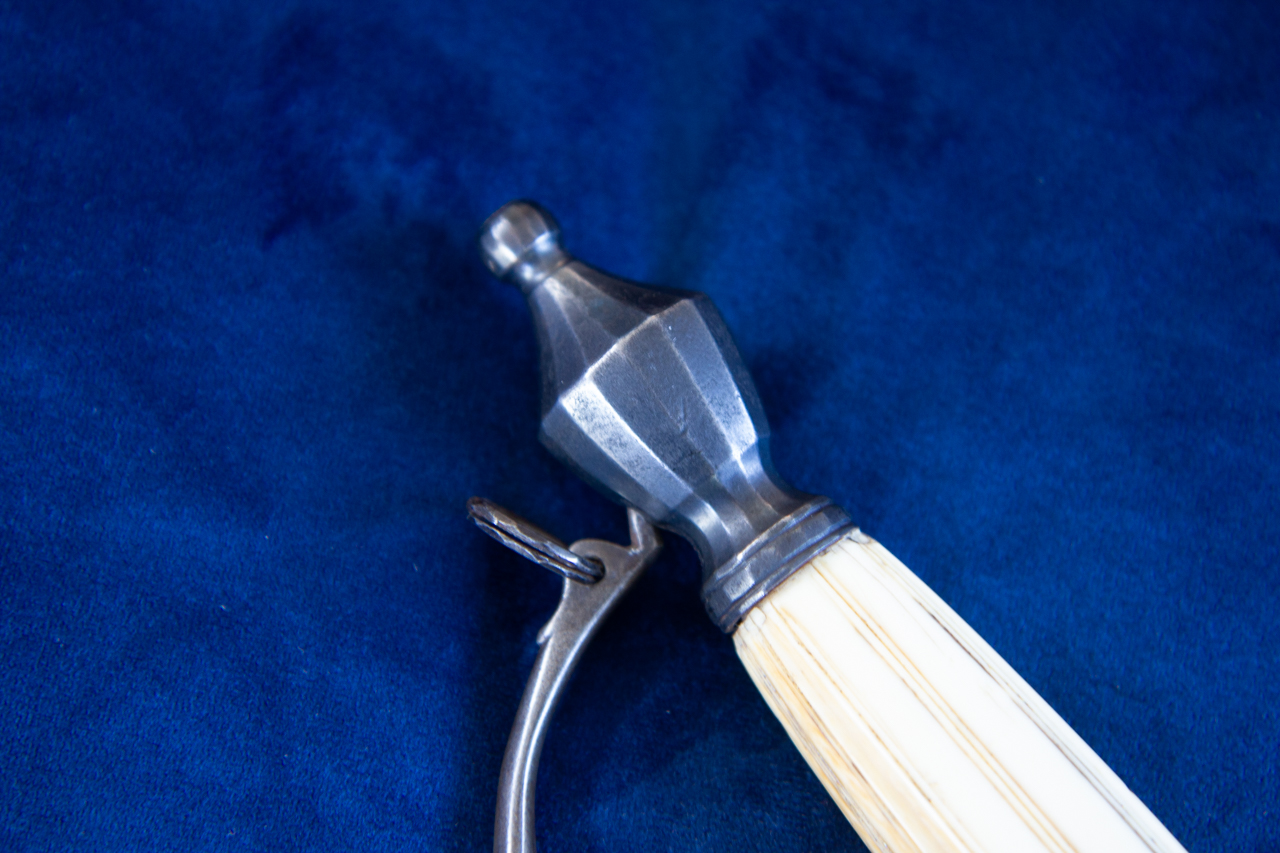

When looking at choices made, maybe "because it looks good" is enough to answer the "why bother" question. Look to the different fuller combinations in late 18th-century and early 19th-century sabres. These would also have needed to be pressed out with a die. Also labour was comparatively inexpensive at the time. Take this spadroon hilt for example:
There is no reason for this level of faceting aside from how it looks, even the lanyard ring is faceted. Think of the man hours that took for no practical reason.
Back to the rolled blades, is the fuller even necessary for the manufacturing process? Is it unique to the process or were they imitating a specific look? Making a blade look more expensive to produce as a possible explaination?

We are blessed with a university that has an engineering department that was started and funded by Lord Armstrong (of Vickers Armstrong fame) and, believe it or not, they have there a professor of engineering and metallurgy who both fences and is an amateur bladesmith/blacksmith and with whom all the others (we have three universities within spitting distance) suggested I consult.
I took a regular hollow-blade smallsword and a colichemarde along to demonstrate the product. My question to all of them had been: "given the standard of technology available in the late 1600s, could this sword-blade have been fashioned with a one-pass machine". The story back then was of secret engines that dramatically reduced the cost of producing the hollows in the blade. Prohibitive tariffs made the 'legal' importation of those blades from Germany excessively expensive.
The unanimous response from the professors was that the regular, all sides reducing radius, blade was very unlikely (even today! as a 'drawing' process would set up stresses in the steel that would encourage warping down the production line) but the colichemarde groove could have been rolled, and a machine to achieve this was well within the capabilities of engineers back then. The slitting mill, for producing nail rods, invented by the Huguenots back in the early to mid 1600s, is a perfect example of how far technology had progressed (see a representation of one of our local ones here: https://www.youtube.com/watch?v=F_UPuImxut0 and it perfectly displays the comparative simplicity of the rolling machine for blades.
Also consider the tiny, ultra-hard, dry grind wheels seen in Mohll's mill in Shotley Bridge that would dramatically speed up the final finishing of the hollows (which could equally have facilitated regular hollow-blade production - and may have done!) and it appears to me that the groove was considered desirable. The groove is undeniably lighter and stiffer.
