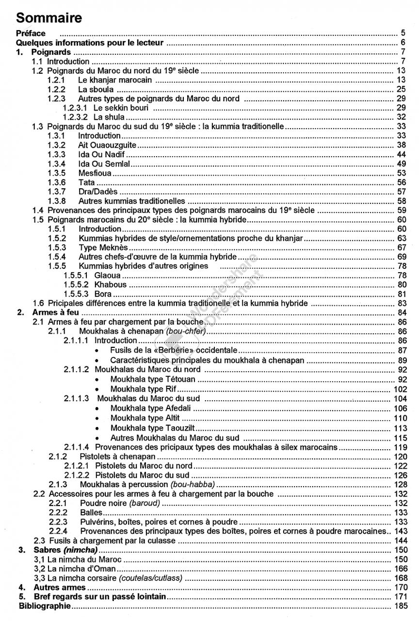

Attached is the Table of Contents for the Waelty book. As shown, it includes discussion of the Firearms of Morocco, plus Sabers (nimcha), and "Other Arms." Quite a comprehensive coverage. The link provided by gp allows reading of the whole book online, and also the ability to print it out. Unfortunately, I could not find a way to download a PDF copy of the whole book.
Ian.

Ian,
I clicked on the link gp provided. As far as I can see, it doesn’t give the entire book of 185 pages. Clicking on Echantilon de lecture only gives 39 pages (which makes sense because echantillon means sample in French). This is the sample I downloaded for this post. Since there is a “Contact” tab, I sent another email asking about the possibility of an English version but because my first email asking about this went unanswered, I’m not holding my breath about this one.

Rob, you are correct. It is just a sample. I had scrolled to the end of the online link and found page 184, thinking that it was the whole book! But unfortunately it's just selections from throughout the book, as you note.
