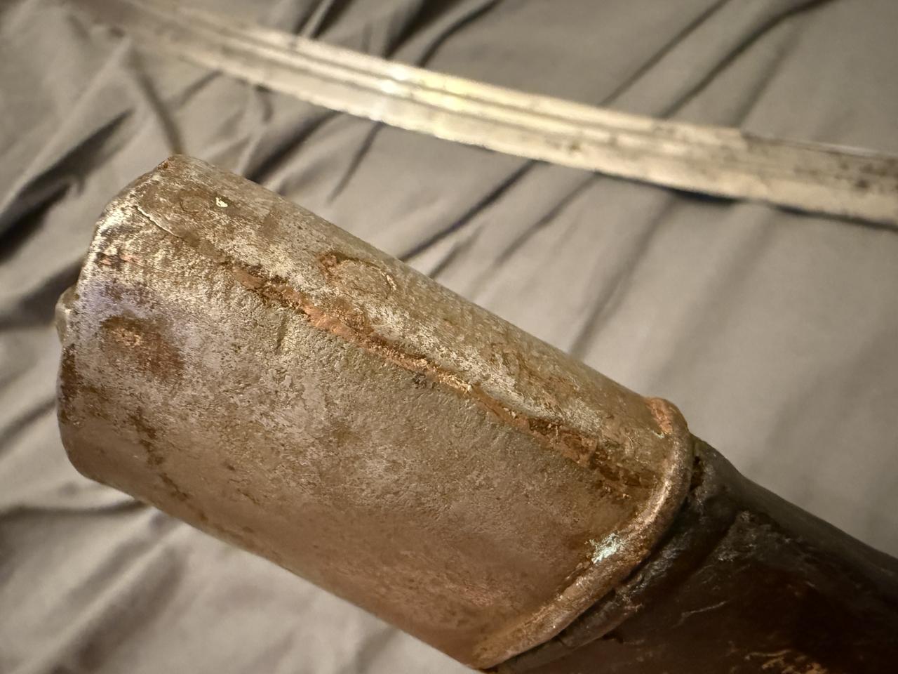

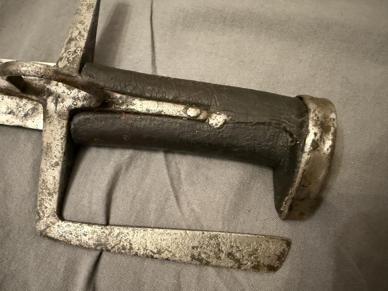

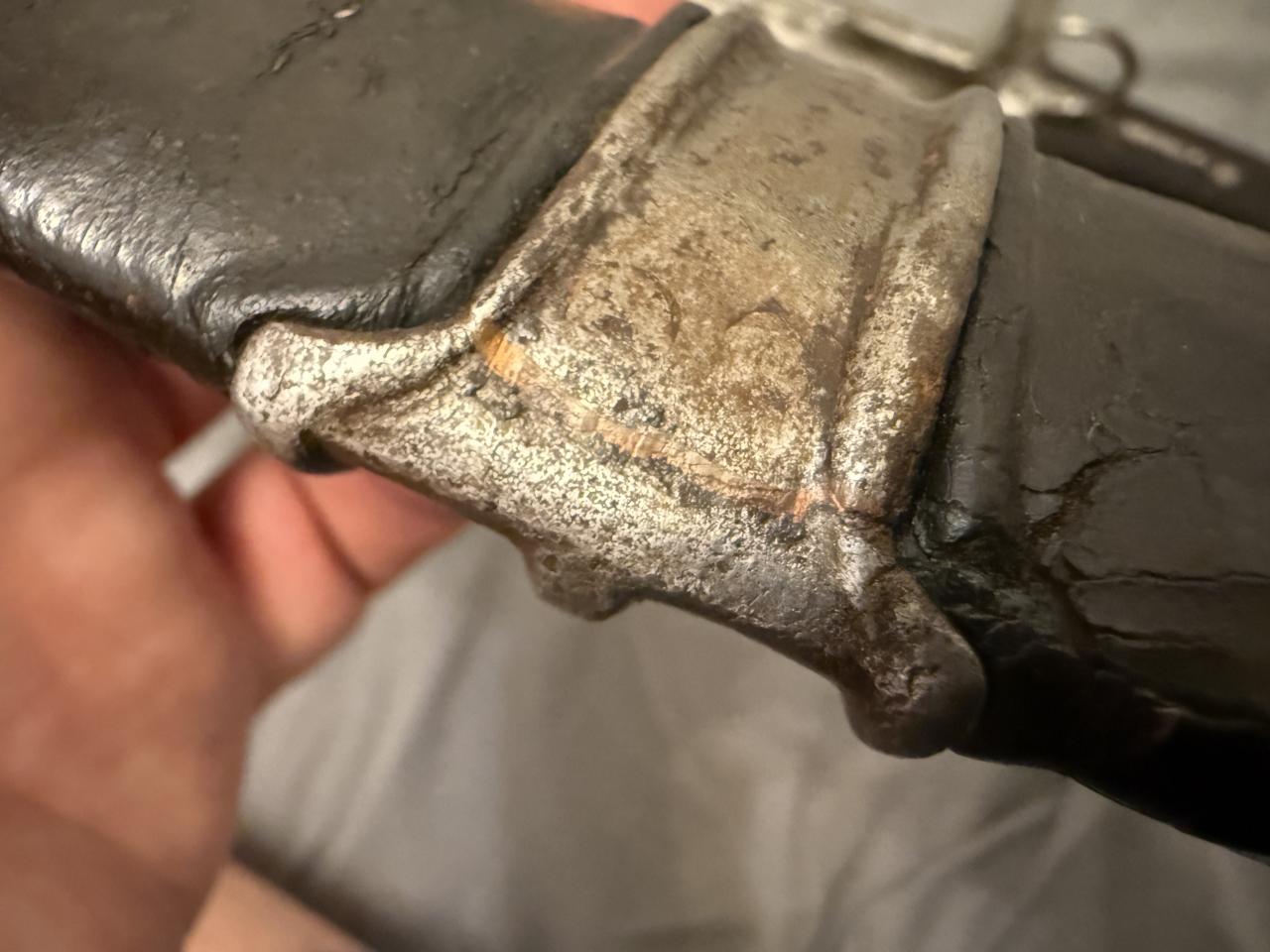

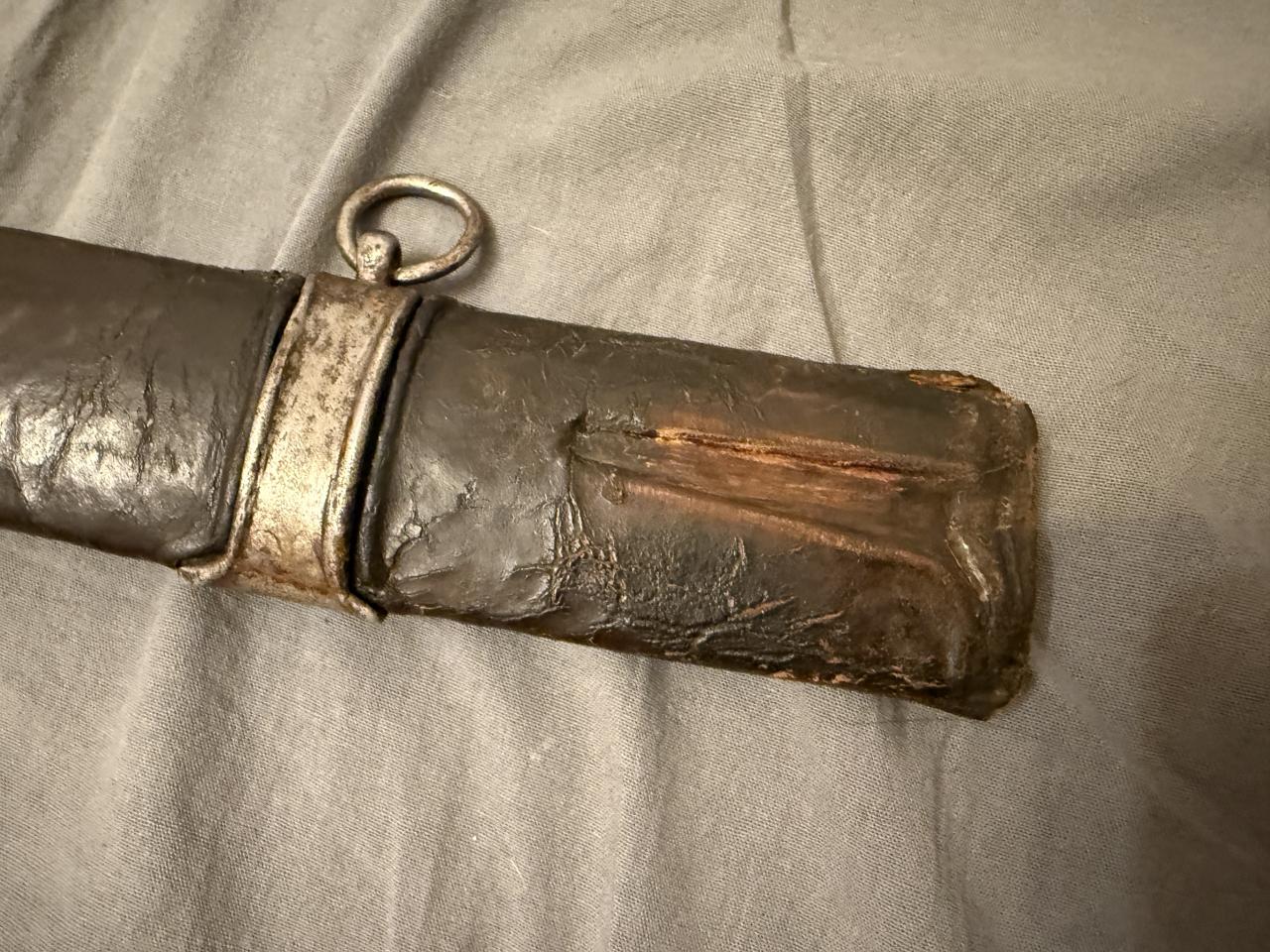

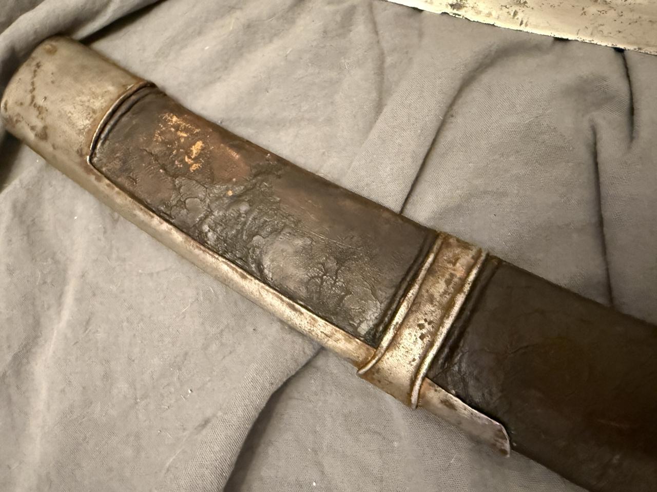

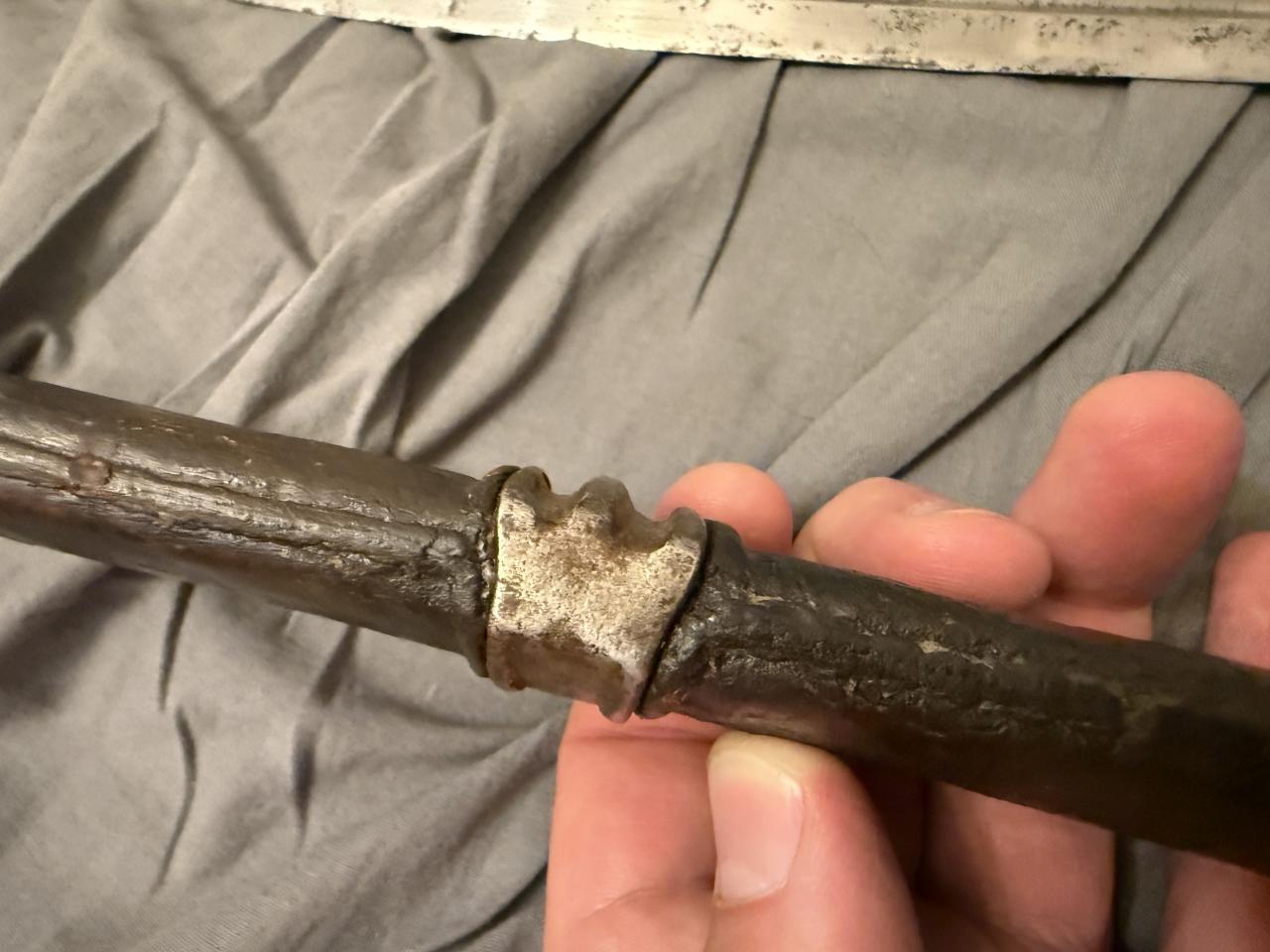

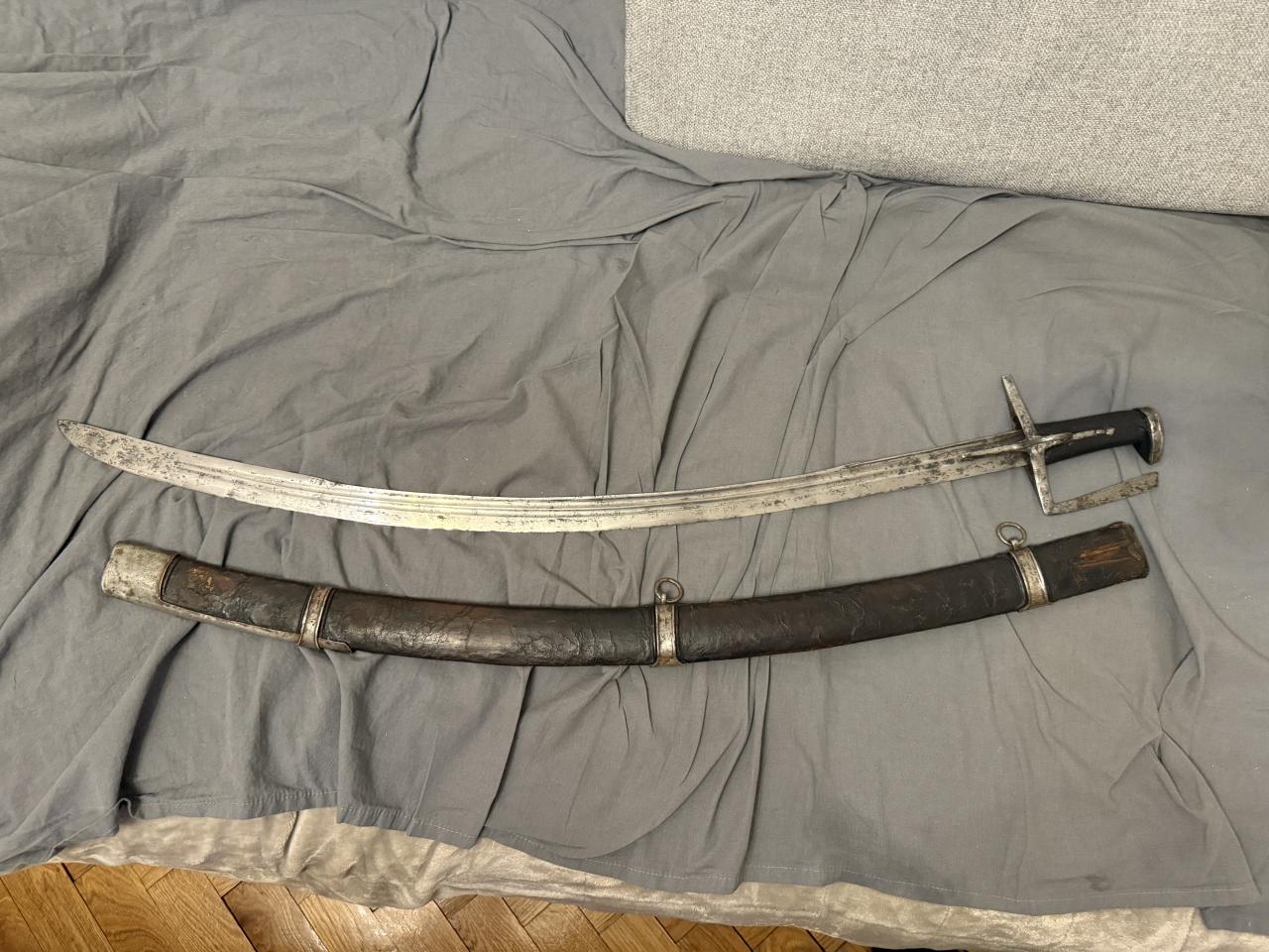

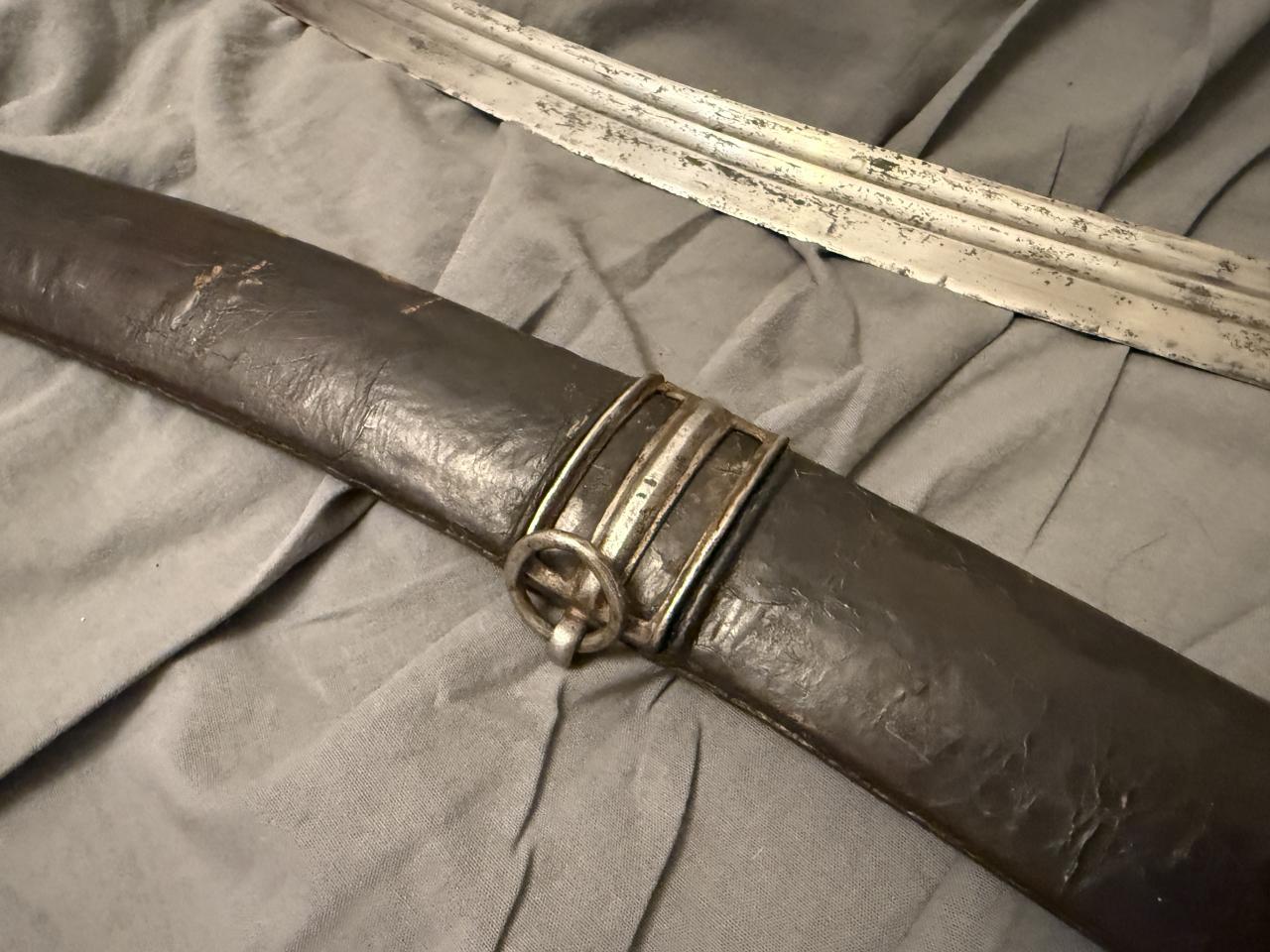

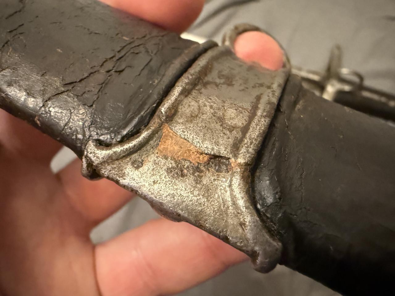

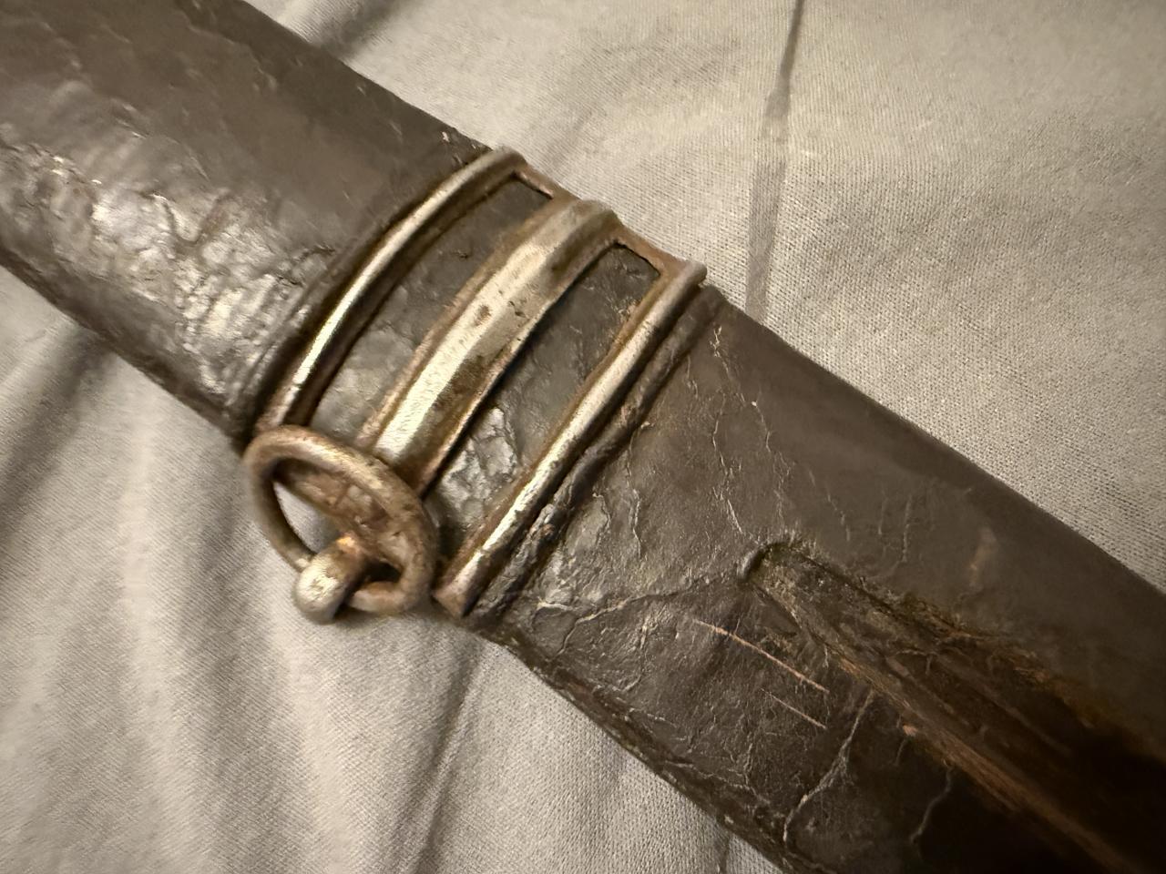

Hussar saber, blade marked with some kind of marka de mosca or something that looks like a germ , and with crosses on both side, blade is heavily damaged from rust and cleaned, maybe even with grinder or some kind of electronic polish.
Crossguard steel, thumb ring coming from crossguard and copper soldered, leather on handle restored and covered in parafin?
Scabbard wood is old, leather restored? With something, steel mountings copper soldered, carry ring slight traces of wear, just slight.

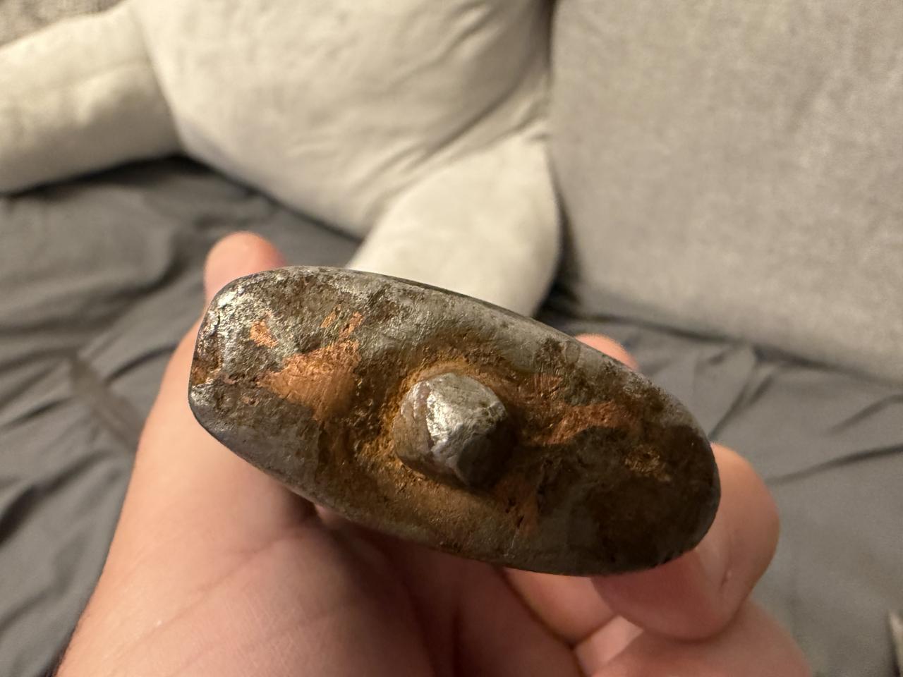

Thru slight hole near rivet that holds crossguard with magnifier and light i can se thorn of the blade and it is shinny, it reflects light better than the blade, i expected it to be rusty, hmm.
Aaaand thats it, if someone knows, is it genuine, or ?.
Thanx, Serdar.

So to conclude, after museum expert examined saber, it is genuine, but heavily cleaned and leather repaired and retouched.
So thanx.

About this saber, i bought it at auction, on which i saw a few not genuine "polish" sabers that to me are 100% obvious they arent genuine and are put together in 19 st or newer, this one and other one i examined they looked genuine to me, enough to buy them, especialy when i have auction house guarantee if i prove that it isnt i can returne the saber.
Guy at auction house said saber is examined from two experts from their museum.
After i had fiasco with fringia saber and polish saber before, which i took to history museum to guy who is a curator of antique arms and armor/ and restaurator, he confirmed me that they are not genuine but made to scamm people, after which i destroyd them, took them apart, it was painful, to see all epoxy glue inside and new wood, but you learn and pay for your school.
So i took this saber to the same curator, he examined it and concluded, he doesent know the makers mark (aka germ), blade is heavily cleaned but to him a genuine 17 st blade, crossguard cleaned but cooper welded as it should be, we moved a scabbard end mounting a little about half a centimeter and beneth is a rust, old rust, old almost roten wood and leather, same as is on the handle, with my premision he took piece of wood near the tang and light inside it is old wood in acordance with color of saber from 17 st they have in deposit, leather is smeared eith parafin and some thing he didnt know what, mountings on the scabard are cooper soldered, and cleanede, beneth them is a old rust.
He said that to him saber is from 17 st in style, manufacture and age, latest end of 17 begining of 18 st.
So if it is not genuine, then it eas made around thst time, they have fev polish sabers, and karabelas frim that time, and it matches, wood age etc.
I think that it would be imppsible to make and age it in this way, i dont see how that would be posible.
Makers mark is very poorly struck, on other side even more, i never seen it before.
After his examination, fir now i decided to keep it as saber from 17 st with big question mark ?
But there is another thing i dont know about you guys but the feeling, when i was buyng that noblemans polish saber my feeling was off but i bought it, allso with fringia one, but with this one my feeling isnt off, so i think il listen to my feeling this time.
And as i said, guy examined it thouroghly and said there is no chance that someone made this now for scamm, that it is imposible to chemicaly age wood, leather and steel in that way (in steel in pits there is still rust, old rust genuine) and would be expensive several times price i paid for the sword just to produce that, and would show in examination.
Soooo as i said, for now it goes on the wall with big question mark.
P.s.
I forgot to ad, his only concern was a pomel cap, he said it looks like it was made from several pieces like it should be, but he wasnt sure, on the front end it is wear and lines of solder are visible but it is under question mark.
And carry ring wear, it is very small, i would expect more wear on the ring holders, but as i said before, i have several authentic 16, 17, 18 century kilij swords and shamshirs that i know 1 milion percent are authentic, few of them are family heirlom, and they got even smaller wear and tear there, so it is not always a sign of time and authenticity.

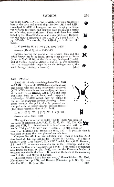

In looking again, the curious oval with arcs at either end marking does seem to have been a known marking, though not as widely known as many others.
In Wallace Collection (Mann, 1962, p.274) it occurs on a German sword of c. 1560-1600, and in configuration bracketed by the familiar 'Genoan' sickle marks (dentated arcs in parallel).
While these 'sickle' marks were apparently widely known in North Italy, the Genoan eponym was leveled primarily as that was the port of export, and these marks used in many locations, As with many markings, there were notable variations and configurations and while perhaps some were favored more by one maker over another, it seems these typically had some sort of application with other meanings.
In looking at the markings on the subject blade discussed here, it does seem the 'germ' marking as we might call it, must have been placed in situ on the blade in original use, the duplicate mark on the other blade face is worn.
The 'x' markings seem spuriously applied later.
Though the sickle marks were originally Italian, and later widely copied especially in Germany, it seems likely this curious mark was also from Italy in its origins. These Italian markings were also notably copied in Styria at several blsde making centers, and these centers are known to be the most prevalent supplier for blades for Eastern Europe's cutlers (despite Poland having some as well).
Attached page from Wallace Coll.
