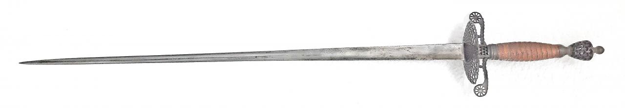

Before the classic style hollow blade colichemarde became popular in the mid. 1700s, there had long existed what was known as a "squeezed" blade that was not of a trefoil cross-section. Plenty of examples can be found today and I attach one below. This is a c.1760s rehilt and just one of a few variations on this theme.
Name:  early colichemarde.jpg
Few folk have possibly considered the fact that the 'squeezed' blade concept long predated the advent of the hollow blade and was certainly easier and cheaper to make so continued until both styles were available.

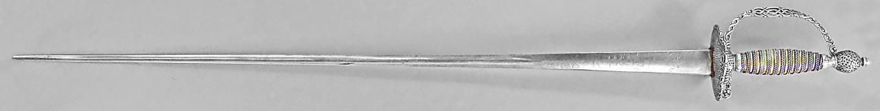

The first thing I found of interest during my initial research into the Shotley Bridge story was that hollow colichemarde blades differed from the bulk of smallsword blades in that – without exception – they all featured a groove in the broad face. This was of constant width as opposed to a constantly reducing radius. It is a fuller that also I found on many non-colichemarde blades. This example below is further typical in that although it does not have a vulgar shoulder, which is not visually pleasing, it does enjoy an extra broad fort and in my opinion a very attractive and successful happy medium.

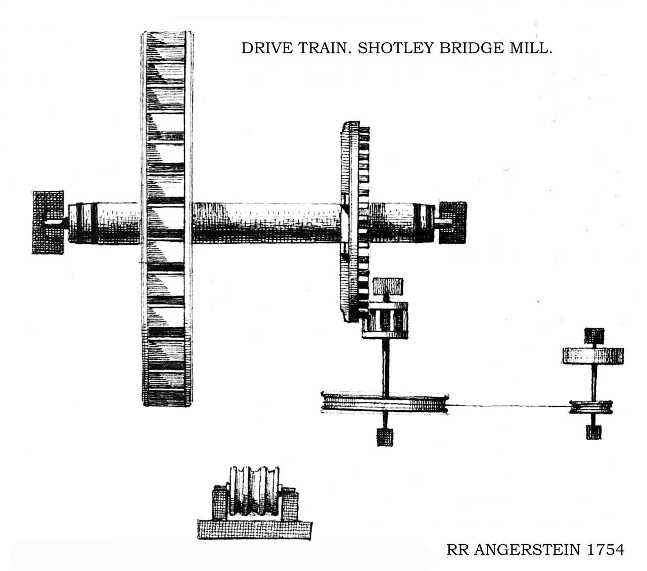

Next: I began to see more and more mention of the use of secret machines (or 'engines') even as far back as 1639 when Jenkes of Hounslow claimed to have use of them; then I saw the same again from Munsten and Henekels, again in Hounslow but after the Civil War. What were these machines?
It had been established from long ago that machines were forever absent in Solingen, and more recently even Burton claimed this, yet we know that over 30,000 Huguenots had found refuge in the Lennep parish of the Wuppertal while escaping from French persecution, and Huguenots were famed for their technical and mechanical skills. They invented the awesome Slitting Mill to produce nail rods for example. The conclusion I came-to was that the Mohll family had converted one of their paper mills to a Huguenot made blade grinding mill using these mysterious machines but, due to the entrenched luddite attitude of Solingen, they were not able to fully exploit them, so had looked to England for some time e.g. Jenkes et al.
It appears that the exodus to Shotley Bridge was the perfect opportunity, so Abraham and Harmonn Mohll took the machines over, appropriated the site of the flour mill in the village and converted it to power one of their (two) machines alongside a typical blade-mill works. In 1754 a sketch of that machine – then no longer secret – was made by Swedish spy RR Angerstein and its functionality is obvious: small, dry-grind (sic) wheels, instead of laborious hand filing.
Name:  Grinding train.jpg
N.B. profiling those very hard little wheels would only have been possible once 'tool' steel appeared following the development of the Cementation process in Nuremberg in 1601.

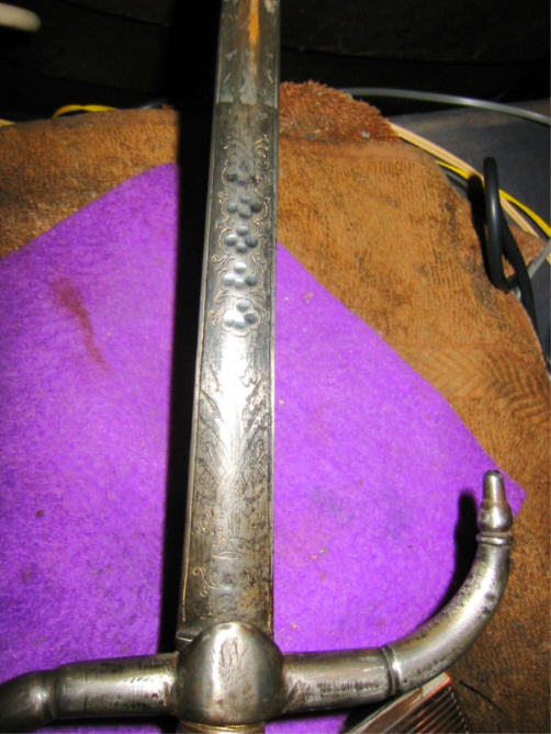

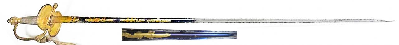

That second machine, by necessity, had to be in the forge and no Swedish industrial spy got into the Oley forge, no-one ever got in there. Angerstein did make mention of smallsword blade decoration in Shotley Bridge as by then (1754) this was the Oley's principle swordblade output. There is an example below, etched in 1767 by famous Tyneside artist Thomas Bewick – apprenticed to the Oleys during his early years with the Beilby glass company – using a stylised version of the Oley family's bushy tailed fox. That impressive style of fox has materialised on more than one occasion.
Name:  Restored colichemarde 5.jpg
So when you consider the official story told to the Crown at the time – that the Shotley Bridge enterprise was established to make fashionable but rare and expensive hollow smallsword blades at a lower price by using new secret machines, then you factor in the end-result of that second machine, I propose that all blades with a groove (colichemardes especially, hence my opening question) were made in Shotley Bridge.

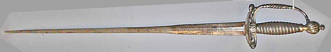

By the last quarter of the 18th century, when Shotley Bridge sword manufacture had virtually ceased, Moles and Oleys took their skills and those machines down to Birmingham. I found a George III smallsword that featured the infamous groove and had Gill's warranties stamped on the ricasso. It was a special commission from a Naval officer so was appropriately a short blade (27") but with a sizeable hilt.
The other example is also from Gill: a fine, decorated hollow blade.
Name:  Gill rolled comp.jpg
I've seen others, and I'm confident Gill could not have produced these blades.
