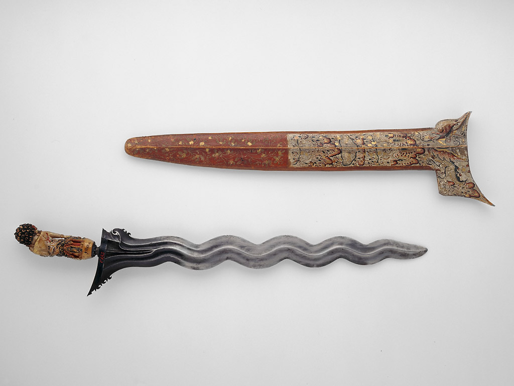

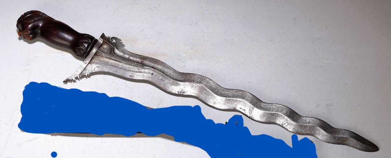

Hullo everybody!
I need help in locating a keris/kris with fretwork similar to that shown in the picture attached. Please look at it carefully if you think you may be able to help.
Thank you.

This Bali keris is close. Not sure exactly what you are looking for or why. Can you be more specific about your request?
Old 11th March 2025, 10:56 PM   #4
Posts: 7,404
Looks Balinese to me.

This greneng does not fit within the major recognised Javanese greneng forms of any period.
It is very probably the work of a maker who was not influenced by a major keris classification.
It might be of some assistance to see a well executed photograph of the entire keris.

Reason being, that when I could not place this greneng from my own memory, I then spent quite a bit of time trying to find a match in books & other published works, but I could not locate a match.
This greneng does display elements of other greneng forms that are pretty much standardised forms, but none of these are a match for the posted photo.
One of the major indicators for a Javanese keris classification (tangguh) is the rondha, & sometimes the complete greneng, if this greneng under discussion does not fit within the matrix then we might need to start thinking along somewhat different lines.
It is regrettable that you were not permitted the opportunity to produce a reasonably clear photograph, I really cannot see important details very well at all on the photo posted. I did massage this photo through Photoshop, but it is such a small image that it pixelated and became even harder to read.

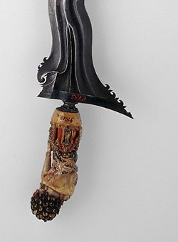

Perhaps this view may be a bit more helpful. It is markedly pixelated by one can now see the line of separation between the ganja and the rest of the blade.

Well, this is Greneng of a Keris, which was mentioned in an inventory for the first time in 1607. We most likely are looking at a 16th cent. Keris.
Todays "experts", seeing such blade, yell in one voice "Banten!". Yesterdays experts yelled "Bali".

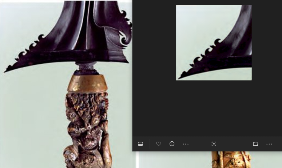

It is not featured in Jensens book, I guess it is in Krisdisk, chapter Bali, I cannot check at the moment. Here an even smaller picture of the entire Keris.

Alan, this is the same Keris.

Alan, load down the picture and zoom it.

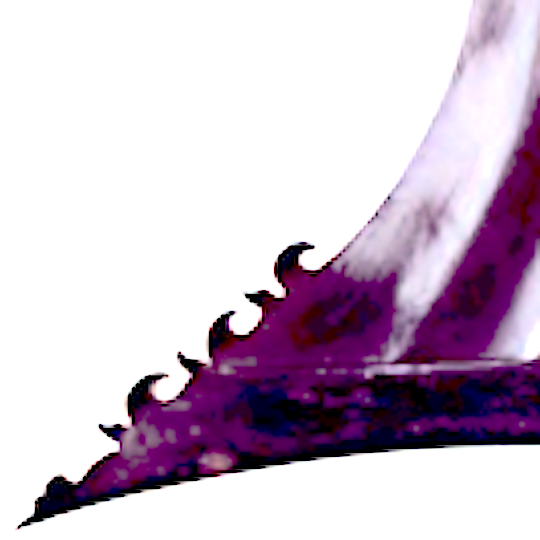

Thanks Detlef, I have already done that, plus an attempt to improve through Photoshop, but the original pic is only 72X72dpi, it is simply not big enough nor good enough to let me see what I would like to see, & I don't much like guessing.

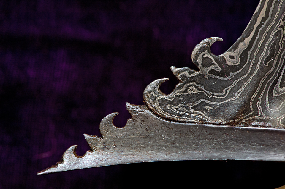

Hullo everybody!
My apologies.
I was rather impatient and so left the thread to retire to the skull-cave and consult the chronicles; emerging to launch into an investigative foray into the matter.
Result:
- better-informed
- becoming the delighted owner of sought-after fretwork (see attached); less-than-ideal but adequate for current purpose. (I may post about it at a later date.)
Thank you for all your input.
Ian & David:
The reason that I initially posted in both rooms was that my initial research indicated the presence of the same fretwork as on David’s Bali blade, on blades from diverse areas of The Archipelago (e.g. sundering/kalis, patani, palembang etc. ). Thus, I had hoped to reach a wider audience. Sorry for the inconvenience.
As for the initial picture of the fretwork in post #1, I found it in a past thread; it is better than the picture of the hand-drawn sketch I have. I focused just on the fretwork so as not to detract from my subject of interest.
I now consider this thread closed.

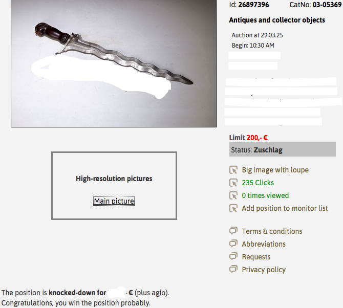

The Greneng in your previous post, with damaged/eroded Ron Dha, is from a Keris, which was auctioned on 29.3.25. It haven't made appearance here before.
Hullo Gustav,
I was referring to my initial picture (cause for some distraction): black blade on green background.
Old 31st March 2025, 05:46 AM   #28
That others know about which keris Gustav speaks here.
