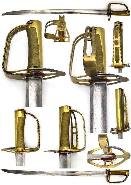

It seems that a number of Napoleonic French swords had a swing out knuckleguard which added extra hand protection as required. These were an innovation which precluded the eventual style of multi bar guards in the 1820s, until then most sabers had stirrup knuckle guards. As the French had notable colonial presence in the Indo-China regions etc. it seems quite possible this might be one of these.
The attached image of one of these French sabers (Cathey Brimage coll.) illustrates the concept, which was known simply as a folding guard in discussion, as far as local or actual term used on original examples it is uncertain what term might have been used.

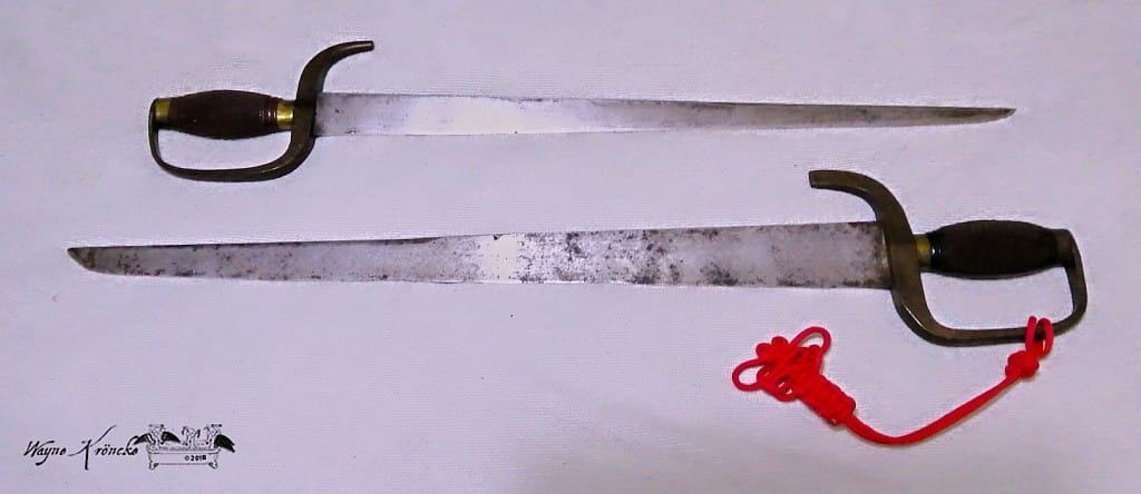

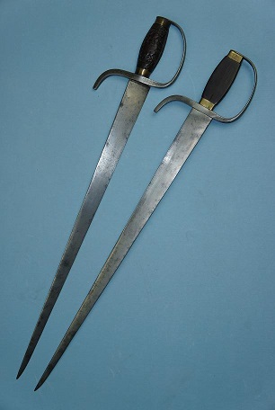

Quite possibly such weapons would have been the 'double' swords or knives termed these days as hudeidao (butterfly knives) which were halved to fit into same scabbard. While considered a 19th century weapon, these were noted in accounts of c.1820s suggesting they had already been in use for some time.
These seem to have been an innovation of Southern Chinese martial arts such as 'Wing Chun' and the Cantonese term for these appears to have been 'wu dip do', as far as I have found.
The 'double sword' concept extended to full length swords such as the jian as well, however these were dual weapons held in separate compartments in a single scabbard. The concept of course was fighting with two weapons, much as in the west in rapier duels with either sword and dagger or two rapiers (known as a 'case').
The best study of these weapons was compiled by Gavin Nugent some years ago, noting the rather clouded character of these recorded historically and that they were popularized in mid to later 19th c.
Perhaps the most reliable presumption of what type weapon would have been used by these pirates in China would have been the more well known daos etc. of the period.

Quite possibly such weapons would have been the 'double' swords or knives termed these days as hudeidao (butterfly knives) which were halved to fit into same scabbard. ...
These also came in 'single' sword versions with un-halved grips.
Mine: I think of them as 'Pirate' swords.

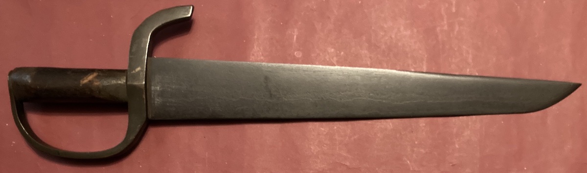

Default Single Knife Version
Hi All,
They also came as single knives. At 14.625 in (37.1475 cm) long, 2.0625 in (5.23875 cm) wide at the hilt, and almost .25 in (6.35mm) thick (spine at the hilt), my example certainly meets the Crocodile Dundee criteria for a “kniof”
Sincerely,
RobT
PS: The guard is very heavy brass and the hilt is wood.

These southern Chinese knives and sword length blades are interesting but do not have the profile of the sword shown in the original post, which resembles a very narrow rapier.
