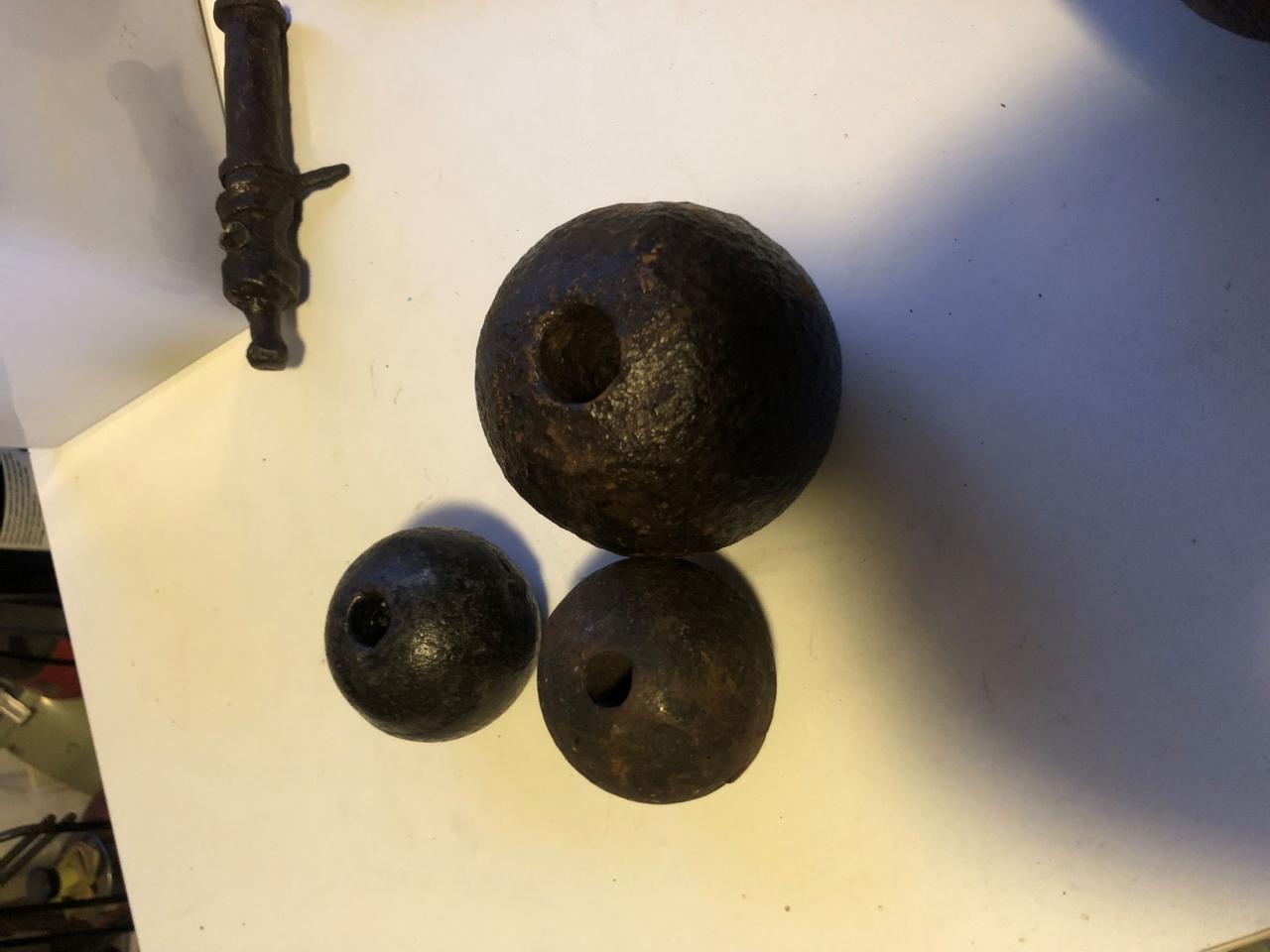

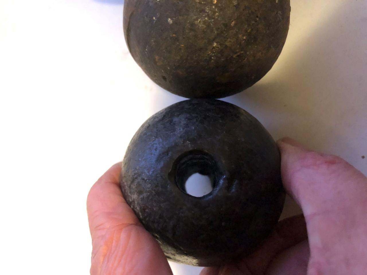

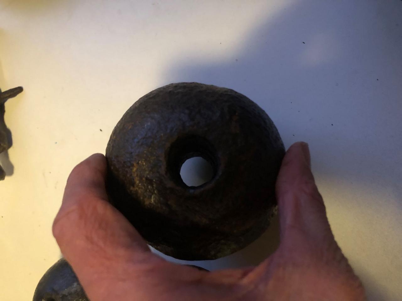

Besides the small "cannon" from my other post, there were also some cannonballs. From the photos that the auction house had on their site and also based on the description, I thought that these were partly mortars or hand grenades. The holes that I thought were for inserting the fuse appear to be holes that go completely through the "cannonball". The ball is therefore not hollow but solid minus the hole. I think that these are not cannonballs but some kind of weights. What do you think?

Hmm. Yeah, one would usually expect to see one hole for the fuse/powder fill. The fact that it goes all the way through and also not hollow except for the channel seems to indicate another use. Many of these types that get confused with mortar shells, coehorn and grenades are often old counter-weights used for mechanisms (gate openers, large clock mechanisms, etc). There is always the small chance that these could still have had some military use, such as in chainshot, barshot, etc lacking some components, but without a maritime provenance, this is just guesswork.

They were probably used as weights but might have begun life as a cannonball. Do the holes look cast or drilled?

Ed brought up a good point indeed. Many so-called 'cannon balls' are actually mill balls used in tumblers to crush rocks into gravel. Then again, there are other suspects, like counter-weights, shot-puts, flag staff ends, iron rail ends, etc.

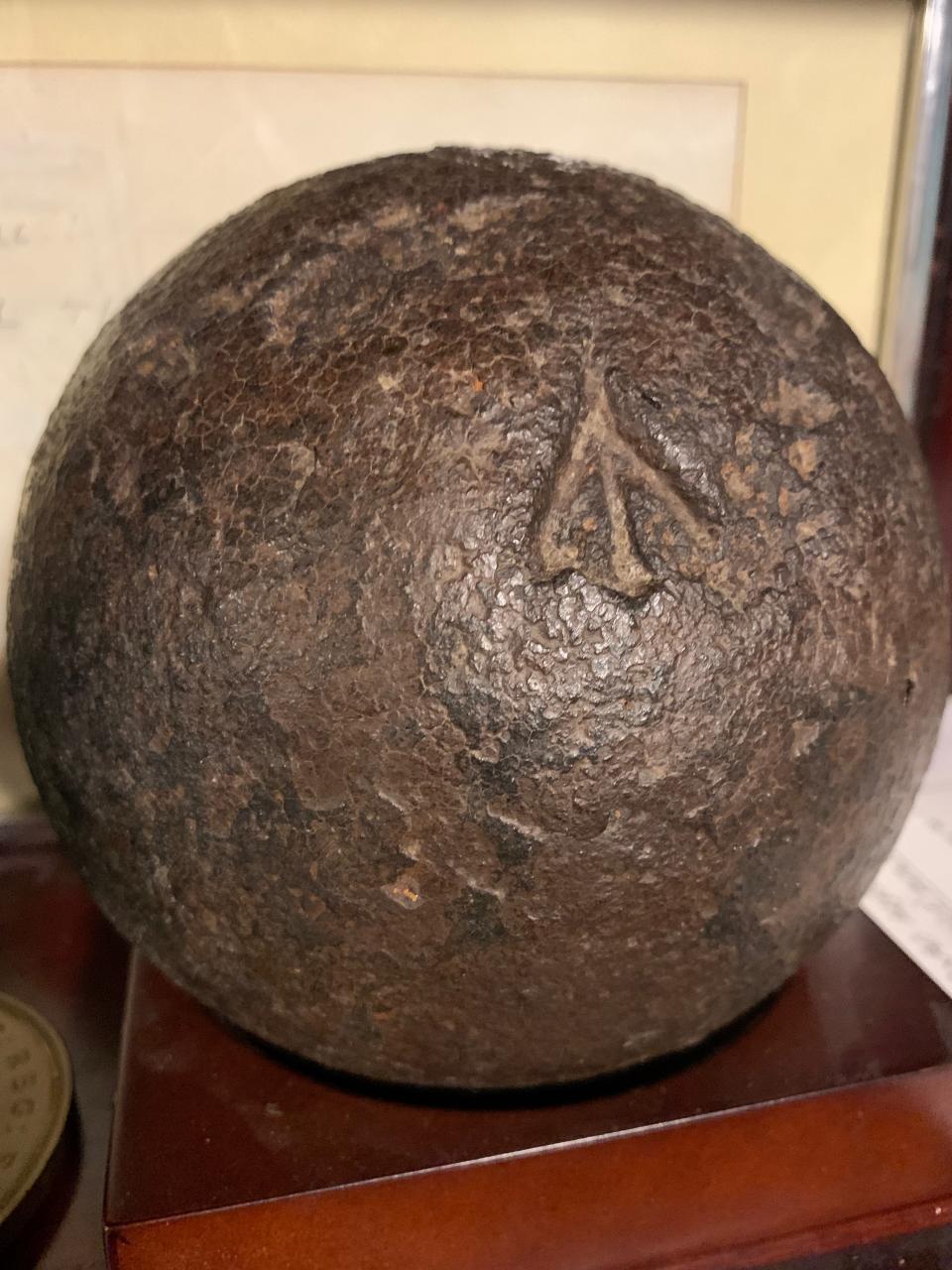

Grinder balls typically have flat spots and their weight does not match common cannon ball sizes. Pictured are some British 12, 24, 32 lb balls. Broad arrow ball 24 lb fired in 1760 at a French fort in Canada.

Thank you all for your comments!
Unfortunately no cannonballs then, although they were advertised as such by the auction. I have since sent them an email to point out their mistake.

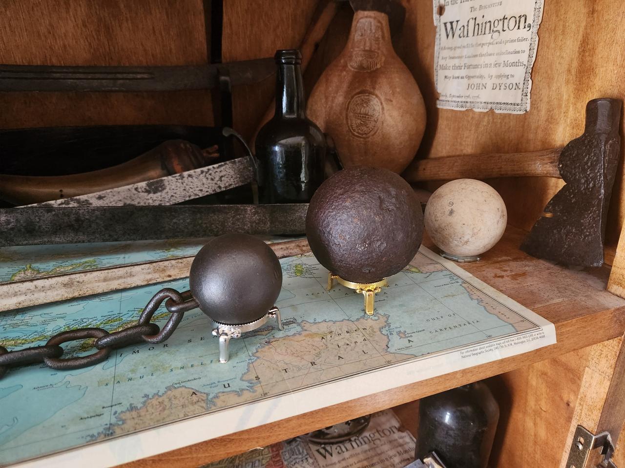

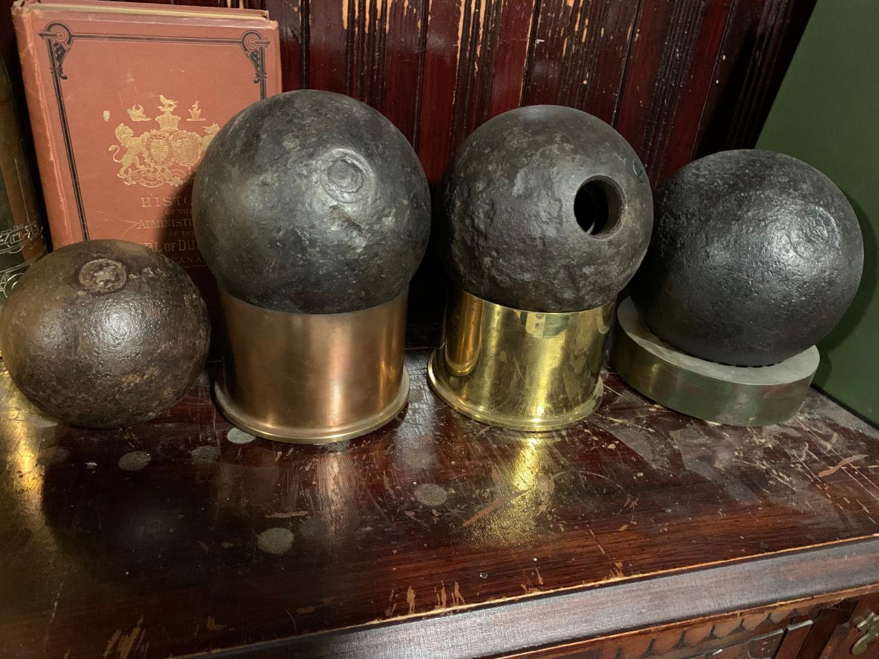

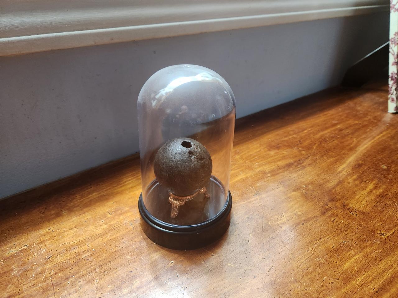

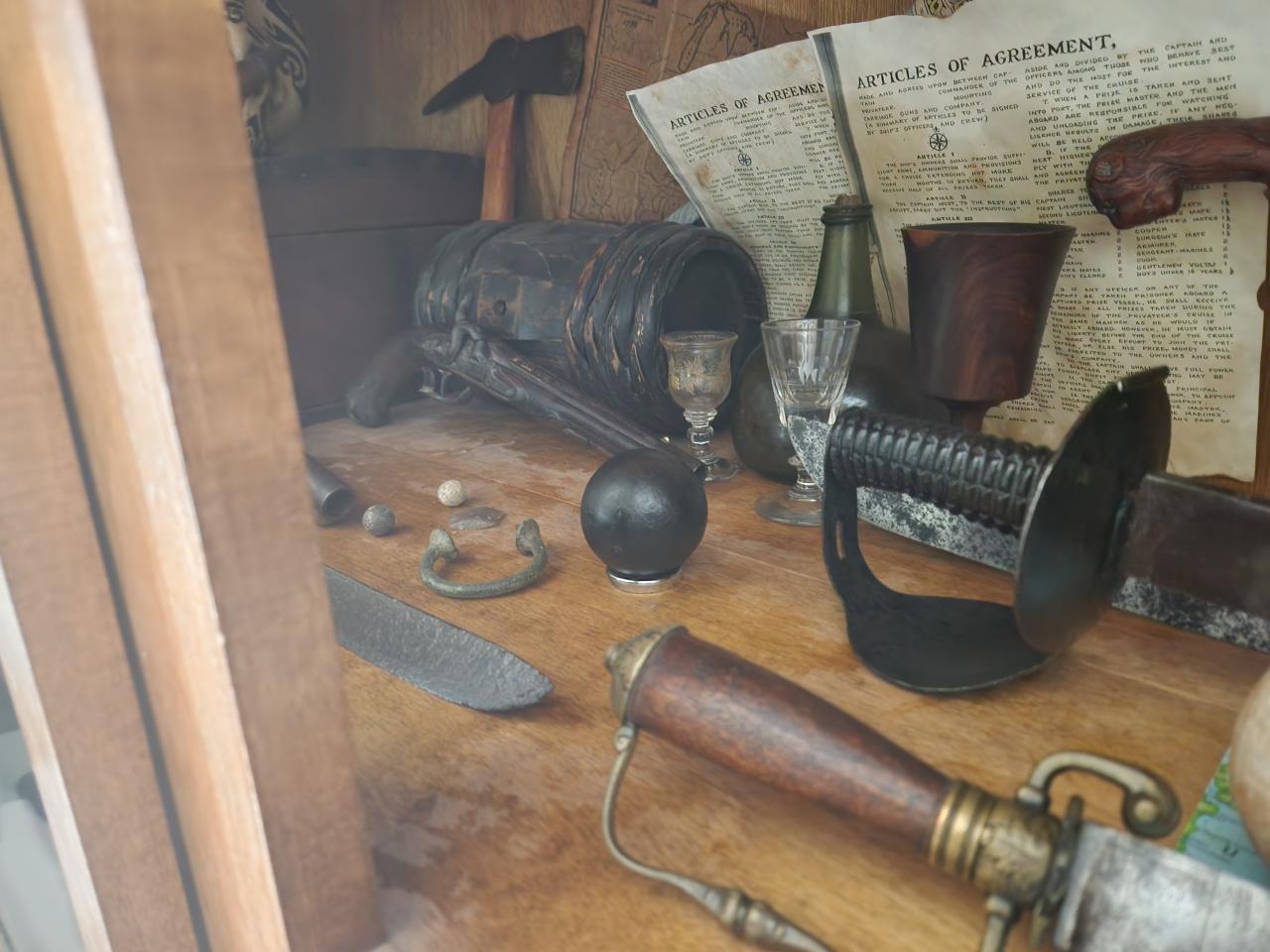

Here's a few from my collection. The large one is a 6 -pounder reportedly from the Charleston, SC area circa 1770's. The 6 pounders were used by both the Continentals and the Red Coats.
Also in the picture is my chainshot piece, which I had suggested these types posted by Cel7 might still be some sort of unusual shot. I have seen balls with the chain all the way through the ball and bolted to the other end. Likewise, there were early spike shot from the Elizabethan period with a round ball and spikes projecting through it front and back that combustable material could be wrapped around and set alight. This is just guesswork without provenance for any of the auction items presented by Cel7.
And, of course, I have two round stone balls presented to me as 'stone cannon balls' in this pic. Cannonballs made of stone did exist from around 1400 up to the English Civil War (mid-17th). They came in a variety of sizes much like cannon and musket shot of the same period. Stone balls were particularly effective on ships, as they could easily punch a hole through a rival vessel's hull, immediately shattering into a lagrage of deadly projectiles. Cheaper to use than iron at the time (and not requiring a forge to make!), they were time-consuming to create and became obsolete as ships' hulls became thicker into the late 17th c. Many stone balls are listed as 'cannonballs', but turn out to be decorative garden balls or Native American gaming balls, etc. (To dispel one rumor, there were never perfectly round 'mill balls' used to imitate these. Iron mill balls, on the other hand, do mimic real cannon balls). So...I'm not sure if I have the real deal or not. My two are hand-carved and very old. They do very much resemble specimens found off of County Antrim, Ireland, where the Spanish Armada broke up.

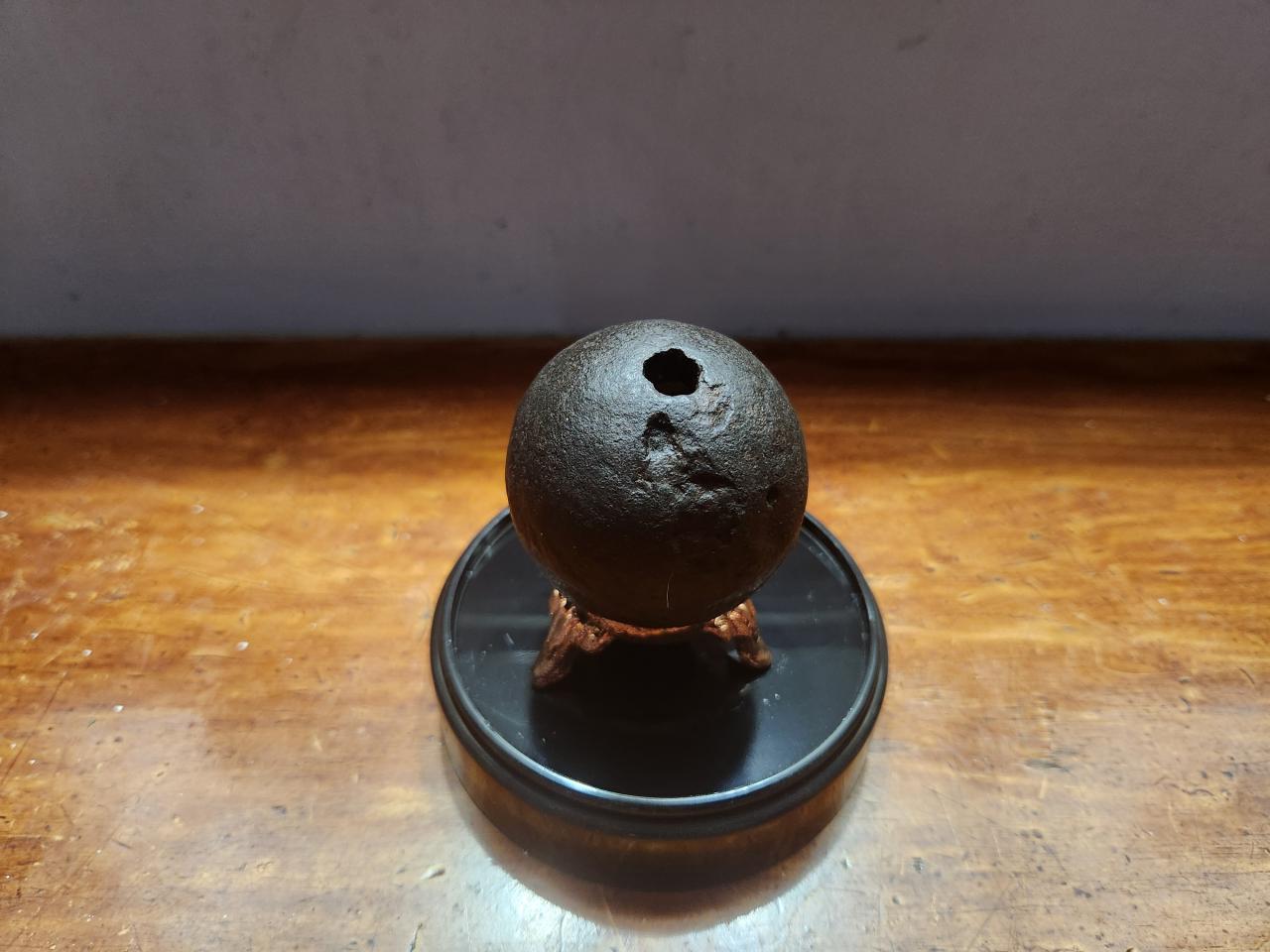

Here we have a 2 pounder cannonball, reportedly dug locally at the Yadkin River (near my home) where a skirmish during the Revolutionary War took place at the Battle of the Shallow Ford. The Americans liked these smaller ordenance as they could be fired from small cannons called 'grasshoppers' (as they jumped off the grass with firing!) that could be pulled behind a single draft horse to position it. Incidentally, 2 pounders were also used in swival guns placed on gunwales to rake enemy boats approaching and on wall swivels on forts. The Lewis and Clark expedition had a small swivel gun mounted on their front batteau as they made their way on their historic voyage.

These are incredible displays Capn, the Eley Maritime Museum!!!
It is amazing to see these items together in context like this. I dont know much on ordnance but I know its an area you have studied intently.

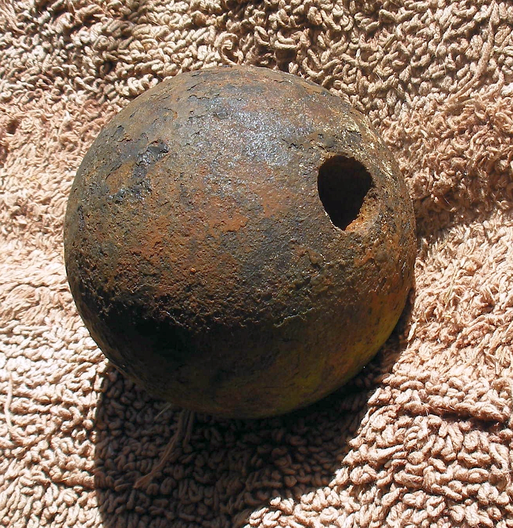

M ELEY
Location: NC, U.S.A.
Posts: 2,236
Hello Cap'n Jim! Good to hear from you! Black powder apparently has a very long shelf life and it is the reason that collectors have to be very careful if there is still powder in these shells. Most of the time, it gets washed away or mixes with earth and becomes inert. That being said, there have been people injured or even killed when dealing with these. The small grenado I posted is the only item I have that I know still has powder present. Years ago, I owned a very old coehorn mortar shell that someone plugged the hole with lead. Was it inert? I never found out, which is a good thing! Sold it a few years later. I know there have been places in Europe where old mortar shells from the 18th and earlier are found and the bomb squad is usually called in to safely detonate them.
