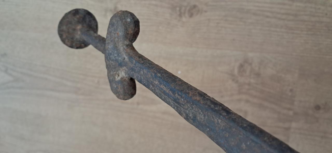

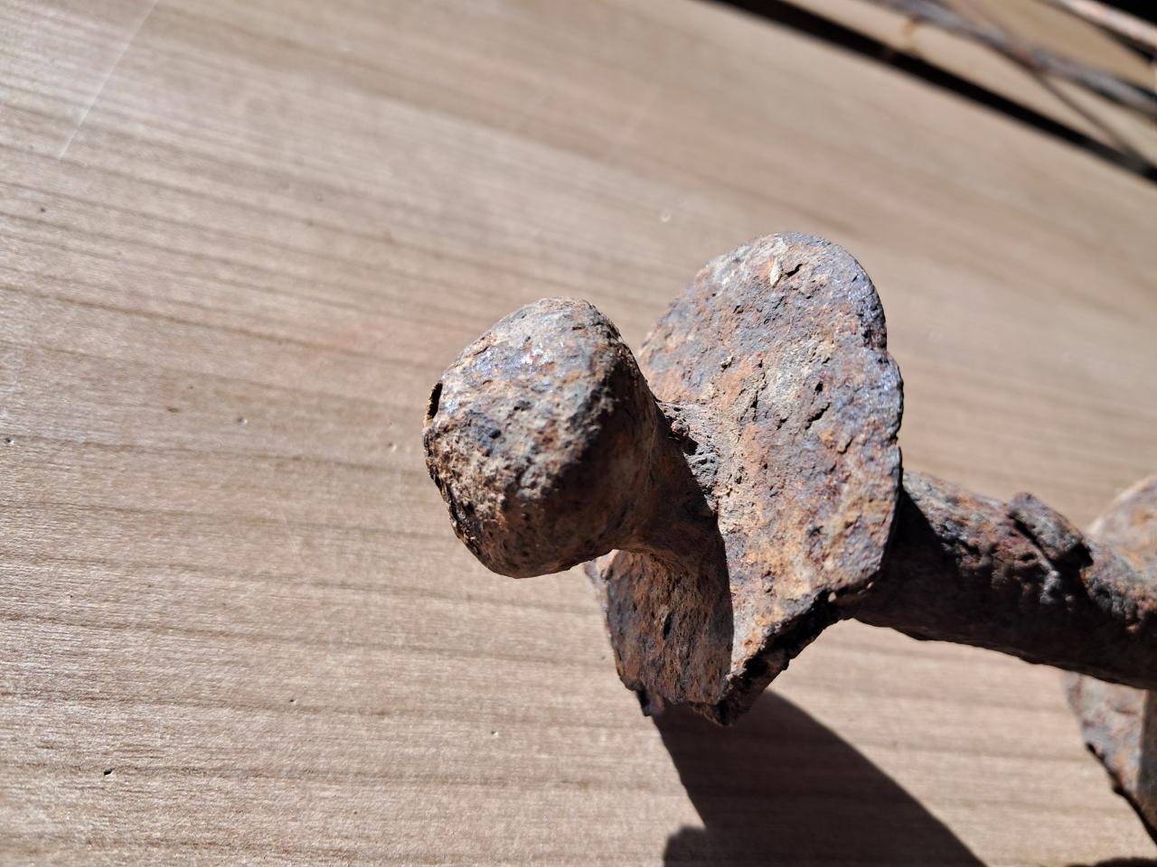

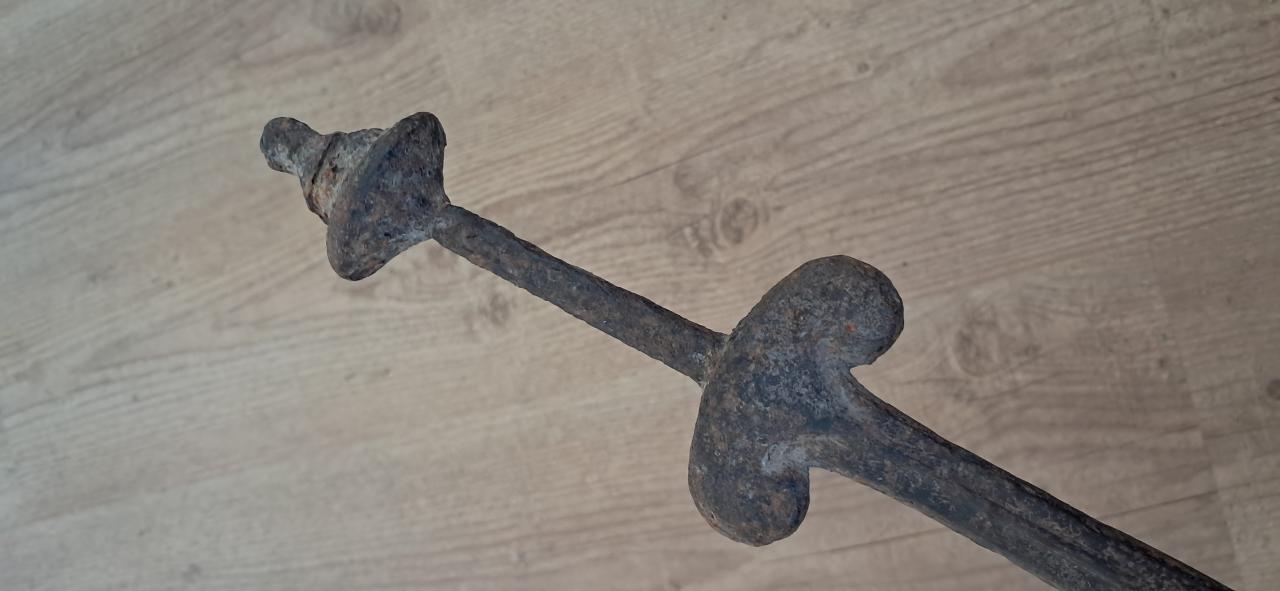

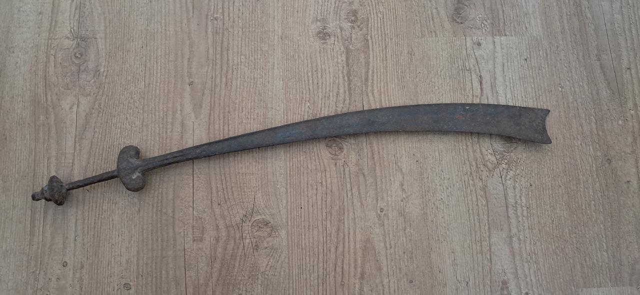

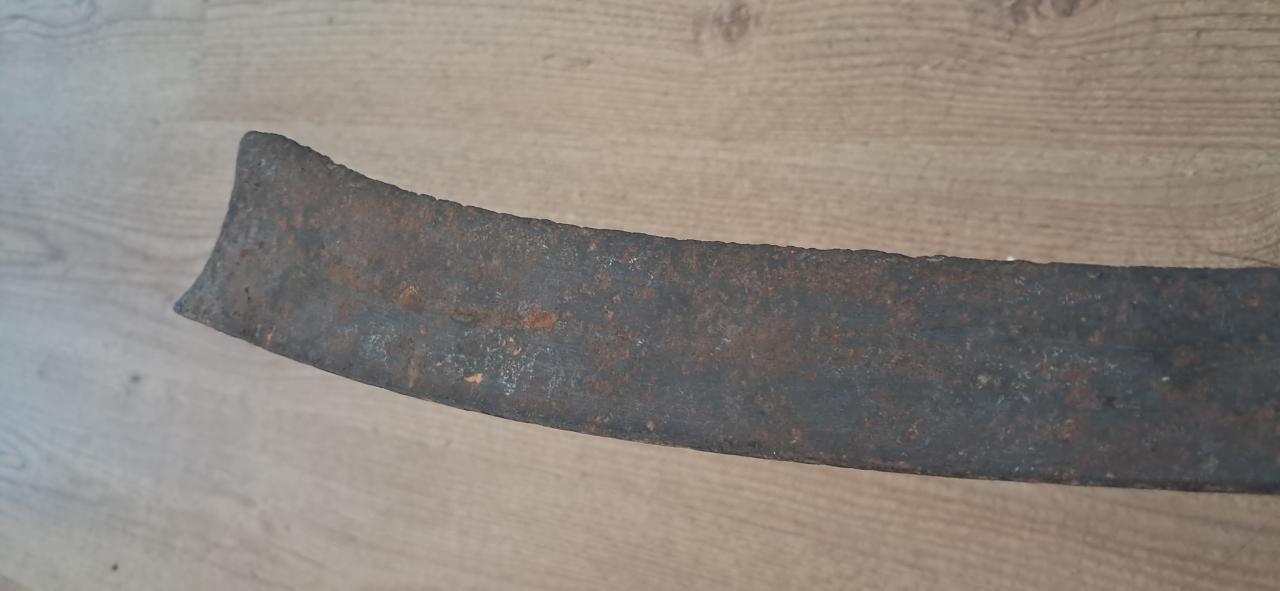

Hello all,

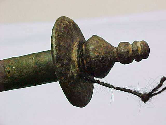

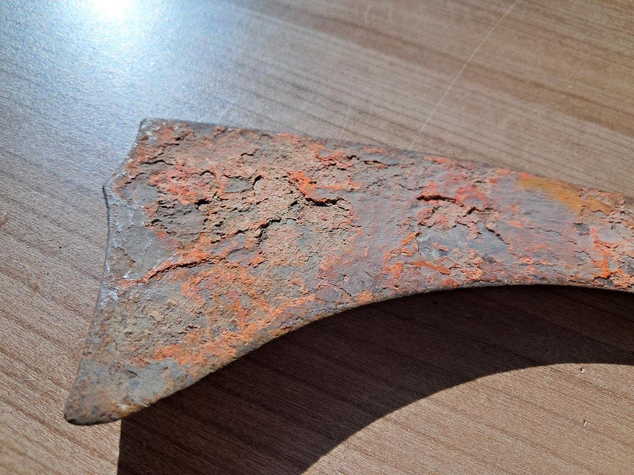

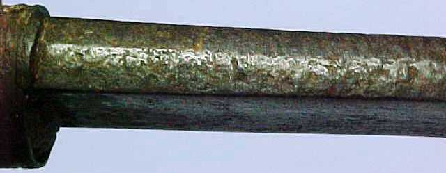

I recently picked up a batch of mostly South-Asian swords in rather rough shape. Among them are several tulwars, a few koras, a nimcha, and what seems to be a tibetan kora, of the type I have seen discussed on at least one post here.
As there does not seem to be a lot of info on these swords, or even a consensus on whether or not they are actually a Tibetan variant of the kora, I figured you would probably enjoy some photos from a new sword.
As you can see it generally matches the characteristics of the other ones being discussed, with a similar pommel, small lobed "quillons" and the same median ridge towards the bottom of the blade, although the one on mine seems to be less pronounced and more simple. It also has the same median ridge difiding the blade in two planes, although the one on mine is hidden by rust and oxidation. Similarly, the tip expands in typical kora fashion, but is still rather slender and thin.
Overall, I have no more info about it other than what was already discussed here, so Hopefully you have more insights, or are at least interested in seeing it!

I just realized I didn't include the pics.
Rapier's Delight is offline   Reply With Quote

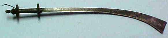

Damn it, I really should have gone back to Amsterdam for that one shouldn't I?
But anyway, there's some discussion of these in this thread starting at post #15. Some suggestion that it might be Indian (Sikh?) instead given the depictions.

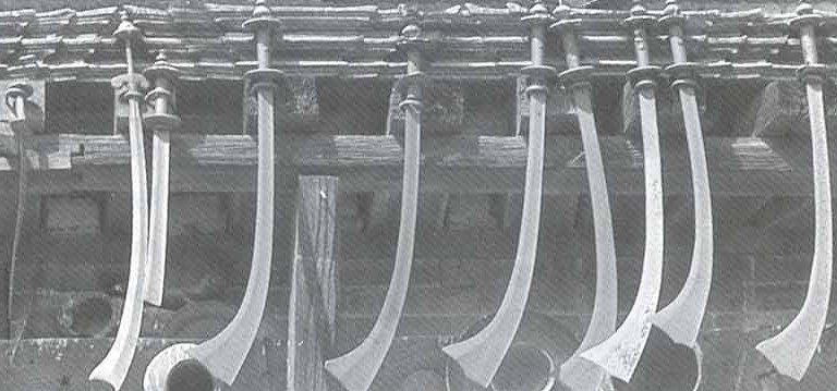

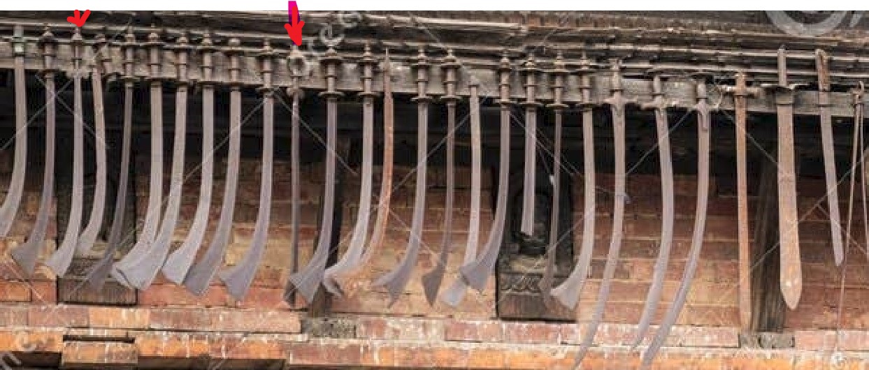

Not common at all. With this hilt type. I think they are archaic.
I have one like this and have seen a few come up. There are some hanging amongst other kora - the more traditional ones - on the exterior of a temple in Nepal. Bagh Bhairav Temple. I can see 2 with this hilt type in the line up.
"Evidence of his terrifying nature and his role as guardian can be found on the front (south) facade of the temple, where many dozens of terrible knives, swords, and other weaponry are nailed to the wall. There is some ambiguity regarding their origin. Dowman notes that they were captured from Gorkhali attackers during a siege of the city in the late 18th century, while Hutt mentions that Kirtipur's Newar defenders surrendered them."

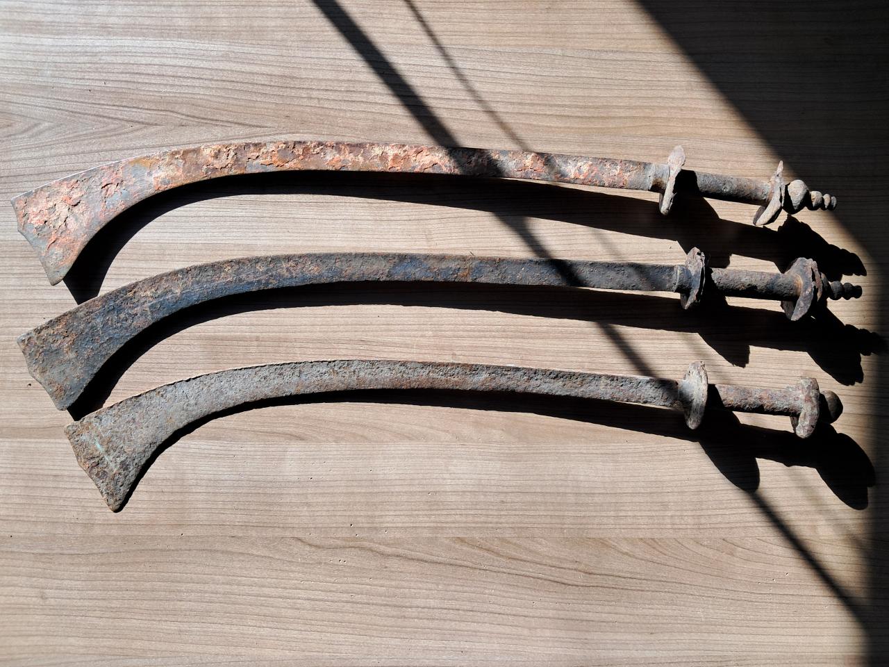

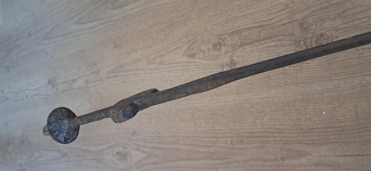

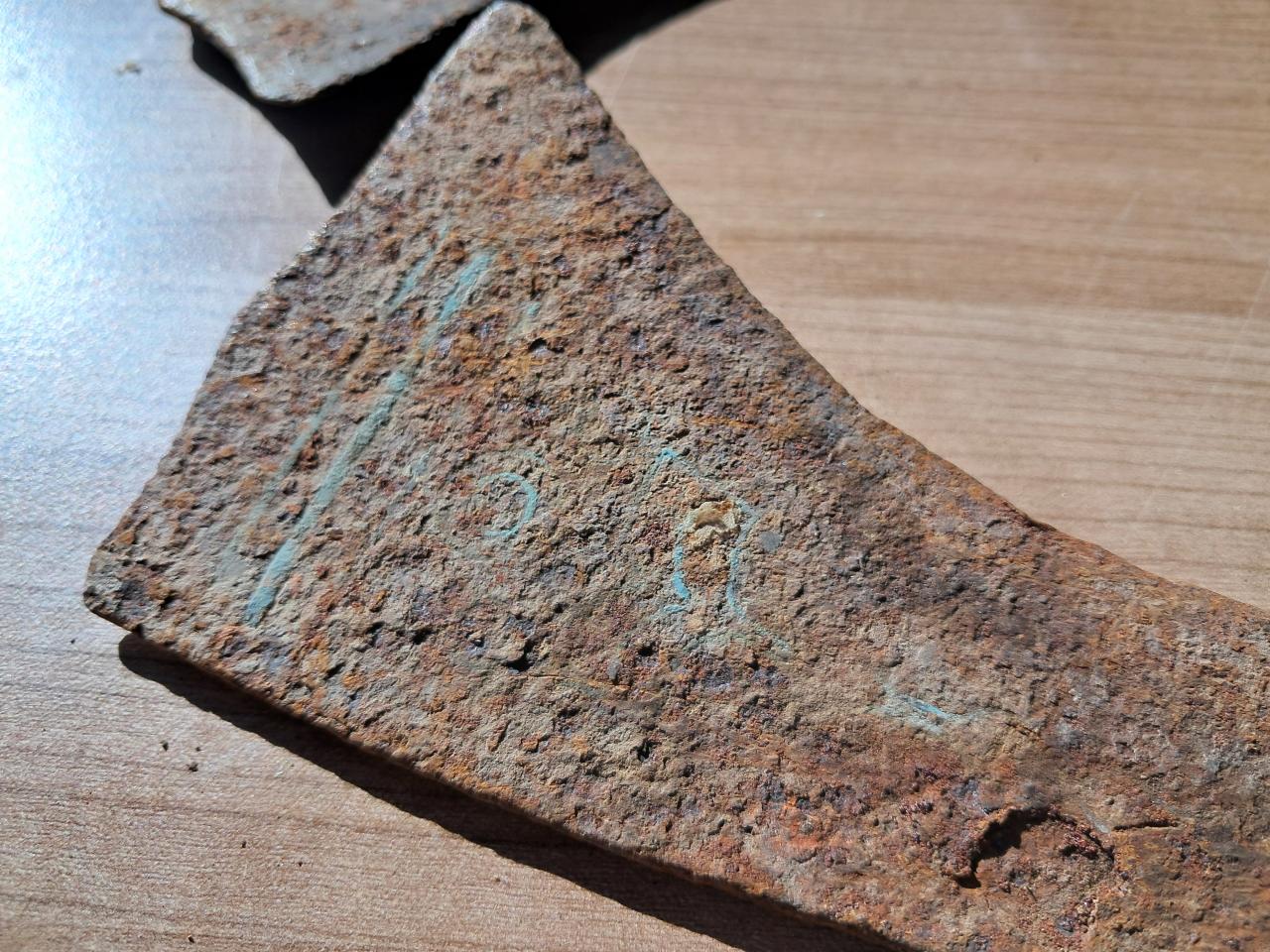

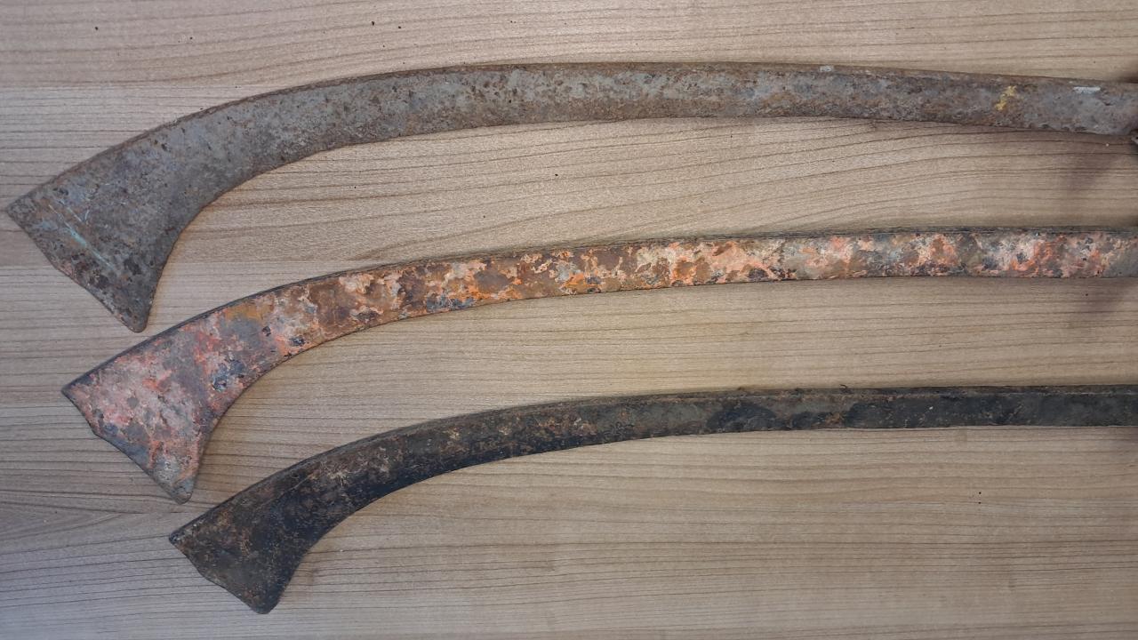

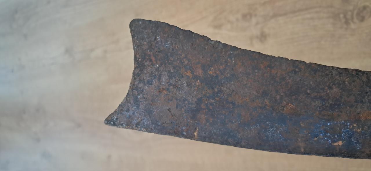

Here are the pics I currently have. I can take better ones tomorrow.

Just a very old form.
Pity as to those other 3. They are in relic condition.

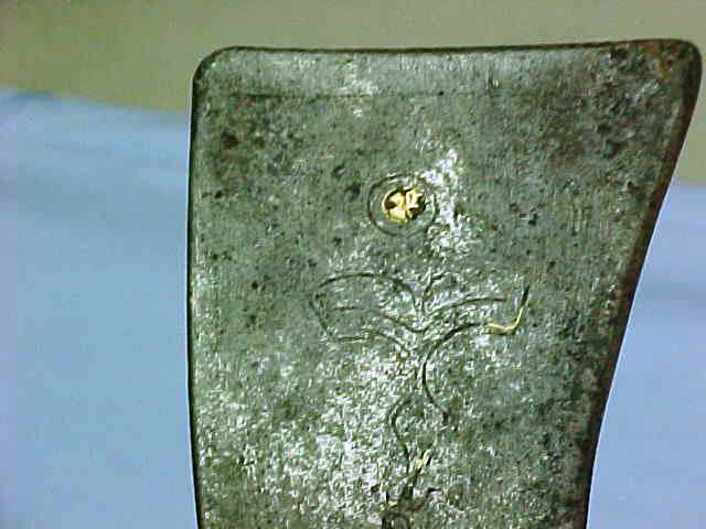

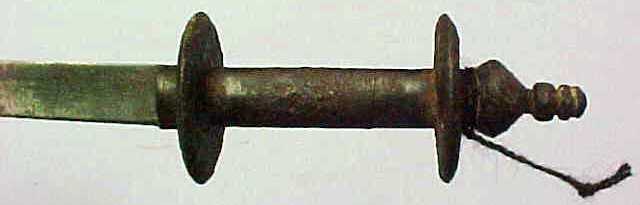

Ive been looking for a Tibetan kora like this for a long time.

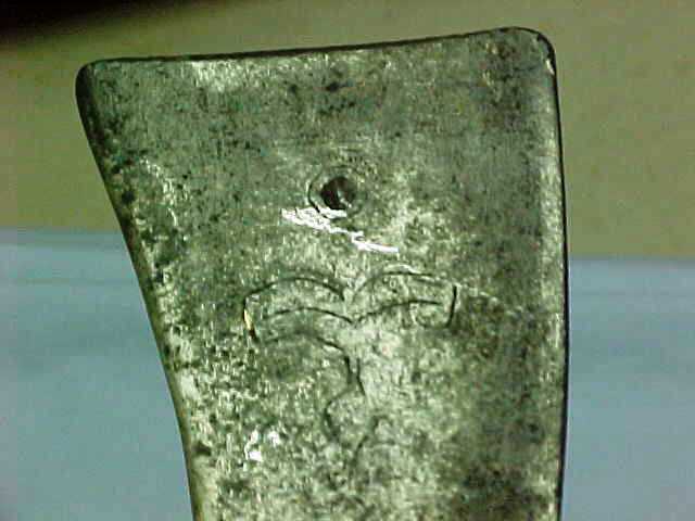

What I have is this, another form of Tibetan kora (which I debate on restoring the inlay or not):
Battara is online now   Reply With Quote
