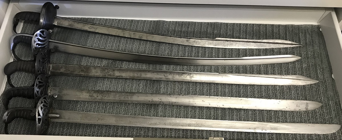

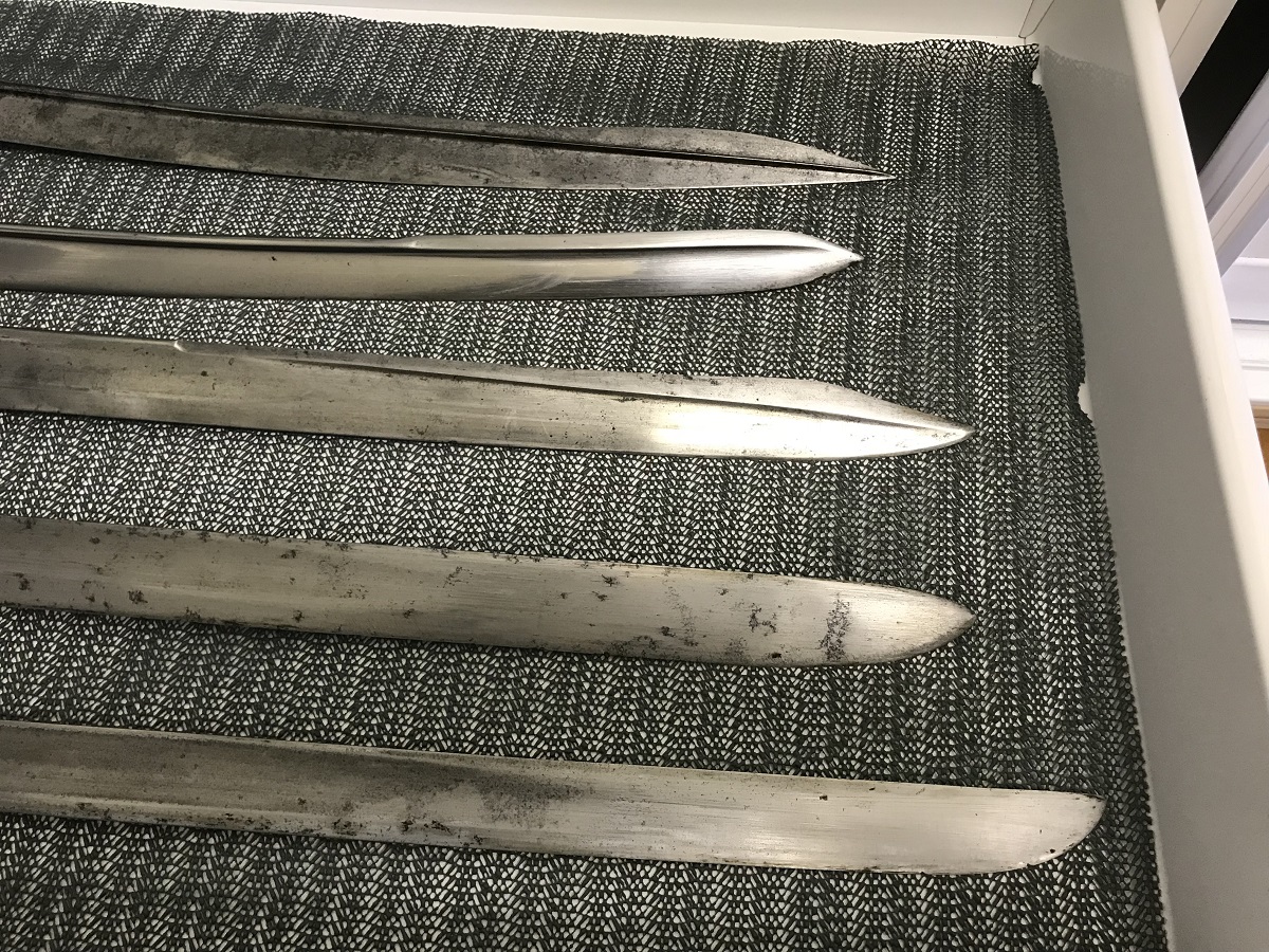

Here is a photo showing a range of blade tips found on 1796 heavy cavalry officer service swords.
From top to bottom:
1. Quill-point
2. Spear-pointed pipe-back
3. Spear-pointed intermediate pipe-back.
4. Modified semi spear-point
5. Original unmodified hatchet point
Cheers,
Bryce

Bryce - excellent photo. What's not to like about that collection. I always did like the look of the hatchet point. I've read about HCS with spear points where the scabbard length matches, implying that they were made that way. I'm not sure you have to lose much blade length to make a spear point, especially an asymmetric one.
